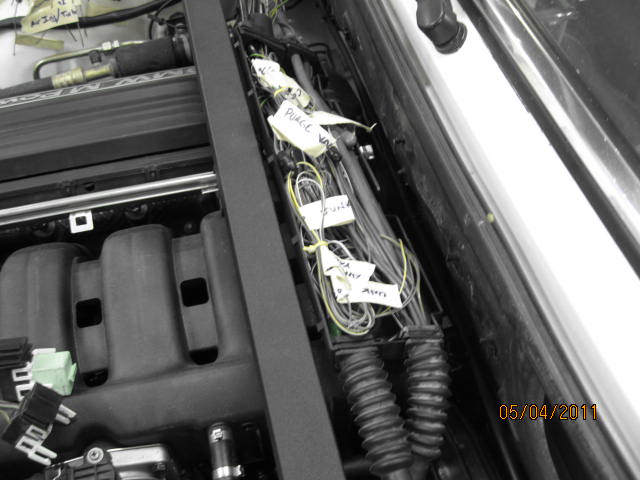

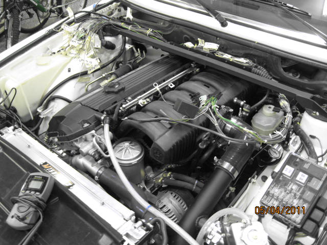

Below are some images of the next stage of the project - ENGINE MANAGEMENT
Just to bring you up to speed - the battery relocation has been completed. This was more work then I had anticipated - DUH (my Charlie Sheen impression). Required a tray for the Optima, mounting the tray, mounting a master fuse holder, crimping the lugs on the end of some very large diameter cables. Did not have the crimping tool, had to borrow one. I hate not having all the right tools.
Did install my rear stress bar from Mason Engineering - that involved taking the rear struts back out to get it in - but it fit like a glove. Had it power coated to match the front - but it is so far in there - who will ever see it?
Reinstalled all the trunk stuff - cut out the bottom piece to clear the battery.
I had to buy an e34 drive shaft from a wrecking yard and have nose grafted into my e28 auto driveshaft - so that the larger guibo could be used. If I had a good e28 big six drive shaft - this would not have been necessary. Turned out really nice, but only when it is delivering power to the rear wheels will I say it is good.
Now on to the really hard stuff...engine management.

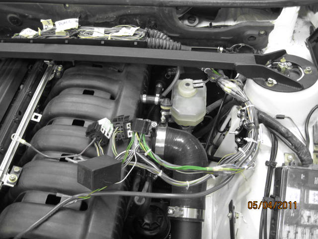

I ended up going with the Megasquirt 3 with MS3X, so I could support COP, sequential injection, boost control, other functions. I spoke with the guys at DIYAutotune.com and they guided me through the whole thing.

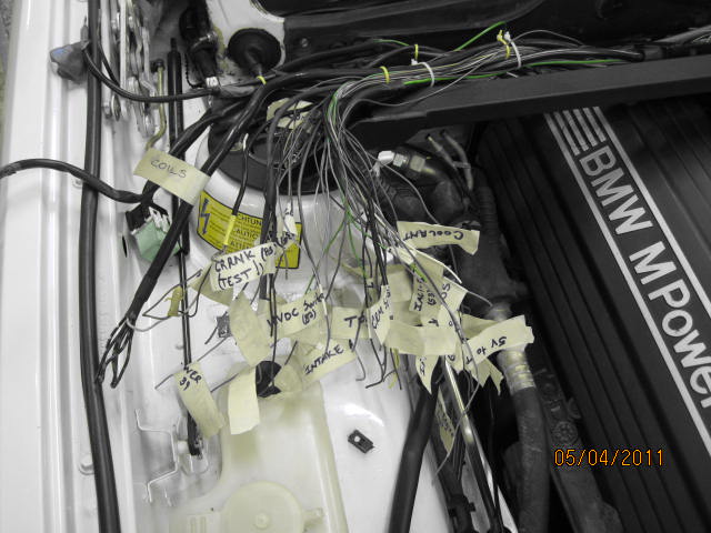

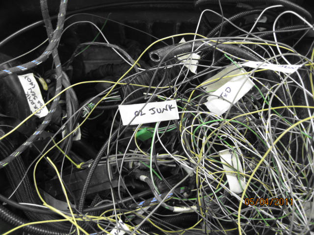

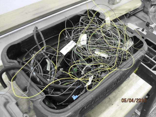

I have now pulled apart my S52 engine harness to eliminate all the unnecessary lines I wont be using and labeling everything, I mean everything- EVERTHING. There is a large amount of the harness that is NOT used, you can see my collection of dead e36 M3 nervous system bits.

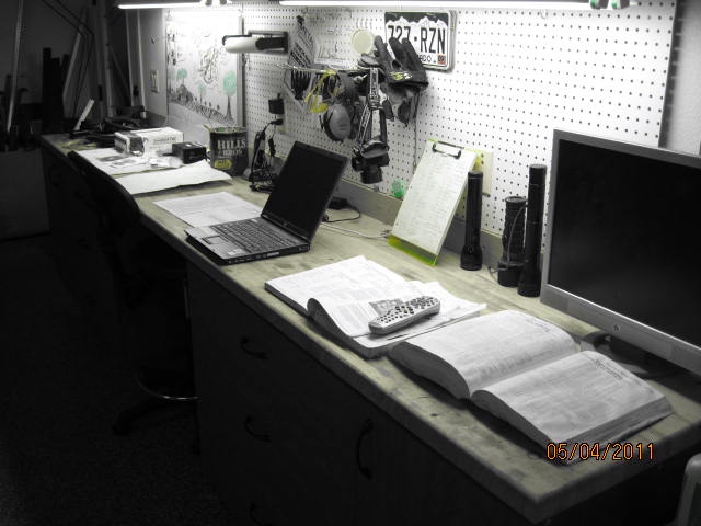

It was pretty straight forward, but before I cut anything, I built a few very large tables in Excel so that I understood the translation between (1) the factory ECU (2) to the factory harness (3) to the MS3/MS3X harness (4) to the MS3 ECU. I used my e36 and e28 Bently Manuals over and over and over again. I also needed to graft the e28 C101 connector to the e36 CX20 connector - that turned out a bit harder than I thought. Around the e36, BMW starting running alot more logic through this connector (engine to chassis). I am still working on that one.
Couple of words of caution:
1 There are others who have posted tables on the net for e36 and e28 pinouts and wire colors - they are at best, about 80% accurate, so before you trust anyone (including me) check their homework.
2 There are mistakes in the Robert Bently manuals.
3 If in doubt, ohm out a line to make sure you are cutting or removing the right one. Because there are so many lines to the factory ECU (88 pins) - some colors are used more than once.
4 Megasquirt documentation is good, but the colors and pinout does not match between the documentation and physical box - check their homework.
5 Understand the logic of your harness/relays (use the Bentley manual) - in some cases I thought I knew what I was looking at, but after looking at more - I had the logic backwards - especially relay activation, some are 12V and some are ground.
I keep plugging away - this is taking forever and ever. I fear I will be willing this car to my kids with instructions on how to complete it.
