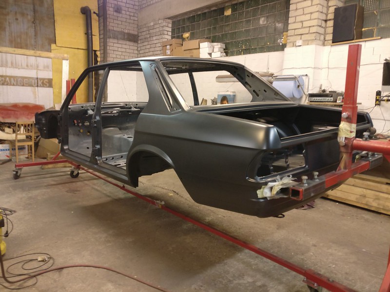

Stripped the rear end. All original paint job (under the spray can top coat) so not many unpleasant surprises. Levelled out couple of my welds a bit better. The flat area where license plate goes needed a lot of work - for some reason it got sandblasted together with the underside and was all wavy from it. Not sure how I hadn’t noticed it before, guess I just subconsciously ignored the mess it was. I was afraid to stretch it out even more working on it. In the end, I got it better and was able to avoid oil-canning. Not perfectly straight, but will do.
My initial plan was to only shoot the acid primer on the outside for some protection and leave the rest for the paint shop. But when I went to buy some more primer my paint gal talked me into doing the whole chassis myself. Her arguments were that it would give much better protection and since it gets sanded down during the body/filler work anyway it doesn't matter if you mess it up. So I took her advice and messed it up.
Actually rear end didn’t come out that bad. First, a layer of etching primer followed by surfacer the next day.
Roof and sides a couple of days later. Pillar areas are where I mostly screwed up - a lot of paint runs. Roof came out quite nice. It would have been better haven’t the gun run out in the middle of the panel. I guess planning isn’t my strong suit.
Then back into the rotisserie for underside, trunk and engine compartment.
Did the underside, wheel arches and trunk in one go. It was rather nasty. First all the scuffing, cleaning and masking. Then the paint gun doesn’t fit where you want it to fit. All that primer flying back at you from the wheel arches and trunk. But eventually, once the car matched the color of my face, everything was all right.
Now It was finally time to install something back on the chassis, namely the trunk plugs.
Also glued in the large plug in the bottom of the spare wheel housing and installed the remaining rivet nuts for fuel/brake line clips.
To have a small break from all that paint work I welded the adjustable rear subframe kit in place. The kit was bought from Bimmertune. Quality seems good. Still need to slot the bolt holes, cut and reinforce the inner brackets. Then I can finally take all the subframe parts to sandblasting.
A wise man would have shot the engine compartment together with underside to avoid all that masking nightmare. But with all the nooks and brackets there I really didn’t want to risk doing it myself. Furthermore I didn’t see much reason do redo the nose frame at this point as I’m sure paint shop will shoot another layer of primer on top of it later on. And I still had some dark gray primer left so I rather had the whole engine compartment in matching color.
Anyway, yesterday my buddy made a really nice job on it.
This is how it sits now. Hopefully, I’m able to shoot the undercoat upcoming weekend. Then make new brake lines while car’s still on rotisserie and after that it can stay right-side-up for good.

Passenger’s side front door was in relatively good shape. Channels were clean, a couple of dents to take care of. I removed and reinstalled the small piece for weatherstrip so I could properly clean the corner of rust.
Funny story. Notice the small sheet metal tabs bolted to the hinge slots. I used these to hang the doors for painting. You know what happens if you use too long bolts there, don’t you? I realized my error a bit too late and ended up with a nice bung on the outer skin. Nothing that couldn’t be fixed though.
Driver’s side rear door. A couple of small dents to remove. Bottom channel was already replaced year ago.
Bought a used passenger’s rear door online. Kind of a lottery but it’s quite impossible to find anything half decent locally nowadays. If you recall, both the doors I had were in a bad shape.
The bottom channel needed to be replaced but that could be seen from the pictures in the ad.
What wasn’t visible from the pictures was all the accident damage hiding behind that bondo.
The damage wasn’t too bad. Thickness of that bondo was less then 1mm in most parts with a couple of thicker spots, maybe 2mm tops. I was able to work most of the deeper dents out and even out the surface a bit. Still needs a bit of filling though.
Unfortunately, sheetmetal underneath the bondo was scratched up pretty bad during the previous repair. Damaged areas had like 24 or 40 grit scratches on them. Sanding those out would turn the outer skin into a foil. I hope they won't be too noticeable once the car is painted.
Bottom edges of the doors needed some straightening. Also made sure that doors line up nicely with each other and with front fender.
Shot some etching primer.
Asked my buddy to do the primer.
Now I need to make them fit well and see if anything needs some more adjustment before the paint.
For some reason, I always thought these were made of plastic. Turns out it’s aluminum.
Some primer on the fenders so I could fit them permanently before paint.
12kg of fasteners. Should cover most from the axles, engine, engine compartment, panels and some of the interior. Minus a couple of odd sized fasteners that I’ll probably order OEM and bolts for doors and trunk hinges that I forgot to order.
Next in the list would be sealing the seams in engine compartment (cabin and trunk are already done), fit panels properly so I could mount the fenders, get the hood to my PDR guy and retrieve my trunk lid from him. Then I think it should be ready for the paint shop.
That would be all.
