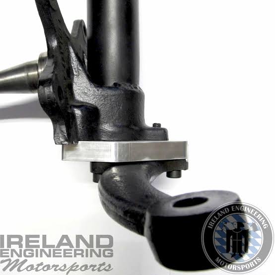

I believe I have fixed the steering issue, the problem was with the tierods being at a very poor angle when the suspension was fully extended and just getting worse as the car was lowered.
I had obtained metric m14 heimjoints two years ago when I was thinking bottom mounting the rodends by reaming a new taper from the bottom of a bigger size and using tapered studs to solve this problem.
The issue with that had been, fining the correct tapered studs, figuring out how to correctly ream the mount points, etc. Ultimately this path would have required me to have custom tapered studs produced that were part metric, part imperial, and the cost was absurd. So I got a second set of knuckles with the idea being that I would just cut then re weld the mount points upsidedown.

Nice creative way to solve steering issue. Is The steering issue caused by lowering the car? If so, there is a lot better and elegant way to solve it. Spacer between the strut and steering/control arm mount bracket would solve steering issue and also improves roll centre.
Re: 84 533i turbo build thread
wow, I am mildly irritated that I had not found that.....
