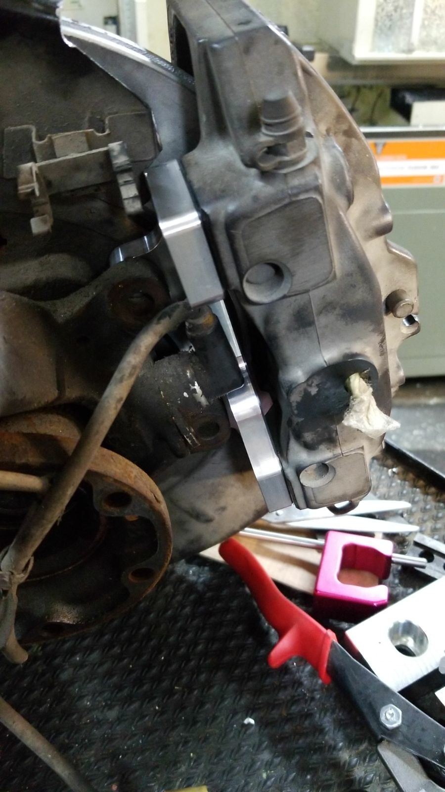

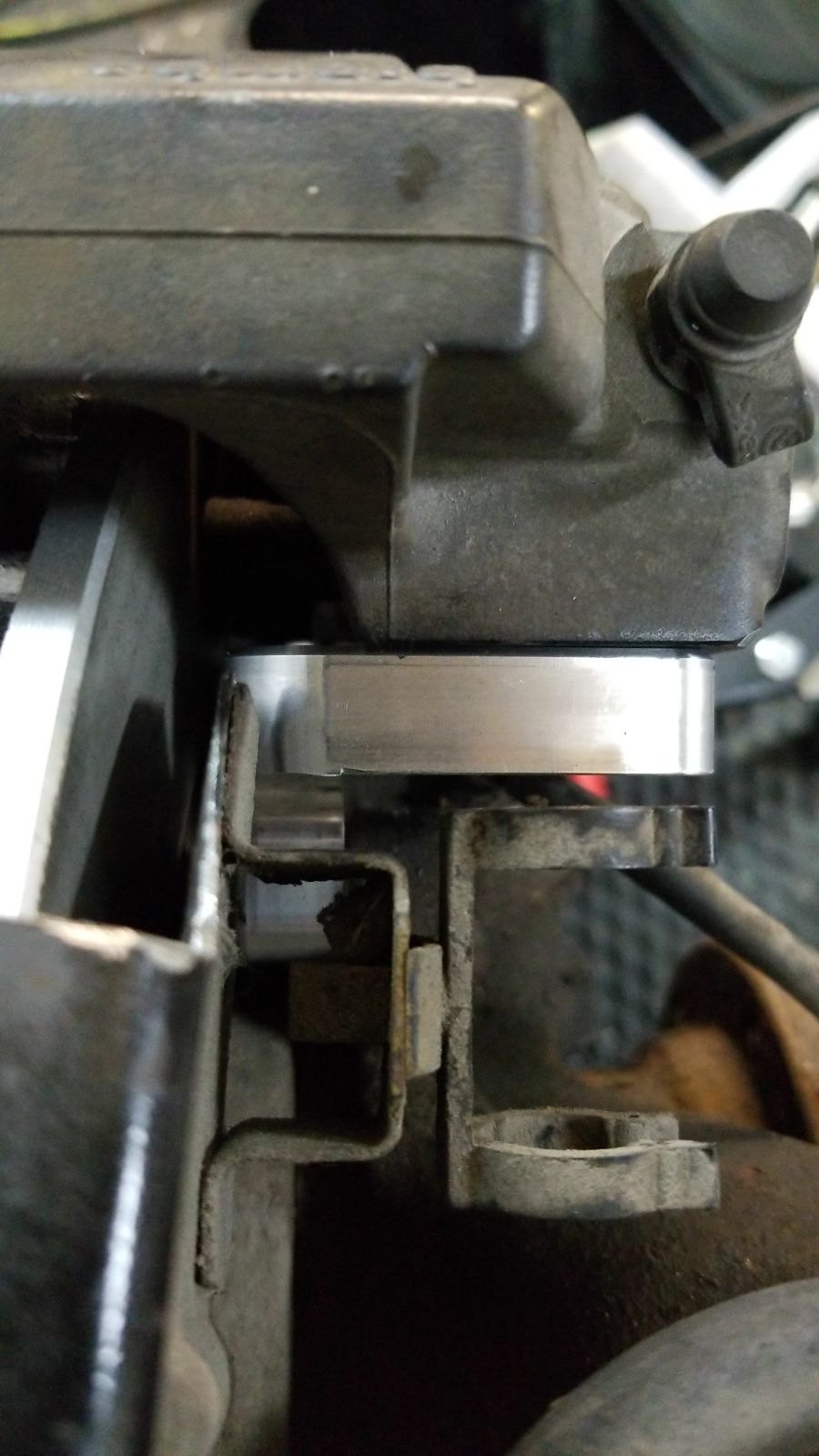

This thread is not dead. I added a couple more rotors to the collection, the stack is now about 7 feet tall. :dunno:
Finally came to the conclusion that I can change up the offset (76mm) and don’t have to stick with the E28 specs.
The main issue we kept having with the 76mm offset was that the Cadillac calipers would always hit the factory mounts and the only way to solve it would be going to a larger rotor. That would then limit the wheel selection to 17” three piece wheels with thin barrels, which wouldn’t help 90% of the people here.
New in the game:
Euro E46 M3 CSL 345x28mm (53.5mm Offset)
Euro E46 M3 325x28mm (53.5mm Offset)
E82 135i 2 piece (63mm Offset)
The 53mm ones need a 10mm spacers for sure to clear the wheel face. It seems like the E82 rotor with the ATS caliper could be the answer I’ve been looking for, at Least under a 17” wheel.
The 325x28mm will work with the ATS under a 16” Style 5 with a 15mm spacer.
On a last note, the combination of Cayenne caliper, 345mm rotor and E48 wheel is a lot lighter than the factory M5 brake/wheel setup. :cool:

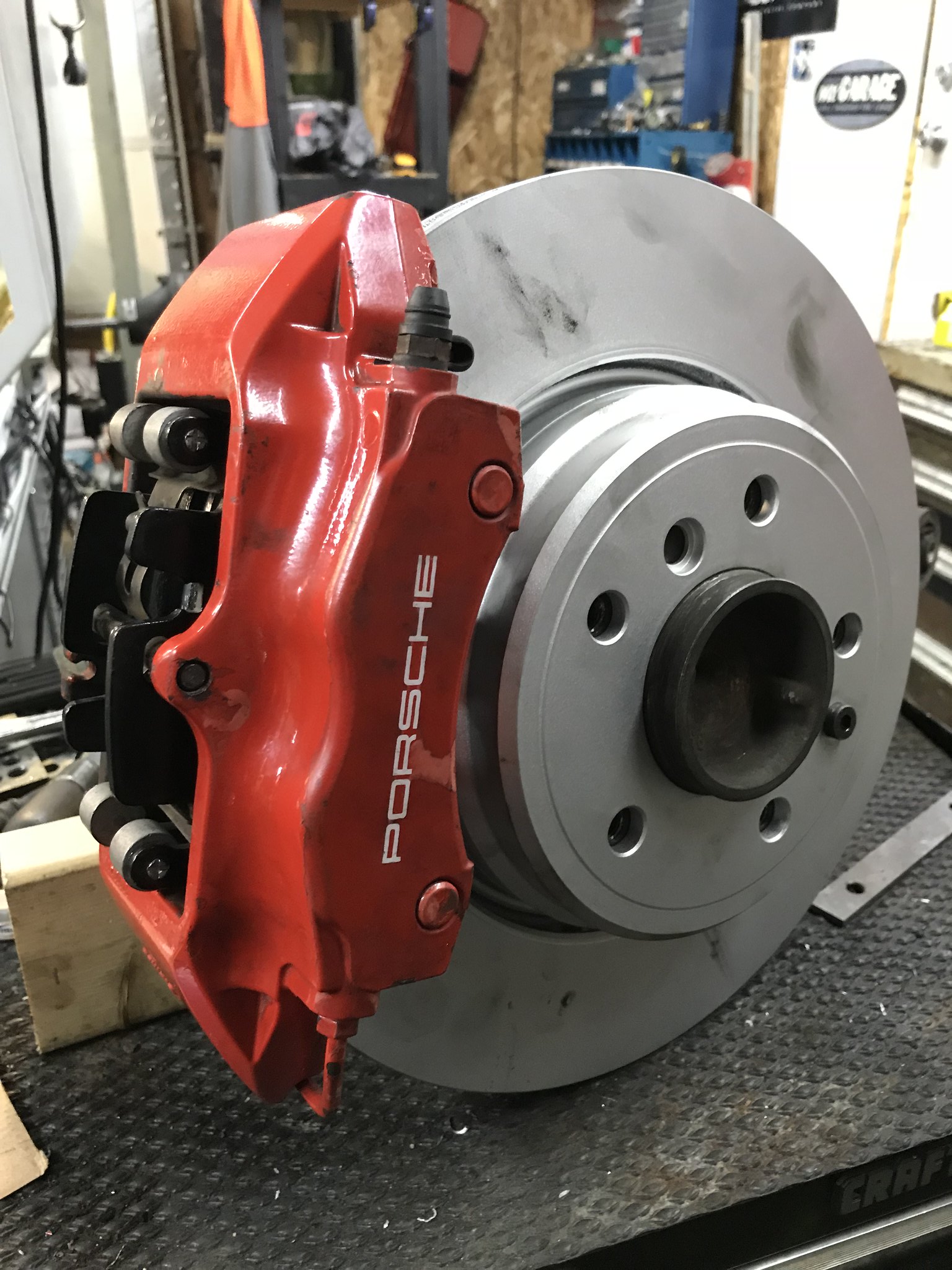

I'm currently looking into doing this using the 996 rear calipers. I offered them up to e34m5 rear discs but the pad sweep was way off. I've just ordered the e38 750 rotors which should work better for pad contact. Will see how I get on with them. If they work then it'll be a case of getting the bracket made up
BenGerman
Posts: 743
Joined: Jun 26, 2016 2:19 PM
Location: MA
Re: Brembo Big Brake retrofit kits for E28/E23/E24
Post by BenGerman »

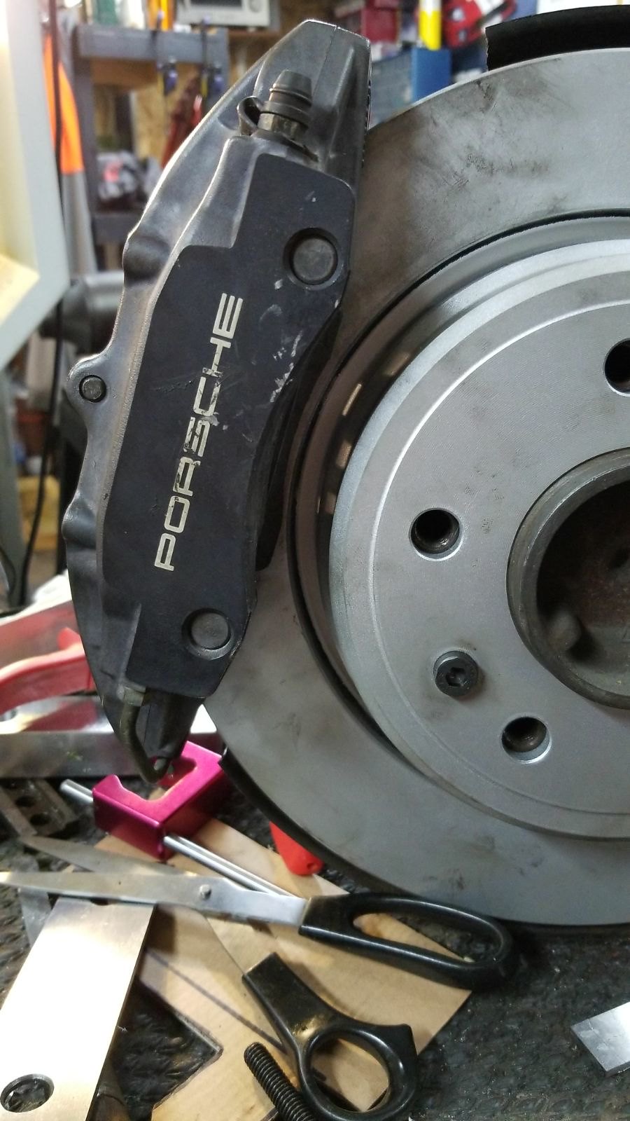

gaza01 wrote:I'm currently looking into doing this using the 996 rear calipers. I offered them up to e34m5 rear discs but the pad sweep was way off. I've just ordered the e38 750 rotors which should work better for pad contact. Will see how I get on with them. If they work then it'll be a case of getting the bracket made up
Interesting, let me know how it goes!
The Boxster with the 300x20mm and the 996 Turbo with the 328x20mm rotors were a perfect fit.
The piston size is the same for all three rear calipers: 996, 996 Turbo and 986 Boxster. The only thing that varies is the pad size and the mounting height.
So in case it doesn't work out, might be worth looking into that. :beer:

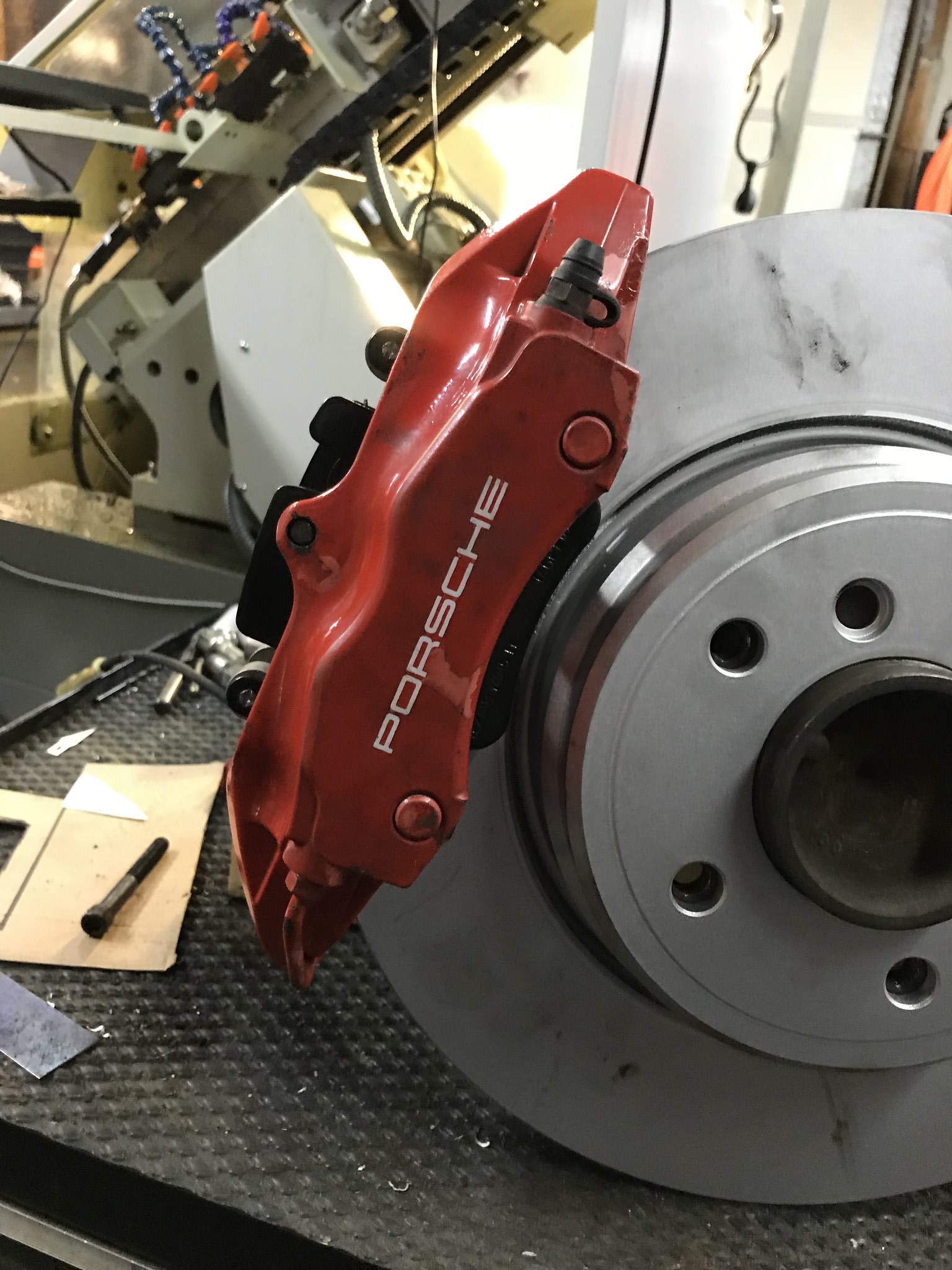

I'll check when i get in tonight to see what 996 calipers I have but from the pics the pads in mine are a bit smaller from memory.

The calipers i have are like the black one in your pic...so normal 996 ones im assuming?
BenGerman
Posts: 743
Location: MA
Post by BenGerman »
The black ones in the picture are the 986 calipers.
What’s the part number on yours?

If you think the OEM caliper is boat anchor and the weight is about 12-13pounds
but dont remember exactly..the Porsche caliper is ~5.6 so here you go you save
5-7 pound of were are added to the larger caliper so its not really that bad if
you think so unsprung weight will remain very very close to the OEM but again
that is very neglected....
The Porsche part# have to check I forgot something 424 421 but need to check
for sure...they are from Boxter S model and purchased them from Porsche junk
yard in TX.
The E39M5 rotor I used is std because my customer did not care about the Euro rotor.
Why the E39M5 set up is win win because the rotor is deep down as opposite
of the E46M3. That sad with the E39M5 rotor you will be able to use variety of
wheels
I noted something I would like to suggest. On one of your pic you have the caliper
a lot of room between the rotor ring top area and the caliper. Make sure you
leave about ~1.5mm so that way the pad will cover all the way the surface ring
and leave no rust ring.
I looked over just like you every single possible avenue but kept coming back to
E39M5 set up with the Porsche calipers because made most sense from money
aspect and also parts availability.

That's very interesting. With the Boxster S front setup you actually don't get a higher brake torque than with the E34 M5 system.
Assumptions: 1000N Input Force, 25.4mm MC, 0.4 Pad Friction Coefficient
Boxster S clamping force: 8,978N
E28 M5 clamping force: 9920N
E34 M5 clamping force: 11160N
Brake Torque:
Boxster S, 345mm rotor: 571,095 Nmm
E28 M5, 300mm rotor: 496,000 Nmm
E34 M5, 315mm rotor: 578,089 Nmm
So your only real advantage is the bigger mass and surface area of the 345mm rotor.

The reason why I'm considering the option of the E46 Rotors is clearance for the calipers to the strut. The wheel choice will be limited, correct.
E39 M5 wouldn't me my first choice for the rotors, more to that further down (E60 550i).
euroclassicmotors wrote: I noted something I would like to suggest. On one of your pic you have the caliper
That is correct, good input. We have considered that later on.

As mentioned above, I don't 100% agree with your choice of the Boxster S calipers.
You are reducing the effective torque that your system can apply. From a technical standpoint, the system is "weaker" than the E34 M5 setup.
Heat dissipation of longer periods of time is where your experience comes in, I can not make any statements in regards of that.
Here is my question to you. Why not run the following setup:
Cayenne 955 calipers: 4430g
Adapters: 200g
Rotors E60 550i: 10,200g
Total: 14,830g
Same weight as the current setup on the car, 4 times the swept pad area, same rotor diameter, 30% more clamping force.
Initial investment is maybe $200 more for the calipers.
The rotors are mass produced, aluminium hat, cheap ($280 for a set) and readily available.
This way you would have a system that outperforms the E34 M5 brakes for sure.

BenGerman wrote:The black ones in the picture are the 986 calipers.
Theres 2 numbers on there
996 352 421 & 20.667.01
I’ll offer the up again on the weekend to double check and get some pics as well

Mocked up a bracket today and offered up the 996 calipers to the e34m5 rotors. Apart from cutting the dust shield slightly they fit quite nicely.
Ben
I checked my caliper numbers and they are the same as your black ones. I think it was fouling the dust shield which is why they didn't fit before.
996 CALIPERS ON E28 https://imgur.com/gallery/w6YH5WE

and mount them on the rotor ring, and now we have 2 piece rotor with aluminum hat
which is so much better than the E34M5 options or what ever else option is.
The fact that the Porsche, Cadillac, AMG name it etc calipers are not available to purchase
sort of "now" or you have to wait till something come up on a deal coming from a wrecked
car or what ever the case might be. Those Boxter S calipers which are at least 5+ year old and will
perhaps need rebuild, clean up from minor corrosion etc. but that does not end.
One wants to restore them and buying spray can from pep-boys for calipers is a patch
to make them fresh..for just about 6 months and then the pain is off...then take them
apart and sent them to powder coating.....so now you are cents away nearly match the
Wildwood of 6 piston calipers Brand New in a Box.
The weight of the rotor will be win win and also the price. Via my SSF or World Pack account
the E39M5 or E46M3 rotor is in hi $170+ range and even the rep says all rotors now days are
made in China, I mean when I purchased ignition coils from BMW dealer for S38 B38
the coil says Made in China so nearly everything is made there but does not mean its bad
it's just the quality won't be as how it was from back in 1992.
The Wildwood Package"
- 6 piston caliper is in 5.25pounds range.
- ~310mm 2 piece rotors. Ring is about 7-11 pounds range,
- Aluminum hat 2-3 pounds including the hardware.
So the package combo rotor+caliper will be no more than
13-14 Pounds at max that put the E39M5 rotor 10pounds
each more per side. Even if build 345mm front and the weight
will grow to max 17pounds not more.
The wildwood brakes system. About 4-5 years ago when I
visited San Diego for family trip I always find and manage to slip
and spent all day at my friend Frank Fahey shop. On his
M6/LS he has wildwood brake system front and back but being
long ago I forgot the spec on the brakes. He gave me a a ride
and I was very very impressed how the car stops.
A year later or so when I completed this car E30M3 S54 https://www.euroclassicmotors.com/1990-hot-rod
I installed this off the shelf kit Wildwood front and back and
this exact front 6 piston calipers. Rear is not what would like to be but
works okay. Wanted my cup of tea more brakes in the back but its just fine.
This E30M3 S54 swap the curb weight is 3050 pounds.
The car stops really well without any brake overheat even driven at the
canyon with anger.
If remember correct the front rotor size is in low 300mm range (298mm)
but again its been years since I complete this and memory is lost.
If personally I were to start all over again of making budged BBK solution/kit
for the older Bimmers I would never ever ever ever touch those eBay calipers
that's for sure....
Just sharing my experience which might be helpful in some way towards your
final destination.
