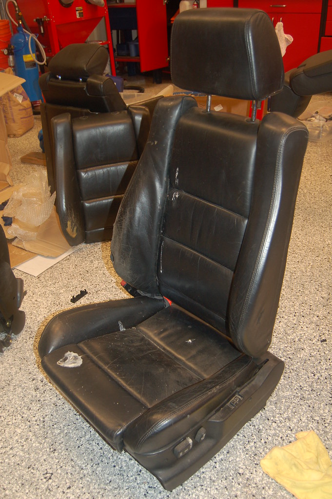

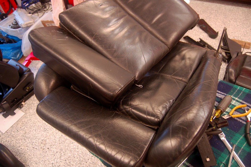

My goal today was to transfer one of the perfect bolsters from the 2nd set of seats I got to the driver's seat of the 1st set. This would make both seatbacks from that 1st set primo. As I said before I didn't really grok that the seat's I was getting via Ireland would be RHD; pretty silly I know. But it turned out awesome because it meant that I have two left hand side bolsters that are in pretty good shape.

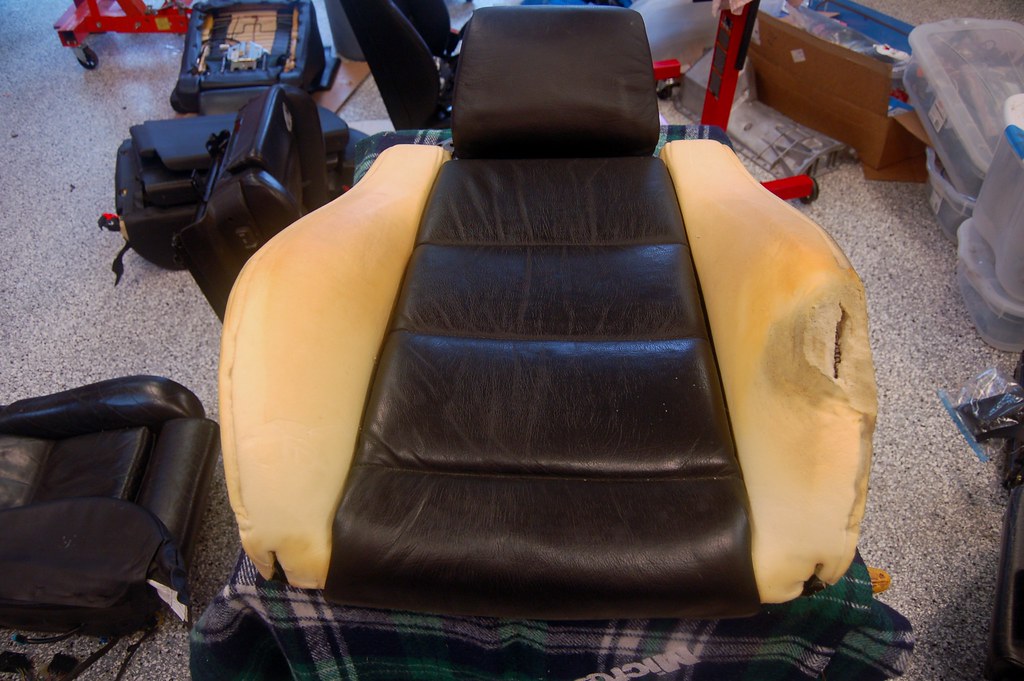

Here's the 1st set's driver's seat 'before':

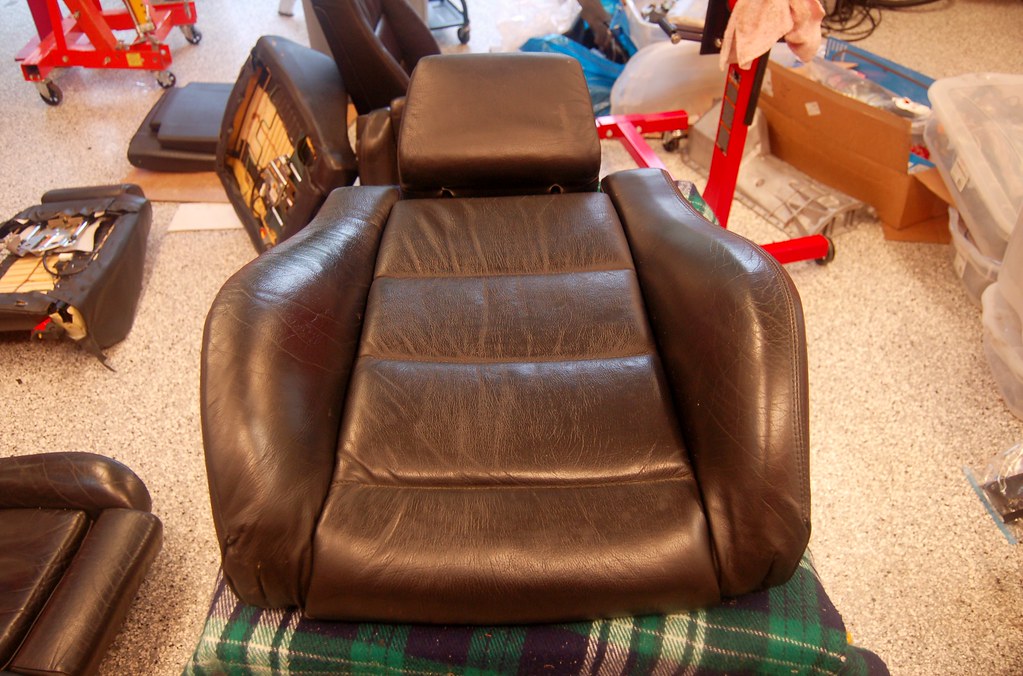

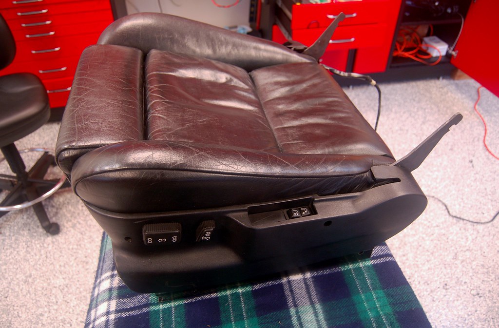

Here's the donor:

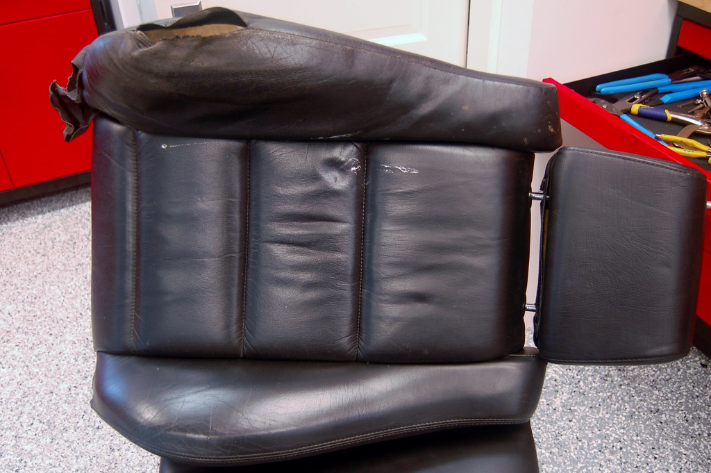

First step was to take the leather off the LH bolster of the good seat. I screwed up and took the RH side off first (I was focusing on the back of the seat, not the front so didn't notice until I had it off...duh). Good news is it was good practice.
The foam is toast too, so that was transplanted from the other seat too.
Ta-da!

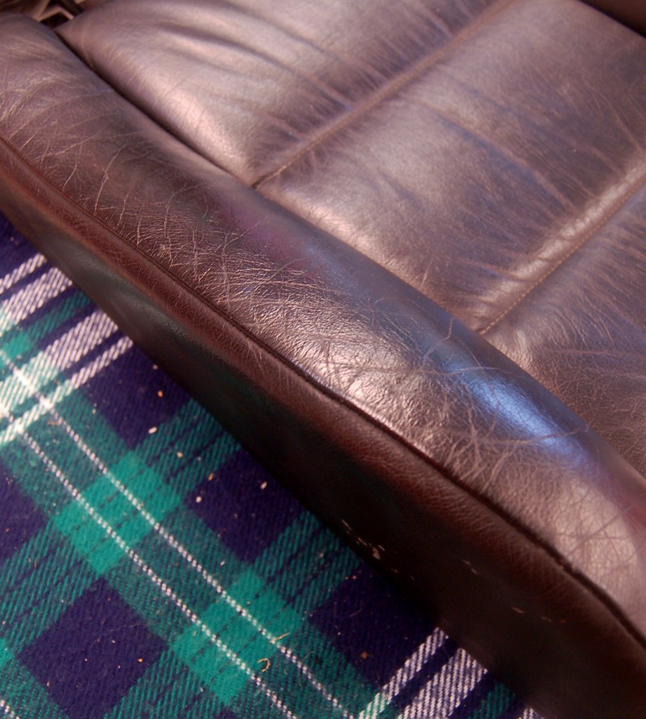

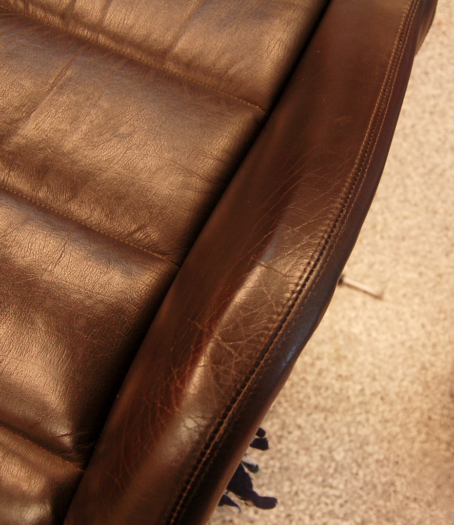

Notice the stitching? I didn't notice until after I'd finished. I didn't notice the 2nd set of seats have exterior stitching on them (while the ones from the later car don't).
Older seats (Europe):
Newer seats (a '95 540 M-Sport I think):
It's too bad. For now I'm just going to live with it. If I decide to recover these seats it'll get fixed (but that seems very unlikely now given how good of shape the leather is in).

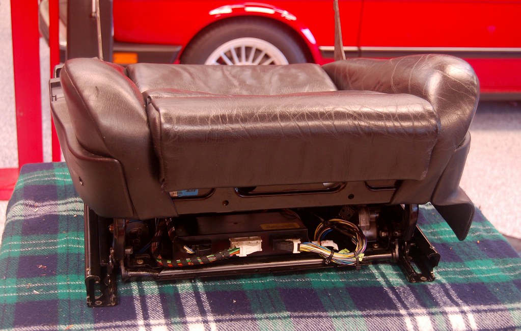

I also decided I was going to transplant the bottom center section from the passenger side of the Ireland seats to my new driver's seat. As you can see the leather of the Ireland seat is in better condition.
Tomorrow my plan is to get the set going in Vlad all tidied up and maybe even test-installed (I need to so some wiring work for the seat-heaters and I know I don't have time for that).
Posts: 9456
cek wrote: I also decided I was going to transplant the bottom center section from the passenger side of the Ireland seats to my new driver's seat. As you can see the leather of the Ireland seat is in better condition.
Well, so much for that plan. The 1st set are heated (and I want that bad). The 2nd set are not. Without completely pulling the leather off of the center section; removing dozens of staples, there's no way to transplant the heating element.
I could probably get it all back together again, but I'm sure the leather will not be as tight. It appears the staples are put in with some sort of tool that causes them to expand and I don't have a means of doing that.
Oh, well, the center section there now is actually just fine; the other one is better, but not THAT much better.

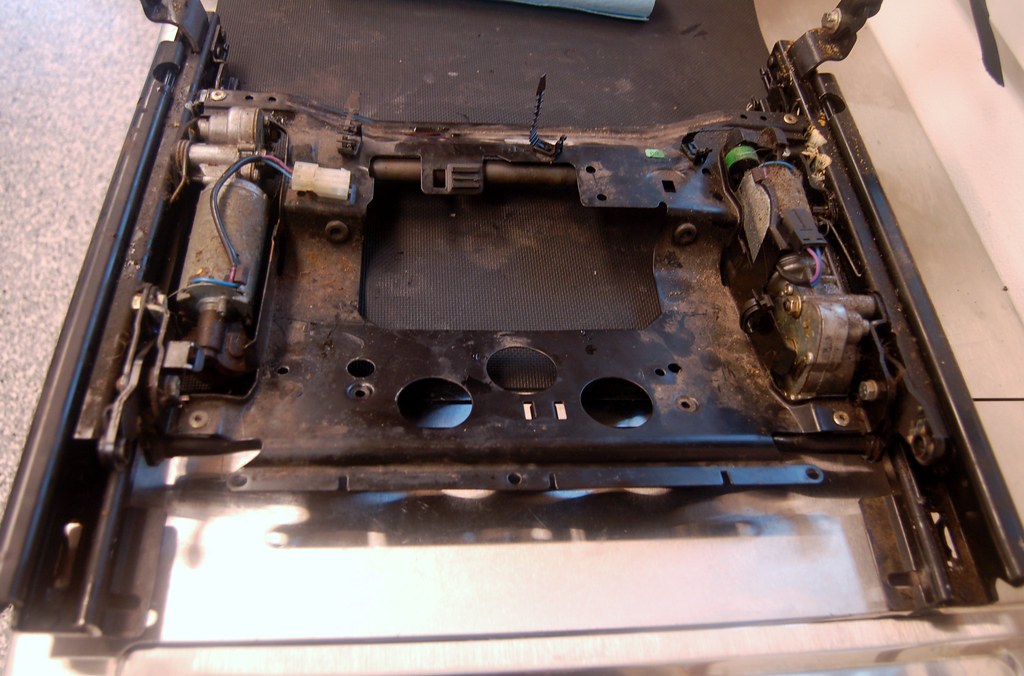

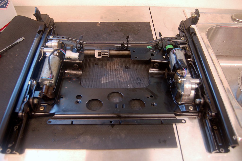

Driver's seat mechanism. Before.
After.
Posts: 9456
I have the driver's seat all back together. Everything is tested and ready to go.

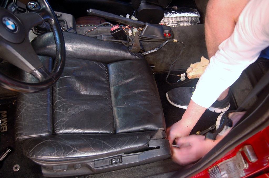

Woo-hoo!

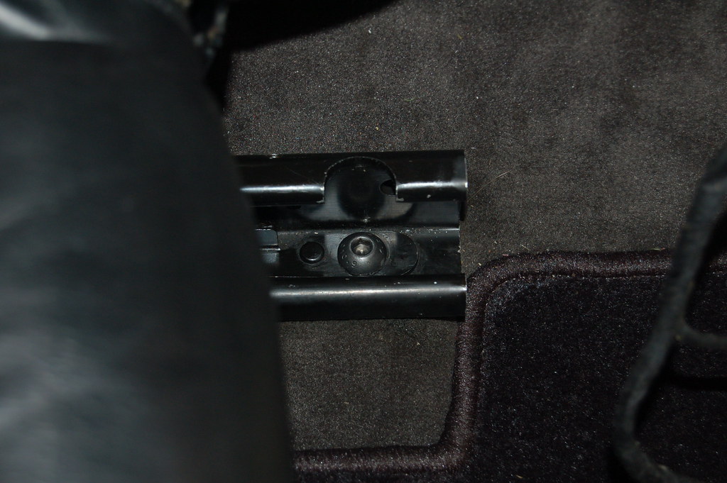

Got the driver's seat installed today. Man, it is fantastic to (a) not driving in a rocking chair and (b) having the more comfortable E34 seats.

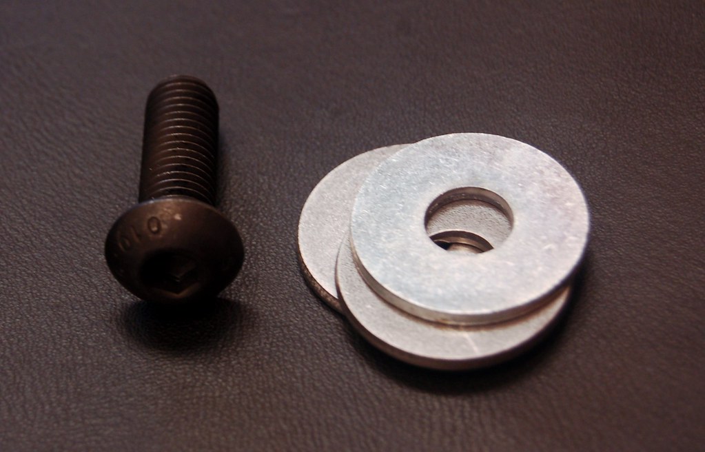

From reading other's threads on installing E34 sport seats I knew the factory bolts would not work; they sit too high in the E34 sports seat rails and interfere with the seat moving forward/backwards. ACE hardware to the rescue: rounded hex head bolts:
Also, since the E28 seats have elevated pedestals on the rails that attach to the frame, some washers are needed on the front of the E34 seats to ensure the rails sit above the carpet. I ended up using two per side.
My handy-dandy son did most of the hard work :banana:
Tomorrow I'll drop in the passenger seat. Right now I consider the fitting "rough". I have not wired in wire for the heated seats and have not removed the wiring for the E28 seat switches. Also, the center console and e-brake boot that I bought from Mike in Seattle will be recovered.
I love it when a plan comes together...

You seem to have the same safety problem I have: the top seat belt mount is to far forward in reference with the seat. What's your view on that?
Posts: 9456
DMS wrote:You seem to have the same safety problem I have: the top seat belt mount is to far forward in reference with the seat. What's your view on that?
The seats are pretty far back (all the way?) in these pics.
There's nothing different here compared to the E28 seats.
Mountain out of a mole-hill?

I've similar E34 seats in my E12 and I'm a tall guy. Made a new mount bracket so the seats are at my prefered position low and far back. The problem I've is that the belt is about 3-4 inches loose of my shoulder. I'm renovating the car and was hoping others had thought about this as well. Since you seem quite concerned about your savety I hoped you'd be one of them. But if it's not an problem for you, there is no need fixing it :)

I can totally see how that would be a problem for you, especially if you had to mount your seats further back. For me, where I have the seat positioned, the seatbelt is touching my shoulder when I drive.

The different stitching is called french stitching. It came in the ///M5s. The rear bench gets it too.
The other seats, as you know, are out of regular 540i/6 or M-Sport.
