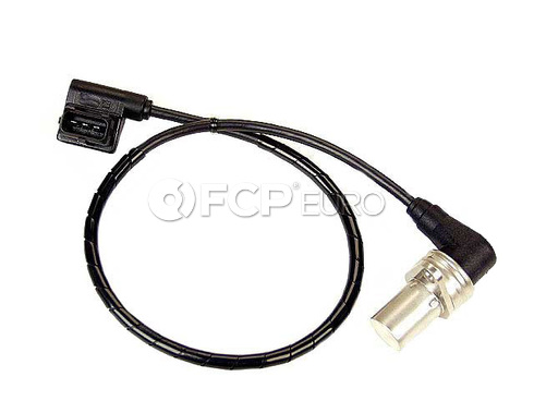

Spen wrote:D Unit, I just purchased a B35 E34 535i powered BMW and the issue was the crank position sensor came loose from its mount and rubbed against the balancer and fried the ECU. The shop it was at said the engine needed to be dismantled to find out why. There is a BMW TSB Technical Service Bulletin that states that the crank position wheel must be checked for tightness every time maintenance is done. The book says 1mm of clearance.
I cleaned the aluminum mount and added locktite and tightened it down nicely using a feeler gauge set to a sandwich of about 1mm.
In no way am I saying that this is your issue, all I am saying is the one fellow who commented about the crank position sensor proximity to the harmonic balancer pointed out an incredibly important point about the B35 fuel management design (to check tolerance ~1mm) and to make sure it's tight.
Your troubleshooting so far seems very thorough. I will re-read and see if I can contribute anything worthwhile other than this chime in tidbit.
Just to be clear, this is the crank position sensor, right?
12141720857, 12141720853, 12141714763, 12141710519
https://www.fcpeuro.com/products/bmw-cr ... 2141720853
There's a 5mm allen bolt that holds it down. I turned it so tight I'm afraid I'm going to strip it. It was oily as shit tho... caked with oil. Do these go bad? Is this another maintenance sensor?
Re: e23 progress... (NEED HELP pg. 4)
Yes, that's the crank sensor. One thing I do know about those is not to use a Febi.
