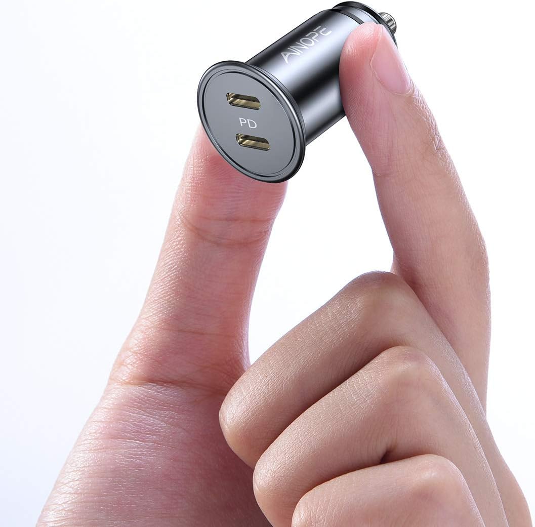

This was my favorite cig-lighter USB-C adapter, but it's NLA, apparently. I liked it because it fit tighter than the Aukey version.
https://www.amazon.com/gp/product/B07M8 ... =ceklog-20
Gonna try one of these instead:
https://www.amazon.com/dp/B089R67JV4?tag=ceklog-20
