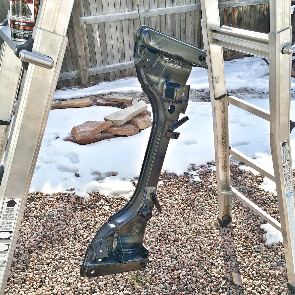

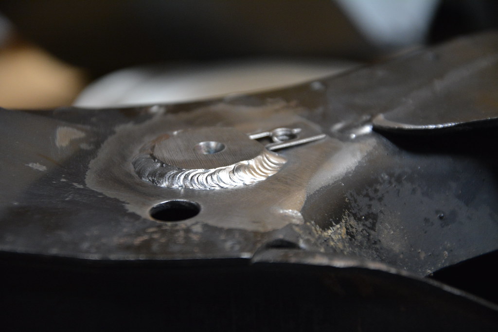

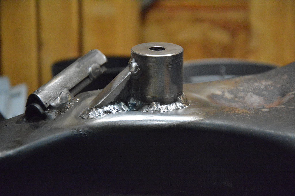

Today I had the chance to weld the dowel to the subframe. I made a little triangle for more support real quick too. Not super happy with the welds. I had to use a ton of current to penetrate the thick dowel, and the rod I had on hand was too thin and just burned up before I could dip it in the puddle. Turned into a bit of a fight with the weld puddle :hitler:
lighting up
ImageDSC_4381 by ericandshovin, on Flickr
ImageDSC_4357 by ericandshovin, on Flickr
ImageDSC_4332 by ericandshovin, on Flickr
bottom finished.
ImageUntitled by ericandshovin, on Flickr

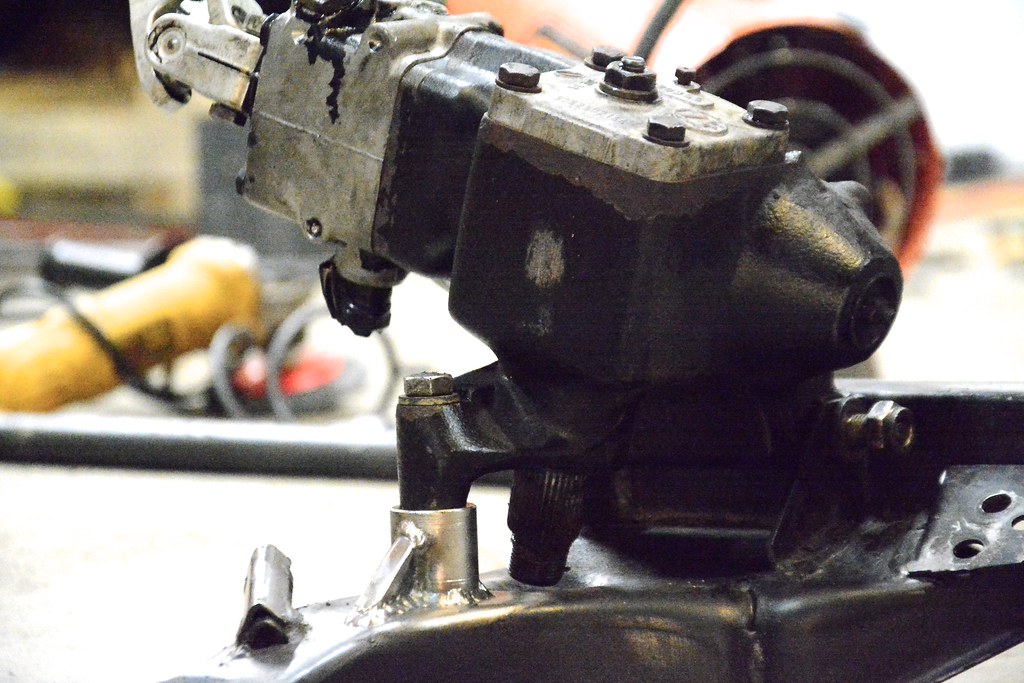

Cleaned up the welded area with a wire wheel just now, and did a quick test fit.
Here is the bottom of the subframe. Note the tinnerman nut can never be removed, but I still have it in place so the splash guard can be re-mounted. This was probably my best weld, even for the small bit I did with my non dominant hand.
ImageDSC_4421 by ericandshovin, on Flickr
Here is the business end.
ImageDSC_4427 by ericandshovin, on Flickr
I could make a ton of excuses for the ugly welds... Not enough current to penetrate the thick dowel. Using filler rod that was too thin so it burned up before laying in the weld puddle. Using filler rod for acetylene torch instead of proper rod. No experience welding hot rolled steel. Shitloads of smoke from oil/gunk/road grime inside the hollow subframe pouring out of every nook & cranny. Being rushed for time...yada yada. I know I have the ability to lay some decent bead, here is a pic of aluminum vertical up I did earlier this year. Truth is, I just need more experience to deal with all these different variables!

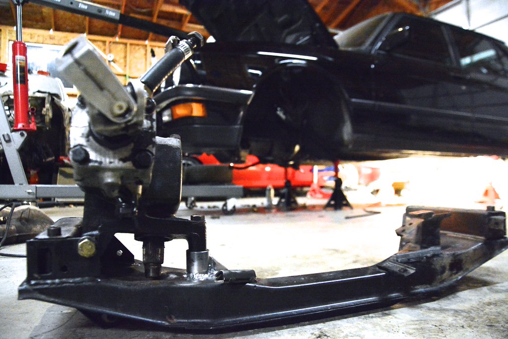

Test fit... Fits perfect! This is also a good visual of what I was explaining a few posts above about the load placement on the two mounting points. I'm pretty sure my new mount will have less side to side flex compared to the OE mount.
ImageDSC_4443 by ericandshovin, on Flickr
From another angle.
ImageDSC_4450 by ericandshovin, on Flickr
