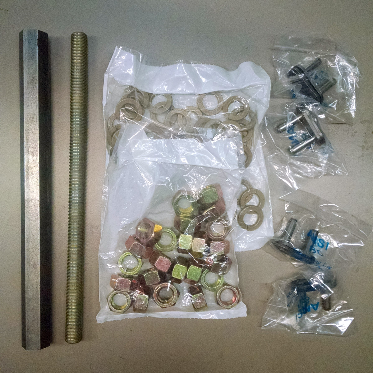

Well, perhaps maybe I could explain what they are. It might be buried in the ridiculousness I'm sure to write under this line.
Mr. Lift uses two chains that run from the bottom of each carriage to the top of the other and run through a baseplate (stolen) which goes between the two columns. Each chain is run along rollers on bearings at the bottom, then up, over a roller at the top and hooked to the top of the carriage. This is done to "equalize" the lifting of the two carriages. Most modern lifts use steel cables for this. This one uses chains and back around the time this lift was made, Mohawk had already introduced their hydraulic equalization which uses a bunch of different valves and what not to reroute hydraulic fluid through a series of tubes (aka the Internet) to keep everything in the same position relative to each other and not have an obstruction top or bottom (hydraulic line can be routed in the floor or up against the ceiling if that floats your boat). In fact, no current Mohawk lift uses chains or cables or string or noodles to tie anything together, so if you call them and are lucky, you can get the one guy who remembers the days of chain and will happily tell you they have no parts. They were all sold on Storage Wars.
Now that you know how that works...
I was surveying the rest of the parts of the lift strewn about my house and it occurred to me that two pieces were missing (aside from the parts that I already knew were missing). I had two ends for the equalizing chains, but there should be two more.
Oh, well, there you go. I call up the folks at Mohawk and after the "It's a what model? Do you have a serial number? Where did you buy it? Huh? This isn't a Mohawk if it has chains." Then once I talk to someone else, that's how I found out Dave Hester bought it all and then Darrell got mad or something. Yuuup! "We haven't had that chain in 20 years." That's great, except there's a guy in Vermont that has the same damn lift in his basement (!) that bought this part I need from you two years ago and he had it in a couple of days. "Yeah, well, that's two years ago."

So, I plan to swing by this machine shop to ask about having one of the parts I already have duplicated and then it hits me. Somehow, this has to be adjustable. There has to be a level of adjustability to account for things that can be adjusted away. So, I get on the texting horn to the guy in VT and ask him about the part he bought. Turns out, it's about 6" long and has 4" of threads for her pleasure. I think. I might have read it wrong.

The parts in the bags are the new end links for the chains. I was missing two already and I destroyed one trying to remove it from the pictured pin, which was not a fun job, but I got to use a torch, despite it not actually working. I also got to spend two weeks trying to replace a screwdriver at eight different Sears locations.
Basically, the idea is to have something to anchor the chain to, and then have it be adjustable so as to ensure the carriages lift as equally as possible.
