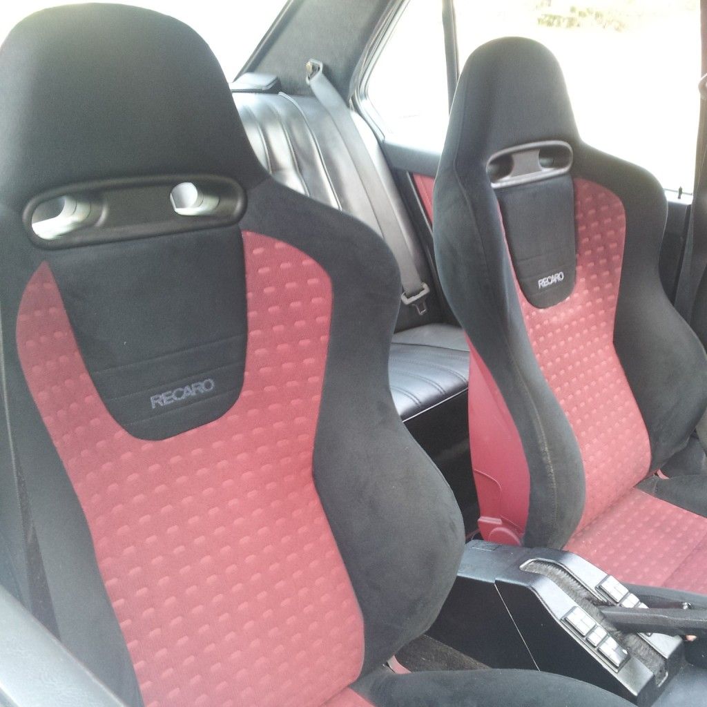

I think I recognize those seats. Those two-tone red and black seats in the pictures were done up here SF at several wrenchfests by someone who was right around 17 at the time. He was really trying it out as an experiment. It looked much better in person. His next project car after that E28 was a Miura so it's hard to question his taste.
Red interior is a polarizing issue. The first time I saw a red interior was in a red on red Ferrari 308. I got to drive this thing and the whole time I was thinking about how bad it looks (I was 22 at the time). 20 years later, I have a red and black M5 now.
The shade of red you choose really makes all the difference. Stick with the darker shades if you're going to cover a lot of the interior in red.

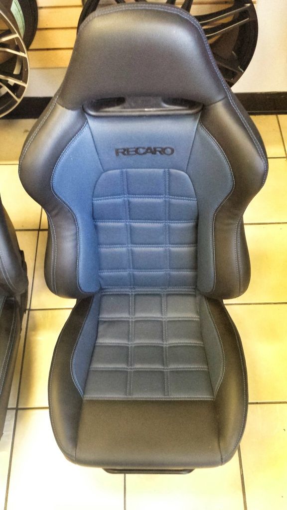

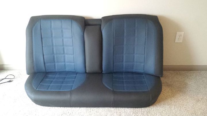

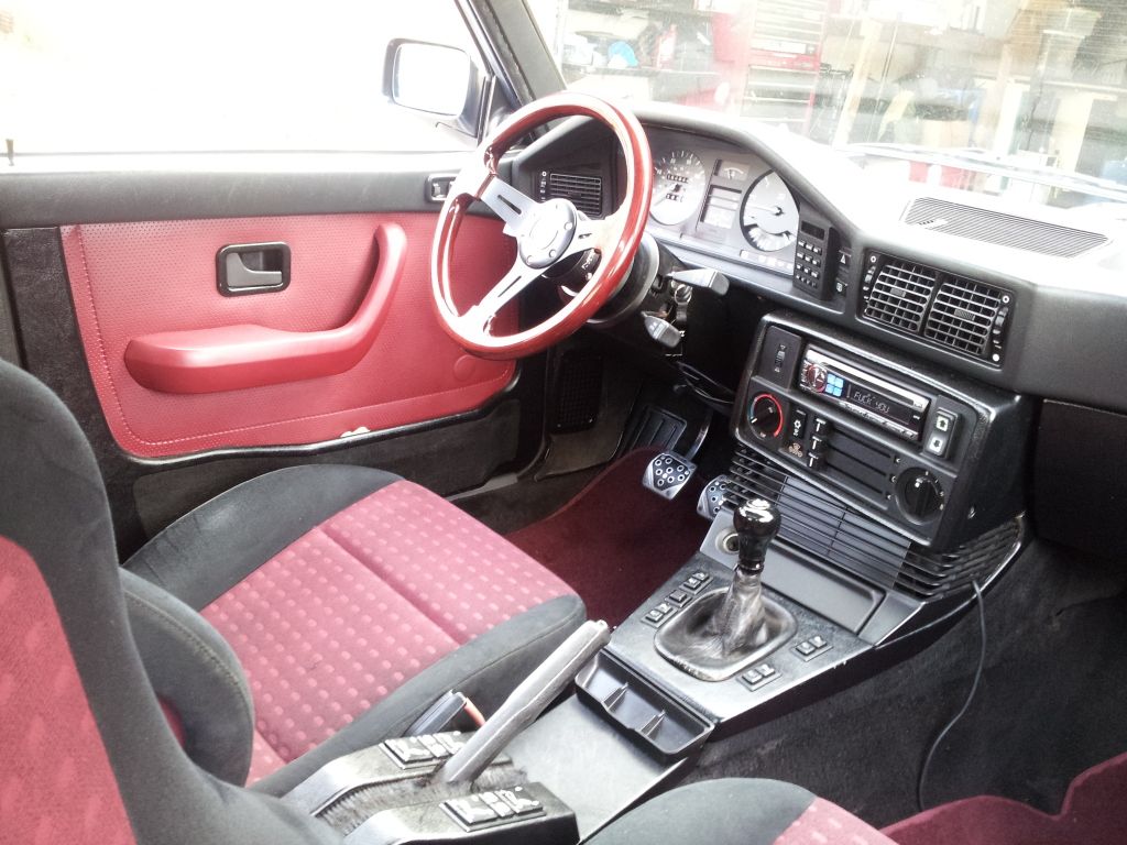

The first picture you posted isn't too bad. The color of red is beautiful but really isn't age or model appropriate to the car. Also, the pattern of the floormats take away from the quality of the seat work & the red carpeting on the door pockets doesn't tie into the carpeting throughout the car. The bottom dash & center console pieces should match or blend instead of contrast. Overall this interior gives me Michael Jackson Thriller video flashbacks...lol

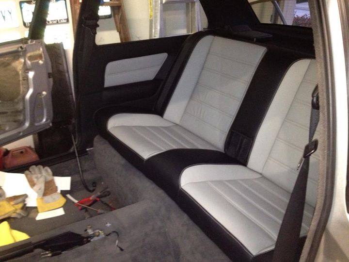

The second picture is spot on with the vintage BMW colors and is a pretty good example of not overdoing the basic two-tone approach. It just flows well for the age of the car.
The next batch of pictures, the main issue I see is the random bits of red on the console pieces in an effort to 'tie' it all together. It gives more of a feeling of indecision. In my opinion the seats are good example of what I mentioned above...too rigid of lines to pull off this look, to me it just looks flat.

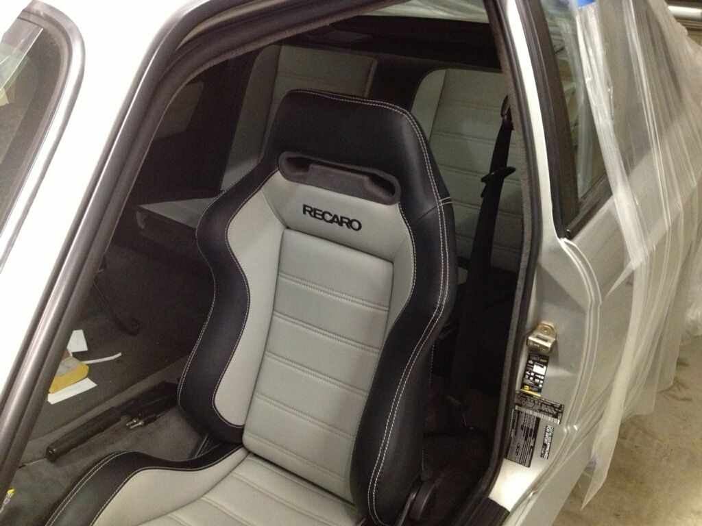

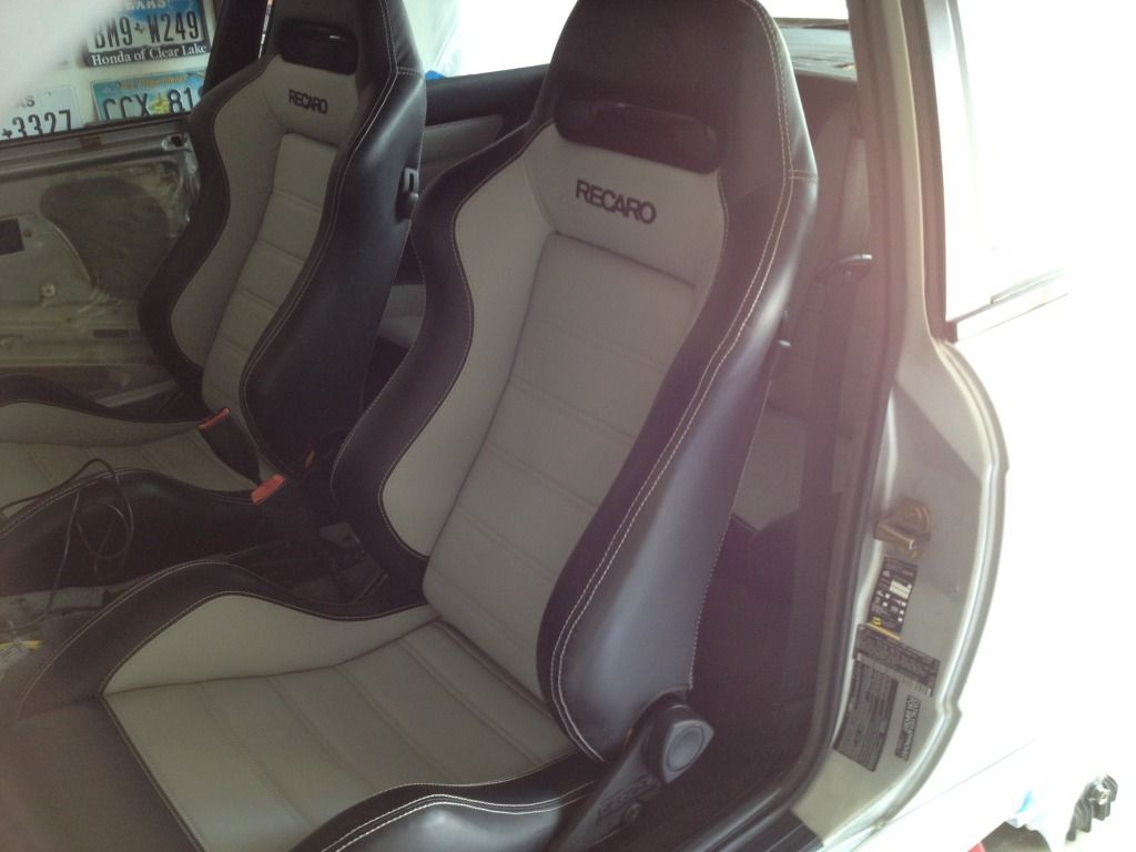

Here are some pictures to lead you in the direction me & my buddy just went with our interior builds that suited what we wanted to accomplish:
His is an E30 M3 with custom done recaro speeds & a stock rear seat:

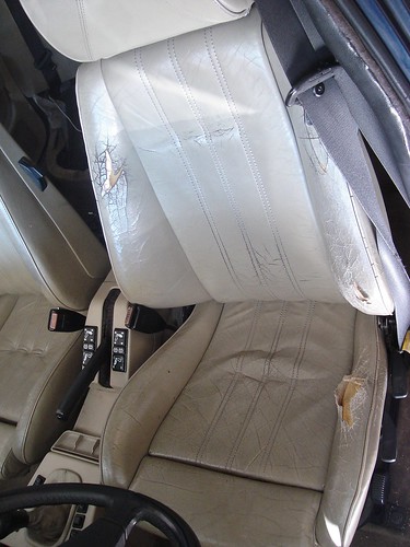

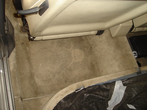

Here is what my interior started as:
Driver side
Driver Seat
Driver rear
Passenger rear

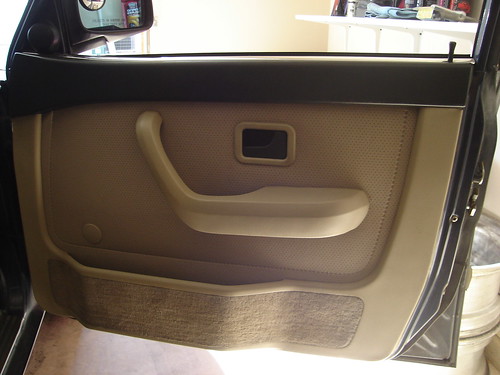

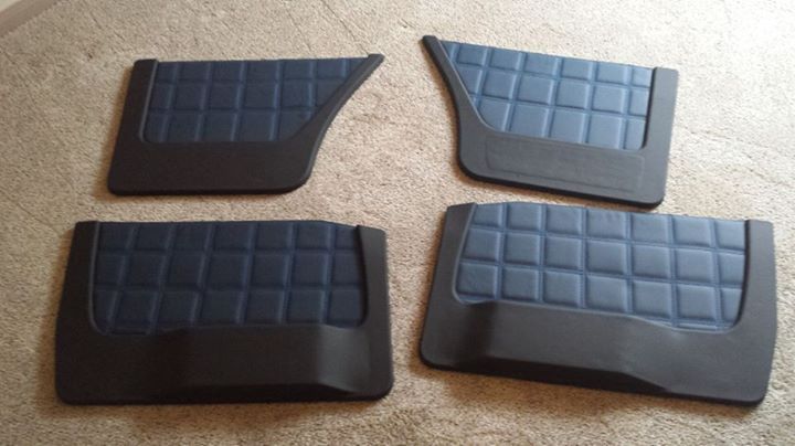

All the door cards are in the same condition which is pretty great. I need to track down some plastic door handle trip trim pieces but nothing alarming.
Here is where I took it:
And this is what is waiting to be put back into the car:

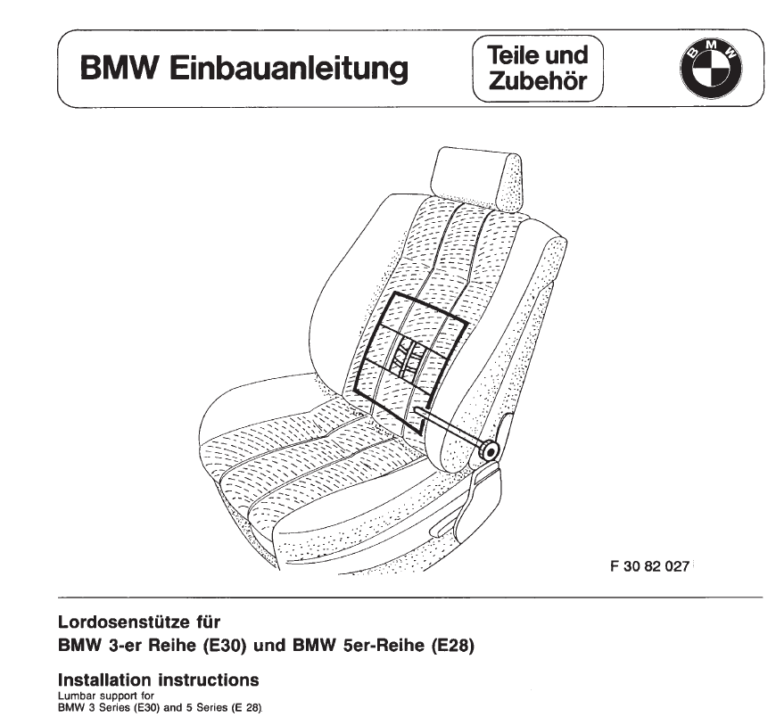

wkohler wrote:The extra lumbar support is one of the biggest things you notice.
That can be remedied in an e28 but prolly only the comfort version seat.
I'm a big fan of Lundberg support

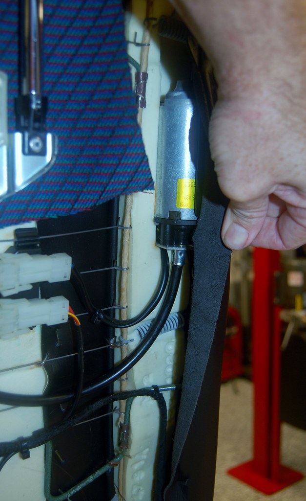

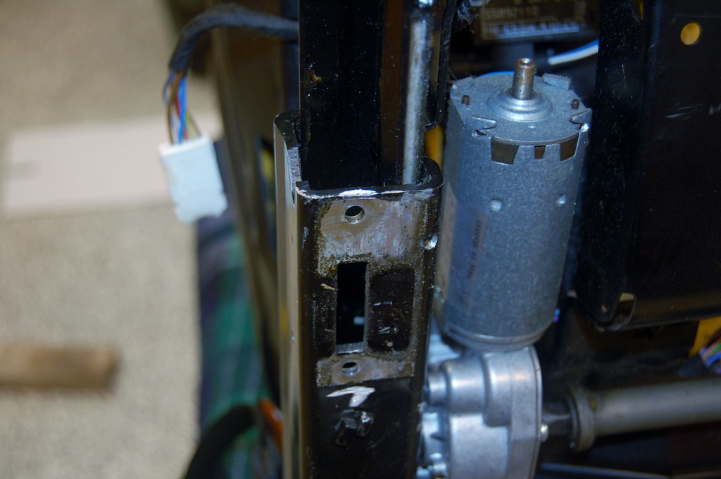

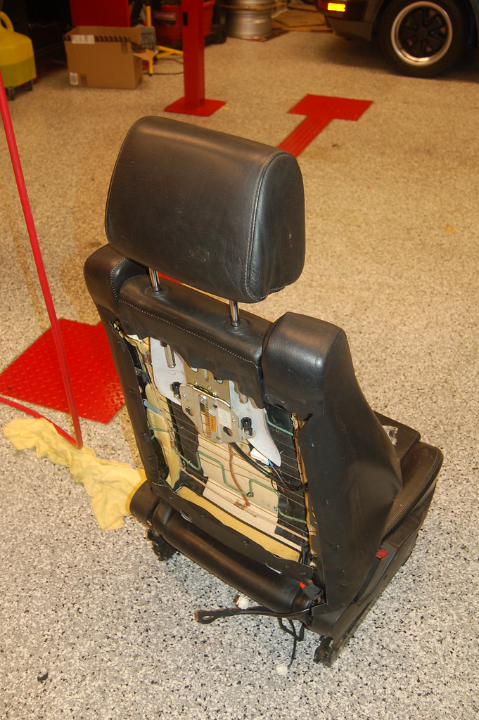

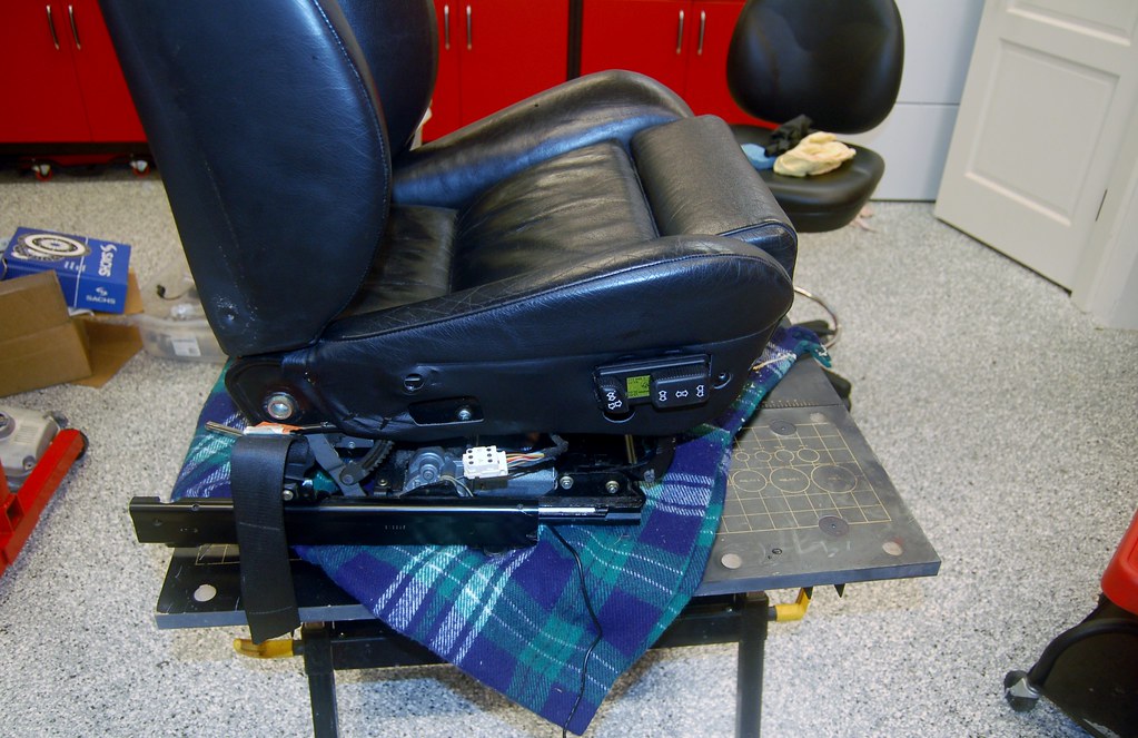

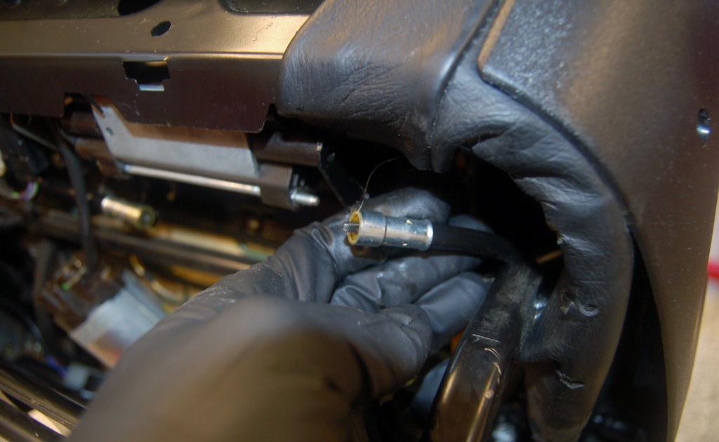

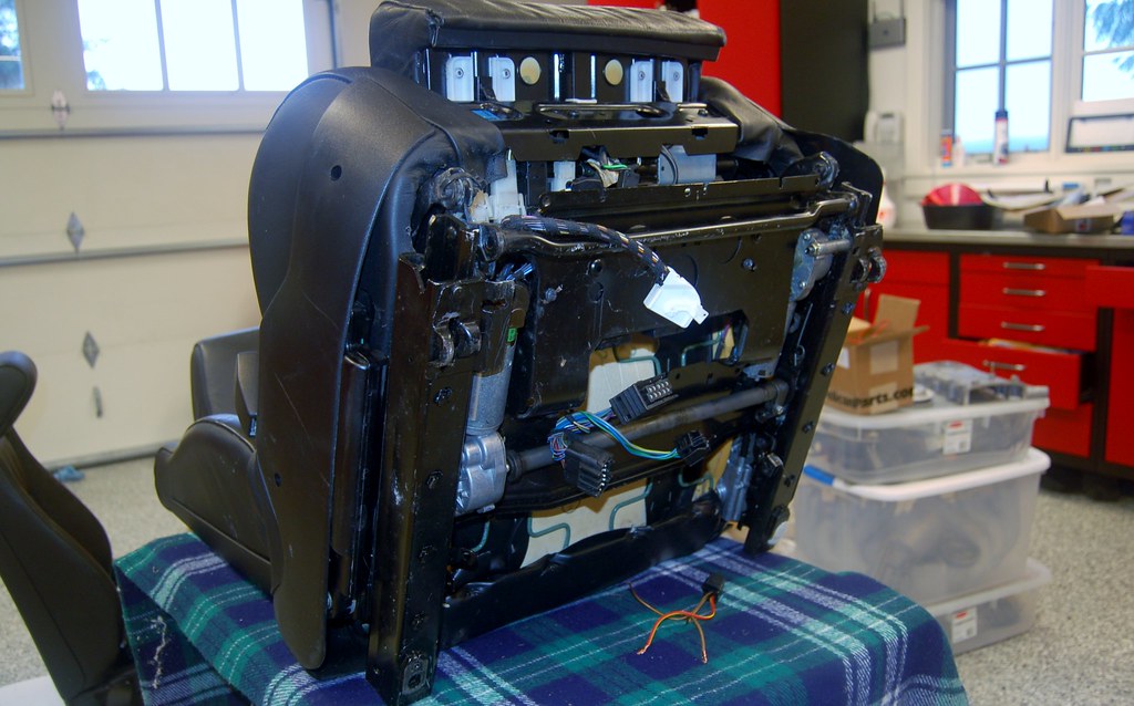

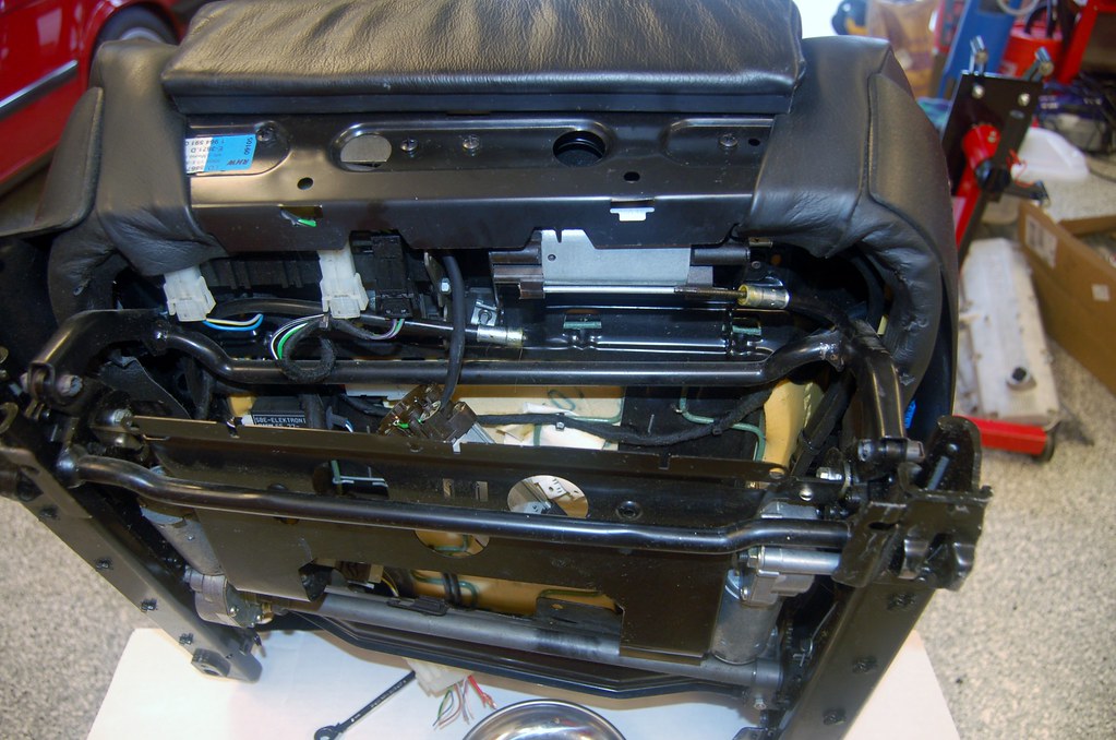

Today I dug into the passenger seat. I figured since it has power I could make progress on it quickly and then I'd have more experience and confidence to deal with the driver's. Note I actually have another set of seats inbound and I plan on restoring both sets to like new condition. I'll keep one set for Vlad (the better pair :-)) and then sell the 2nd one. Given how hard these seats are to find, I'm pretty sure I can recoup a lot of my cost by selling the 2nd set.
The first task to was to fix the twist in the seat. I searched the interwebs and found several Youtube videos that show how to "untwist" E34 seats. Also this link: http://bellsouthpwp.net/m/i/miales/seatcablesfix.htm
It turns out the cluprit are the cables from the motors to the actuators. Over time the rubber/plastic of the cable sheath expands, lengthening the sheath. This causes the inner wire that actually does the work to be too short, pulling out of either the motor or actuator.
In this picture you can see one of the cables and note that the inner wire is just barely sticking out of the end of the cable. It should be about 1/2 inch.
To fix this you have to take the metal sleeve off the end of each cable (at the motor; there are 4 cables under the seat) by heating it up with a torch, cutting the sheath about 3/8". Then you heat back up the sleeve and slide it back on. The hot sleeve slides over the sheath and when it cools and contracts it's tight again.
The hardest part of this job is getting the 8 8mm bolts off of the electric motor mounts so you can pull the cables free. Two of those bolts are hard to reach and it's just tedious. A racheting wrench helps big time.
Once you have the cables fixed you use the seat controls to cause the seat to move back into alignment by leaving one side of the motor disconnected and then the other.
In my case the seat frame actually became bent because of the twisting and while I was able to straighten it some by sitting on the seat in the garage it won't go completely straight until I install it in the car and bolt it down.

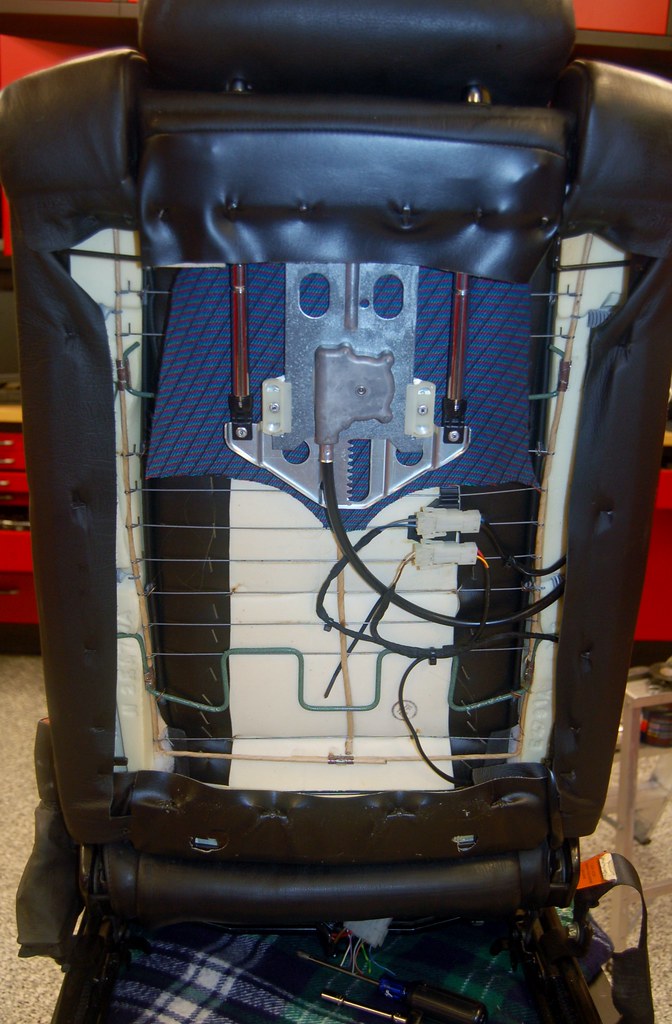

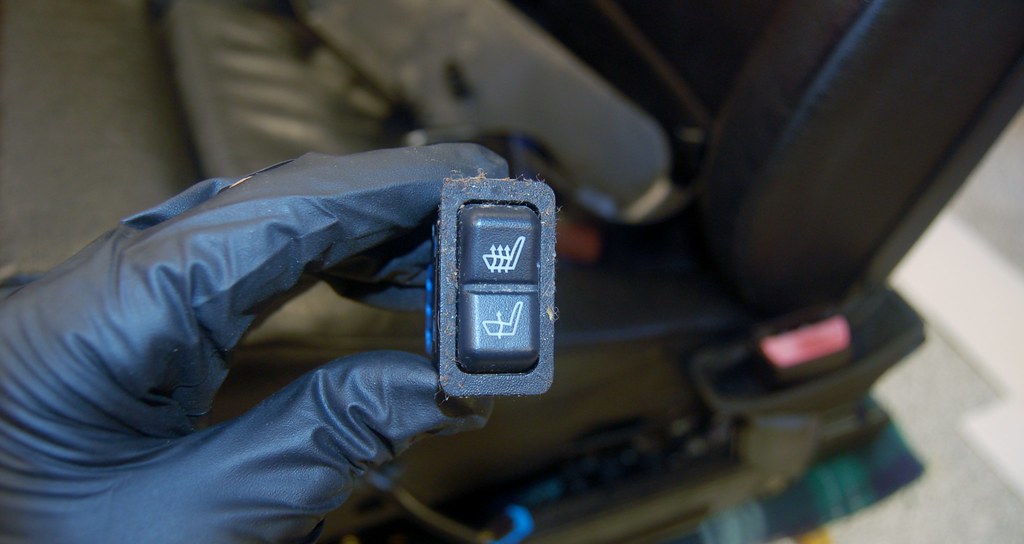

The headrest was inop on this seat too. It turns out for the same reason the seats were twisted: the cable for the headrest motor/actuator had lengthened. Taking the back off of the seat made it clear that the procedure for fixing was the same: unbolt the motor, pull the cable free, pop the metal sleeve off, remove the inner wire, cut the sheath, put the sleeve back on, put the wire back in (putting a little new grease on it), reattach motor.
After fixing the cables, I pulled the side plastic pieces off to (1) clean everthing and (2) see exactly how the seatbelts attached.

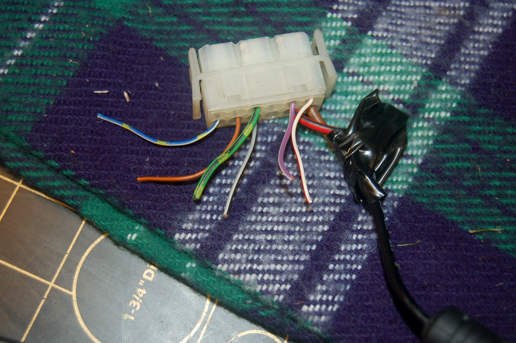

To test/operate the seats on the bench I found an old laptop power adapter that output 12V/5A and used it. These seats are supposed to have a 30A circuit, but I doubt they pull anything near that unless you are actuating multiple motors at the same time, so this technique works fine.
Right now I'm pouring over the E34 ETM to determine what else I need to wire up besides power. This is the connector for the passenger seat:
Brown (BR 2.5) - Ground
Red/Black (RT/SW 2.5) - 12V 30A Hot Always - Main power
Green/Black/Yellow (GN/SW/GE 2.5) - 12V 30A Hot in Run and Start - Heated Seats
Gray/Black (GR/SW) - Lights on.
Brown/Orange (BR/OR) - Seat belt switch
Blue/White/Yellow (BL/WS/GE) - SRS (Seatbelt Switch)
Violet/White (VI/WS) - Seat Occupancy Detector
White/Red (WS/RT) - SRS (Seat Occupancy Detector)
The 87 E28 ETM shows the following (5200-1):
Red/Yellow (2.5) - 12V 25A Hot Always - Fuse 4 - Main Power
Green/Red (1) - 12V 16A Hot in Run Only from Unloader - Fuse 13 - Heated Seats
That page also shows, but I think these are internal to the seat:
Red (1.5) - Not used
Green (1.5) - Not used
Yellow (1.5) - Not used
Red/Yellow (1.5) - Not used
Page 6131-0 of the E28 ETM shows "SEATBELT SWITCH" has BR/RD on one side and BR/WT on the other. Anyone know which lead in the E28 seating loom is for the seatbelt switch?
I will splice into the Gray/Red lead that goes to the ashtray light to hook up to the "Lights on" function of the seats so the buttons are lit. I need to do this anyway for my illuminated shift knob :-).
Fuse 4 is shared with the lighter, SLS, and the antenna. Given Red/Yellow is the same gauge wire and I don't have SLS I think the 25A circuit will be fine to power the main (Read/Black) on the E34 seats.
However, Fuse 13 is only a 16A and uses only "1" gauge wire. Given on the E34 an ENTIRE 30A fuse is dedicated to the heated seats (Fuse 16) I think it's safe to assume the E34 seat heaters draw a lot more than the E28's. Thus I will run a new 30A lead from the battery to power the new seats' heaters, unless I can find another unused wire to do this. Ideas appreciated.

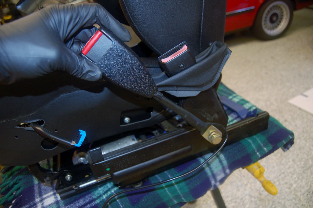

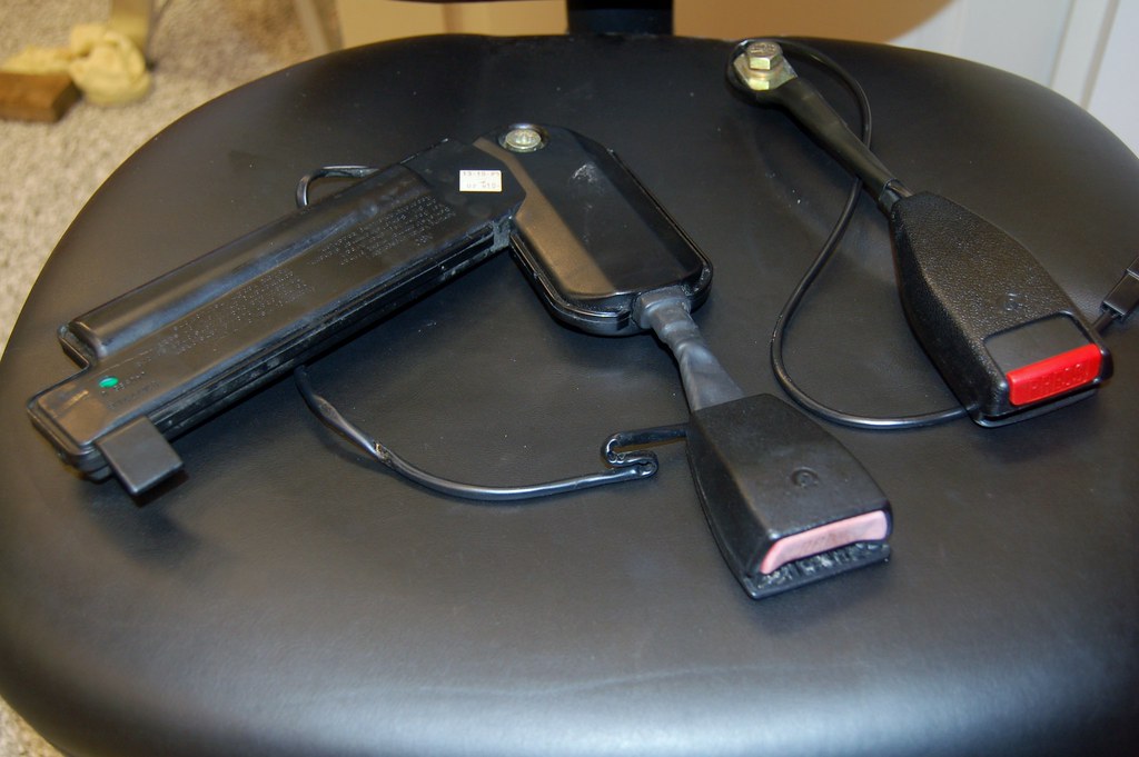

The E34 seatbelt receiver accepts the E28 belt.
The E34 receiver has a pre-tensioner that improves safety by tightening the belt when in a head-on accident. It's a purely mechanical system self-contained in the belt assembly.
E28 on right.
E34 on left.
The E34 receiver's have the same disgusting looking pink-aged plastic. This will not do.
So a dilemna: Use the new E28 receivers and be less safe, use the E34 receivers and be safe, or buy NEW E34 receivers and waste money?

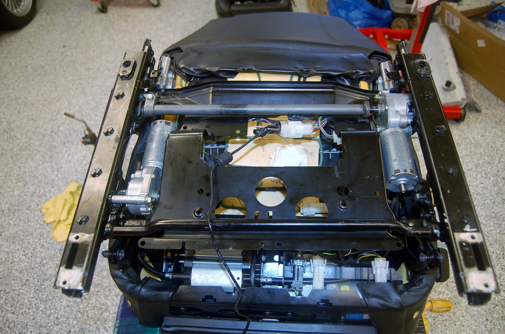

I started the day finishing up work on the passenger seat. It is almost pristine now. The leather could use a light dying, but now that I've cleaned, greased, and tested everything it is basically as good as new.

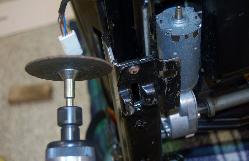

While I had it up on the bench I decided to go ahead and grind off the front mounts that are E34 specific. I'll have to wait to test fit it before I can precisely locate where the bolt hole should go. I used my trusty die grinder to get the E34 mounting thingies off:

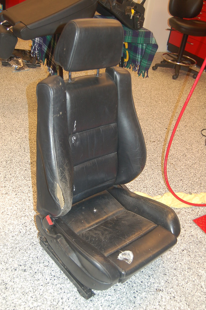

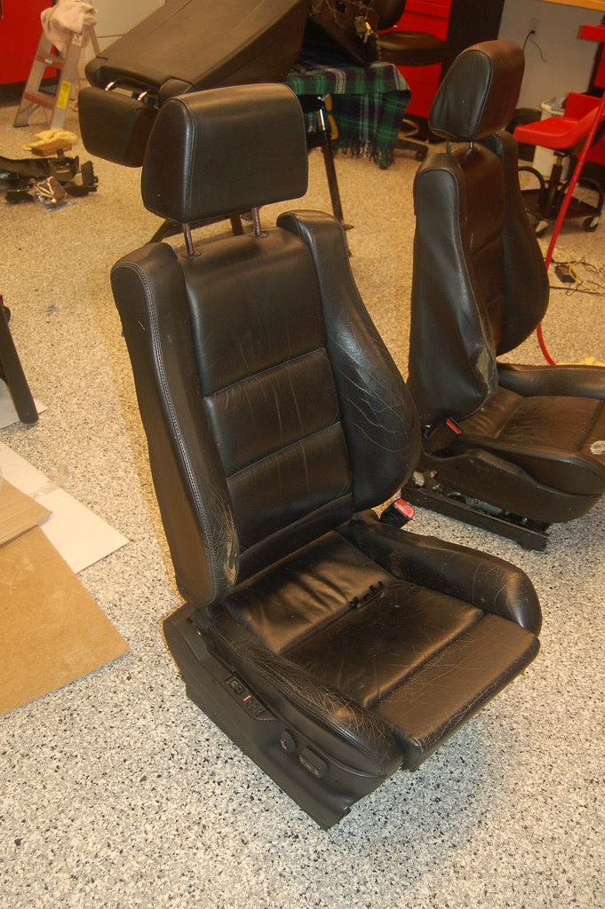

Like most cars, it's clear the car these seats came out of rarely had anyone but a driver in it. The driver's seat has more gunk and grime under it and the bolster is badly worn.
However, it should clean up fine.

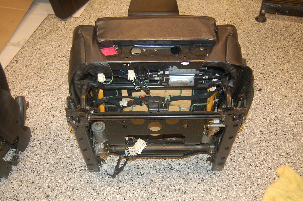

The big question is "does it work"? 87Royal, who shipped me the seats was unable to get it to function by applying power & ground and neither was I when I first tried.

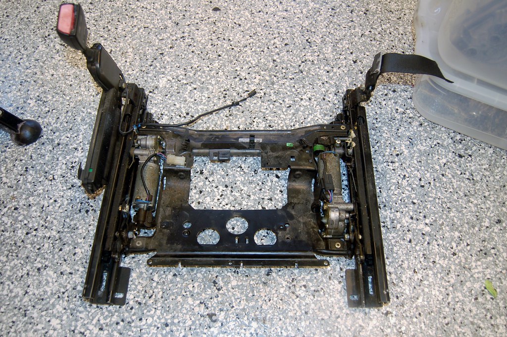

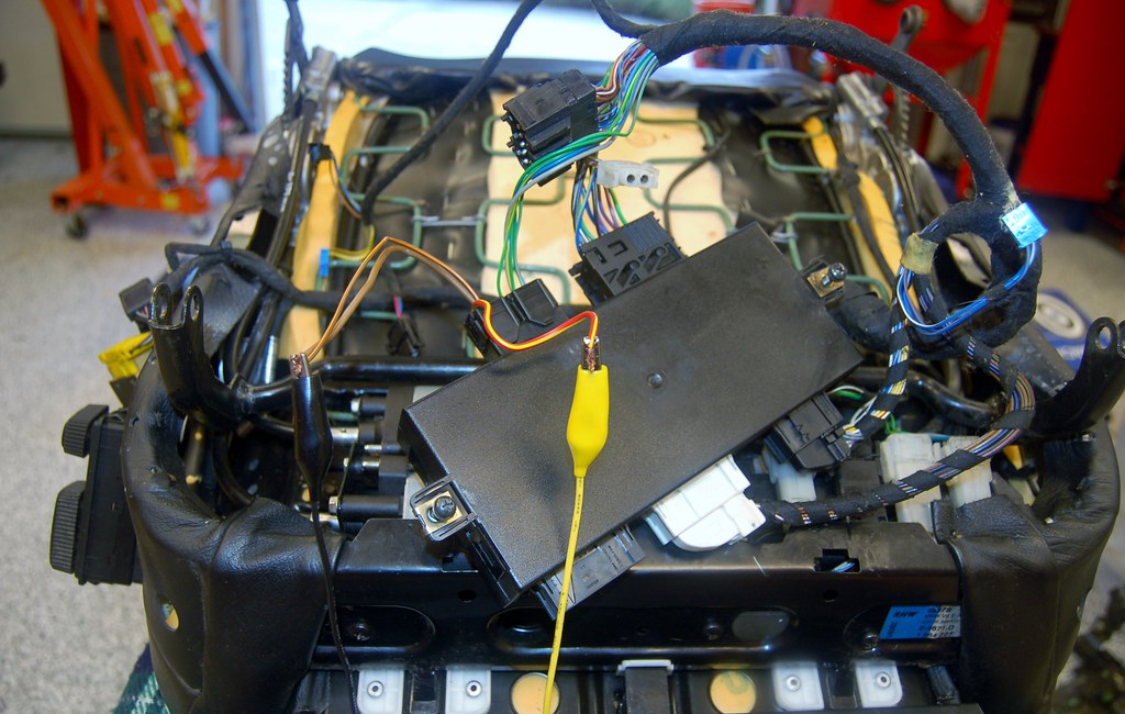

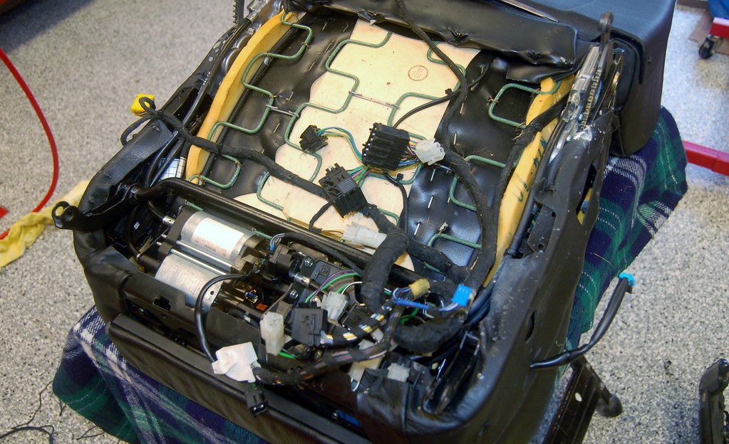

After getting it up on the bench and trying again with no joy I decided to test the motors individually. I quickly discovered that all seat functions, including heat, work but the actuator cables needed refurbishing (the twist problem) and I could not get the seat to function via the control switches.
Because this seat has memory, fixing the actuator cables is trickier than on a non-memory seat. Every motor has a sensor attached making the bolts less accessible and there are far more wires in the way.
Initially I struggled because I couldn't get the seat to raise up in the back: the cable for the left side was not working. I un-twisted the seat by using my portable drill to turn the inner wire in the left side cable.
Then I decided to figure out how to actually disassemble rail section from the seat frame. Here's how you do
- There are four pins that hold the rail section to the frame.
- The front pins come out the obvious way: just push the little spring loaded tab in and tap the pin from the other side.
- The rear pins were less obvious: You have to move the seat all the way "back" so that the rail is all the way forward. Then you'll find a hole that lets you tap the rear pins out.
Once I did this, coping with the cables and wiring was much easier. I'll do this 1st thing next time I work on seats like this.
After fixing all the actuator cables and testing that the seat was straight and everything operated, including the headrest, I decided to find out why seat would not work when power was applied to the main connector.

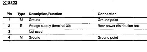

I did this by studying the E34 ETM... And the answer is right here:
The 4 prong plug that has the Red/Yellow always-on power lead has two ground wires. One a "2.5" and the other a "1.5". BOTH are ground and BOTH must be grounded for the memory module to work.
With power/ground supplied as shown above the seat controls all work (except heat and leg which require other wires to be hooked up).
So, we now definitively know: E34 Sport Seats with memory will work just fine in an E28.
The memory function itself is not currently working. When I press 1, 2, or 3, the actuators in the seat move, but I cannot get "program" to work. I ran out of time, but I suspect I will need to hack the sensor inputs for the mirrors so the module thinks they are 'set'.
Worst case, and I'm totally fine with doing this, I will remove the memory buttons and replace them with a blank plate. There won't be any memory function but the seats will operate just fine.

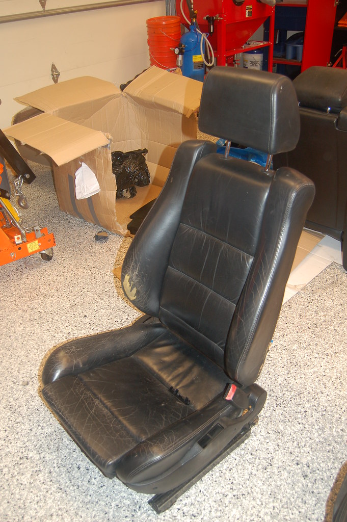

Second set of seats arrived today. Huge hat-tip to cddallara for sourcing these and getting them shipped...from Ireland. All up this set cost a lot less than I spent on the first set. Corey took care of the whole thing; he was prompt with great communication and I will happily buy from him again.
The packing did it's job...barely:
They came with the tops and bottoms separated. How come none of you jerks told me the tops and bottoms come apart so easily? Would have saved me a HUGE amount of hassle moving them around and working on them.

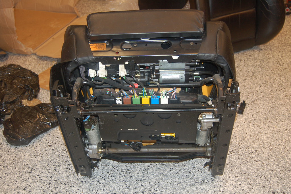

Here's the bottom of the driver's seat. Things to note: It has an old-school memory module in it. I didn't realize earlier E34 seats used a different memory module. Means swapping parts between the two pairs will be harder if I need to.
Second thing to note is these are from a RHD car! I didn't even think about that, even though I knew these were coming from Ireland. Swapping the components around will be trivial though now that I know how everything works.
Third point is this set is in far more worn condition than the first set. Neither seat is in what I would consider acceptable aesthetic condition and getting them to my standards will likely require a complete recover.
I may steal the left hand bolster from the passenger seat for the left hand bolster of the driver's seat of the other set. By doing that I will simply have to re-dye the first set to make them like-new.
I have not had a chance to test the mechanicals (and won't until the weekend) but they look to be relatively clean and in good shape. There's no evidence of twist but I will refurbish all the cables anyway.
This is actually the passenger seat bottom:
This is the driver's bottom with the other top. As you can see whoever owned the car these came out of swapped the tops at some point so that the RH bolster on both seats got worn down.
I'll test and refurbish the mechanicals on this set ASAP (this weekend?) and see how hard it would be to swap bolsters.

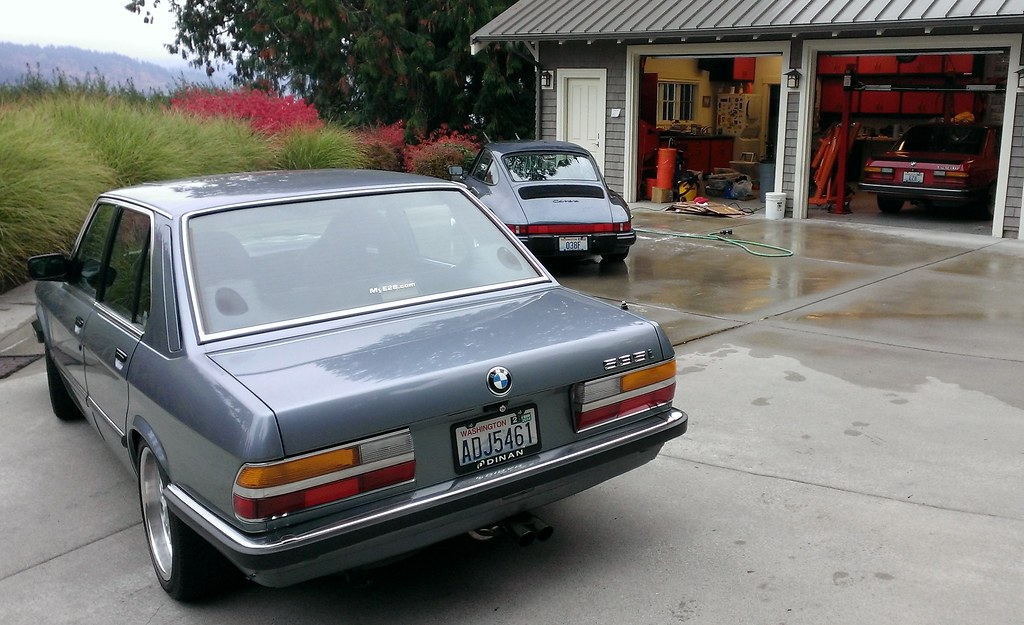

Pretty wild to see the interior of my first car in this thread! BMW4aaron just found that car in the junkyard haha! Good luck with the rest of your project.
Posts: 9397
Mike from Seattle to dropped by as I was washing the 911 to drop off the non-power seat ebrake cover I bought from him.
His car's looking great!
I may or may not use the ebrake boot that was included. We shall see...
