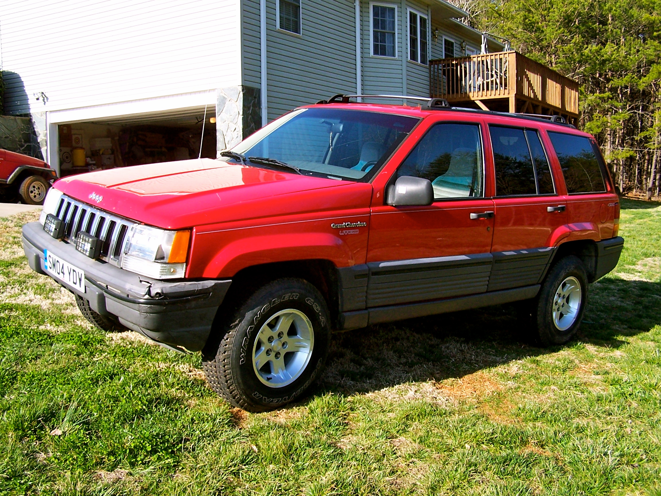

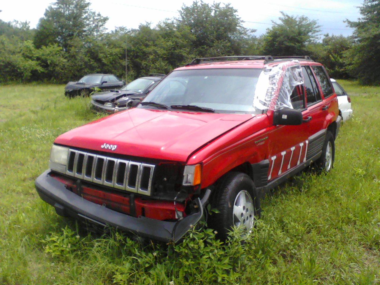

It seems to be in great shape so I'd definitely fix it.
This was my first car, I bought it for $300.
I got parts that were already red, utilized pull-a-part and people that I knew and I ended up with this.
Its not perfect but it gets the job done, not to mention that I now have a very strong bond to that Jeep. I don't think I'll ever get rid of it.
You just gotta ask how much it means to you, and even though it sucks it can really be a great learning experience (I did about 90% of the work myself) and knowledge is priceless right?
