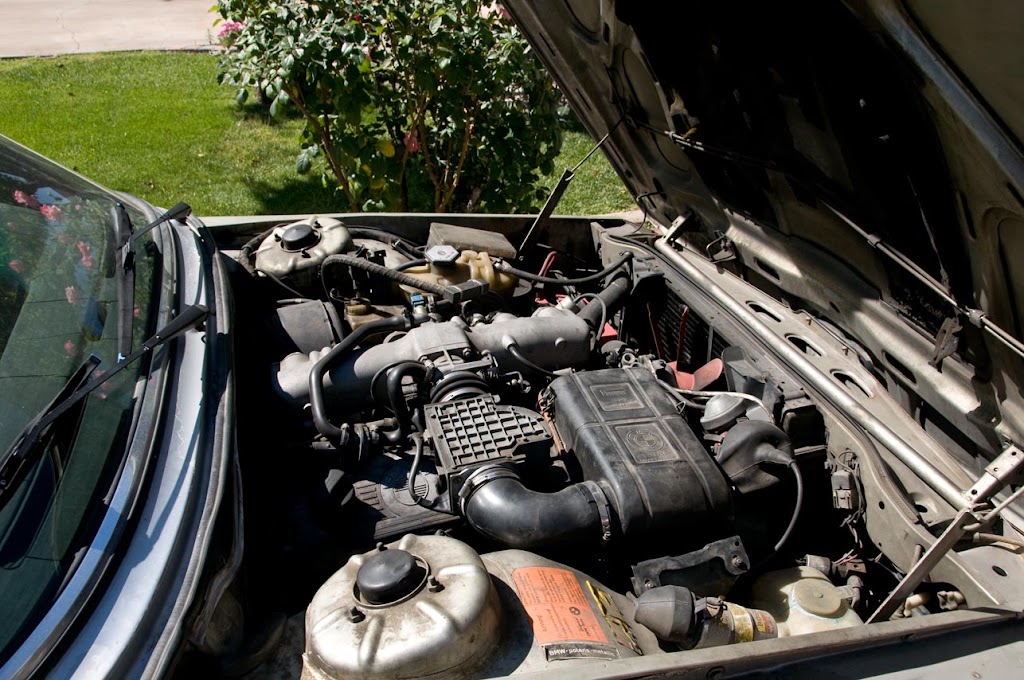

Then, I had to drill four holes in each grille for the squirters. A 14mm hole for the squirter and a 3mm hole for the locating pin. I couldn't have done any of this as effectively without the great help from Eddie in T.O. who went through all of this recently. With his help, I had a fantastic template and made quick work of that. I decided that it would be best to make a small hole and use that grinding cone to open it up to fit the squirter. Worked great, though oddly, there was a slight variance in location of the pin on a couple of squirters. That was interesting.
So with that done, I pulled the front of the car apart again, swapped the headlight rings (these were used, as I did not get rings with my kit - they cleaned up very well after lots of elbow grease), attached the motors and then wired everything up. I routed all of the washer hose. I used the stuff that came in the kit, which isn't white-white, but it's NOS, so that was kinda fun. Interestingly, there was JUST ENOUGH to do the whole car.
It looks a bit more complete under the hood now. I still need to fit the covers for the back of the headlights and the battery tie down from the wiper kit. Of course, I also need a battery (this one belongs to Alex
). Also, the front rubber seal isn't installed and the distributor is a spare I swapped in to test the drivability issue. Other than that though...
I also fitted the decals on the right shock tower.

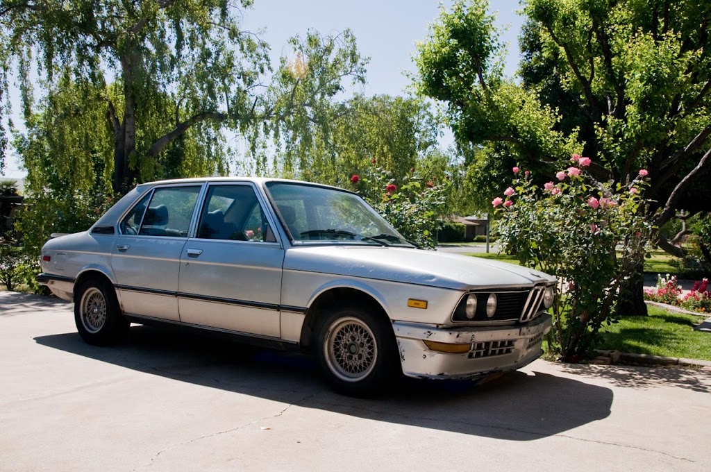

Thanks guys. It certainly has improved a bit. All it really needed was a good wash. Came right back.
I will get some real photos in daylight today.
