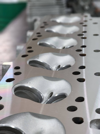

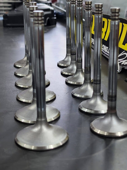

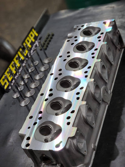

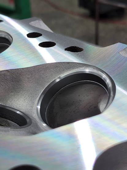

Beautiful. Looks like they nailed those angles...Federico wrote: Aug 29, 2022 10:47 AM Got the B28 head back from the machine shop![]()

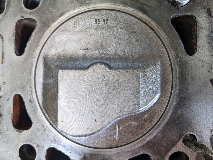

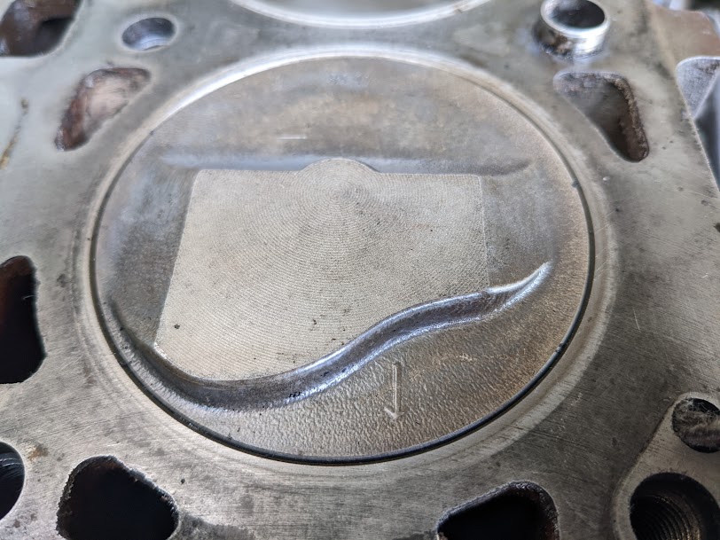

I finally got my 528e running. It's got a 10:1 B34 bottom end with a B35 head so I suppose it's not really a 528e anymore. My original plan was to assemble this car out of parts I had been collecting over the years. When I started I was pretty sure I had almost everything necessary to make it happen, but of course that's never the case. Many, many parts were ordered, including some that were completely unnecessary (Supersprint headers, I'm looking at you). Then, while assembling the first engine (B35), the threads pulled out of three head bolt holes at only 45lb/ft.
Rather than having the B35 block repaired I used a euro bottom end I'd been saving. Of course it was a slightly oversized block so factory rings were hideously expensive for the original 10:1 pistons, but I couldn't find any alternatives. All of this set the project back almost a year, but it finally started and ran great. I let it get up to temperature and cool down overnight, did the final torque on the head bolts and nothing felt funky. Then I was able to take it outside and do a couple of laps around the parking lot. Felt like a big victory.
We celebrated with a beer.
There's still a ton of work to do before it's ready to hit the road but at least I don't have to push it around anymore.
