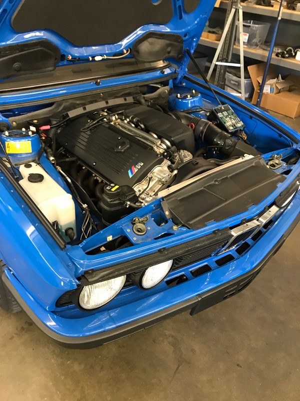

I picked the car up at 425 Motorsports Friday afternoon...
Shit-eating-grins followed as my daughter and I drove her home. The seatbelt receivers we ordered hadn't arrived so the drive was sans-belts, which felt weird. But it didn't take me long to forget about that detail...
Everything felt right. From accelerating onto the freeway, to cruising at 70mph, to breaking for traffic, to the curve of the offramps. I'm not sure what I expected, but when you put a car together from the ground up, you expect SOMETHING to feel odd. Nothing like that. Just solid and smooth.
Here she is departing home July 7, 2016:
And here she is back home June 21, 2020:
I took several drives yesterday after putting Maytag's seatbelt receivers in, including a run to Costco to get Julie some flowers for our anniversary Monday (yes, I parked this car in a Costco parking lot; it is a daily driver after all). I got my first comments from others while filling up with gas
First impressions:
- The color is a lot, and I love it. The bronze windows are a perfect touch; they add something to the car that just subtly says "care was taken building this thing". Glad I did shadowlike, for sure.
- Sounds fantastic. See video below. I had a hole in firewall that was unplugged so the initial experience had me concerned, but once I fixed that, it meets the daily driver test. Outside, it's just magical.
- Faster than snot. I had forgotten about the Sport mode switch. When turned on it's faster than fast snot. Maybe too much power for the 225s? Super easy to break the rear end loose.
- The seats are quite comfy. They have optional lumbar pads that can be inserted and I'm not sure they're needed. And, man do they look great. I was worried I did too much houndstooth, with the doorcards, but nope. Perfect.
- I love my steering wheel.
- Handling feels right. I've only tossed her a little bit so far, but so far so good. Right rear tire rubs a fair amount and the left barely at all. i have some work to do here, but I've known this was going to be a trouble spot.
- Ride height is a little lower than I'd like. The front resonator taps my lift when I drive on.
I've started collecting a healthy punch list. Dan at 425 was reluctant letting me have the car because he knows it's not really done. But I was tired of waiting, and tired of paying them to do work I am more than capable of doing myself. I am now an expert with the checkbook-wrench (achievement unlocked?) and have no desire to improve my skills there any further. So unless it's something I am really not capable of (paint/body work), I'm doing the rest myself. While this list may look scary, I have to say, reading over it actually brings me great joy!

CJ & I went for long drive this morning on one of my favorite roads this morning. Even with the issues noted, this car is magical. The H&R coilovers are really, really good. We intentionally hit some speedbumps hard, and did a stretch of I-90 that has serious undulations. Solid.
Like a good dad, I even let CJ drive.
After a #totwaffle breakfast (look them up), we had our first real wrench session. Knocked this stuff off:
You may recall way back that I refurbished a wiper motor and then decided to go with an Amazon.com bought Chinese knockoff, just for the heck of it. We'll see about longevity, but after adjusting everything properly, the Chinese unit works great.
The powder coating on the wiper arms, esp the driver's side with the "because race" wing, made installing the cap challenging. But we got er done. Having CJ help me was the best father's day gift ever.
