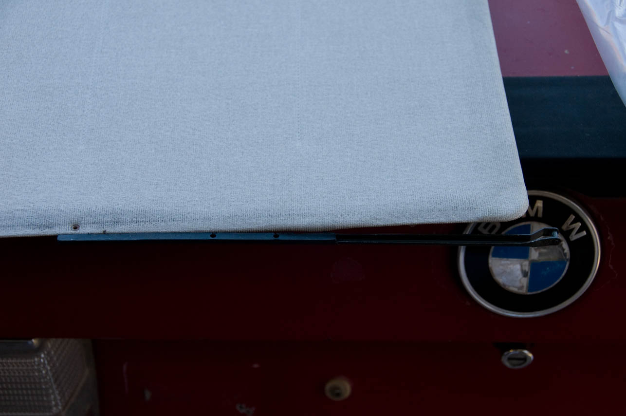

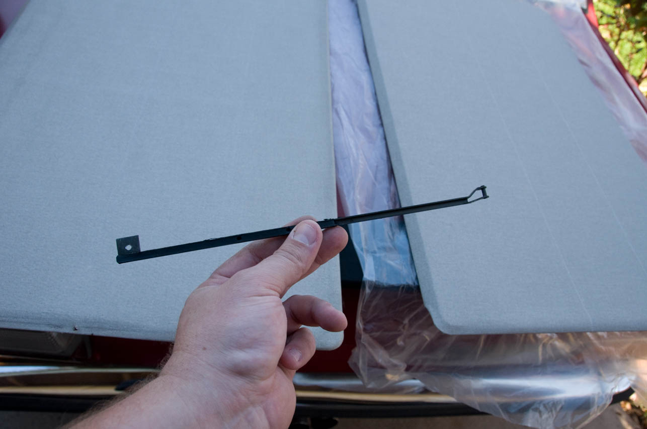

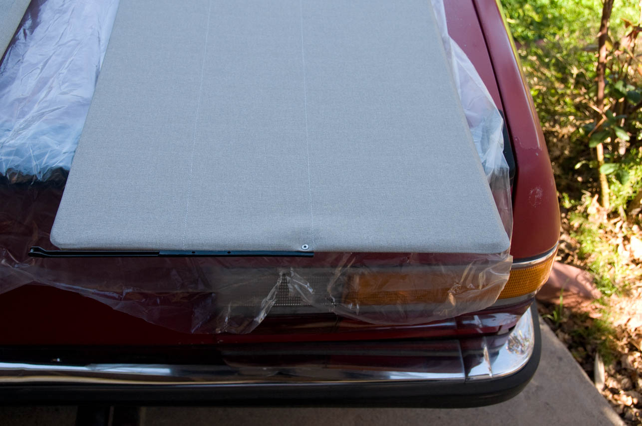

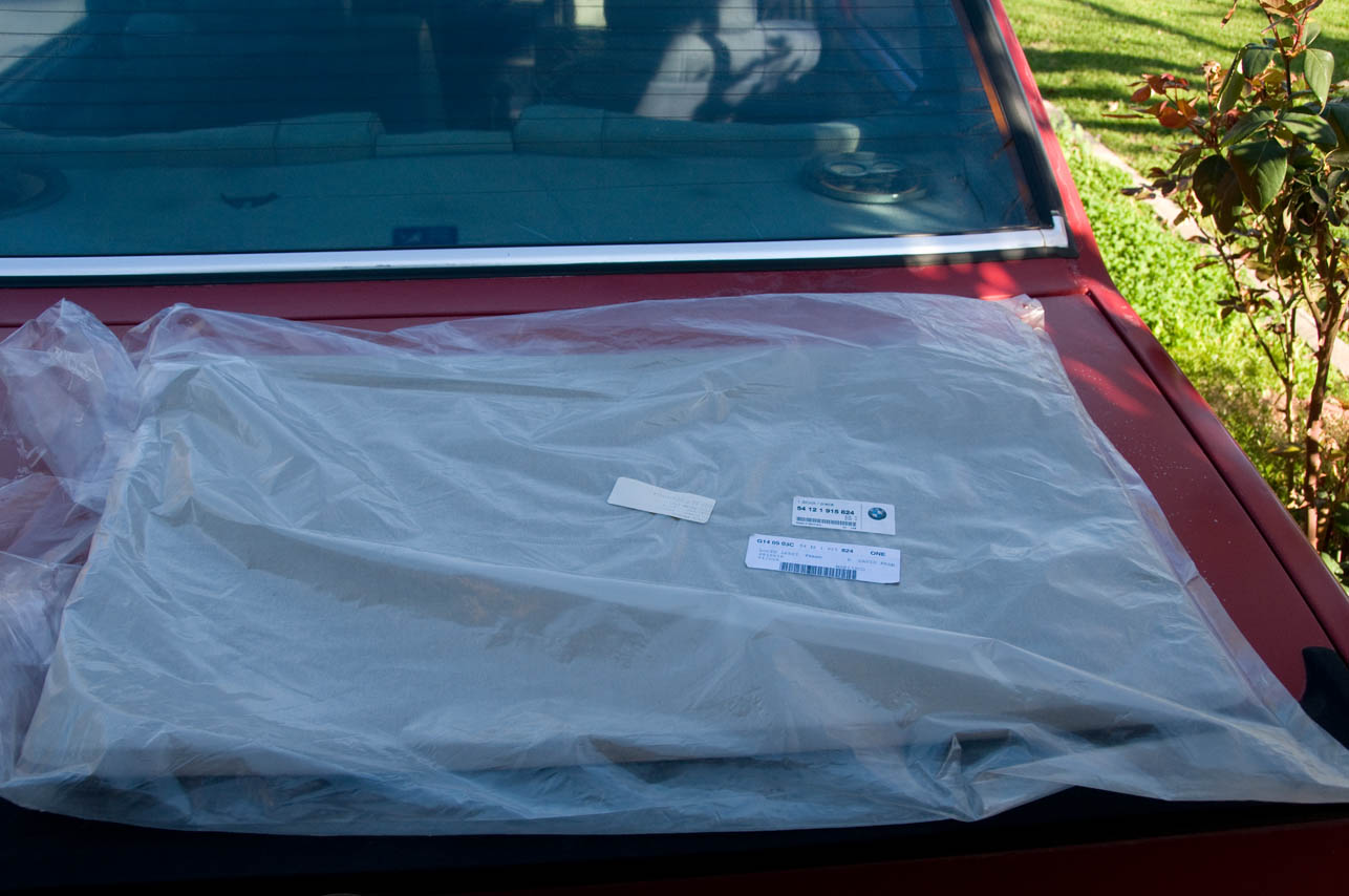

The reason I opted to go for a new piece was while my original was nice, my headliner was new, so why not go new? You can't just have one recovered because there's no way to put the heat-treated stitching in there like factory.
Well, apparently, they don't do that anymore.
So, it is new. That's fine. Something else is missing.
The new one doesn't have these. So, it's off to get some rivets.
I got aluminum rivets for this purpose since I wanted to be sure I could deform it enough before popping, as I didn't think that would happen with steel. Believe it or not, but the original rivets are only used on E12, E21, E23, E24, E28 and E30 and this is the only place on the car. My local dealer flat-out REFUSED to order them - even if I ordered the necessary 500 or whatever their minimum quantity is. That's why I went with normal rivets.
I got them as tight as I could and stretched the fabric as much as possible before making the hole, but that's the best we could do. Unlike the original, the new one is quite puffy on the edges as the foamy material is new, not 25 years old.
I snapped the arms into the bar, took the sunroof guides apart, slid it into position, put everything back together and bolted the roof in, making the necessary adjustments. I couldn't slide the new liner forward enough to clip into the roof. Finally after about twenty minutes, it made it. Then it got hung up halfway closed and wouldn't budge.
I decided to take it apart again. I thought I found the issue and went to clip it together again, only this time, the plastic receiver that the arms clip into broke on the left side, causing the headliner panel to end up cockeyed. What I didn't realize was that the arm flipped over the top of the ear which raises the rear of the headliner, pushing up on the roof panel. I didn't realize this had happened every time I moved the sunroof to try to free the screw up.
I finally got it unstuck with minimal damage (obviously not in the mood for photos here). Sadly, there were several minor scratches on the top of the trailing edge of the sunroof, but they went beyond the clear, necessitating a repaint.

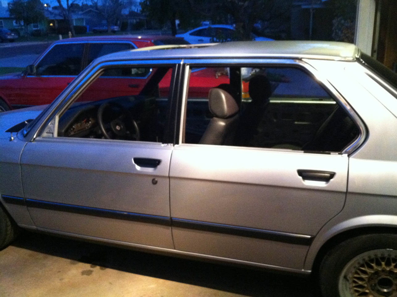

Next up, I installed the quarter windows and the rear window guides for the rear doors. I was leaving for Texas and figured this would be a good time for them to get used to their position. I'd make adjustments upon my return.
I came home from Texas and after getting some critical work done, I decided to relax. Tuesday night, I put the redone sunroof in. No muss, no fuss, no drama. Took all of ten minutes. Sucks because I wanted to take the car back to Mike and go, "HA! I didn't screw anything up." I guess what I did screw up was minor though.
Wednesday, I worked on the right side of the car and cleaned up the window regulators and got all of that installed. Then the glass. Everything worked as it should.

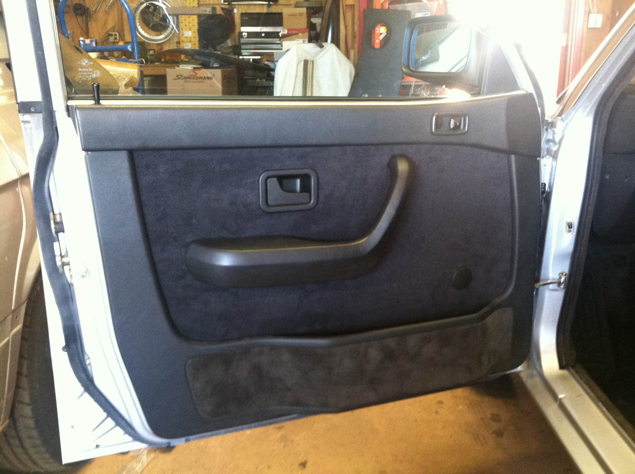

Everything worked perfectly except the right front lock actuator. Will sort that once I have one.

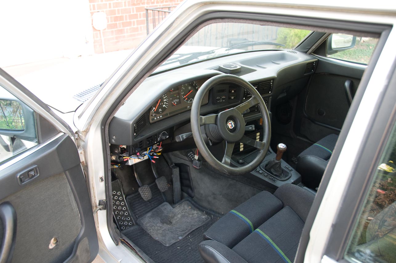

Next up, I have to recover door panels and make my vapor barrier. I had saved enough between the 8 doors I had to make enough for one good car, but it wouldn't have been nice enough. Last year, MLastovo gave me 4 sheets of this peel and stick vinyl sheeting which we used on his car for vapor barrier and it worked well. I used my pieces as templates.
Here, I realized I forgot to zip tie the wiring harnesses back to the door, so I took care of that.

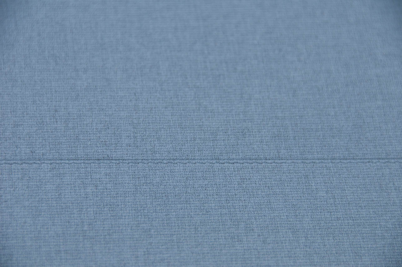

The problem with the original door cards was that the cloth had shrunken. It wasn't terrible on the edges but was a problem around the plug for the window motors and the door handle/armrest.
Amazingly, this is the most illustrative photo I've got.
It also didn't really match the interior of the car. So, rather than buying the factory stuff again (which I couldn't, but World Upholstery had something close), I decided to try my hand at one of our local trim suppliers. My car didn't come with Alpina cloth on the door cards. I was hoping Pedi got to keep his original cloth from his car, but the upholsterer tossed it, so I was left to my original plan.
I bought a fabric that was the right texture and I felt would work, only to bring it home to find it was too black. None more black. I returned it, surrendering 30% of my refund for restocking. I bought something else and discovered I was again an idiot. Another 30% lost. The final time, I came with the original fabric, the door card frame and a headrest and wasn't leaving until I found something. I think I did okay this time. It matches well in color (iPhone photo doesn't help), and it has a similar appearance to the Alpina cloth. I bought two yards, it was on clearance, so they gave me everything they had left (nearly 3 yards - I think they felt sorry for me).

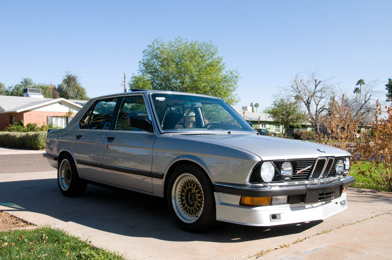

Once all of those were installed, it was time to mount the license plate (new stainless hardware and rubber feet to protect the paint from the bracket) and install the trunk badges.

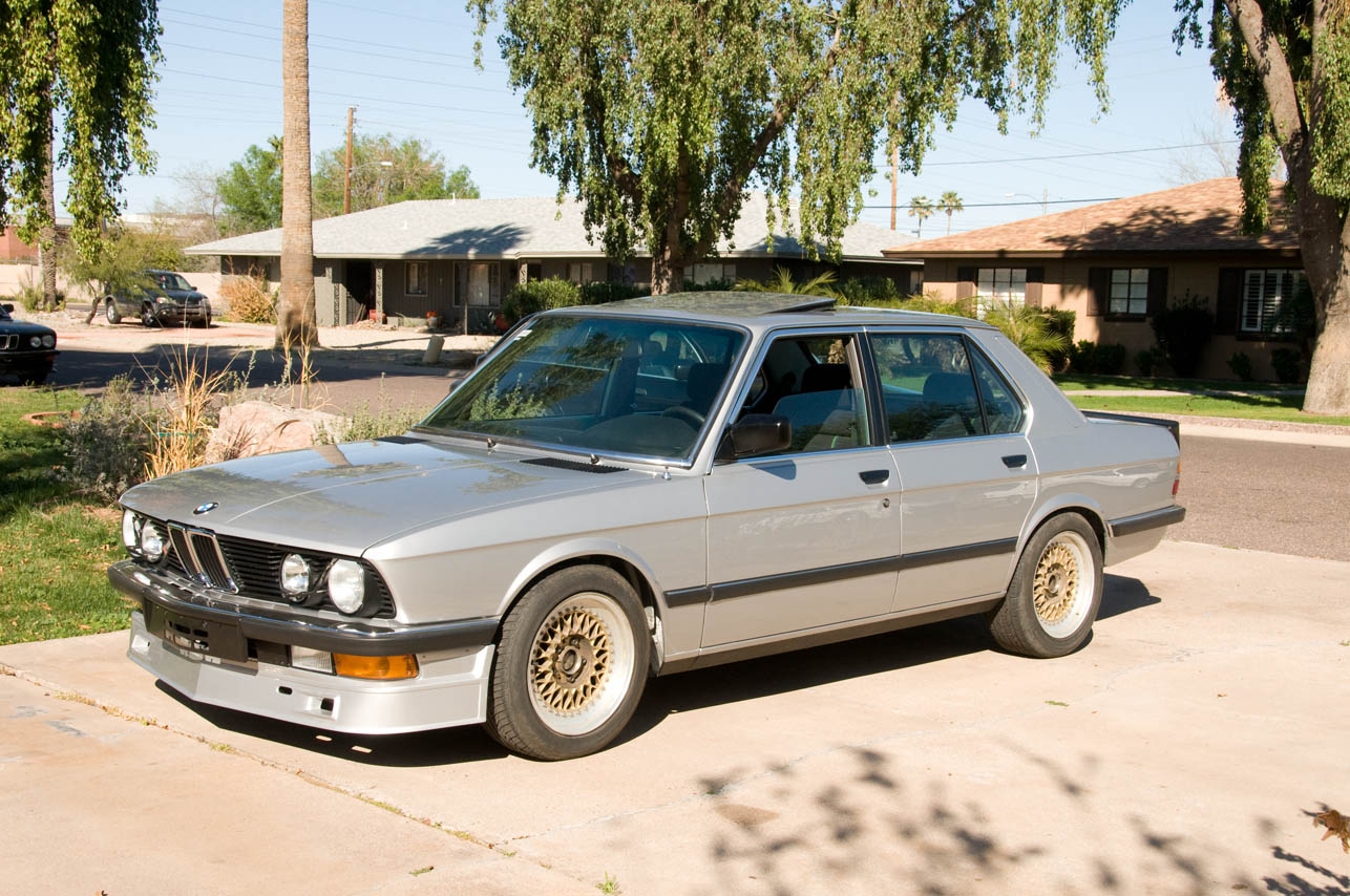

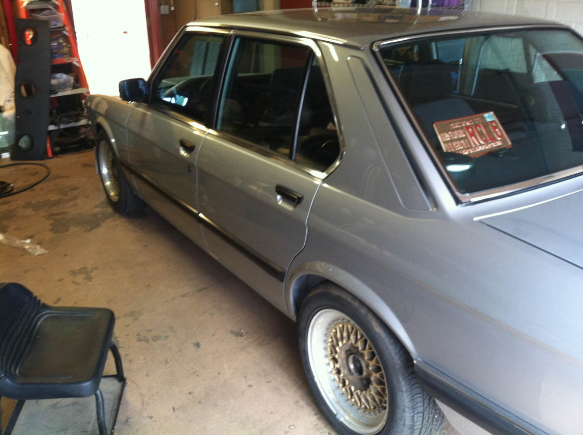

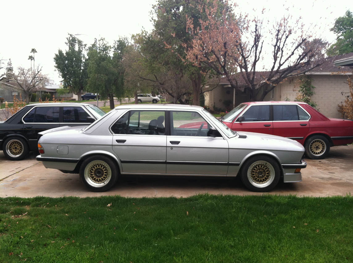

So, it's still not 100% finished, but there's not much left to do cosmetically. Wheels are still being refinished, I hope.
I drove it around the block today. Still don't have the rear muffler on, so I'll be looking into taking it to have a custom stainless exhaust made. We will see how that goes, but for now, I'm ready to clean up the mess I've made in my garage.

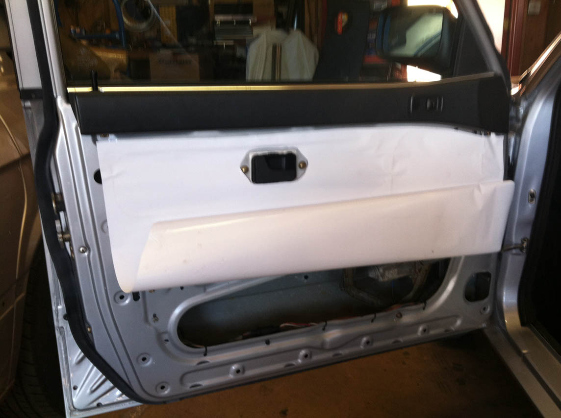

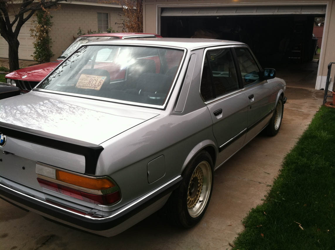

The rear spoiler has been refinished using flexible products with the top coat being a "hot rod black" but designed for flexible pieces. It was in decent shape before, but it really looks virtually new now.

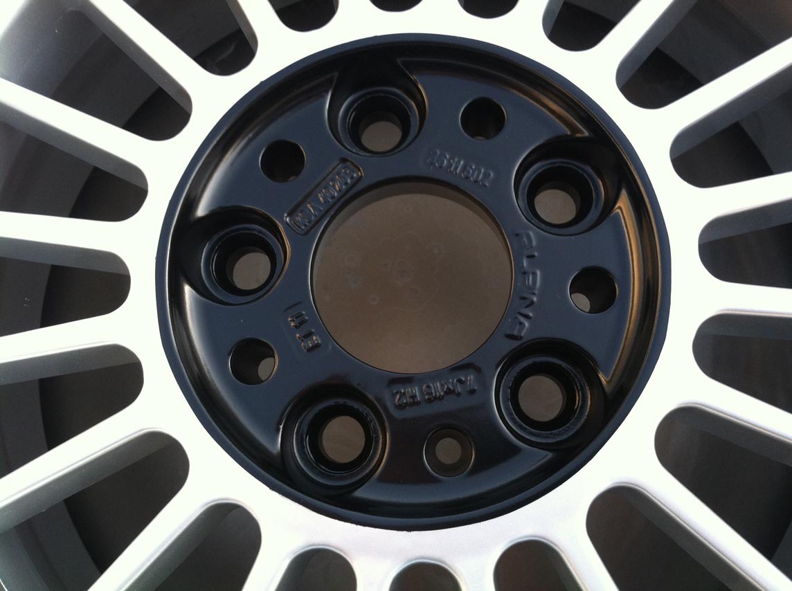

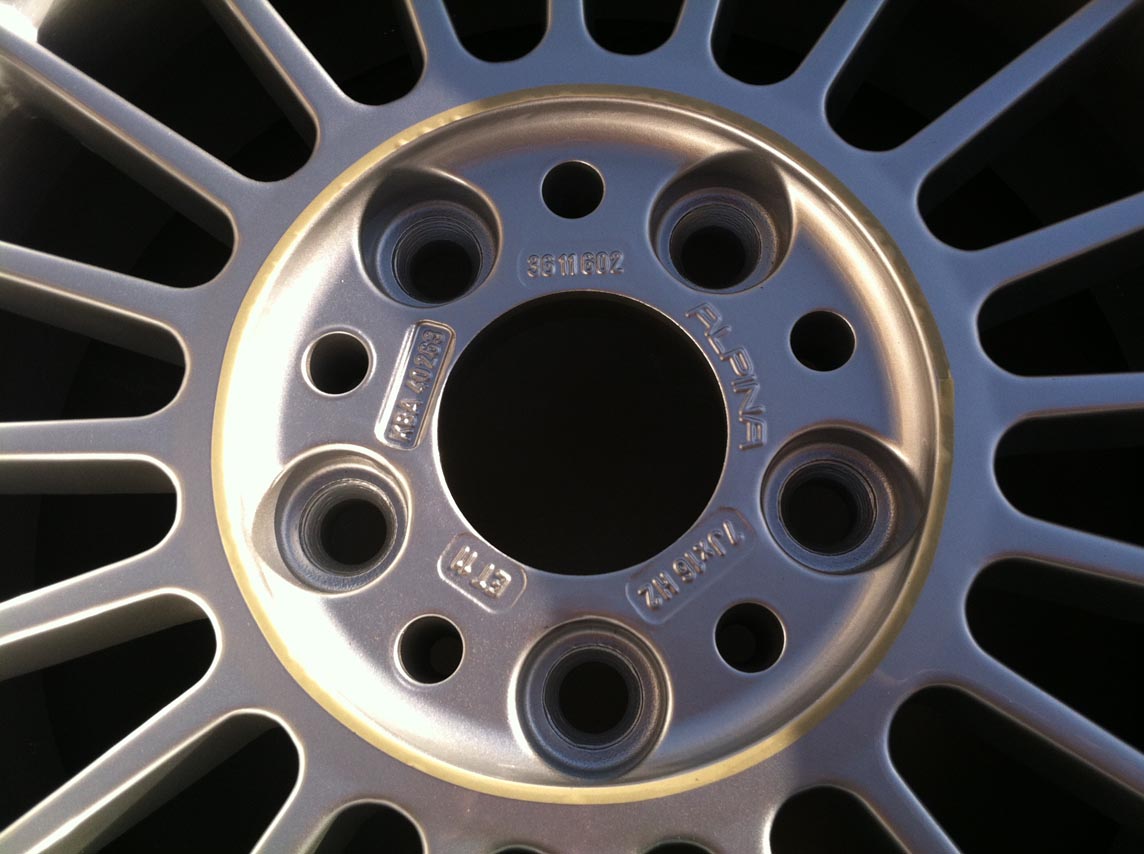

I haven't had much time lately to do anything, but there is progress nonetheless.

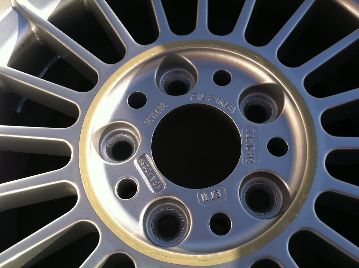

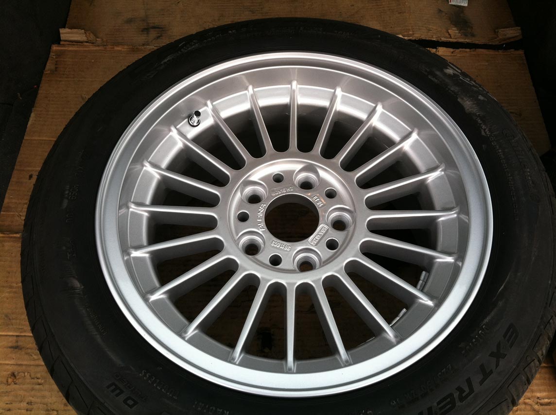

I received my wheels back from refinishing.

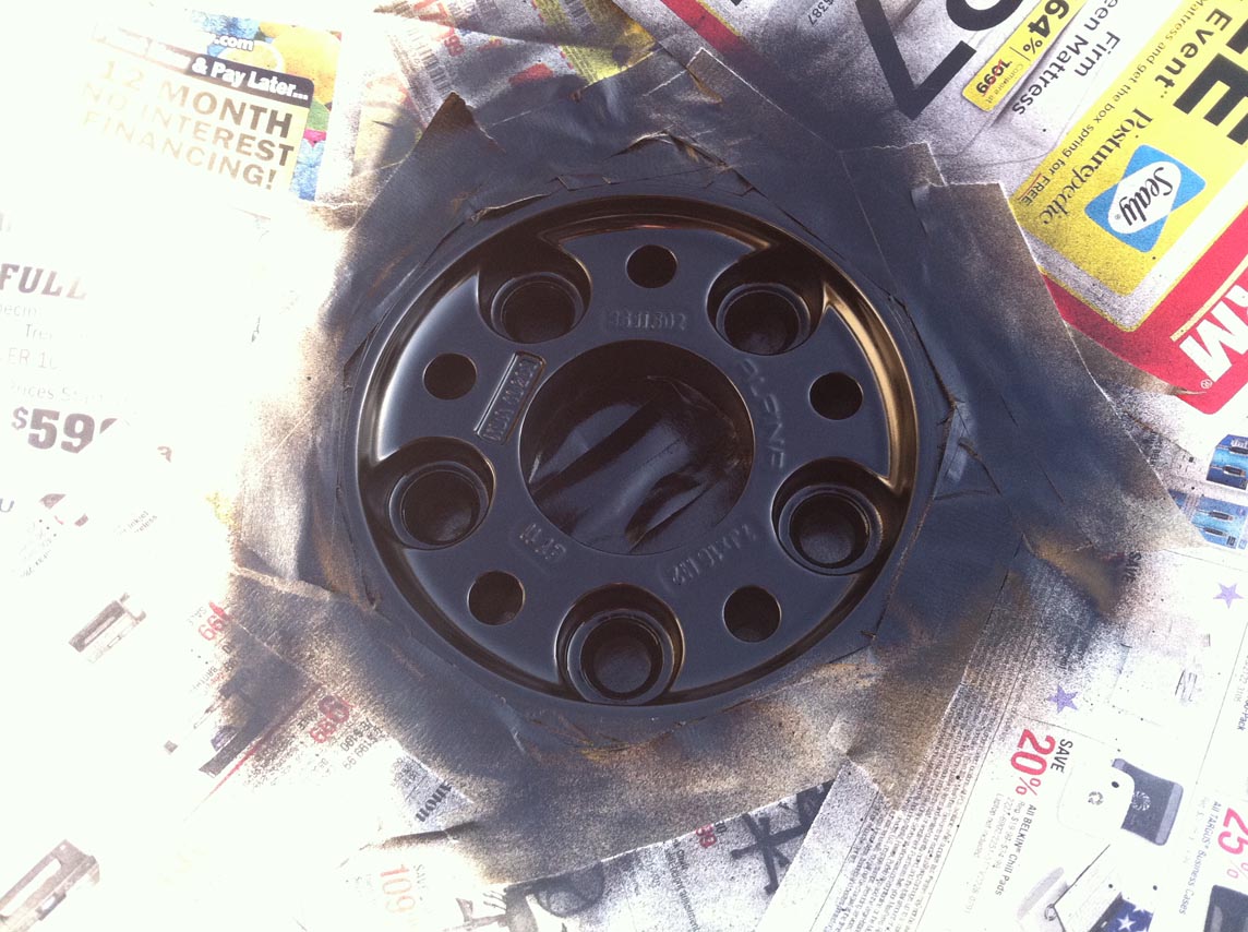

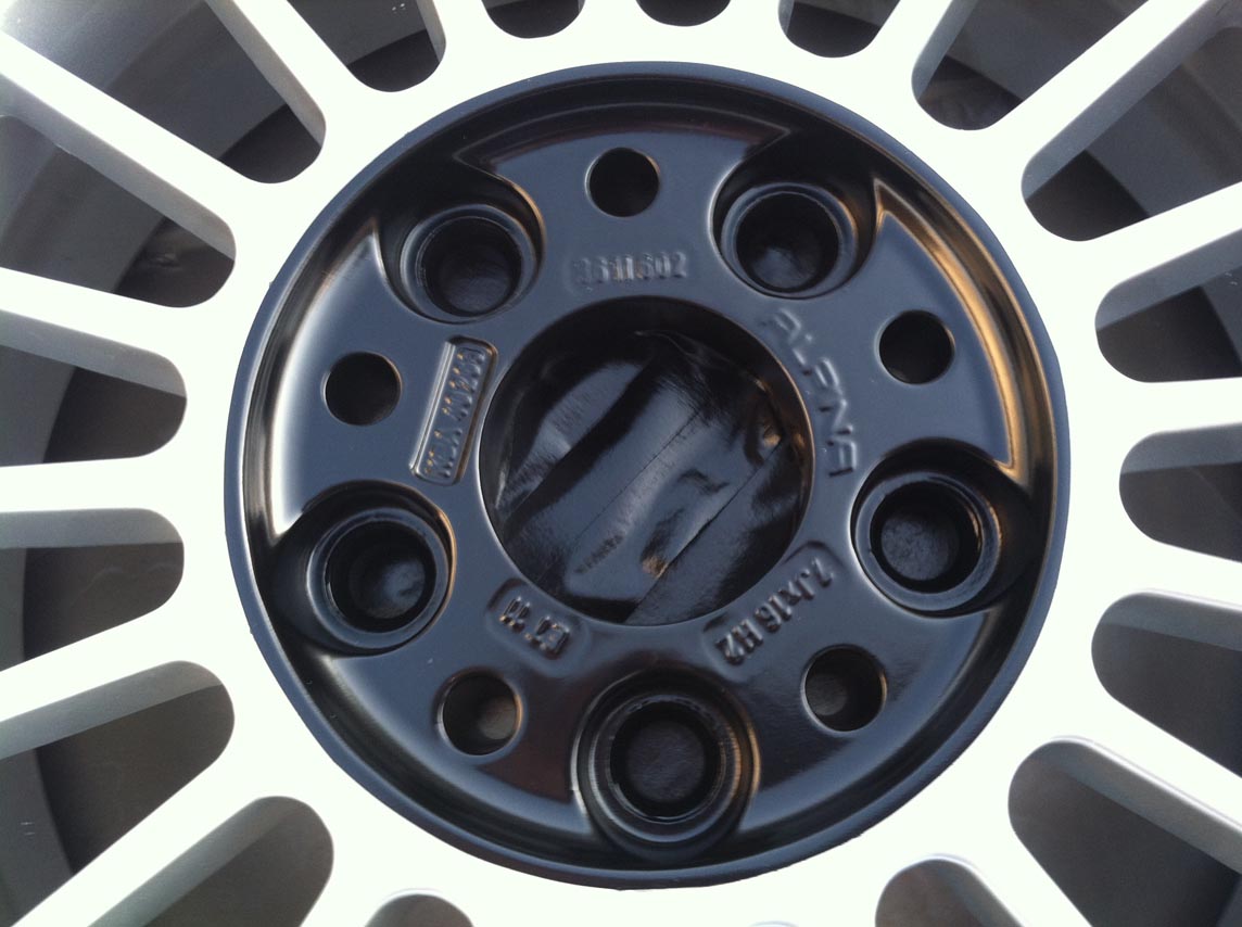

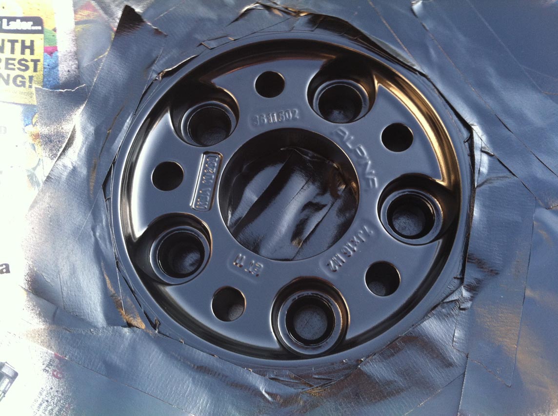

When I dropped them off, I knew they wouldn't have anything to do with painting the centers black. That's fine. When I bought the tires, we made sure the wheels were straight, so all they needed was to be refinished. Since I have the original spare tire, we reused that, too.

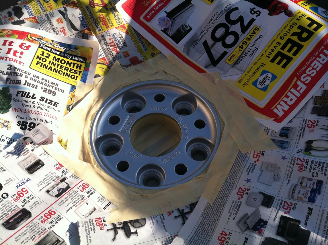

The thing about refinishing Alpina wheels is that people rarely do the black centers properly (if they even do them). You will notice in this photo of one of my original wheels, the black extends past the recess onto the face of the wheel.
Many don't do this because it's a pain to mask. That's fine and they look just fine, but I wanted to try to do it the correct way.
I bought some expensive tape.
Run the tape along the edge of the recess.
Then, run a piece of tape next to it.
Peel off the inner tape. I forgot to take a photo of this since I was preoccupied trying to find junk mail to mask the wheel off with, but look at the next photo.
Mask off the rest of the wheel. I didn't want to paint the inside of the center bore black, either, so there's a piece of tape in there, along with tape underneath the holes to prevent getting overspray on the 745i, or the backside of the wheel.

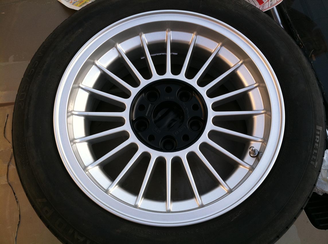

Once I felt satisfied everything I didn't want paint on wasn't going to get it, I sprayed my first coat.
Looks pretty good. I'm going for something between a satin and semi-gloss, so one coat isn't sufficient.
Let it sit for about 15 minutes (it was about 70°, so it was ideal temps), then spray the second coat.
Then, after a while, it's okay to remove all of the masking on the face of the wheel.
Then remove from the backside.
One down, four to go. I started with the spare first. Had about 30 minutes today at the house between jobs, so I figured I'd give it a shot. The tape is pretty difficult to work with, but its pretty much the only option to accomplish what I need to accomplish.
Hopefully sometime soon I can get these wrapped up and on the car.

Chris,
Just an idea to help with your painting, use Duck Tape sheets: Take a quality compass divider to trace a circle & then cut the inside of the circle out.
If Duck Tape sheets are no good because they'll leave residue on your wheels,
1. Line a sturdy sheet of paper with packaging tape.
2. Apply masking tape over the packaging tape. Make sure you start on one end so you can peel off later.
3. Do the compass divider trick.
4. Cut the inside of the circle out.
5. Peel off the masking tape & apply to your wheel.

Thanks for the comments. I investigated several options for masking the hole. I have a compass with an x-acto knife on it and I couldn't get it centered. I have some leftover vapor barrier scraps that I was going to use for this but the problem is that you really cannot reposition it without distortion. I certainly appreciate the suggestion. I think I might give it a shot again before I do the next wheel. We will see.
I have no idea what was used on the spoiler. I didn't do it. Mike did it. He said it is flexible and won't crack. He used the same stuff on my mirrors.
