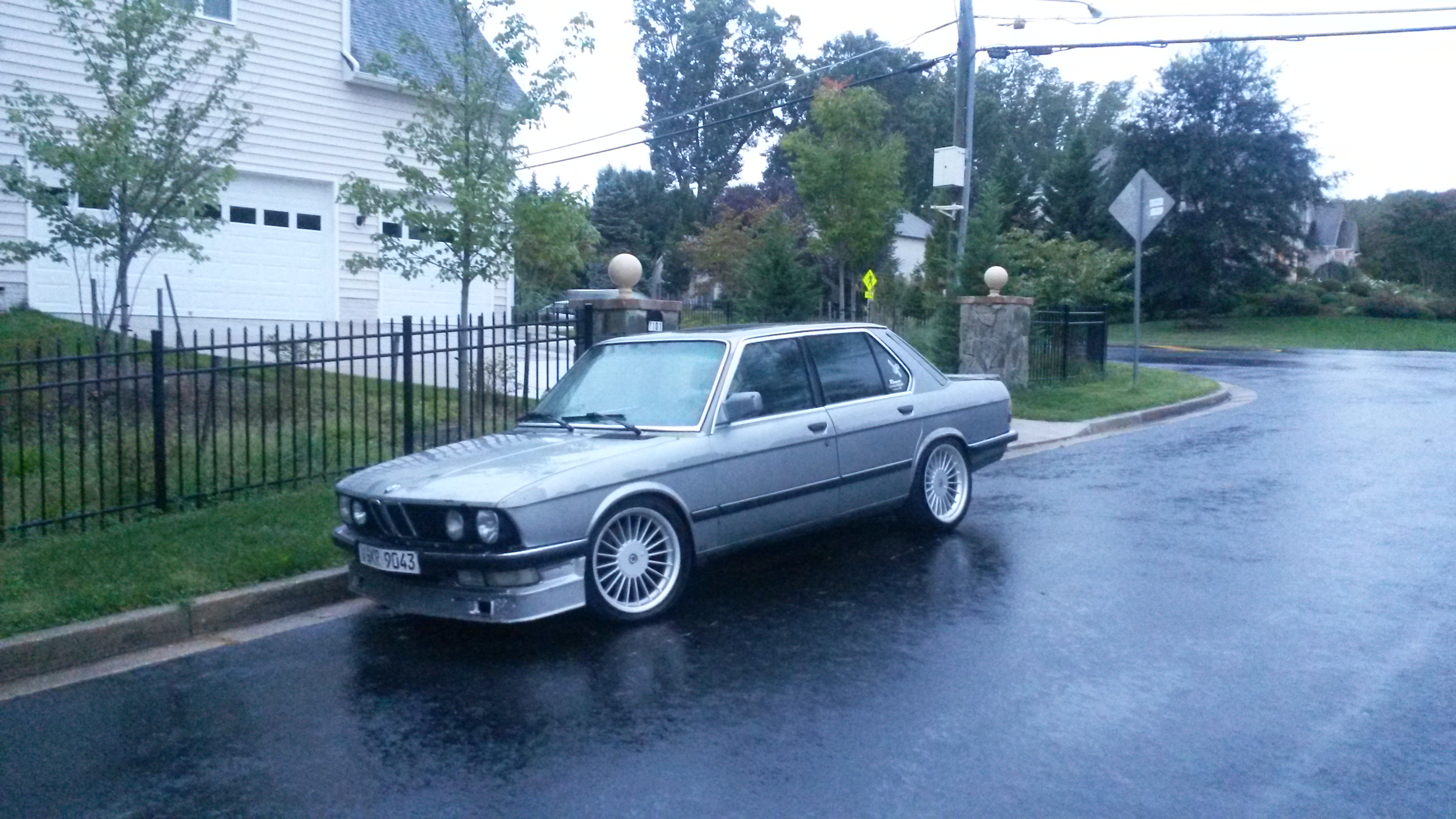

So after owning this car for twelve years, a crazy turbo build, a terminal hg event and a possible sale, I've decided to keep it. I'm in the process of collecting the goodies to make her a very nice dd. Upgraded k27 already in hand.
But it would have been one cazy part out.

:) Yeah dude. I swapped in a new stock O2 sensor and spark plug wires and she is brand new again. The idle is as it should be. Starts right up every time after sitting for a week or two. Still a few small things to do before spring, but it looks like she's mine for keeps.
Since I couldn't move her for $4500 I may as well get her running perfect, slap a coat of paint on her and have a fun car for meets and weekends.
I still get a hard on when I pull up to the house and see her sitting there waiting for me. LOL.....
