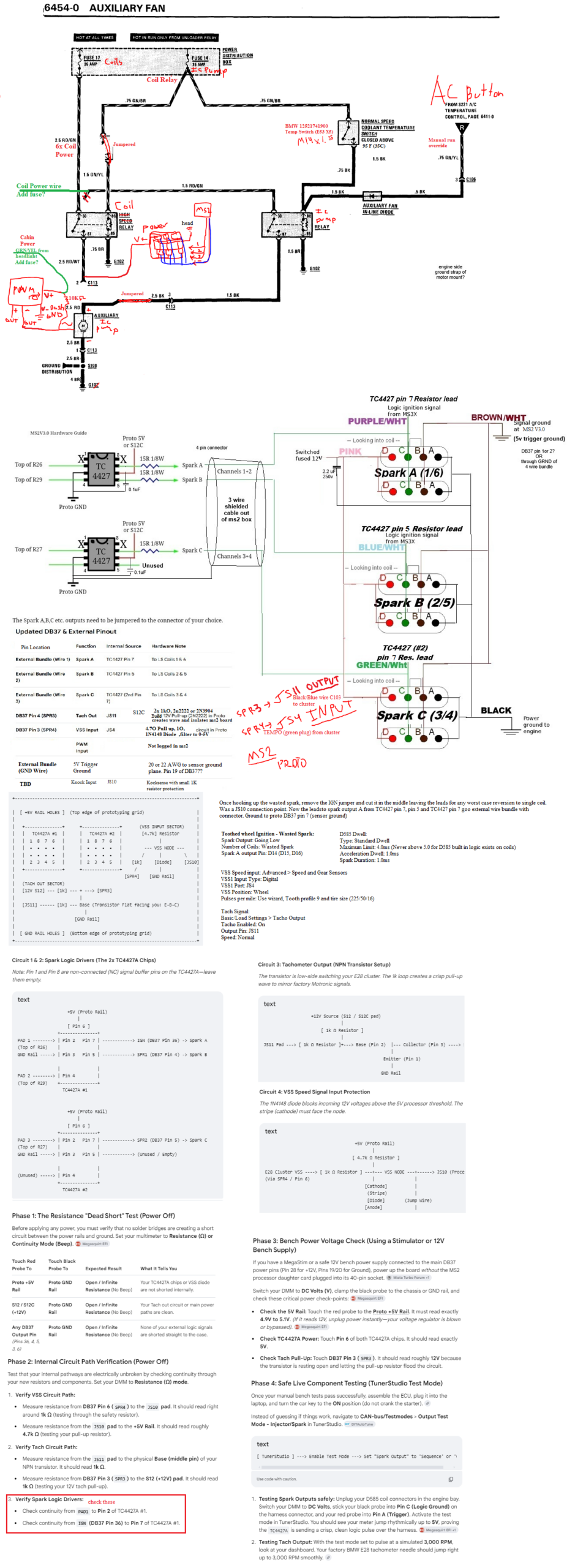

In the mean time, I was researching Wasted Spark with my spare MS2 unit. It is V3.0 and has these T4427 modules that need to be finished soldered in that would work with logic level coils. I am trying to decide if I might want to try this setup or what.
Basically I would use  them to send the fire signal for 3 coils in a wasted spark setup, or 6 (3 tc4427) with 6 coils in sequential, though I am not sure that is necessary. I have room on my prototype board to do it on either V3.0 ms2 setup if I wanted...
Wiring looks to be fairly simple with the 3 outputs of these chips going to the individual coils, with 2 hooked together for wasted setup. 3 outputs, and then I just need to make sure that each coil has power and ground hooked up properly.
To suit this setup, I bought ACDelco chevrolet GM LS coils D581 which are supposed to be quite good. I got 8 for less than $100. It looks like this is the setup Jake uses for M20 turbo at classic daily. They are big coils and sort of heavy, but maybe I could play with their mounting location when I look at adjusting my intercooler piping setup. Below is his photo, mounted on an M20.
My intake elbow of aluminum may or may not  allow this position on the valve cover^^
More research required on this topic also.

I also started organizing the wiring for the megasquirt gauges and sensors. I'd like to spend some extra time pulling power and arranging the wiring nicely. So far i have the gauges positioned above the center vent. As a last steps i will probably be labeling everything and  trying to get connectors for easier disconnect. Possibly vss speed signal input to ms2, coming out of the instrument cluster. Not totally sure if it will work.
I also have 4 wires sitting in place to run the wasted spark setup and the wire to operate the circulating pump with pwm control. The controller should sit down by the headlight switch.
Here is my revised schematic and details. some AI prompts to help me define the wiring, but I need to check this through for the proto circuits for vss speed input and the tach output.
