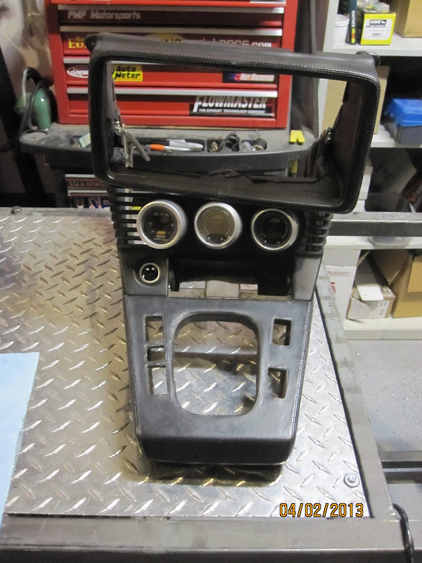

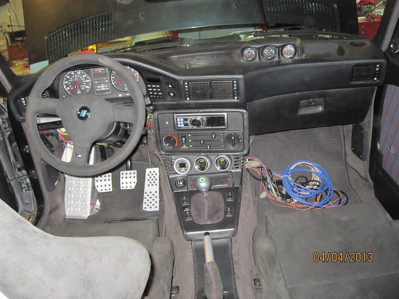

Gauge panel completed. In the panel from left to right are:
AEM Wideband Failsafe (http://www.aemelectronics.com/wideband- ... -gauge-84/) Universal Exhaust Gas Oxygen (UEGO—“you-way-go”) controller with an internal boost sensor, an internal data logger and a full color Organic Light Emitting Diode (OLED) display. It includes technology to activate a failsafe strategy in the event AFR falls outside of a user-defined operating window. If the AFR falls outside of the set operating window, the Wideband FAILSAFE Gauge triggers a user defined output function that can save an engine from catastrophic damage.
In the center and right position are AEM digital serial gauges: "AEM’s Serial Gauge plugs into the company’s Programmable Series 1 and Series 2 EMS and has the ability to read 19 channels simultaneously to provide reference for all outputs, including boost, AFR, EGT, H2O, IAT, knock, volts, RPM, vehicle speed, and more! Since it can read all channels at once, AEM’s Serial Gauge eliminates the need to buy a cluster of gauges, or you can link multiple Serial Gauges together to monitor additional channels or to divide your readouts across a few gauges." (http://www.aemelectronics.com/gauges-26 ... -gauge-33/)
Those of you who have been following this build will recall I purchased the pre-cut plastic panels from Shawn D. several years ago as well as a new grill shell. I was waiting to determine which EMS to use prior to purchasing gauges. With a local AEM-certified shop and chassis dyno specializing in forced induction on imports the choice became that much easier.

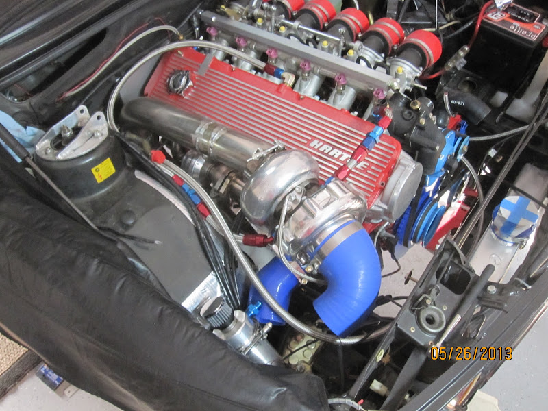

Update: In the past month or so there has been a good deal of progress...
BEGi intercooler installed: I channeled the radiator support, fabricated and welded mounting tabs for the bottom supports. On the top sides I reinforced the existing metal and opened up the holes to accept spring-loaded mounting pins. The two tabs on either side of the core now slide into grooves in the reinforced areas of the radiator support. The pins hold the intercooler secure and allow easy R&R. The bottom mounts have rubber bushings to allow some for limited movement, making it much easier to align the pins at the top. The top mounts don't photograph well with the intercooler in place. The bottom mounts are visible at the bottom of the second pic.

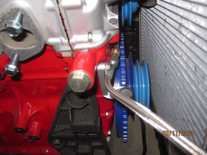

The turbo has been plumbed for water and oil. Oil feed is from the OE 745 filter head and pipe which has been modified with a JIC fitting and stainless braided hose and 90 degree fitting to the center housing. Drain is a -10AN to the oil pan.
Water input is from the coolant drain at the rear of the block and output is to the t-stat housing. Adapters were required to go from -6 to -8AN.
The need for a potentiometer type TPS due to the AEM EMS and the requirement for one of a much smaller form factor has had me scratching my head for months. The other night I was working on the E46 and decided to remove the TPS and check fitment on the B36 throttles. The bolt spacing is much closer. Yet, when I removed the flange the mounting holes on the E46 TPS and those on the throttle assembly align perfectly. To make it work will require 8mm spacers and removal of a bit of material off the the throttle shaft. Problem solved.

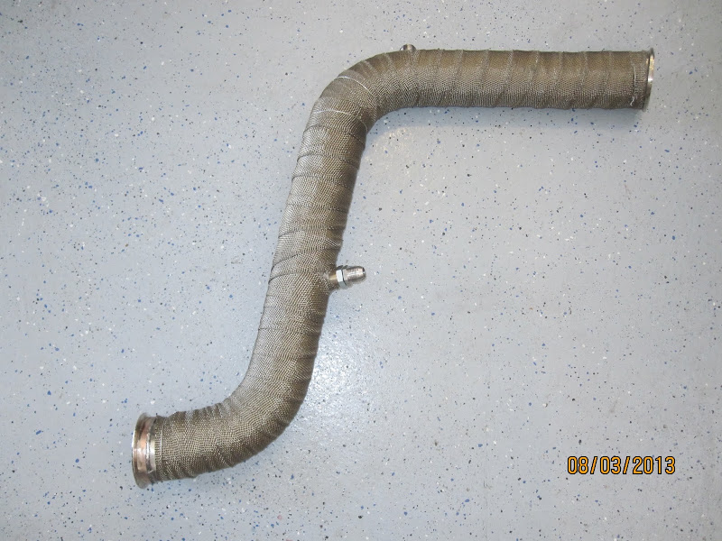

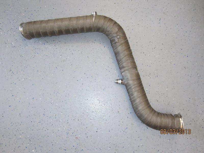

The downpipe was fabricated with 3" stainless. I used one 180, one 45 and a few feet of straight pipe. There is a v-band at the top and bottom with a flex fitting connection to the track pipe.
Still figuring out the packaging on the FPR and battery. Had to downsize the battery to fit the charge pipe from the intercooler to the plenum. The washer tank had to be moved to make room for the catch can, coil packs and intake.

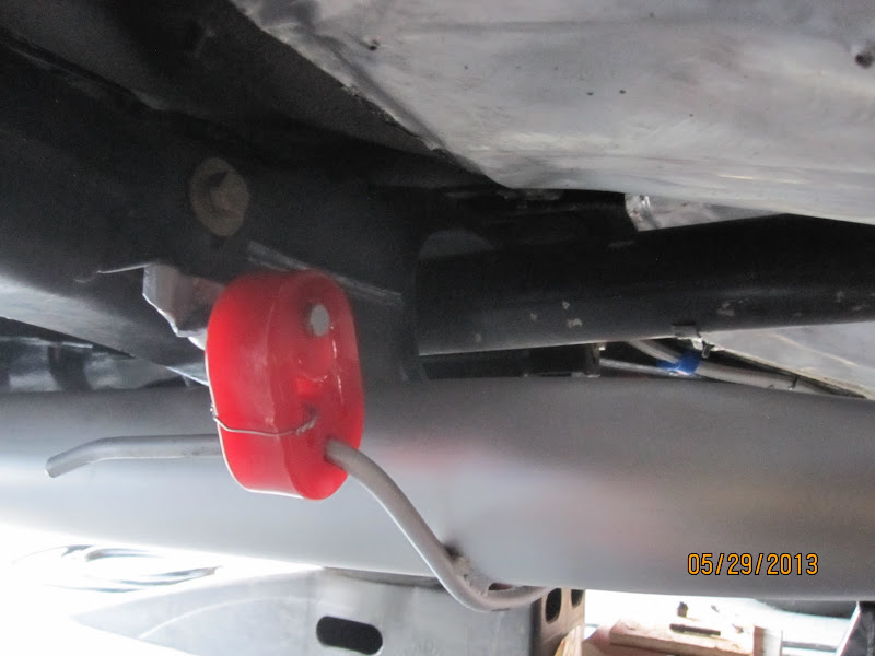

Two years ago I replaced the OE exhaust hangers because they'd dry rotted after 2 years on the car. After another 2 years the replacement pair, which sat in the garage the entire time, were again starting to show signs of wear. After looking into some other options I decided to go with urethane and modify the OE hanger brackets with 8mm studs. I then safety wired the hangers to the brackets to keep them from potentially slipping off. $15 well spent.
Nice work Murf, i wonder how the urethane will cope with the heat, i imagine pretty well with the nice long rod to cool before it reaches the bushing. Totally agree about taking your time and thinking your way through each aspect of the build, no need to rush at all. Soooooo clean, keep up the progress

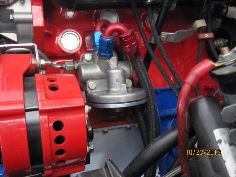

Spin-on oil filter adapter installed. Many thanks to Bert Polaikoff for taking the time to provide this modification allowing use of a much better assortment and quality of filters. I'll be keeping close tabs on oil degradation via Blackstone with the intent of extending oil change intervals. Pictured with Fram XG8A filter installed.
