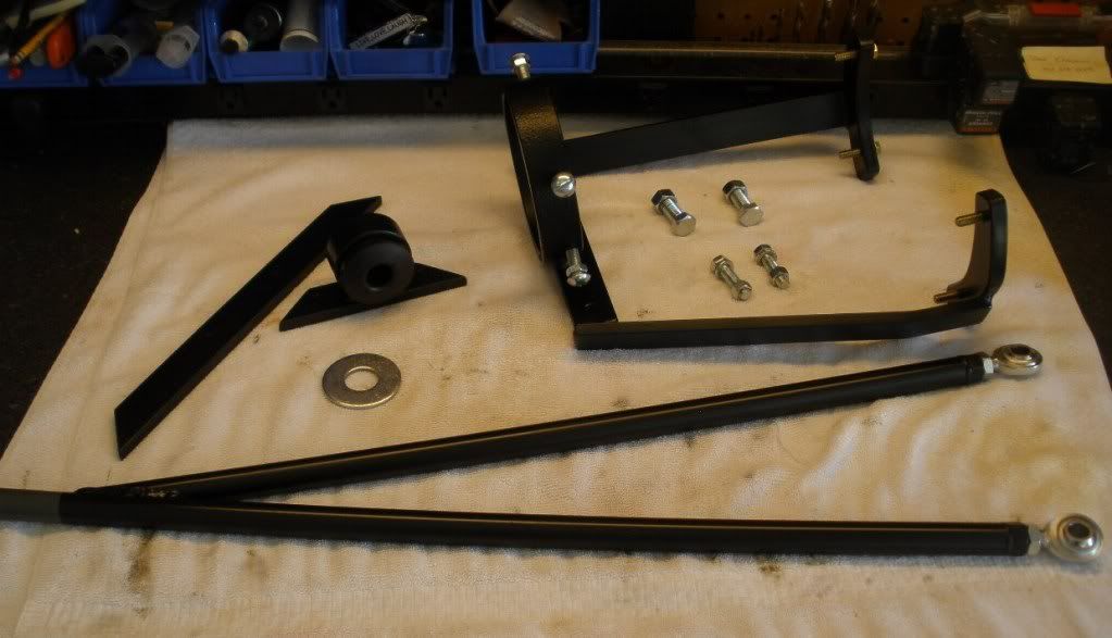

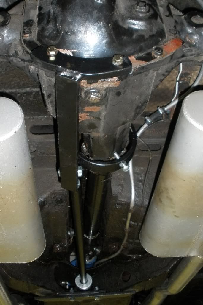

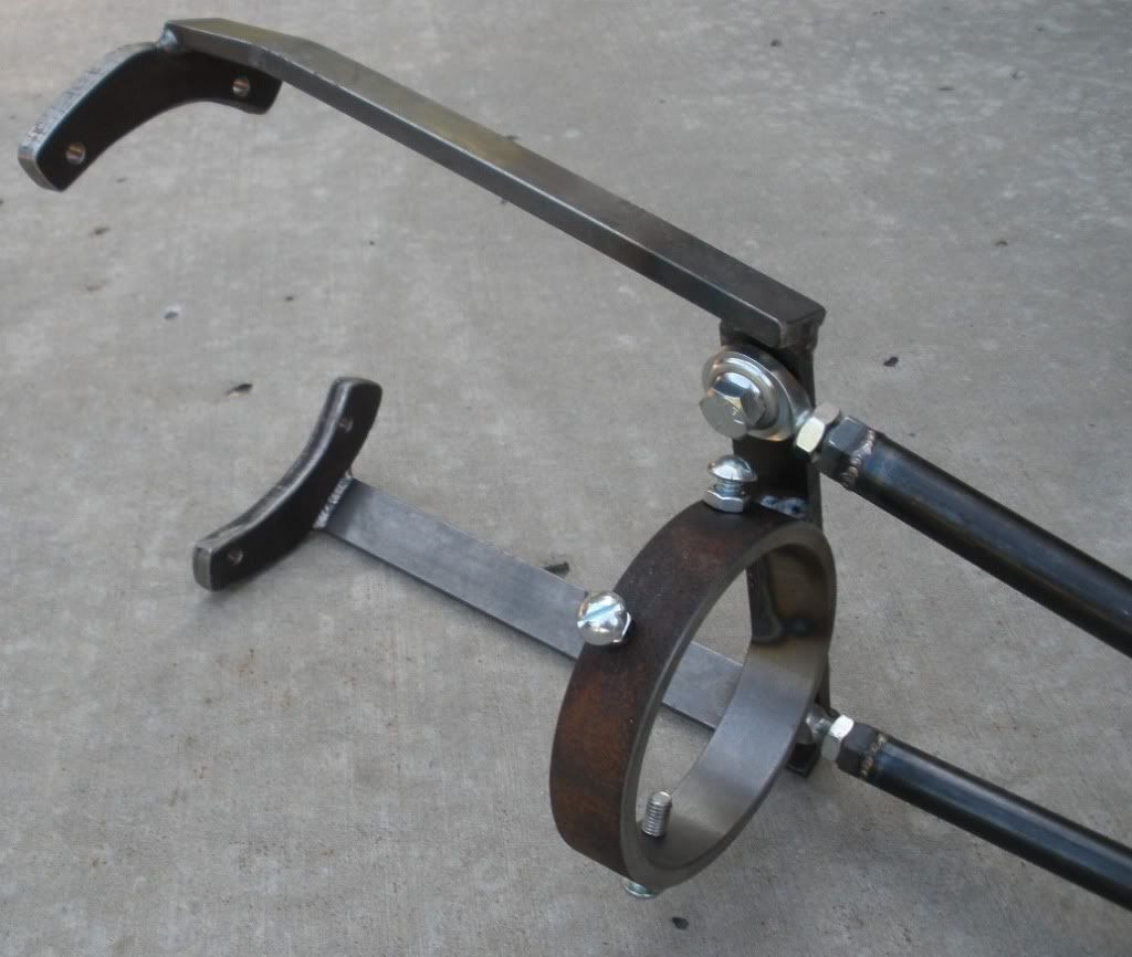

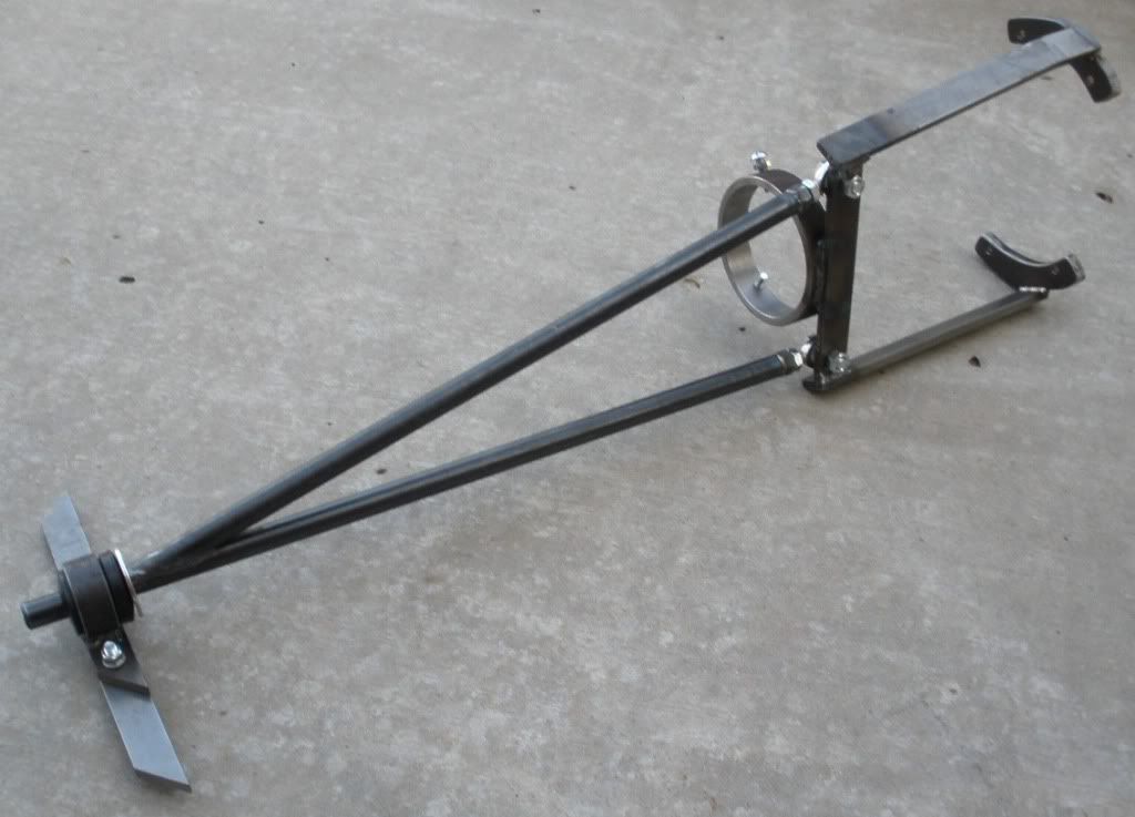

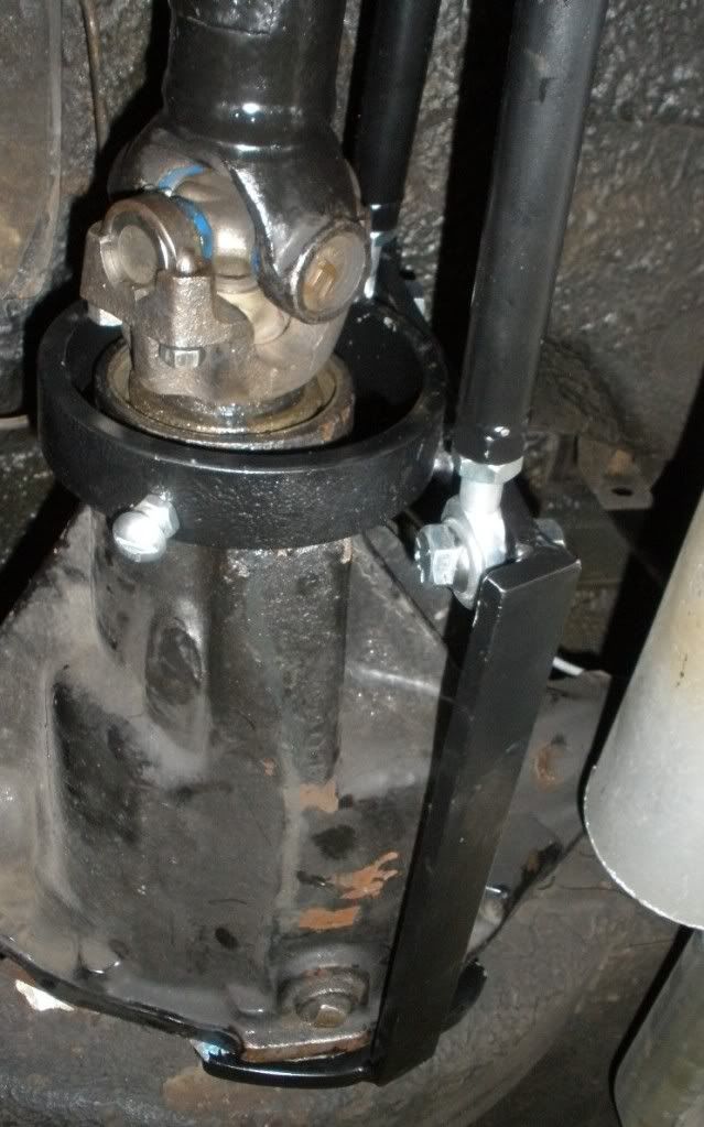

With the new found HP came new found problems......one of which is wheel hop caused by rear spring wind up. Here it the fix, a torque arm.
This torque arm is custom made for the Tiger. It bolts to the back of the dana 44 rear end and then attaches to the uni-body cross member. Only two 3/8' holes are needed to be drilled in the crossmember for its installation.
Hand made by a fellow Tiger enthusiast and each part is hand stamped #0170 for the unit made. All of this for $285 shipped. I will need to take it apart and paint it, installation will be a breeze.
Gonna be a monster at the drag strip!
Torque arm is painted and ready for install. Will do that in the morning.

Torque arm is in and I think it is the shit. Car really scoots along now with no drama from the rear end. If enough torque is applied, the tires simply spin with no hop.

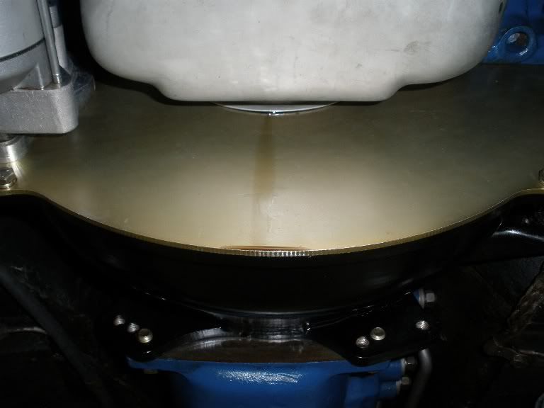

Now.........the FRIKIN oil leaks. Got the front main fixed and now this -
Seems to only do it when not running. I just installed a very expensive one piece steel and silicone oil pan gasket too. If it is the rear main, I am going to punch some puppies :brickwall:
Engine and trans will have to come out to fix it.
