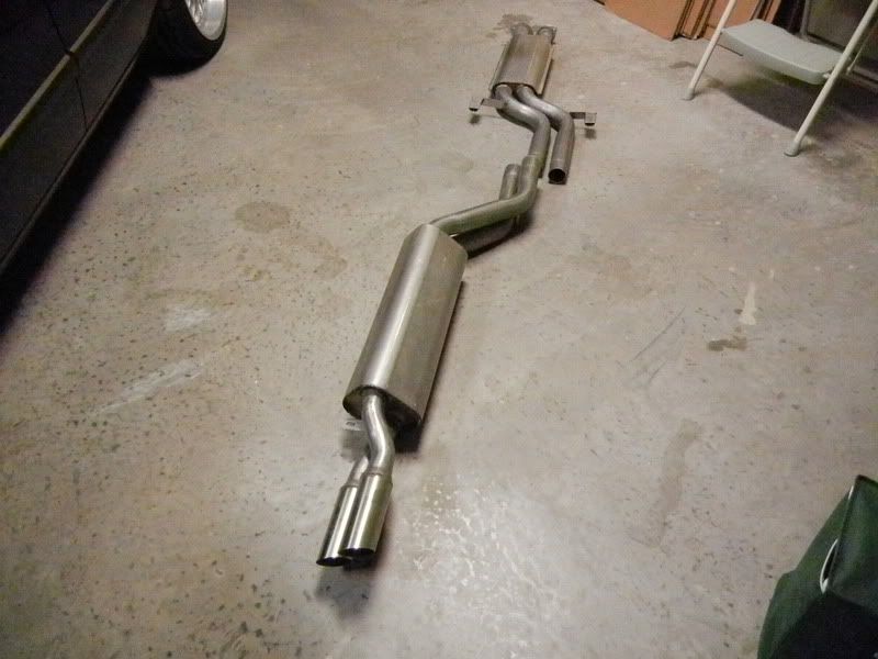

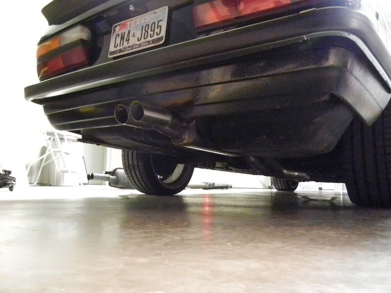

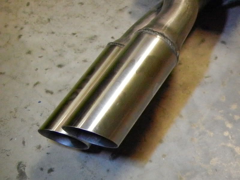

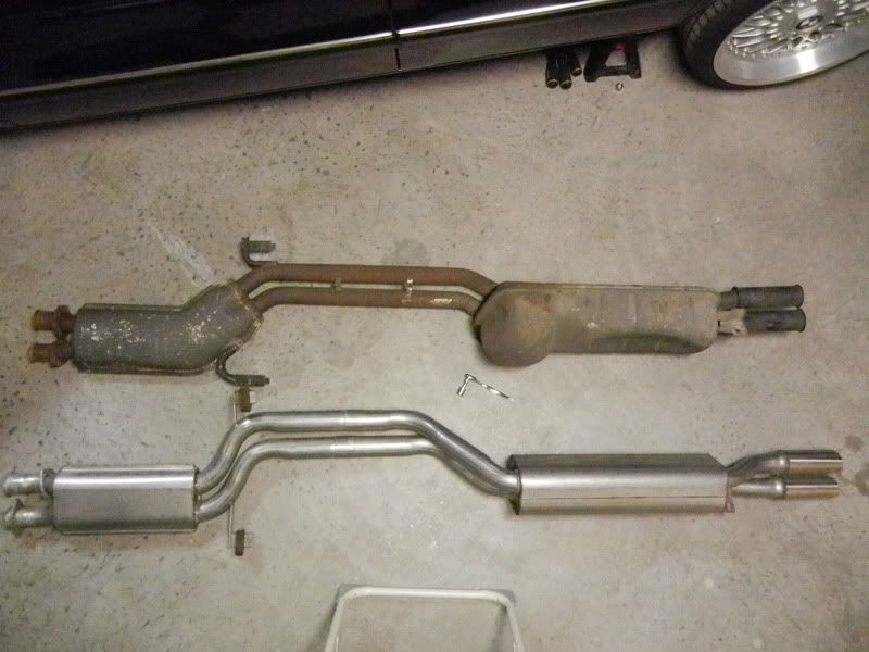

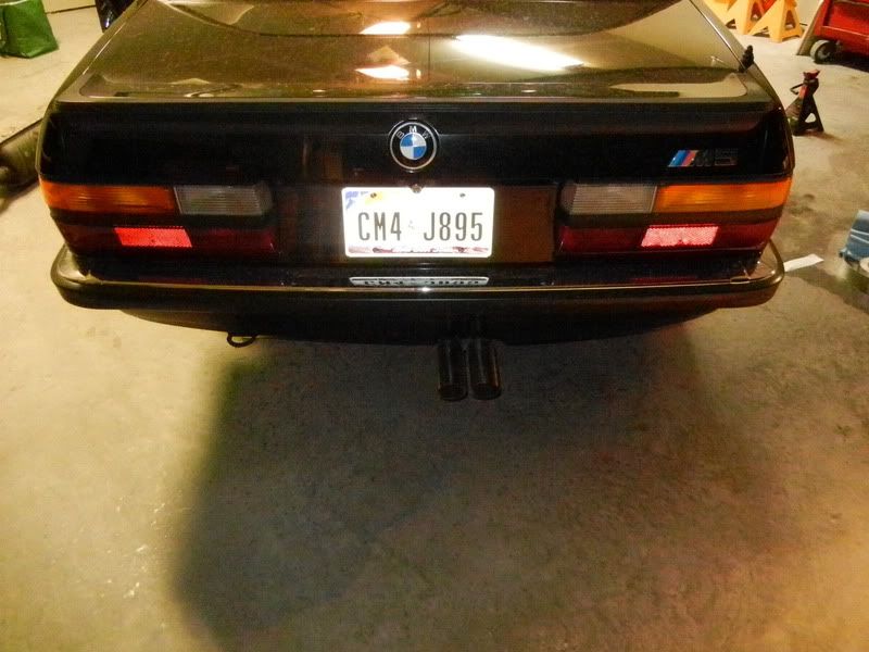

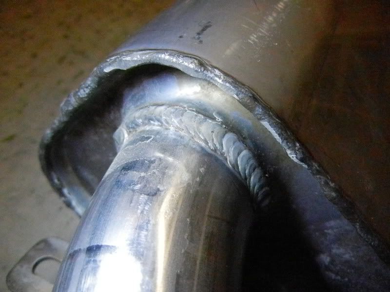

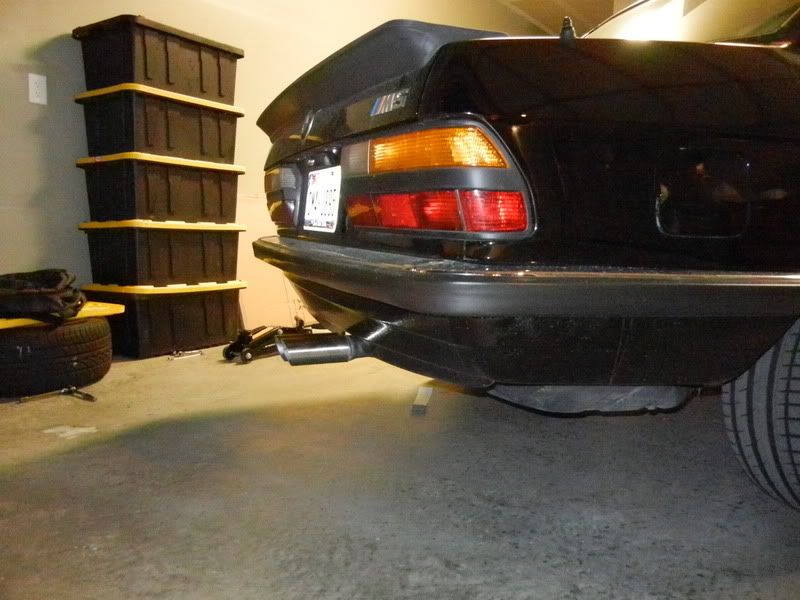

I'm not super exited about the fit of the exhaust... The way the E28 hangs the muffler is a bit dumb, and makes the thing hang a bit crooked. Plus the tips stick out too far like a 70's italian car with a ansa sport muffler system. I'd like it if the tips were about 2 inches shorter overall, and suck into the body about an inch. I feel that I should only see the tips poking out from under the body, not the welds and original piping. Later on, I might have the tips shortened, and the exhaust powdercoated black to mimic the original mufflers that came on the M5... But for now it will be quite enjoyable. It has a nice bark and gives the car a bit more "european exotic" sound over the stock muffler.
Here are a few pics of the exhaust all pretty on the garage floor, and then a video I took with the GoPro HD I recently aquired:D

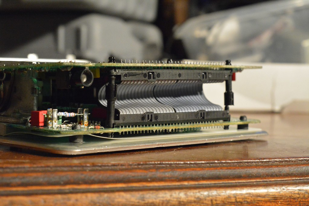

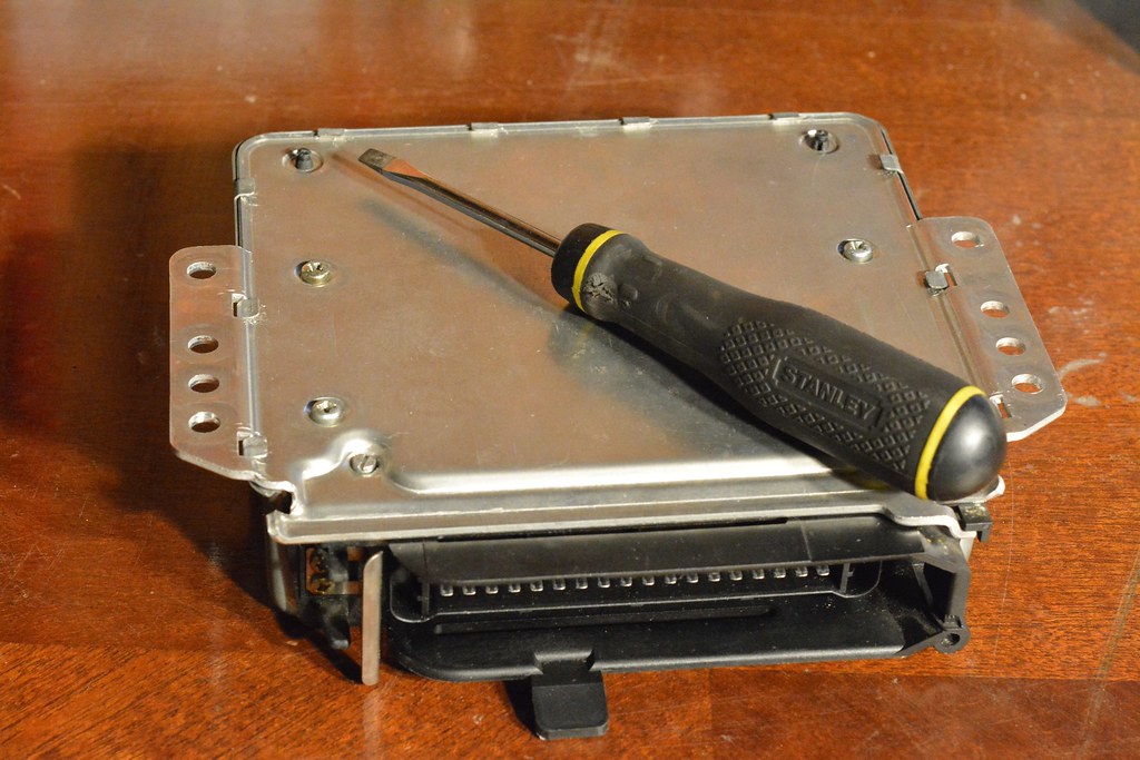

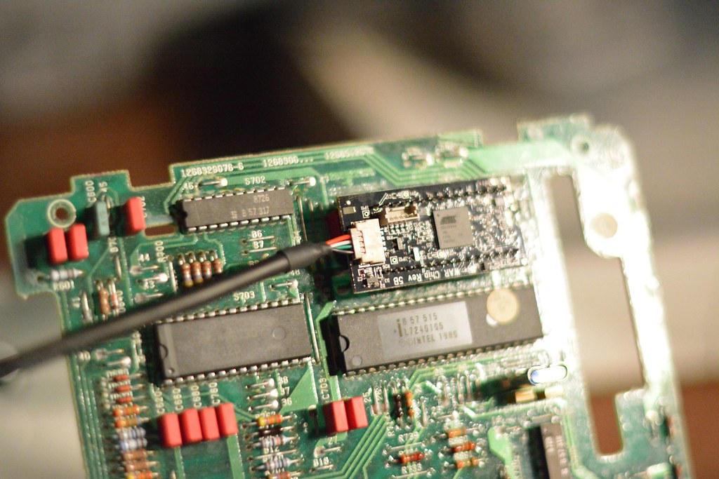

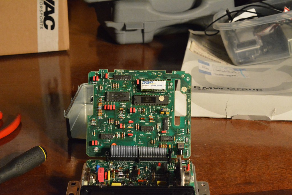

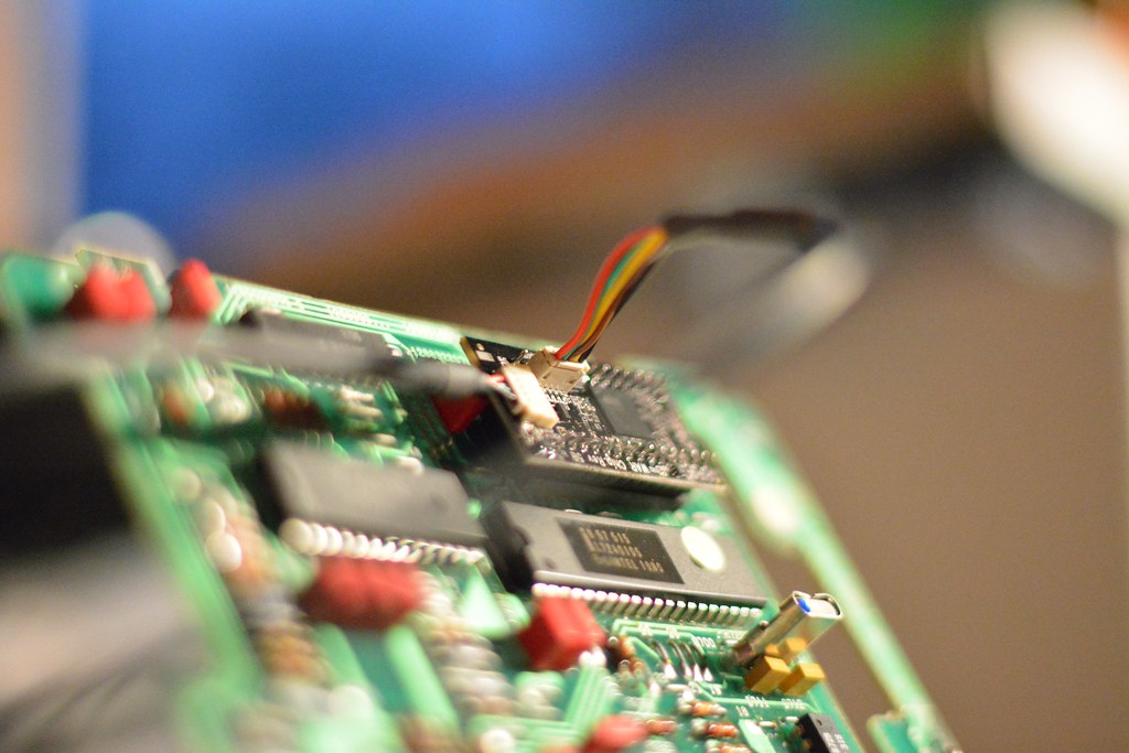

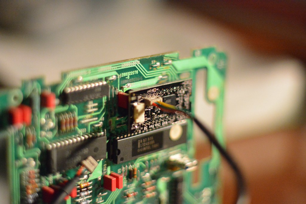

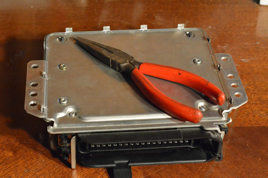

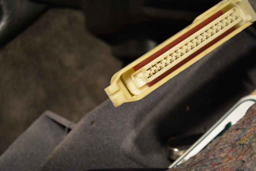

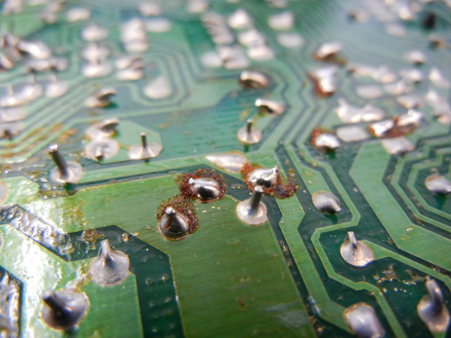

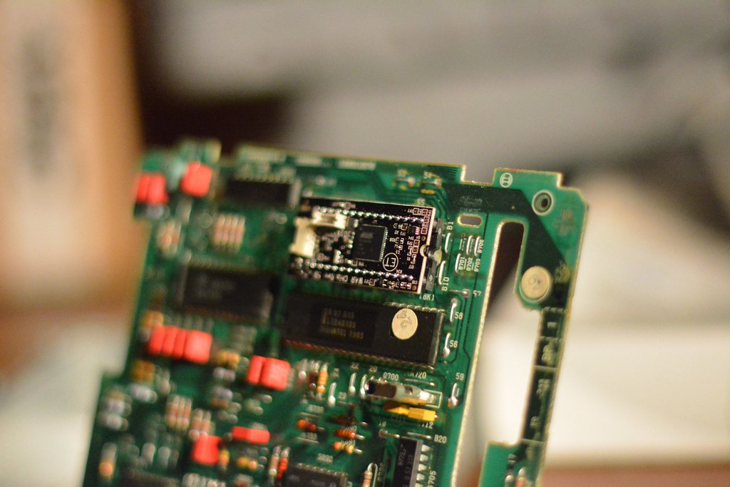

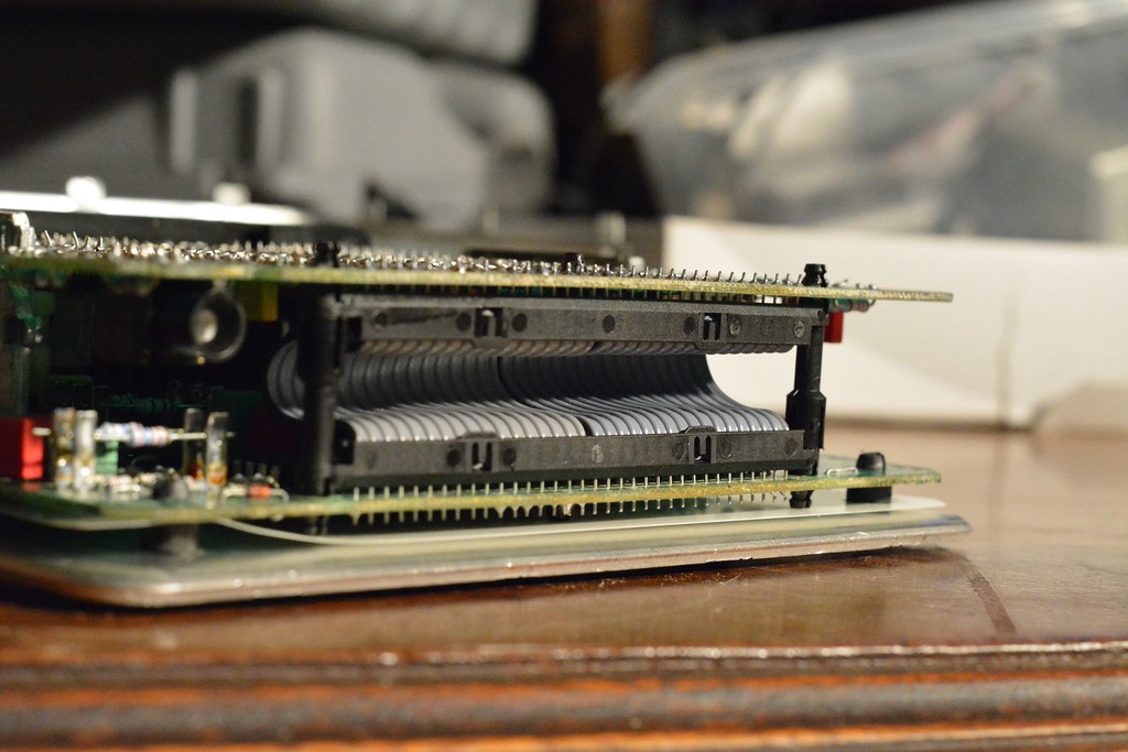

Hi guys, just as spring is here and the M5 is getting more use, it's decided to start acting up. The car completely died while driving into town today, but when I pulled over, it fired right up like nothing happened.
Here are some other symptoms:
-car stalled 3 times in the last 2 days while coming up to a stop light
-engine cuts out then immediately continues running Almost like the motor is blinking... very fast cutout/hiccup.
-I noticed the cutout/hiccup often happened with the car rolling over a decent crack in the road
-runs fine at idle, but cuts out/hickups at part throttle and cruising.
-pulls hard to redline making me think that it's not a fuel delivery issue.
-Fuel system was overhauled less than 10k miles ago

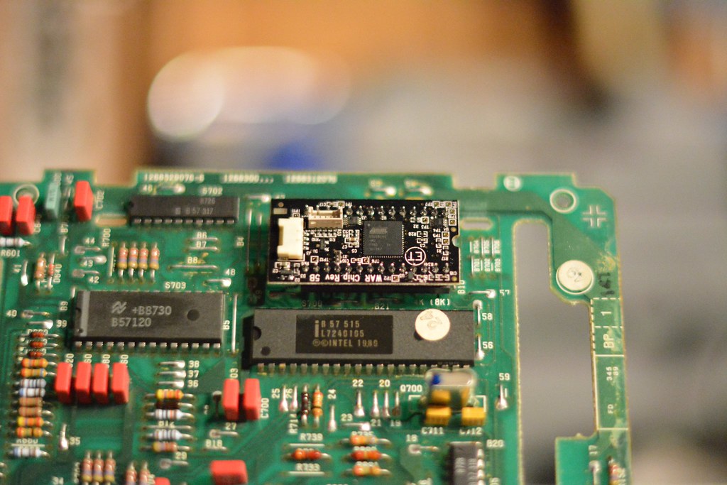

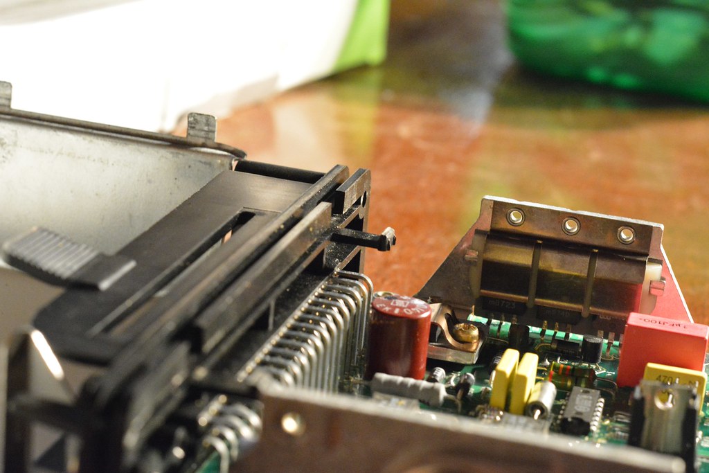

I think I'm having a ecu/solder problem however I took the ECU apart today and didn't see any cracked solder joints. I did see plenty of unoriginal solder additions, and I'm thinking that maybe these repairs might be the cause of my problems.
Here is a GIGANTIC photo of one of the solder repairs, does this look good or bad? More photo's can be seen on my photobucket album... I don't want to kill the bandwidth. http://s98.photobucket.com/albums/l254/ ... ?start=all
Thanks for the help!
UPDATE:
Just a quick update. I cleaned up and re soldered a few joints this afternoon. Popped the ECU back in and it cranked but didn't fire... Damn.
Turned the key on and let the car think for a minute, then cranked again and I heard a spuratic puff of ignition. Kept cranking for about 30 seconds total and the car sputtered to life! Soon the idle settled to the normal rythm of the S38, so I took it for a test drive. 40 miles later and I am free of sputters!
I'll continue to monitor for odd running, but I'm hopping that a little TLC on the ECU did the trick.

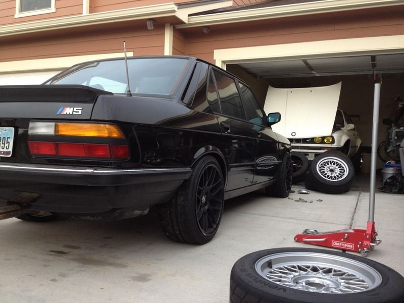

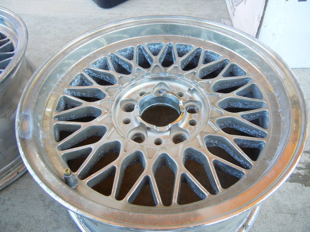

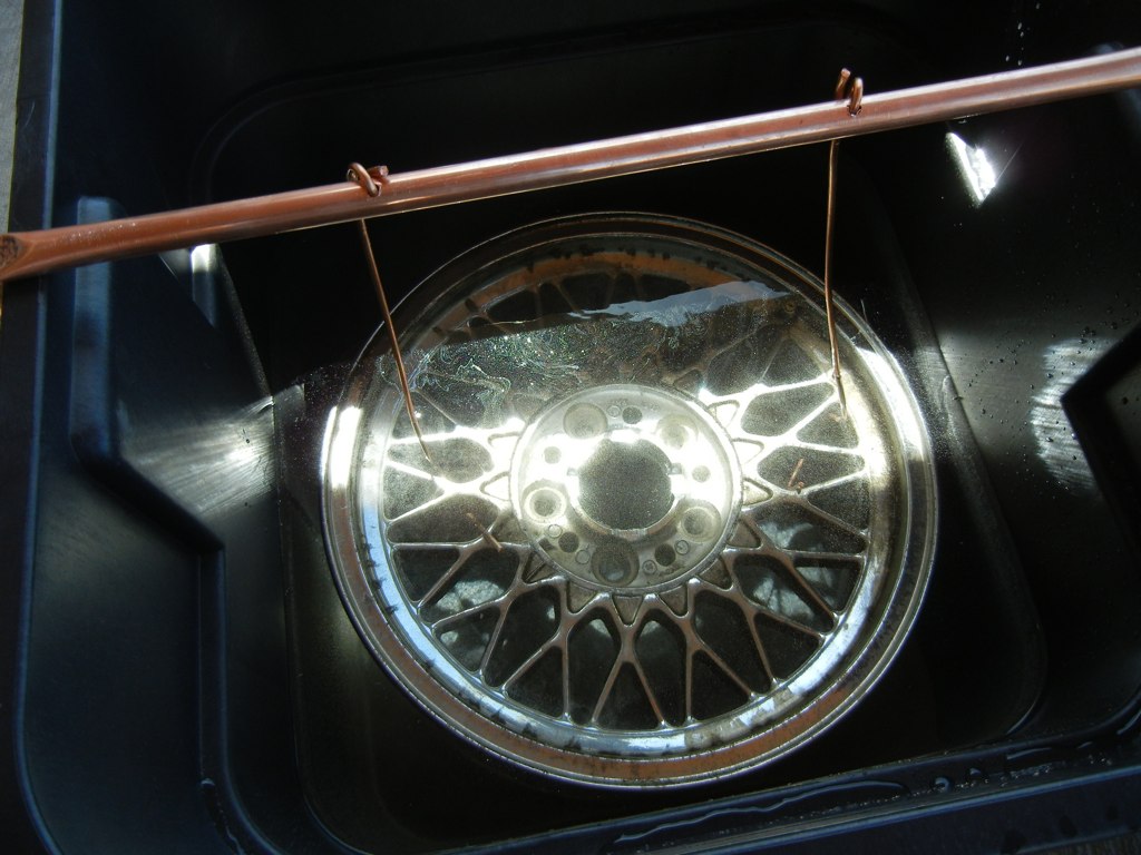

So that means today I get to work on the new wheels! I made a bit of a mistake and bought these in some dudes driveway in the dark, and didn't realize how bad the finish was.
DSCN4430 by ericandshovin, on Flickr
DSCN4436 by ericandshovin, on Flickr

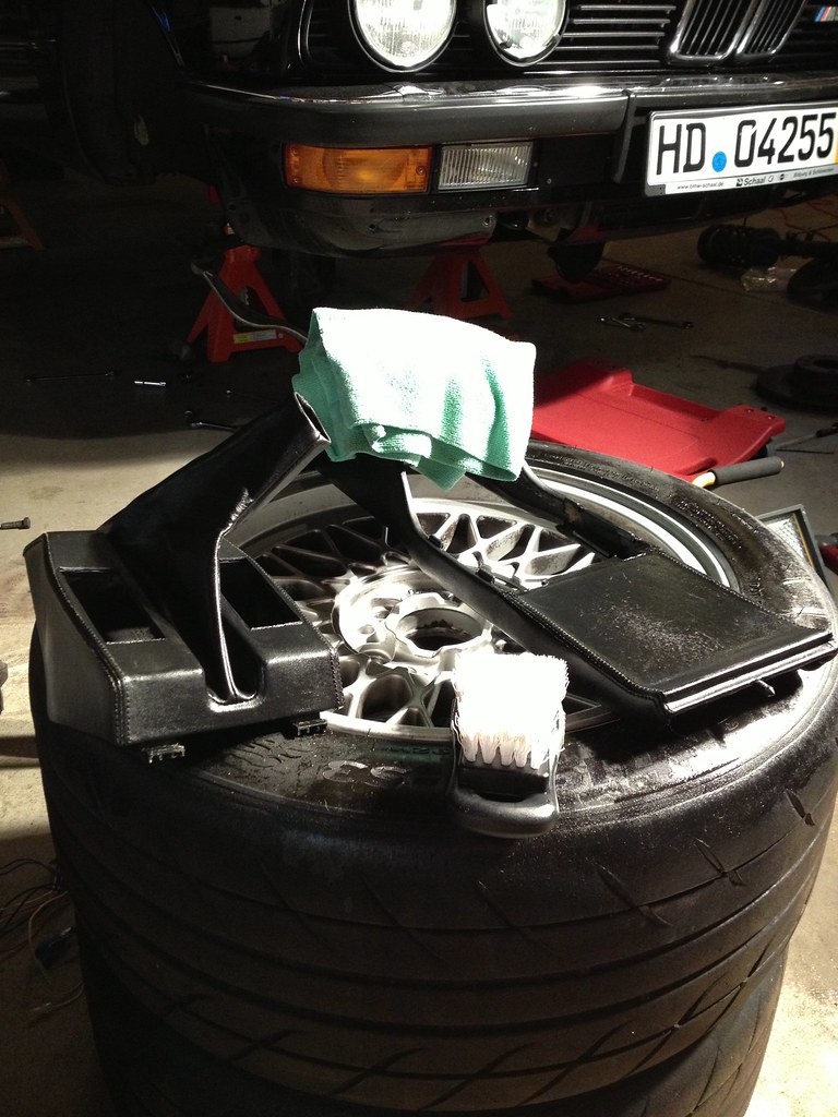

Not one to back down on a challenge, I took to google to learn how to chemically strip the chrome/nickel/copper from the wheels, then have them finished in a less hideous finish.
So right now, the first wheel has been sitting in a Muriatic acid bath for the last 30 minutes and is still bubbling... I think I might need to add more than 2 gallons of acid for more power!
DSCN4400 by ericandshovin, on Flickr
And while I was prepping the bath, Mr. UPS man stopped by!
DSCN4460 by ericandshovin, on Flickr

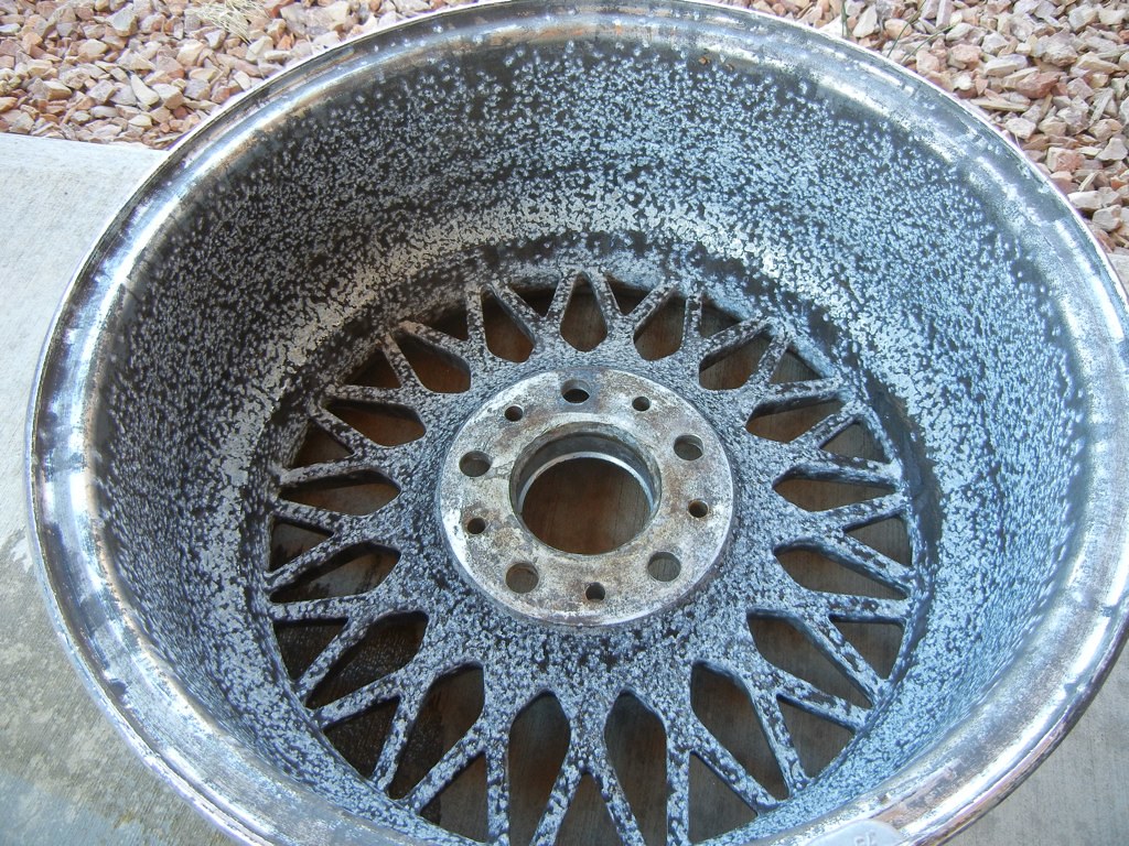

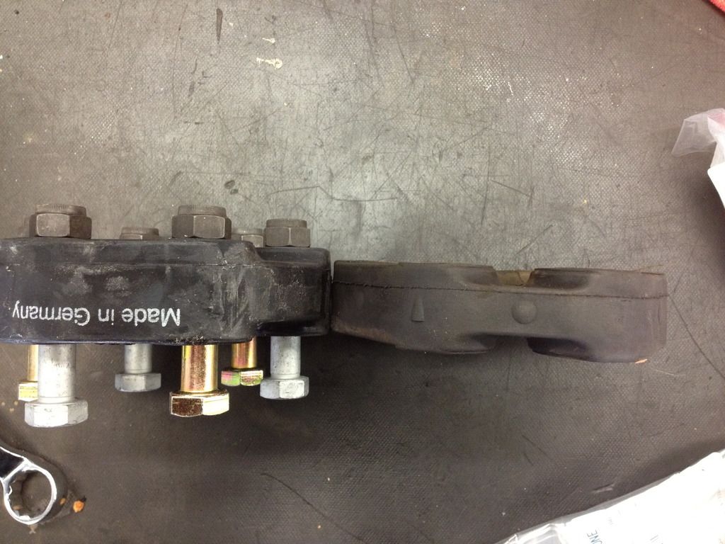

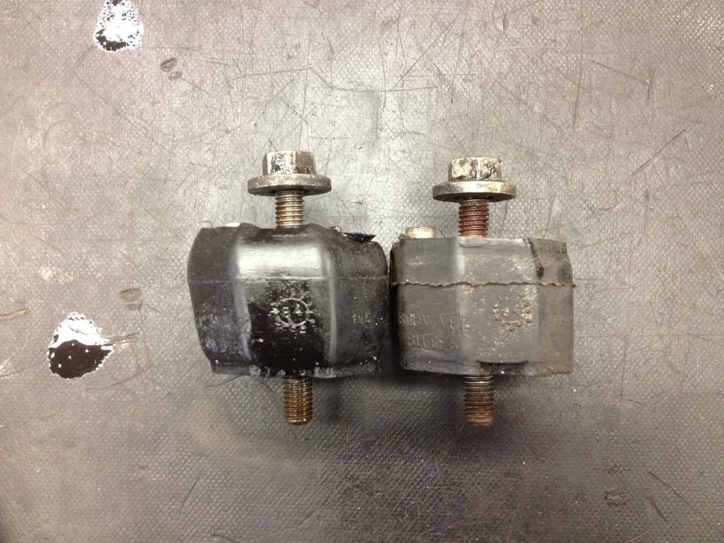

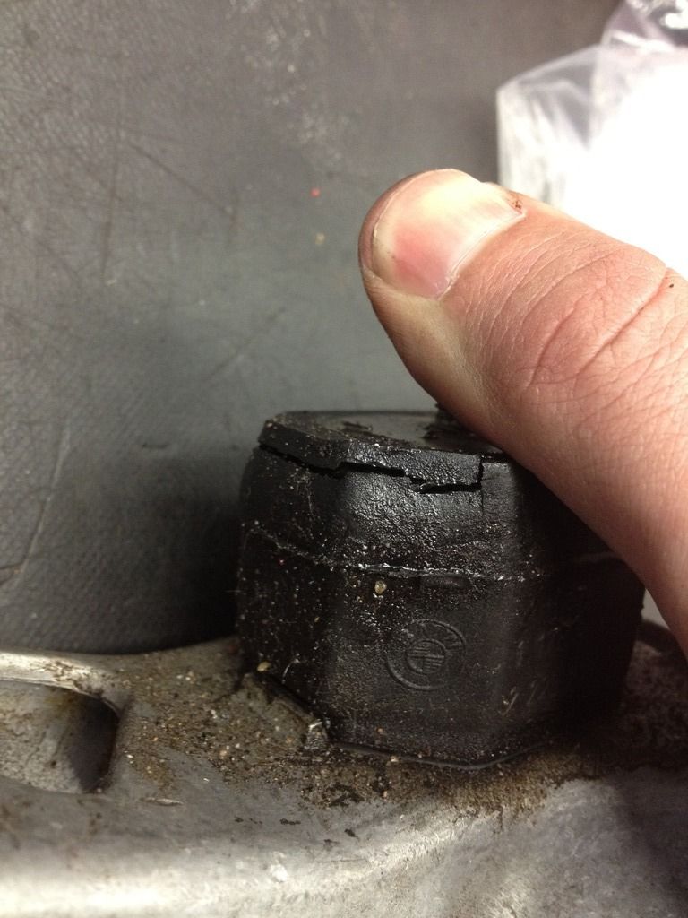

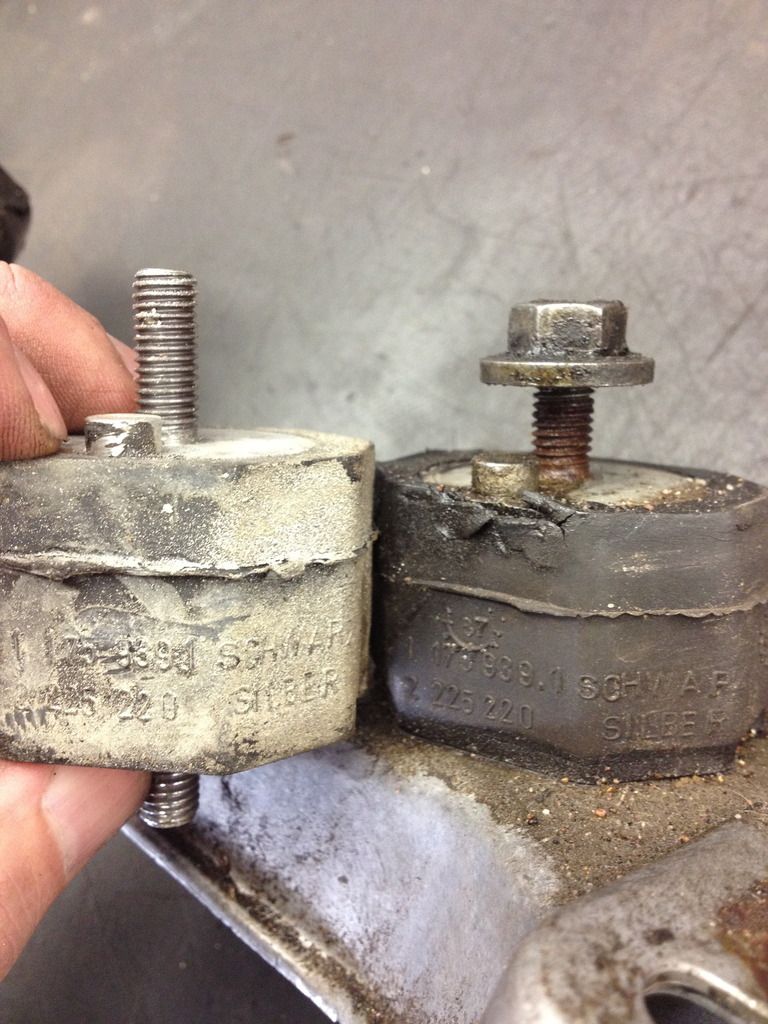

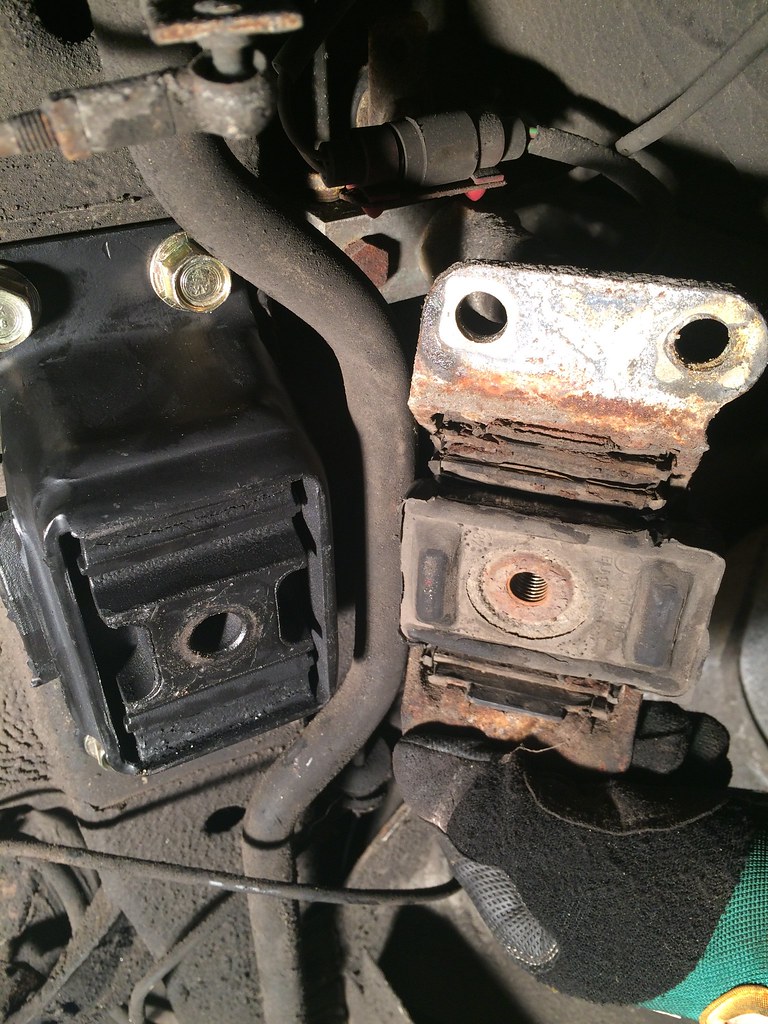

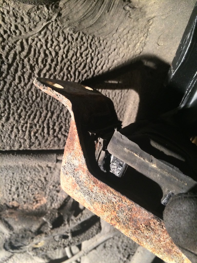

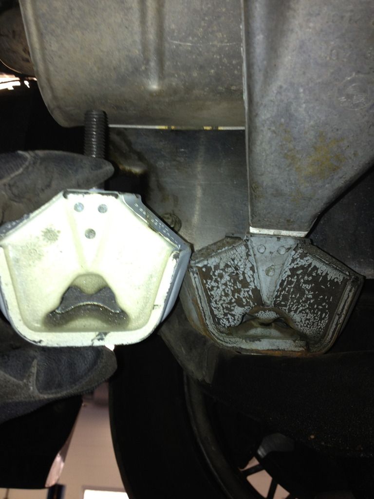

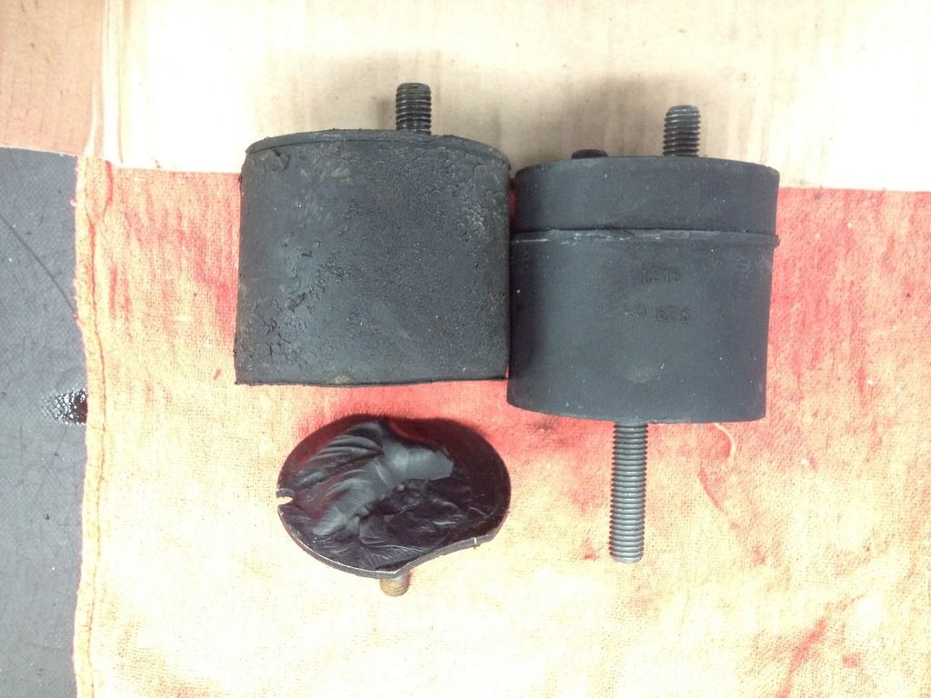

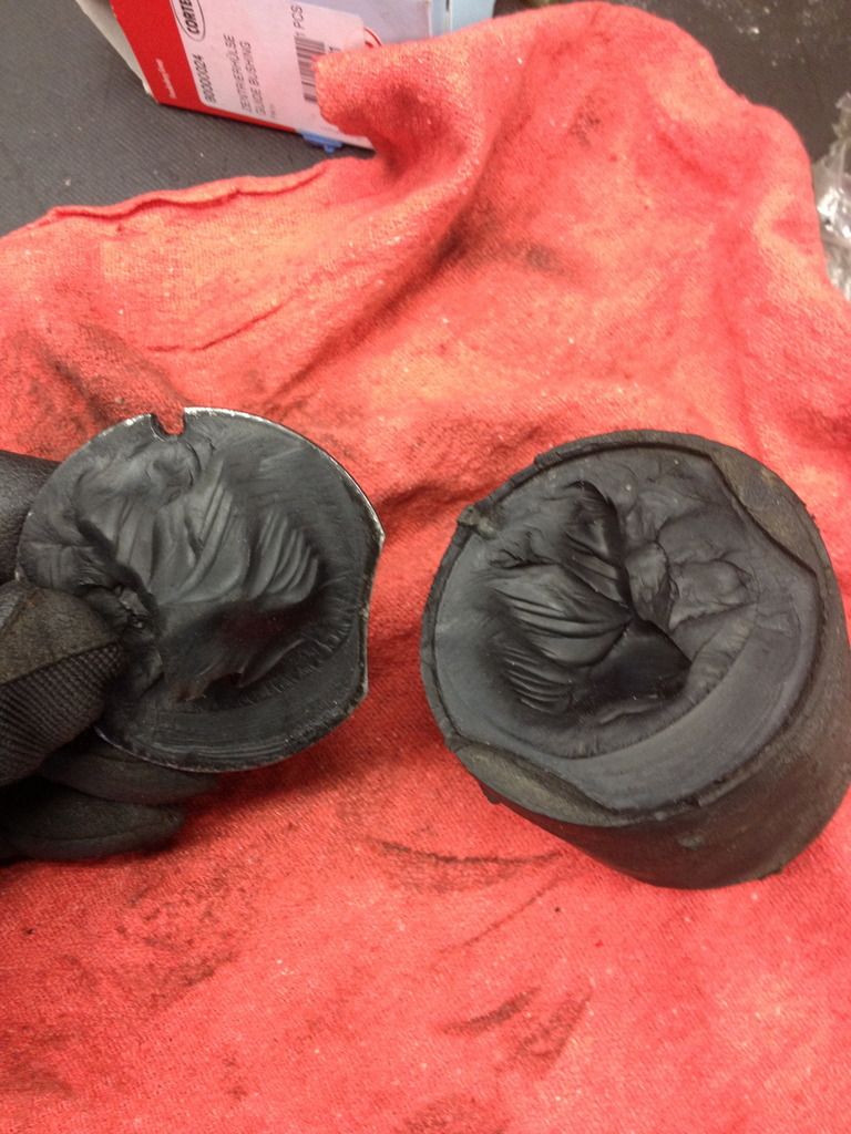

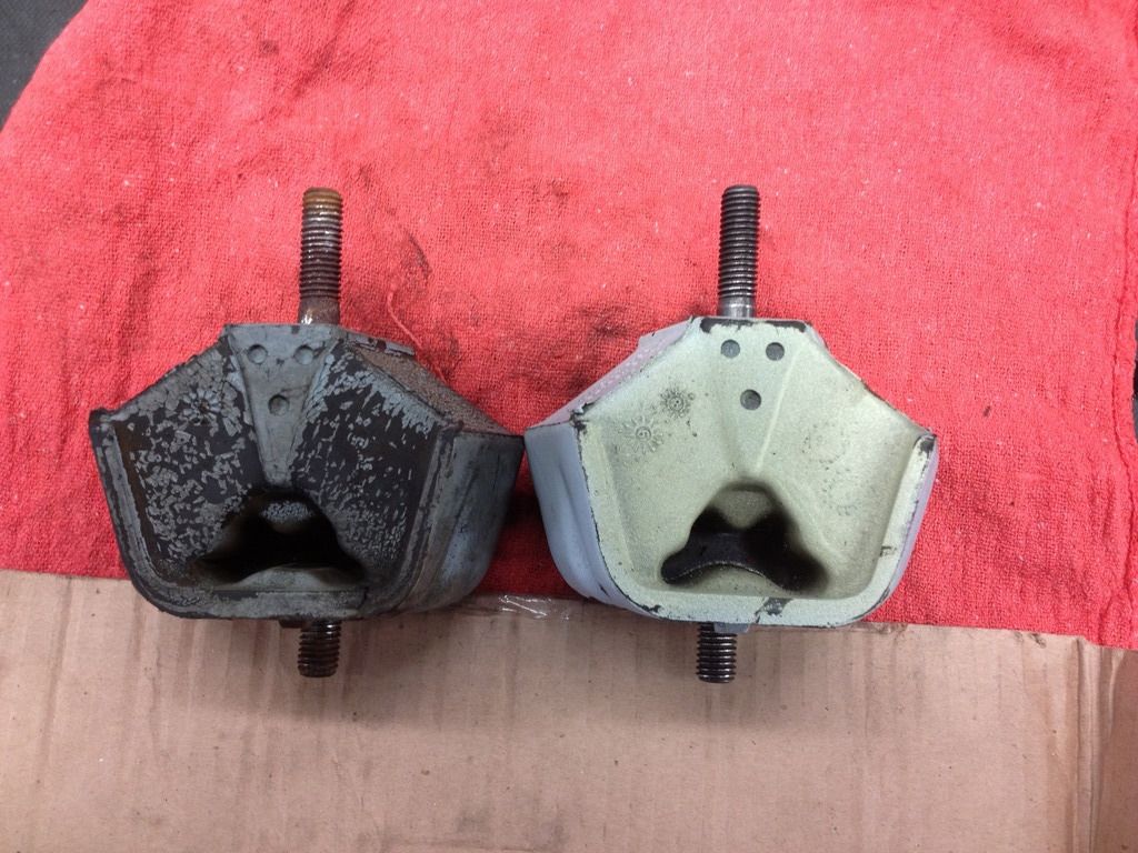

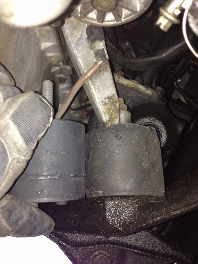

So earlier in July at an auto-x, I noticed that my engine fan had done some decorative abstract artwork on the nearly new radiator.
Not so good, so I ordered some new engine/trans mounts from Steve @ bluntech.
At first I thought that the passenger side mount was the main problem child since it looked quite compact & the fan was touching on the passenger side
The Drivers side looked pretty compressed as well!
Transmission mounts looked like they were being stressed/pulled towards the front of the car
Right one was beginning to have permanent failure.
And they were a bit squished compared to new ones.
When I got the passenger side mount out, it looked worn, but not toooo bad.
The drivers side mount though... well it had a bit more wear than I was expecting!
Compared to the new replacement mount.

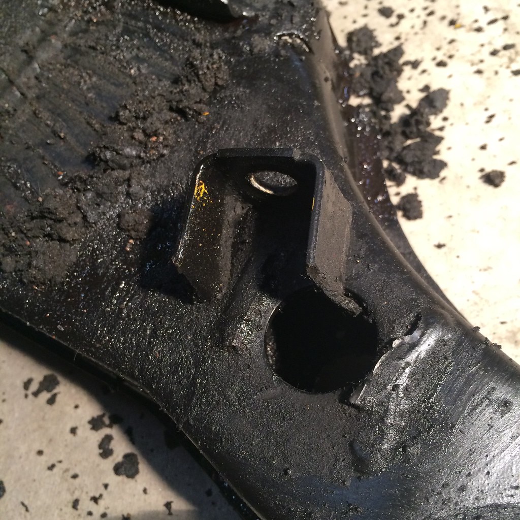

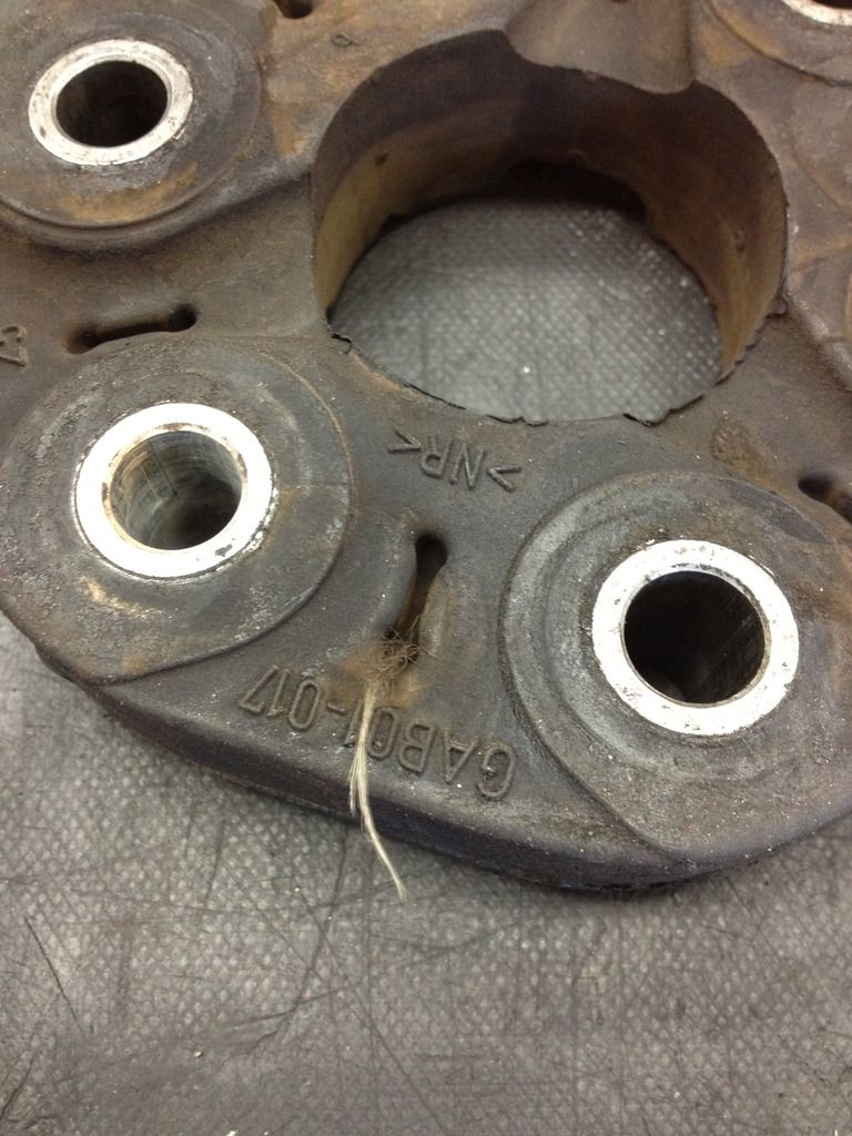

I've had a replacement guilbo disc for a couple of months waiting for a "while I'm in there" moment. I swapped out the stock E28 guilbo for and E34 M5 unit.
new vs. old.

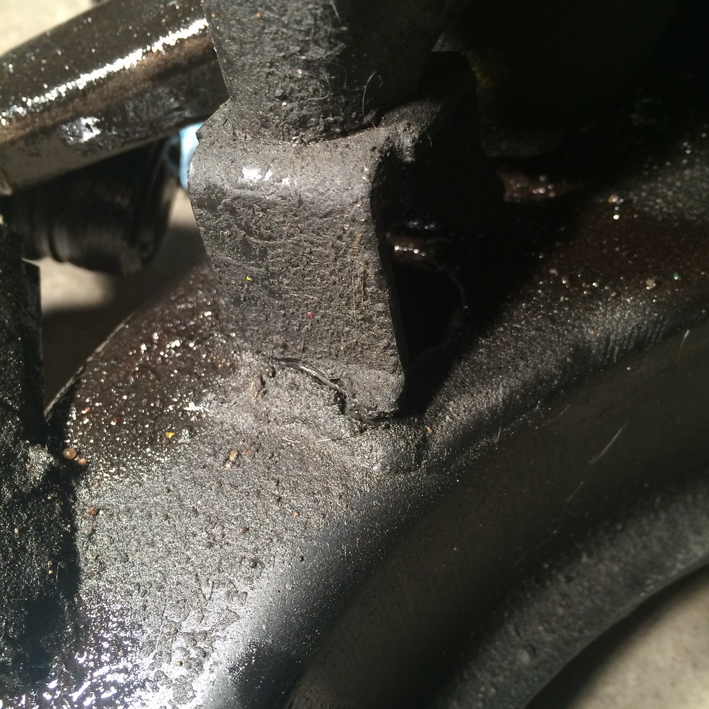

The reason I bought the replacement is because every time I was under the car, I would see more and more little hairs coming out of the guilbo. This is usually the first signs of failure.
Back in April, I replaced a bunch of parts trying to hunt down a shimmy when braking. A little while later, the right front of the car developed a clunk when turning left. I was convinced that my $279ea crash mount was failing. Well the other day I mounted the CSL reps onto the car for fun(didn't like the look) but noticed something odd when putting the 16" style 5's back on.
I noticed that the wheel was moving just a little bit from side to side. Initially I thought that I had a failing wheel bearing until I saw the strut moving with it. So a few minutes of poking and prodding revealed that the 3 bolts that hold the strut to the dogbone (bolts to the bottom of the strut & holds the control arms/tie rods) were finger tight! I pulled one out, and the threads had been smashed up pretty badly, so I ordered 6 new ones from BMW ($4.36 a bolt!). This time the bolts were given a dab of locktite, torqued to spec, and a dab of thread marker on the outside of the bolt so you can quickly see if the bolt has moved!

Little bit of an update.

I'd love to chop those Sterbo tips down to be flush with the bumper. Maybe coat it black like the factory exhaust.

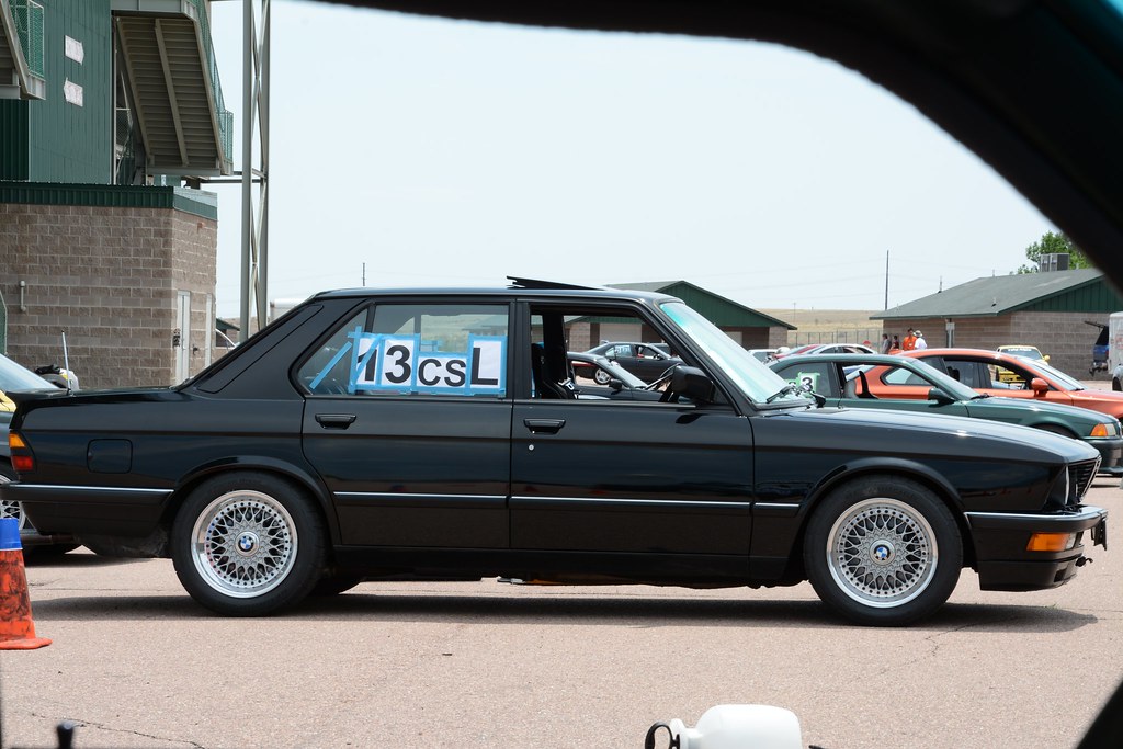

ALso, my wife attended her first auto-x and had a great time! Below are a few action shots of her.
DSC_4680 by ericandshovin, on Flickr
DSC_4683 by ericandshovin, on Flickr
DSC_5124 by ericandshovin, on Flickr

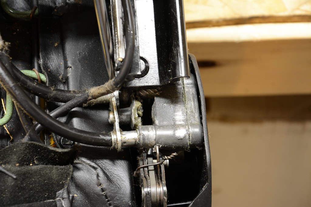

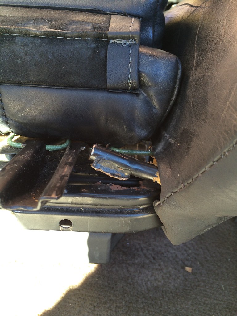

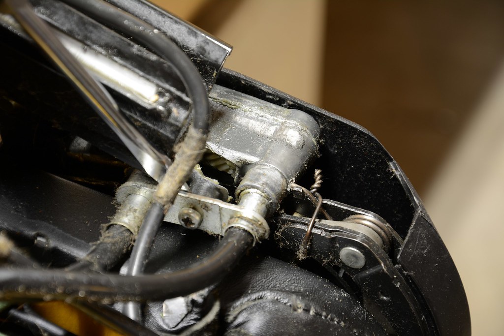

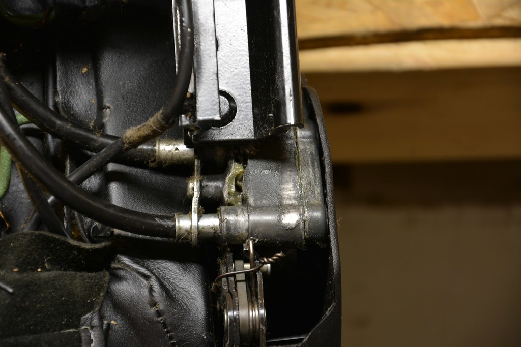

Finally tinkered with my stock sport seat for the M5... This is why it was twisting.
DSC_6792 by ericandshovin, on Flickr
Pulled back with a screwdriver
DSC_6793 by ericandshovin, on Flickr
DSC_6794 by ericandshovin, on Flickr
Pretty sure you cannot buy this part.
The fix for the seat gear was the wonderful Fox Chung loaning me his seat gear. Then a month or so after returning from O-fest, a nice fellow on here responded to my WTB thread with a set of good working gears! The internet can be so fantastic!

09 August 2013, 6 days (5 free evenings) countdown to O-Fest:
Garage time!
DSC_6837 by ericandshovin, on Flickr
Gotta do all this in 5 evenings...
- New upper/lower control arms with roller bearings instead of bushings
- New front upper strut mounts
- AKG bump steer spacers
- New brakes (Portified RS4 pads)
- New pitman arms/RTABS/Diff mount/Subframe mount

- Deep clean interior/leather while it's apart
- Fix seat & install

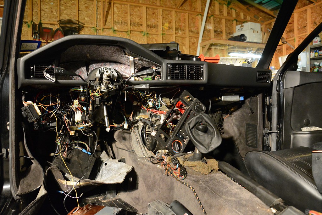

As stated a few posts up, there was quite a bit of little maintenance that I had been putting off over the last year. That includes paint upkeep, it had been almost 2 years since the M5 got a coat of wax!:hitler:
Before leaving Colorado Springs, I decided to dismantle the car. There were a few items I had wanted to fix, and a few items that needed to be fixed.
Wants:
- Remove the ugly JVC stereo
- Repair and repaint the front valance
- Clean and Condition the leather
- Find the source of a front end clunk.
Needs:
- Replace the upper/lower control arms yet again
- Replace the brake rotors/pads
- Clay/polish/wax the exterior

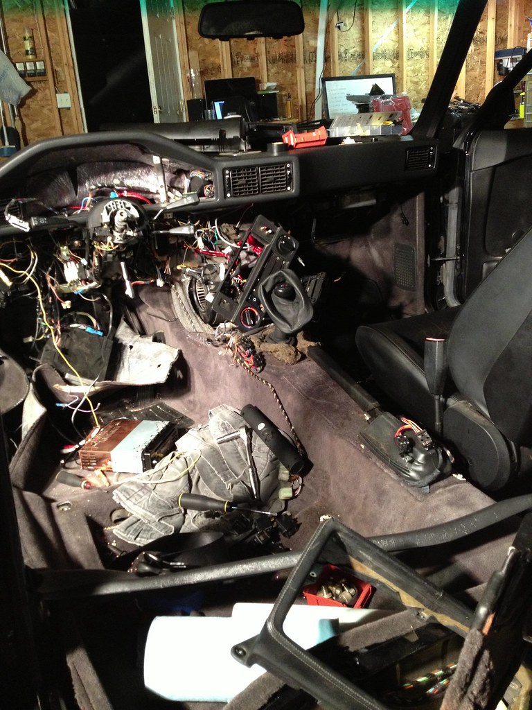

So with those goals in mind I started with the least important first, remove the ugly deck! It quickly spiraled into a deck/amp install and possibly a sub under the seat.
Old deck:
3A8A92FA-03B8-4169-80B2-DD20B0C643D0-1133-000001DDED35C6A8 by ericandshovin, on Flickr
Mid way.
IMG_2600 by ericandshovin, on Flickr

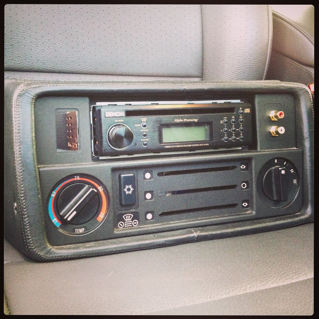

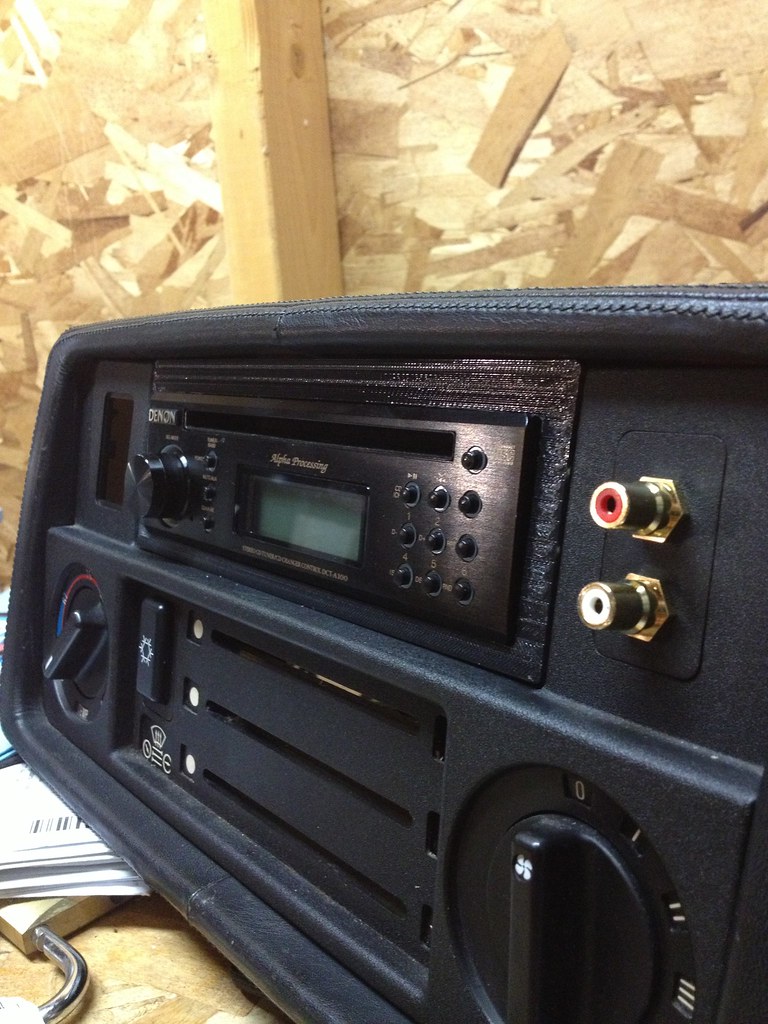

The new stereo is a Denon DCT-A100. A pretty sweet deck built for the Japan market. I looked for a black Denon deck for a long time as I liked the period correct look, and the amber illumination was a must!
IMG_2605 by ericandshovin, on Flickr

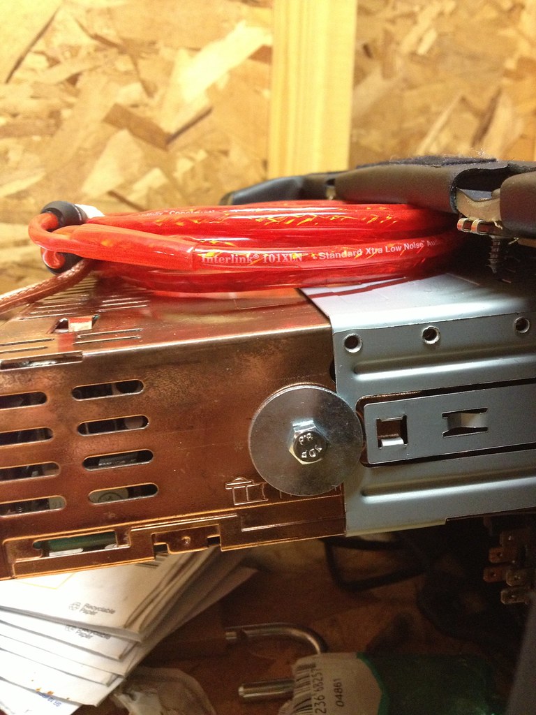

Unfortunate for a quick install, the deck has no power, so an amp is required. My time constraints made this a little more difficult, but in the long run I'm much more happy with installing some goodies that have been collecting dust in my toolbox for years. Oh yeah, the amp is a Brax x2400.2 http://www.crutchfield.com/p_875X24002S ... 745&awdv=c
First test fit/power up/sound check
Green:
DSC_6821 by ericandshovin, on Flickr
Amber:
DSC_6822 by ericandshovin, on Flickr

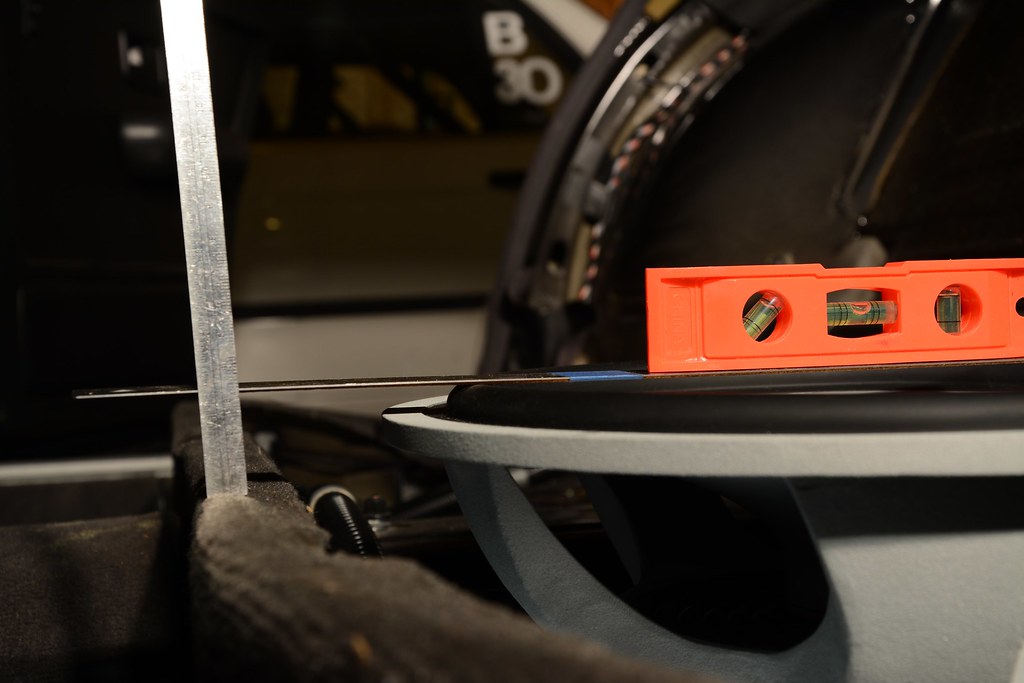

I had to remove the rear seat to run the RCA cables to the trunk area, so I contemplated doing a sub enclosure using the two brand new Alumapro Alchemy 12's I've been keeping for a good project.
DSC_6796 by ericandshovin, on Flickr
I believe this will work with just one on the drivers side as the floor on the passenger side is different to fit the fuel pump/filter, however the support bar that runs front to back on the rear seat bottom will need to be removed. I was thinking that removing a section of the bar and welding in a speaker grill would keep the support the bar provides and also protect the speaker from larger bottoms. Below is a picture of what the underside of an E28 seat cushion looks like with a adult sitting on it. You can see the support bar resting on the tires with my hefty self sitting on the seat cushion. I don't expect many people to sit in the rear of the car, so I'm not too worried about damage especially if a grill covers the sub.
DSC_6801 by ericandshovin, on Flickr
The sub sits above the pocket a bit. A shallow sub would be great in this application!
DSC_6806 by ericandshovin, on Flickr
The last time I really fiddle-fadled with a stereo was almost a decade ago, so I wanted to really do it correctly. Instead of just stuffing the RCA cables down the side of the carpet, I pulled it back a good ways and tucked the cables in with the OE wiring. Being a bit rusty, I forgot to run the remote turn on wire with the RCA's. Dang.
Those speaker cables are from the old stereo and were removed shortly after this picture was taken.
DSC_6809 by ericandshovin, on Flickr

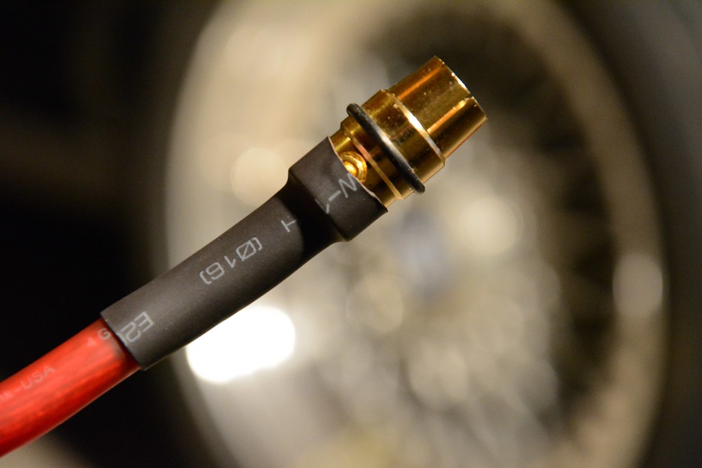

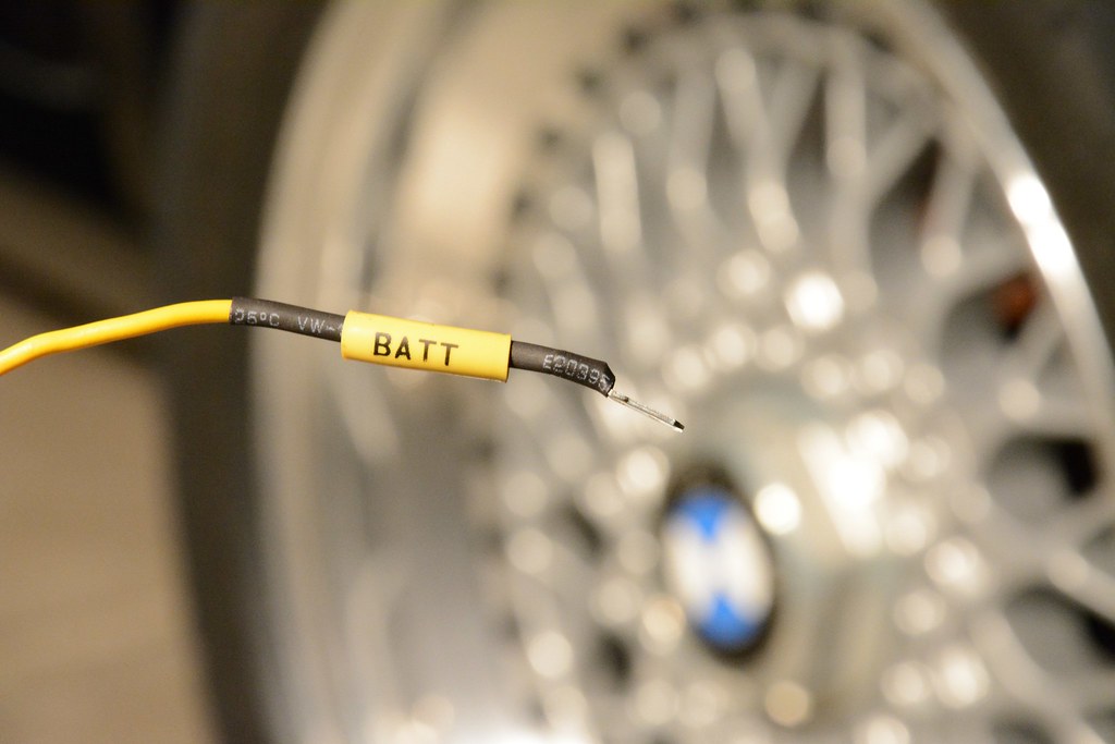

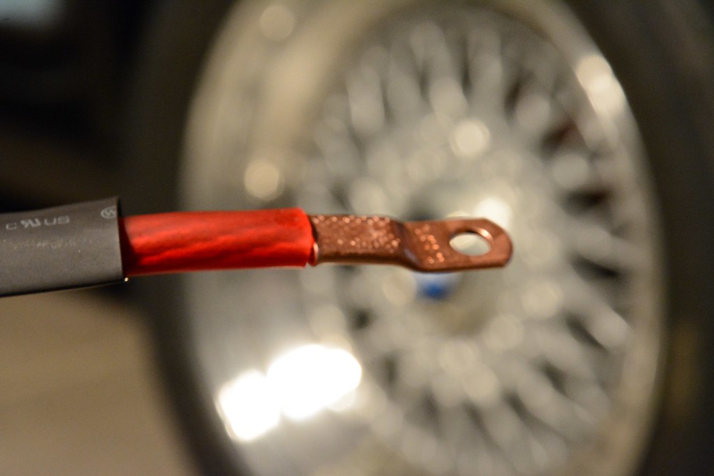

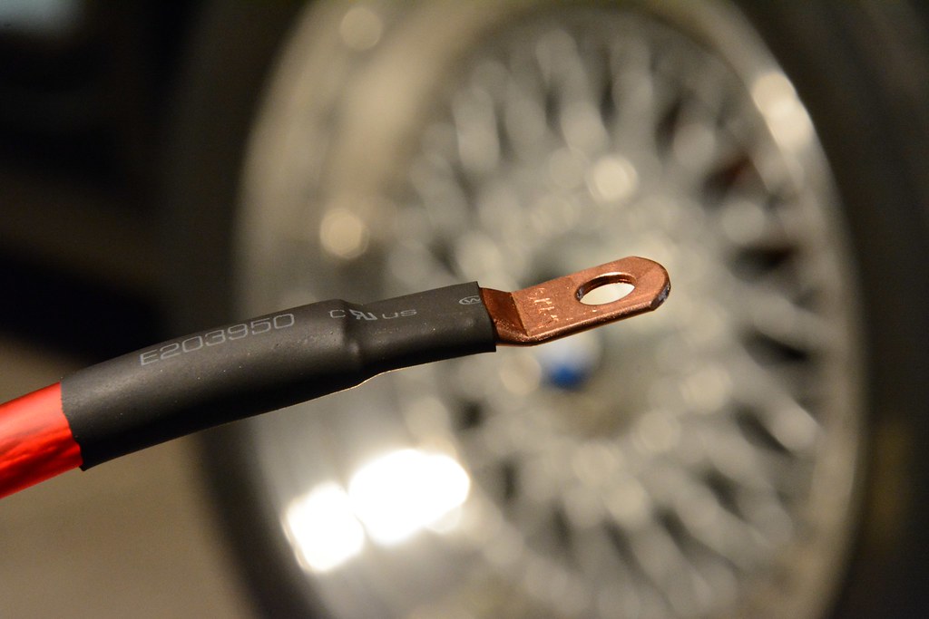

Moving on. Power cable routing... I got a bit OCD with the heat shrink.
DSC_6823 by ericandshovin, on Flickr
DSC_6824 by ericandshovin, on Flickr
DSC_6825 by ericandshovin, on Flickr

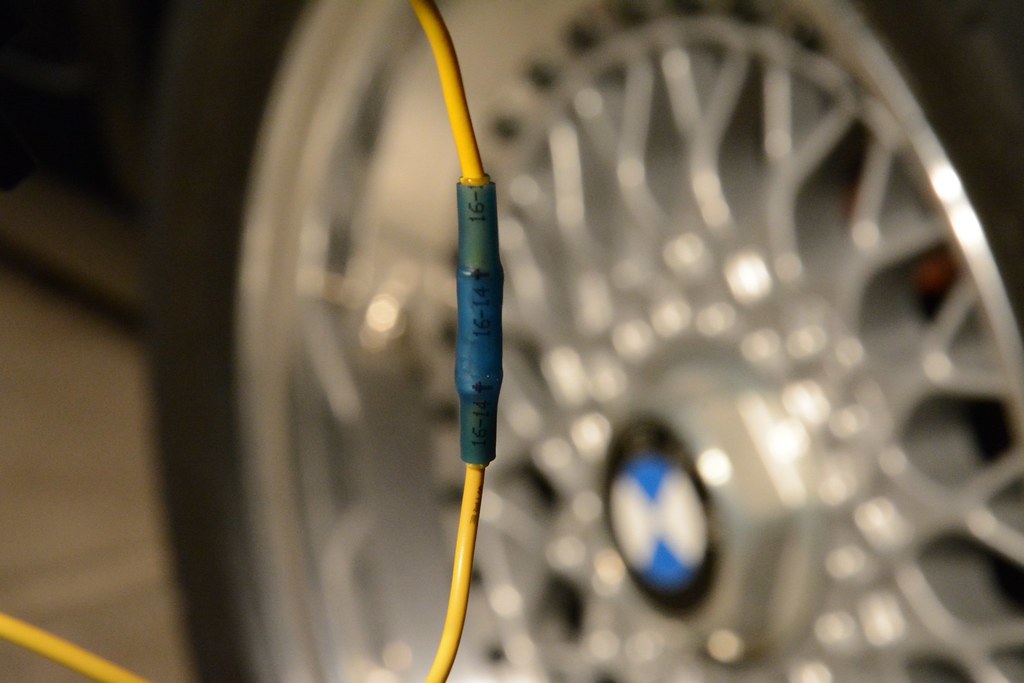

Even the deck got it's own 12v source & ground instead of tieing into the factory harness. In fact all that was used for the factory harness is ACC, illumination, and antenna power.
DSC_6815 by ericandshovin, on Flickr
I had to make the 12v constant about 18 inches longer than the wire supplied by Denon, these heat shrink butt connectors are definitely trick!
DSC_6816 by ericandshovin, on Flickr

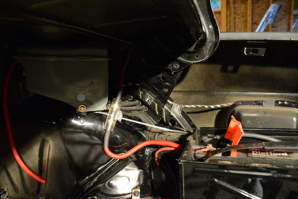

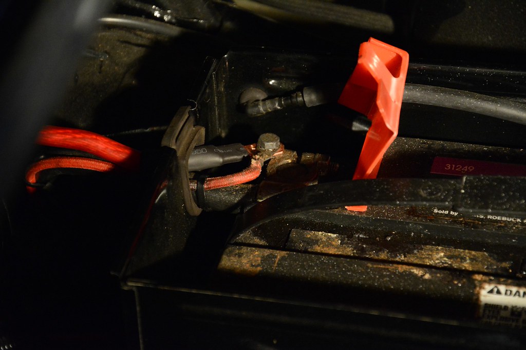

the M5 battery tray in the trunk makes running the power cable much cheaper & much easier! I've luckily never owned a car worthy of a stereo upgrade that had the battery in the engine compartment.
DSC_6826 by ericandshovin, on Flickr
I decided to attach the glass fuse holder to the support structure for the trunk hinge. This will all be 100% covered up by the unique M5 trunk panels.
DSC_6828 by ericandshovin, on Flickr
attached:
DSC_6829 by ericandshovin, on Flickr
The ground cable is done up much the same as the power cable, I must have forgotten to snap a few pictures of it, but you get the idea. Ground was run to a factory ground in the trunk area and is a very solid. I also didn't get very good pictures of the completed amp install (I'll update the thread later) but it's basically installed on the underside of the rear parcel shelf. 4 rivnuts and a few 2 inch long bolts give it enough stand off to clear the trunk springs. My Iphone came in great help as I was laying in the trunk I realized that I wasn't sure which slot on the amp was for ground and which for 12v power... a mistake I didn't want to make! So I put the phone in selfie mode and snapped this photo!
IMG_2650 by ericandshovin, on Flickr
This is a good arm work out after an hour or so!
IMG_2651 by ericandshovin, on Flickr

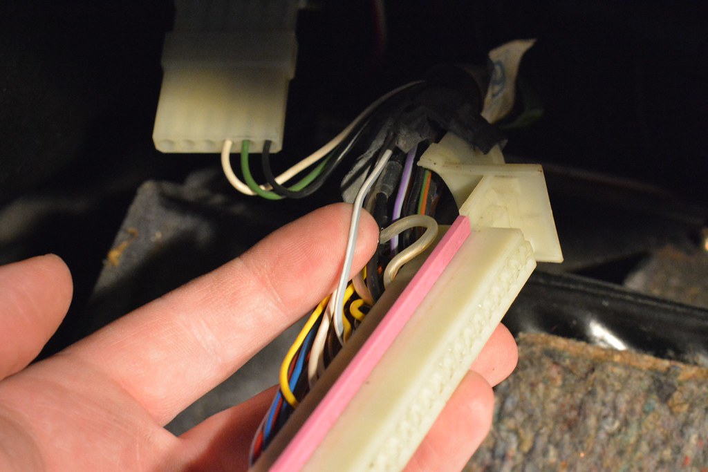

With the amp done, all I had left to do was put the dash back together. My friend Greg who is doing a ridiculous rebuild on his 1993 M5 (http://www.m5board.com/vbulletin/e34-m5 ... d.html)was very kind, and 3D printed a trim ring for my deck in a very very short time. We are talking about CNC machining a piece of aluminum, then anodizing it to match the deck next round.:eeek:
IMG_2662 by ericandshovin, on Flickr

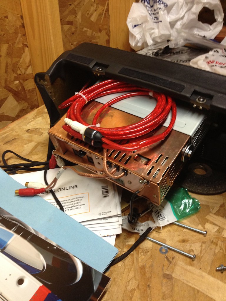

Because the stereo is from Japan and used, it did not come with a cage so I had to bolt it to the cage from the side. This means that if I ever want to remove the stereo again, I have to pull the entire center console out... quite a bit more complicated than an E30 center console too!
IMG_2663 by ericandshovin, on Flickr
Also found a nice space to tuck the aux imput cables out of the way. There isn't much space between the deck and the hvac guts, so this was very helpful.
IMG_2659 by ericandshovin, on Flickr
All back together and everything working the night before leaving for CA!
IMG_2665 by ericandshovin, on Flickr
Future stereo plans include something for the front stage that compliments the quality of the deck and amp. Factory is a 4x6 plate with a 4" round, I'd really like to do something a bit larger, but I really don't want to cut up the car and kick panels usually don't look that great. Also figuring out what to do with a sub, either using the alumapro, or getting 1 or 2 shallow mount subs for under the seat. The goal is as OEM looking as possible, and using as little trunk space as possible. The final move is do move the amp to the back wall of the trunk so it can be shown off a bit.

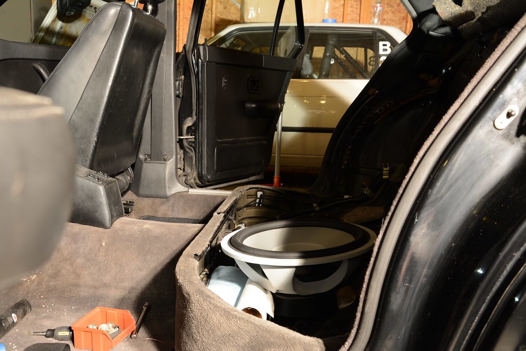

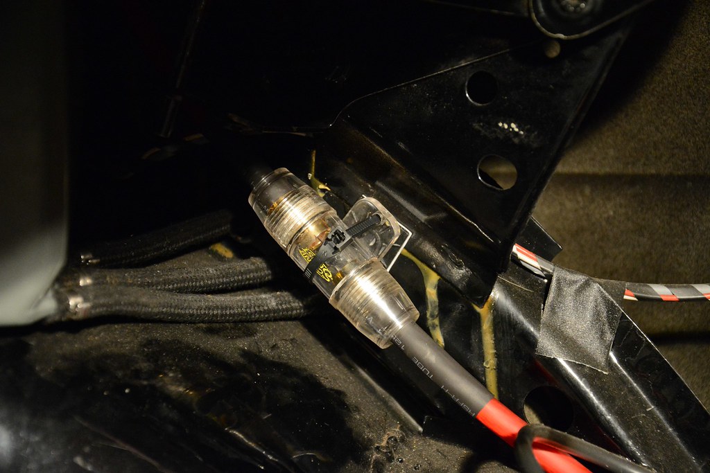

attached:

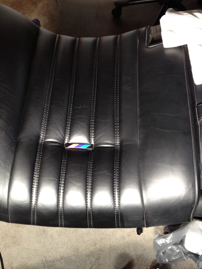

Before the drive out to CA though, I figured I could scrub down all the leather on my own. Most of the interior was out due to the stereo ambitions Anyway, so cleaning all the nooks was far easier while out of the car.
I used Fiebing's saddle soap to clean the leather, and Lexol conditioner to rehydrate the hide. I got decent results, but next time I'm going to try Color-Plus products. On a side note, the Fiebings spray bottle is by far the best spray bottle I've ever used!
IMG_2636 by ericandshovin, on Flickr
Here is a before after with the cleaner/conditioner. Untouched is on the right
IMG_2634 by ericandshovin, on Flickr
By the way, there is A LOT of leather in the E28 M5, a lot more than I had realized. Everything below the dahsboard is leather, door cards and of course the seats. I used the entire bottle of Fiebings Saddle Soap on just the one interior!

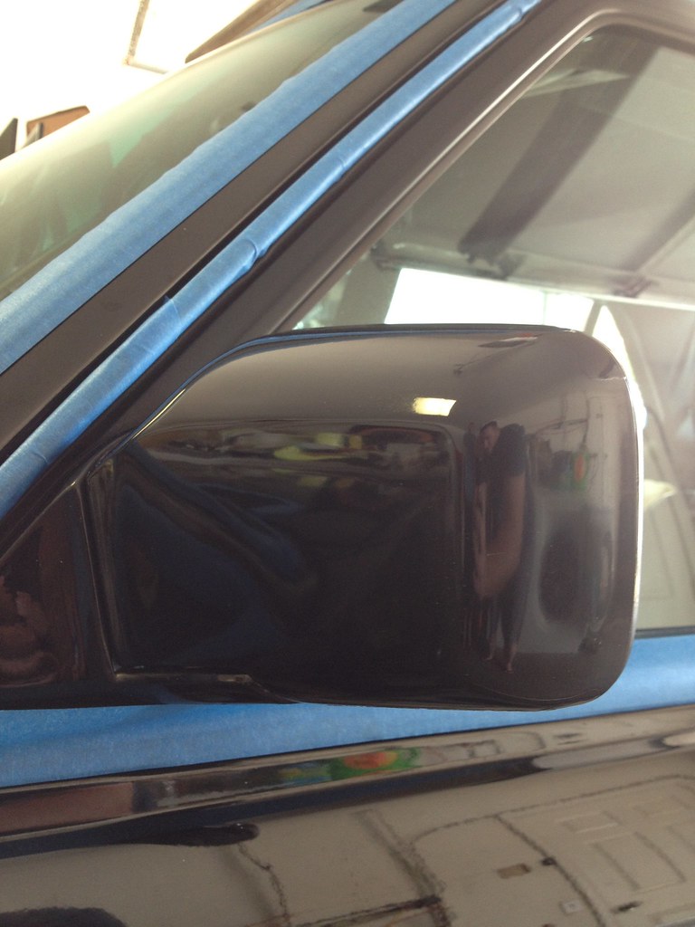

Mirror before:
IMG_2710 by ericandshovin, on Flickr
Mirror after:
IMG_2709 by ericandshovin, on Flickr

We spent a good 12 hours on the car, and it really shined up nicely. The right rear door that was dull a noticeably different shade of black wasn't the only spot that really came around. The mirrors were soo dull that I thought they were just black plastic, like a 325e! Rich brought those back to life, and to think that I was considering having them repainted! The back of the trunk lid (part with the badge) was also badly oxidized and shined up very nicely.
Mirror before:
Mirror after:

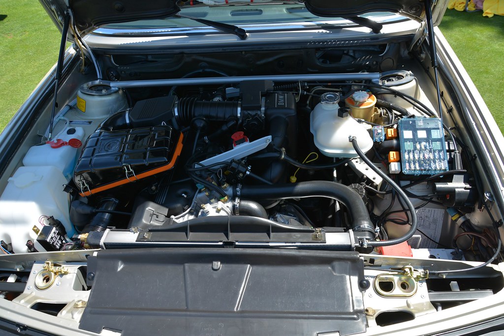

even the engine bay was spotless!
DSC_6901 by ericandshovin, on Flickr

Unfortunately I have no update for the TSD Rally. Jim Bair and I were planning on running the TSD rally together, but about a mile from the launch point of the rally, the M5 decided to quit. A very expensive tow and some stern words from the CHP officer who happened to stop by resulted in a return to the hotel.
IMG_2721 by ericandshovin, on Flickr
Luckily, Jim is incredibly nice man, who know's a good amount about old BMW's. His M6 and M535 are time capsules and kept in exceptionally clean shape. About 2 hours of fiddling with fuel pumps, relays, fuses, caps, plugs, etc. I clunked my knuckle against the ECU out of frustration... And the car came to life!
Great, we know the problem, but now how to fix ECU solder joints again? Google and a half dozen phone calls returned one guy in the entire Monterey peninsula who still works on electronics. I rang him up, told him my sob story and in no time we had the ECU dropped off at his place with a guarantee of it being done in a few hours. To waste a bit of time we had a bit of clam chowder on the pier, and had a look at all the million dollar machines being loaded up after auction week.
IMG_2723 by ericandshovin, on Flickr
IMG_2726 by ericandshovin, on Flickr
IMG_2722 by ericandshovin, on Flickr

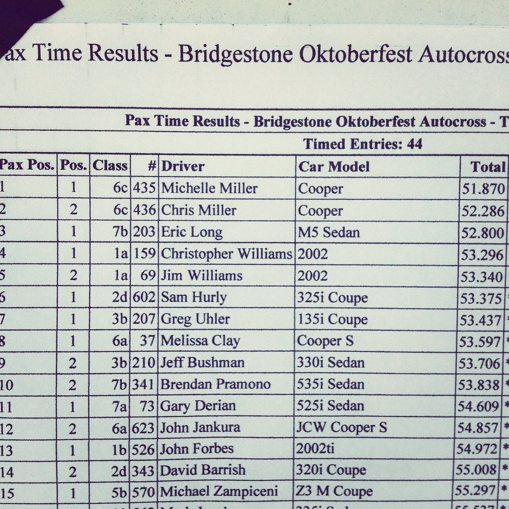

I don't think I compiled a video of the auto-x course, but it was tiny! The San Diego chapter did a good job putting on the event and working with the small paddock of Laguna Seca as the course site. Not sure who's desk it lands on, but there were a few last minute schedule changes that were not well advertised and caused two issues for the Thursday participants (non M3 cars). 1. Some people showed up at the wrong time not knowing the day was split into two heats. 2. Because the day was split in two, not very many runs were part of the competition. In the end, it's a fun, friendly event and those things shouldn't matter... except FTD (Fastest Time of the Day) wins a set of Bridgestone tires! That's my version of black gold, and I had gold rush fever!
Unfortunately for the M5, a tiny tight course is not it's strong suit, and a little MINI on Hoosiers cleaned up the competition pretty easily. I finished first in my class and I think 5th overall after both morning and afternoon runs were tallied up. Here are the results after just the morning runs.

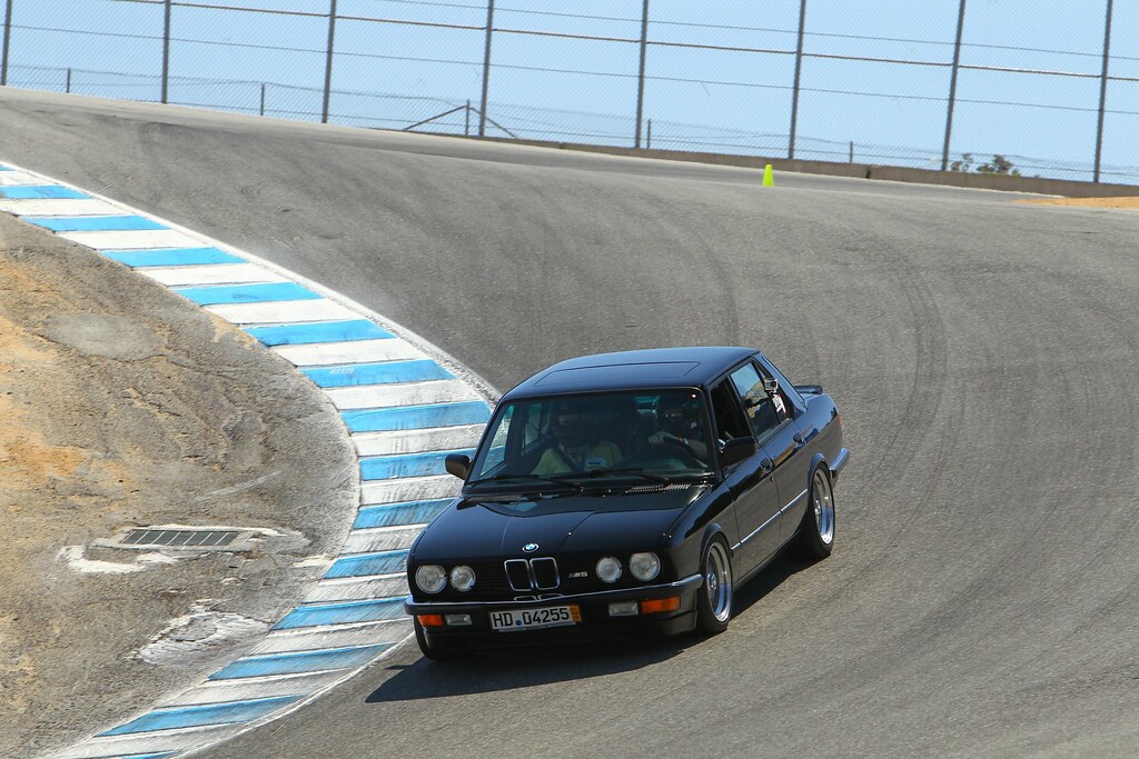

I must be honest, the deep clean the M5 received, the day on the golf course, the auto-x were all fun, but the reason I drove 1,300 miles was really only for one reason... Mazda Raceway Laguna Seca.
The M5 was an HPDE champ, and hunting down E46 M3's and even closing the gap on E90 M3's was a blast. I'm probably making every driving instructor reading this cringe reading that last sentence, but honestly, the capability of this old car is truly astonishing! I learned a ton in the two days of instruction and the M5 never missed a beat.

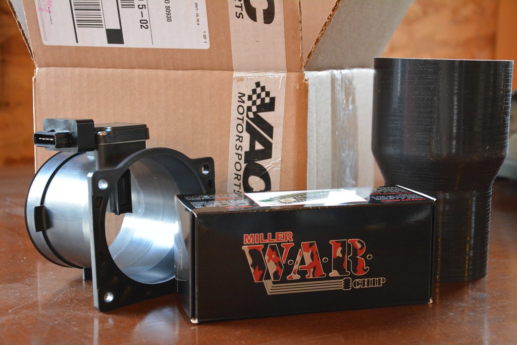

Below is what Arrived after a decent wait (ordered in August, arrived in early November) as Miller apparently is having a hard time with production keeping up with demand. I think there are worse situations in this world than too much demand!
-Miller WAR chip (quality piece!)
-Millers custom 4" MAF that plugs straight into the old AFM plug.
-4" to 3" silicone reducer made specifically for the gap between the MAF air plenum.

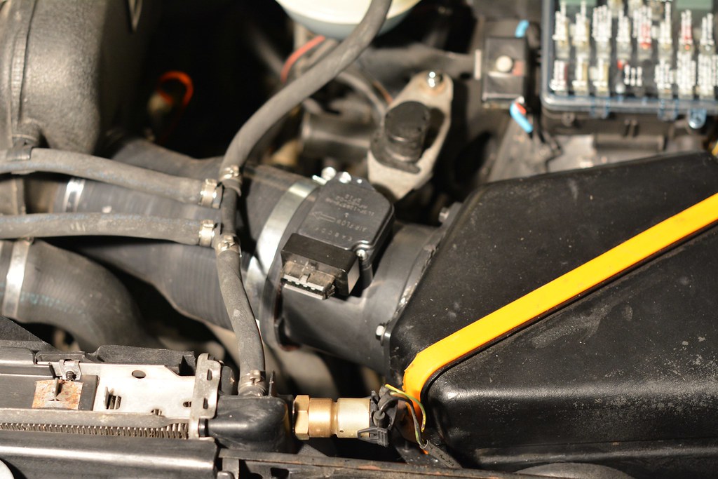

MAF Installation:

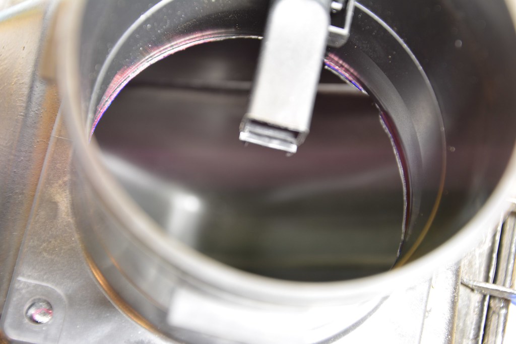

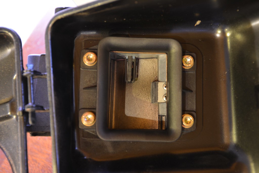

Removing the airbox and AFM is quite simple. Undo two hose clamps, remove the plug connecting the AFM to the engine harness, and undo a 10mm nut on the right side of the airbox. The most difficult part of removing the airbo/AFM is the coolant return lines get in the way a bit. You can wiggle around them, or just remove the hose connected to the coolant reservoir to gain more access. I am terrible at installing those push lock hose clamps, therefore I elected to wiggle the whole assembly around the small coolant lines.
Once you remove the airbox & open it up, you can see exactly what the S38 breathes through in stock form.
DSC_7540 by ericandshovin, on Flickr

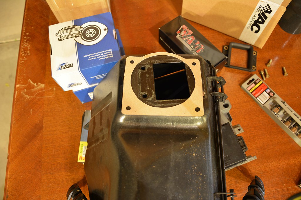

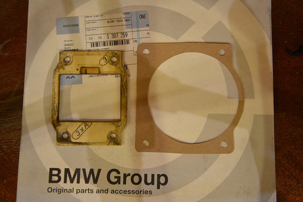

I didn't want to just go buck-wild with a grinder, so I made a little template using a sharpie and an old document envelope to trace out the MAF. This type of cardboard is thin enough to easily cut, but stiff enough to keep it's form. Cereal boxes work well for templates too.
IMG_3506 by ericandshovin, on Flickr
Cut out with a razor blade, and compared to the AFM's gasket.
DSC_7541 by ericandshovin, on Flickr
Comparing the template to the original opening it becomes clear that the new MAF is significantly larger than the OE AFM. The internet can argue until it's blue in the face whether or not the S38 should have a 4" MAF or a smaller one. I'm not an engineer and have not studied fluid dynamics so I'll reserve judgment.
DSC_7542 by ericandshovin, on Flickr
After the initial cut using a dremel, I was a bit conservative, so a little bit more needed to be trimmed. To cut the metal I used the cutoff wheel to remove a bulk of the metal, and the "561 Multipurpose Cutting Tool" to trim it down to size making sure I kept my fingers well clear of the spinning digit shredder.
DSC_7544 by ericandshovin, on Flickr
Once the big hole was cut, I drilled 3 new holes for the bolts to secure the MAF to the airbox, and made a quick trip to Lowe's to grab some new M6 nuts and bolts that were the correct length. Lowes/Home Depot's metric selection is usually quite terrible, but in this instance they had some nice black bolts with washers already attached in the "automotive" drawer. To me, this makes the install look more OEM and draw less attention.
To seal the MAF to the airbox, I used a bit of black permatex gasket maker and bolted it all together letting it sit overnight. I have a 1 year old and a 4 year old so my garage time is usually pretty limited.
IMG_3258 by ericandshovin, on Flickr

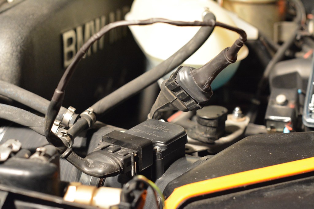

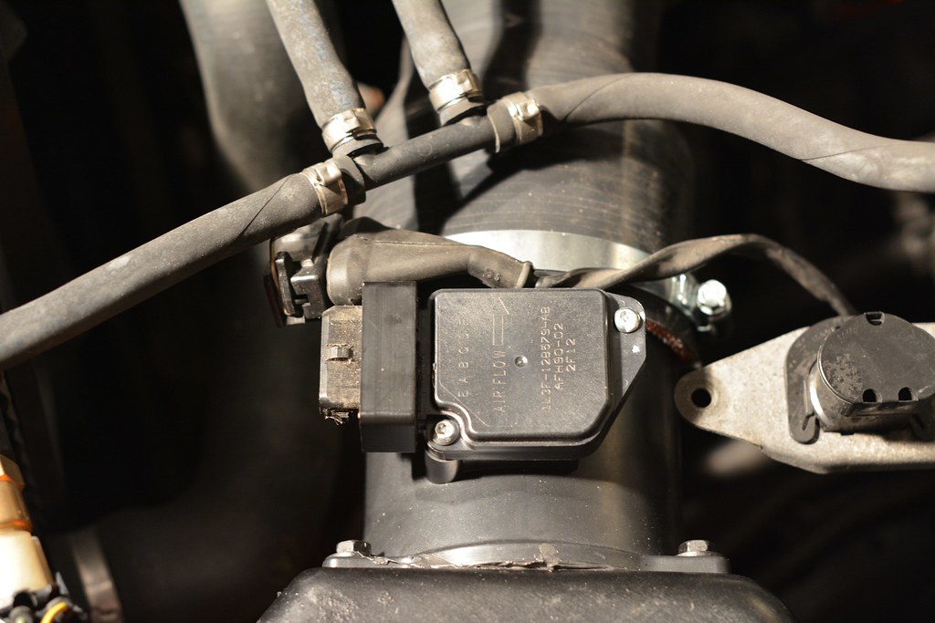

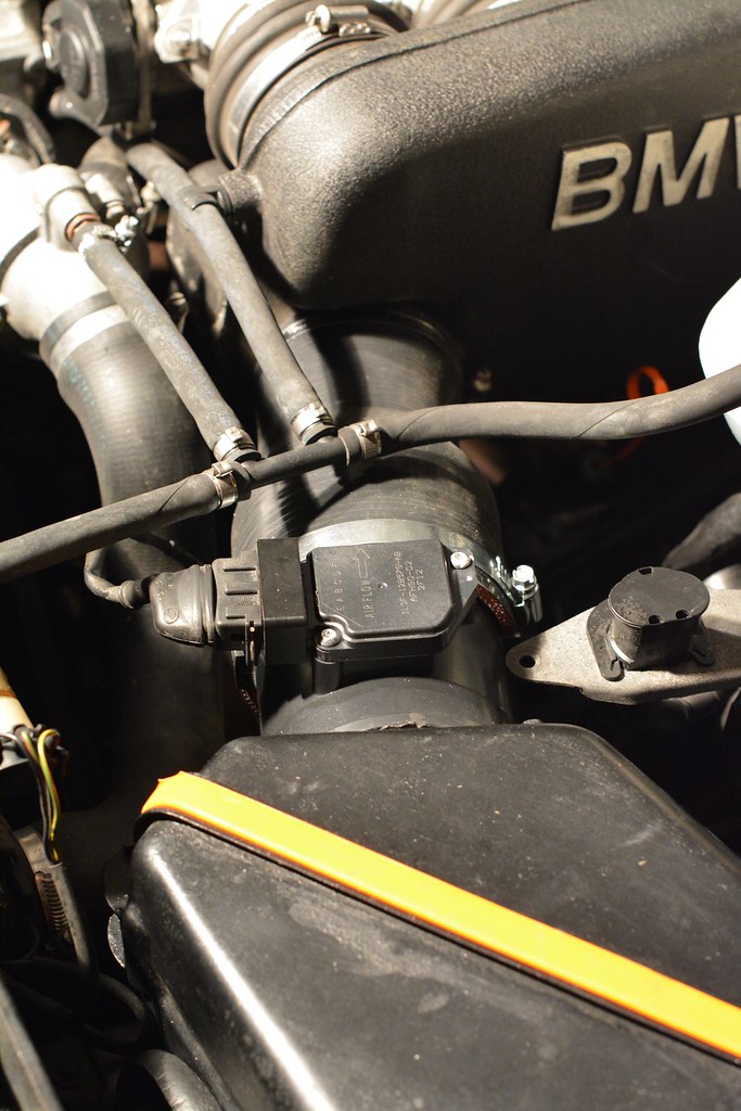

The next afternoon I put a new BMW air filter in the airbox and got to work sticking it all back together. The neat-o silicone tube is much much stiffer than the rubber boot it replaces, so putting the airbox + MAF + tube was nearly impossible. I found that if you shoved the 4" side as far up the MAF as possible (past the moulded in stops) it helped tremendously. To get the 3" side onto the air plenum I did my best shoving & twisting the tube onto the intake opening until most of it was on. Then I pulled out my harbor freight dental pics and started pulling and prodding the last bit of the silicone tube onto the air plenum. It was not simple since the silicone is so stiff, but with a bit of determination, It finally slipped on.
I was a bit short on pictures for the installation, but here is the finished product. Also, notice the coolant temp sensor hanging off the side of the radiator. If you get too rough with wedging the airbox back in it's spot, this can crack the radiator resulting in an expensive mistake.
DSC_7598 by ericandshovin, on Flickr

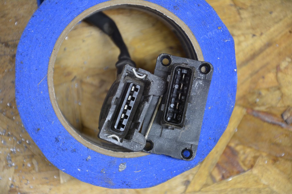

Now the astute reader might notice that the plug for the MAF is on the opposite side compared to the AFM plug. As you can see below, there is not enough cable to easily connect the MAF to the factory harness. Pulled very tight it will physically connect, but I do not trust it as a long term solution.
DSC_7600 by ericandshovin, on Flickr
So a trip to the U-Pull-N-Pay junkyard was in order, and I came up with these guys from a donor E30 325iC. The pin layout for the AFM on the M20/M30/S14/S38 is all the same, so a few snips, a couple of screws removed and my extension cable idea was becoming a reality. As a side note, I found it sad that there was only 1 80's vintage BMW in the lot. 5 years ago old BMW's in yards was much more popular.
DSC_7546 by ericandshovin, on Flickr
A bit more of Dremel "561 Multi Cutting Tool" trimmed down the AFM side connector, a terrible attempt at soldering, and some harbor freight heat shrink resulted in this little beauty.
DSC_7603 by ericandshovin, on Flickr
And here is the final product tucked in nice an happy.

WAR Chip Installation
Moving on to replacing the factory 28 pin e-prom that controls fuel & timing tables with the sophisticated WAR processor. This process is no harder than replacing the factory chip with a Mark D or Conforti chip, but it does have a few extra steps that isn't needed with a conventional chip replacement .
The WAR chip is not specific to the S38 or any other engine like a normal performance chip would be. To make the chip unique to your motor, you must load tunes onto it using the supplied USB cable and software provided by Miller (more on that later). You can load the tunes either before or after the chip is installed in the ECU.
Pulling the ECU is pretty straight forward. Open the glove box, remove the leather flap to expose the ECU. Remove the four 10mm bolts holding the ECU to the dash, and disconnect the wire harness by pushing on the silver metal tab on the firewall side of the ECU (grab a flashlight if you cannot feel it).
Once the ECU is out of the car, use a small flat head screw driver to pry the 10 tabs up.
DSC_7569 by ericandshovin, on Flickr
Once I get them up a bit, I use a set of needle nose pliers to pull them straight up. You can accomplish the same results with just the screwdriver, but this is easier. Caution that the tabs aren't bent too far back as they can break easily.
DSC_7570 by ericandshovin, on Flickr
The circuit board is visible once the cover is removed and you can see that it is actually two separate boards with a bit of ribbon cabling connecting the two. The chip is on the top board, so separating the boards is the next step. No need to remove any screws, just pop the little plastic stanchions on either side of the ribbon cable. Place your fingers on either side of the stanchion and gently apply pressure up and down evenly until it pops, then move to the next one. Being delicate here is important since these parts are NLA.
Before:
DSC_7575 by ericandshovin, on Flickr
After:
DSC_7576 by ericandshovin, on Flickr
Next, you need to depress the two tabs holding the circuit board up against the black plastic connector housing. Here you can see the tabs after the circuit board has been removed.
DSC_7578 by ericandshovin, on Flickr
These are the tabs before removing the circuit board. To release them, use your flathead screwdriver and depress one while simultaneously gently prying the edge of the circuit board away from the black plastic connector housing. This is where a third hand comes in handy.... While maintaining enough pressure to prevent the tab from snapping back into it's place, depress the other tab and gently pry the other side of the circuit board.
DSC_7595 by ericandshovin, on Flickr
Once both tabs have been depressed pull the circuit board away from the black plastic connector housing to reveal the guts of your ECU! As you can see my car was already running the Jim Conforti/Turner Performance chip. A solid upgrade in it's own right and much better than the Dinan chip that was previously in the car.
DSC_7579 by ericandshovin, on Flickr
Gently pry the chip out of it's socket taking care not to bend any pins. Then place the Miller WAR chip in the old chips place. There is a 1/2 circle notch on the WAR chip that needs to be lined up with the 1/2 circle detent on 28 pin receptacle. Both the notch and the detent are visible in the picture below
DSC_7585 by ericandshovin, on Flickr
Now your war chip is installed! At this point you can either button everything back up (basic reverse of disassembly) and the WAR chip will function like the chip you just replaced running solely on the default map (we'll get into that later) or you can hook up the cables to truly get the maximum potential out of the WAR chip.
DSC_7586 by ericandshovin, on Flickr

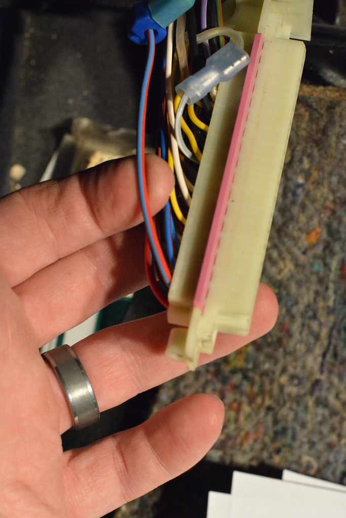

However these cables do no good if they are not accessible. To be able to actually use them, you need to drill a hole in the side of the metal ECU case. Another trip to Lowe's netted these nice rubber grommets to keep the wiring from chaffing on the metal case. Miller sells a grommet for about a buck which is probably a better piece than my Lowe's one.
DSC_7592 by ericandshovin, on Flickr
I chose to drill the hole in the back of the case as that seamed like a less congested area of the circuit boards. Routing the wires in the most direct configuration didn't look that good to me as it would be resting on different components that more than likely get quite hot. Once I drilled out the hole to the appropriate size, installation of the circuit board and case was a simple reversal of disassembly. The extra wiring made it slightly more cumbersome but not difficult.

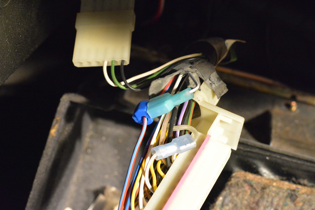

Wiring modification
The final piece of the puzzle before you can put it all back together involves a bit of soldering. It is not difficult, but does require permanent modification to the wire harness. Take your time reading Miller instruction manual and double checking that you are cutting/modifying the correct wires!
DSC_7604 by ericandshovin, on Flickr
Before:
After:

Wiring modification
The large connector that the ECU plugs into needs to be modified a little bit to ensure the MAF talks to the ECU correctly. Millers directions work well here, but their pictures are from a different car.
To remove the cover and expose the wire harness, first remove the small screw at the end of the harness, then clip the zip ties at the back of the harness where the plastic cover meets the factory electrical tape. 223,000 miles of use made my tape a bit stubborn and I had to persuade it with a box cutter to free up the plastic cover.
Once the cover is free you need to slide it away from the harness and the pin-out area. I put my flathead screwdriver in the gap between the pin-out and the cover and pry'd it apart a little bit. Below you can see the opening that is created as the cover starts to slide.
DSC_7555 by ericandshovin, on Flickr
Slowly work the cover off until it slides completely off.
Once you have removed the cover you need to locate two cables. One is located at pin 9 and the other is pin 35. Miller specifies multiple times that the wire color is often what they described, but not always. My S38 powered M5 was exactly as they described.
Pin 9 is usually a grey/white wire
DSC_7558 by ericandshovin, on Flickr
And pin 35 is red/blue (note, another wire nearby looks similar but is blue/red so ensure you get the correct one!).
DSC_7568 by ericandshovin, on Flickr
After you locate the wires highlighted above, cut the wire that belongs to pin 9 and connect it to the wire that belongs to pin 35. I used a t-joint and a crimp connector to make the wiring modification because I plan to dyno tune the car in a month or so. During the dyno session I plan on reverting the car back to stock to see if there is a measurable difference between stock/Miller MAF/custom dyno tuned Miller MAF.
DSC_7567 by ericandshovin, on Flickr
The above method works, but is FAR to bulky to allow the plastic cover be re-installed and I will be soldering this connection together after the dyno session has happened.
Once you have finished the solder job and taped up the new joint, put everything back the way you found it ensuring none of the wiring becomes pinched as you put the cover back on. Reconnect and reinstall the ECU as this part is finished!

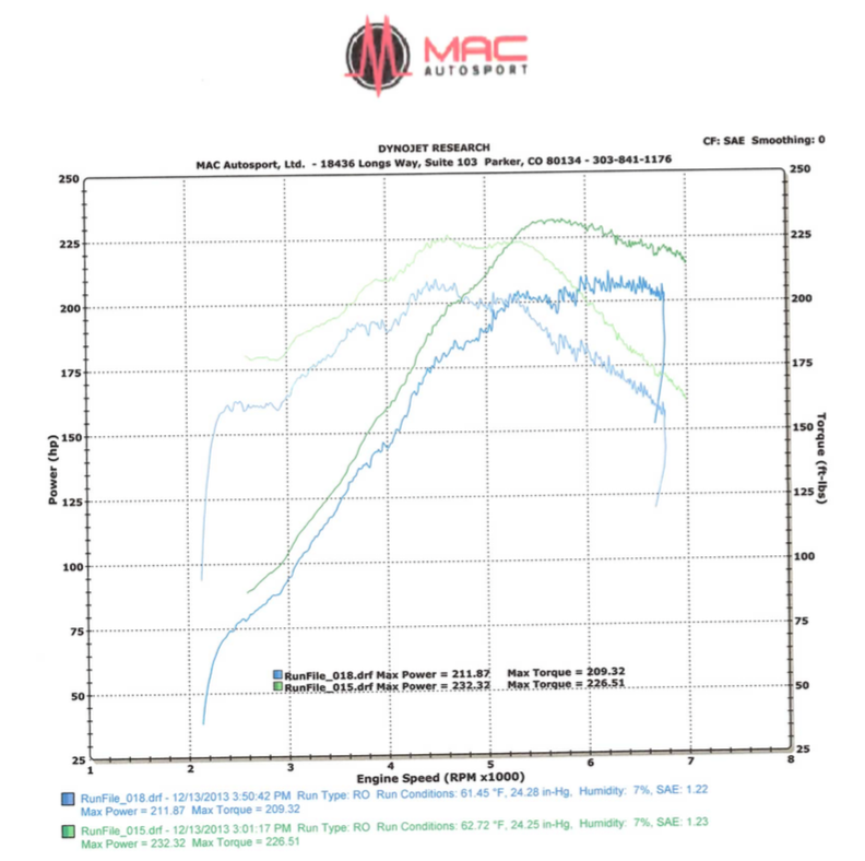

Reading back through old threads, I now realize that I never posted my Dyno results! I wrote this little article for our local chapters newsletter. Either I never finished it, or it got lost in an editor shuffle... not sure which, but none the less, it's cheesy and your free to read it or scroll to the dyne plot at the bottom!
Making old new again.
New is nice. New food is almost always better than left overs (except spaghetti for some reason). New clothes get worn while the old duds sink to the bottom of the dresser. My newish MacBook is ages better than the 10 year old laptop it replaced. So why then do new cars come and go in my life but old ones seem to stick around for the long haul? I've wondered this many many times in years past. Our MINI Clubman was fantastic, doing everything our growing family could possibly need from it. The GTi before it was also lovely. The F11 530d I drove extensively in europe was exquisite... nothing better than cruising at 220kph with the fuel economy of a Prius.
My 1988 M5 turned 26 in November, hardly new, and if you measure car years similar to cat years, this old girl should be in the golden age of her life. I don't drive the M5 every day, but every time I sink behind the wheel, my bond with the Garching creation grows deeper. This summer I was lucky enough to take the M5 to Monterey for the 45th annual BMW CCA Oktoberfest, and one of the many great things to happen at this event was experiencing the M5's powerplant at sea level. Oh. My. Goodness. Experts say your loos 3% for every 1,000 feet of altitude. The seat of my pants tell me that the S38B35 is much more responsive and lively at 10 feet above sea level than Colorado Springs 6,035 feet above sea level.
Since returning to the mountains, I've been craving the power I felt ripping around Laguna Seca and carving a few lonely backroads in the coastal mountains. To do this, I decided to add some new technology by way of Miller Performances MAF conversion and custom dyno tune from MAC Autosport in Parker CO. The M5 and most BMW's built in the 80's came with an air flow meter (AFM). This is basically a barn door that is spring loaded shut. Engine vacuum sucks the door open and a potentiometer at the top of the door measures how much the door has moved. The more it opens, the more fuel is given. The boy at Miller take the AFM and chuck it in the trash, replacing it with a giant 4" mass airflow meter (MAF), and a new eprom called the W.A.R. chip. Most cars up to 1996 can benefit from the W.A.R. chip custom tuning ability.
The MAF/W.A.R. chip install was pretty straightforward. only a bit of airbox trimming and 1 wire rerouting were needed. After installing the Miller setup, I honestly didn't feel much performance difference over the factory AFM with a Jim Conforti chip installed. The motor ran well, but still felt a bit lethargic and lazy. Luckily the front range is blessed to have a great tuner in their backyard. MAC Autosport has a AWD Dynojet dynamometer able to handle anything under 1800hp and their tuner, Nick, is a bit of a BMW gear-head. He currently owns a 400 something horsepower turbocharged E34 535i and another turbocharged S50 swapped E30 that is even more ridiculous!
One run on the Dyno showed that the Miller supplied tune was very rich which was affecting a smooth power band. Still the S38 lay'd down a respectable 220whp & 215 torque. Nick quickly got to work adjust parameters in both the fuel & timing cells. Soon the M5 was consistently making around 227whp but was making an odd fuel dump blip at 5,500rpm. They dyno plot showed at 10whp drop at this rpm when the air fuel ratio dipped. A bit more fine tuning smoothed out the rich fuel problem and netted an extra few ponies. The M5 was now making 234whp and 226 torque.
Nick explained that the older generations of 8-bit fuel injection are much more difficult to tune than current 32-bit technology. I relate this to playing Mario Bro's on Nintendo vs. Call of Duty on PS3. He is able to reflash the E46 M3's Seimens MSS54 ECU and has seen 16whp gains! This is more than plug & play flash's most popular companies are offering and if it's anything like my M5's gains, the area under the curve gets a big boost.
Our final step was to see what the motor makes completely stock. For this I borrowed a factory airbox, AFM and ECU from club member Tom Schultz. His E28 M5 is tucked away for the winter, so this was a perfect time to do a baseline run using his parts! Completely stock, the M5 made 211rwhp & 209 torque. For rear wheel drive cars, Nick uses a 19% drivetrain and altitude loss to convert the rear wheel horsepower numbers to crank horsepower. Factoring in the drivetrain loss, my 222,332mi M5 made 252hp, only 4hp shy of factory specifications! With the new technology and wizardry of MAC Autosport, my M5 now runs a healthy 278hp!
Screen Shot 2014-12-28 at 6.48.07 AM by ericandshovin, on Flickr

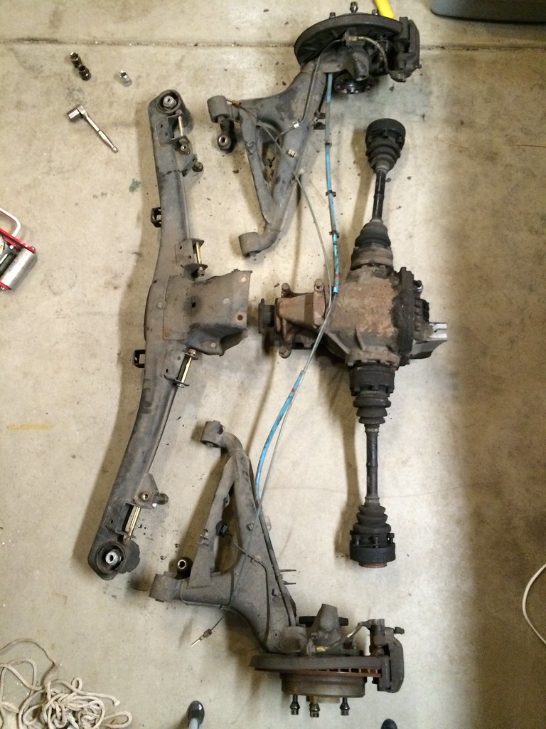

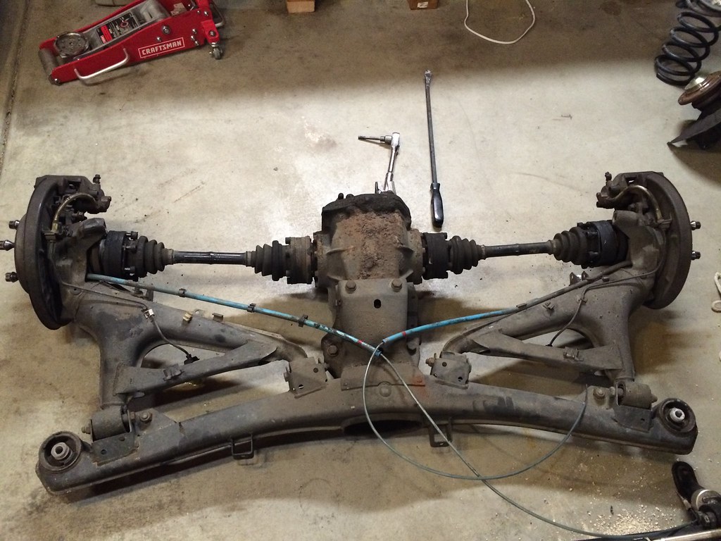

The whole rear assembly came down one evening with my brother-in-law's help. The e-brake lines were fuzed to the channels's the lead into the car and were the only major hick-up, other than trying to muscle this monster of a subframe out from under the car!
IMG_7637 by ericandshovin, on Flickr
The goal for removing the subframe was to replace:
- Subframe bushings with new OEM bushings
- Dogbones with new
- Rear Diff mount with new
- Roll bar bushings and end links with new bits

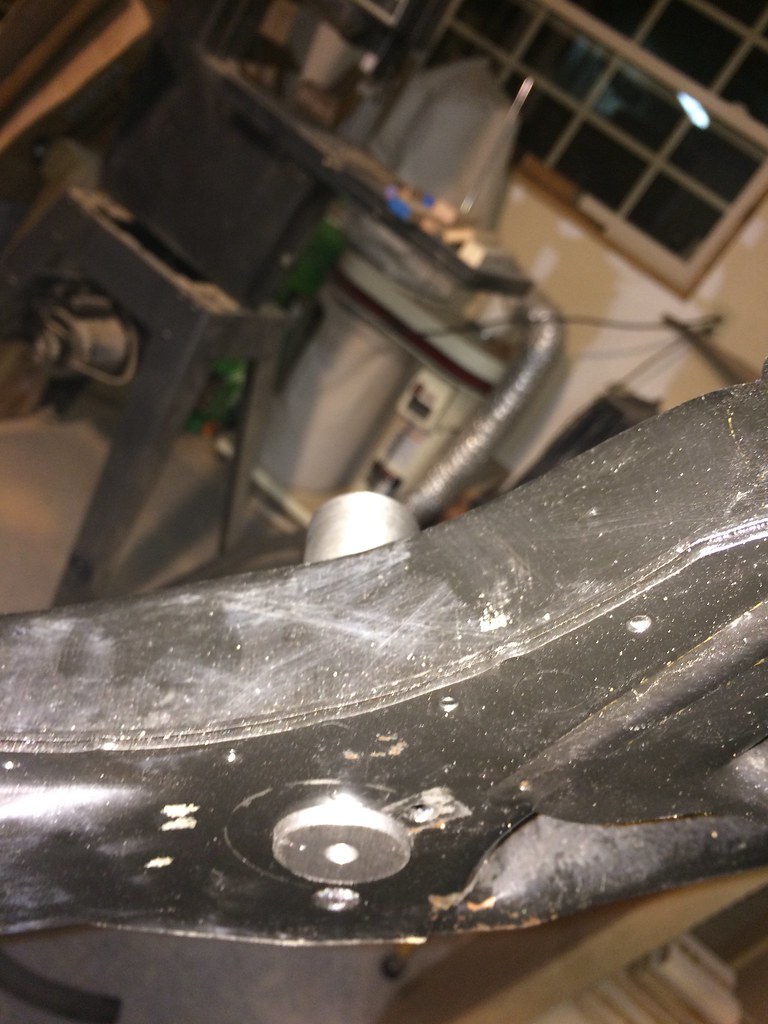

- Trailing arm bushings with AKG units. If I had known before purchasing the AKG ones, I would have bought E34 M5 bushings. Bummer.

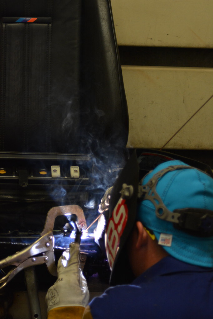

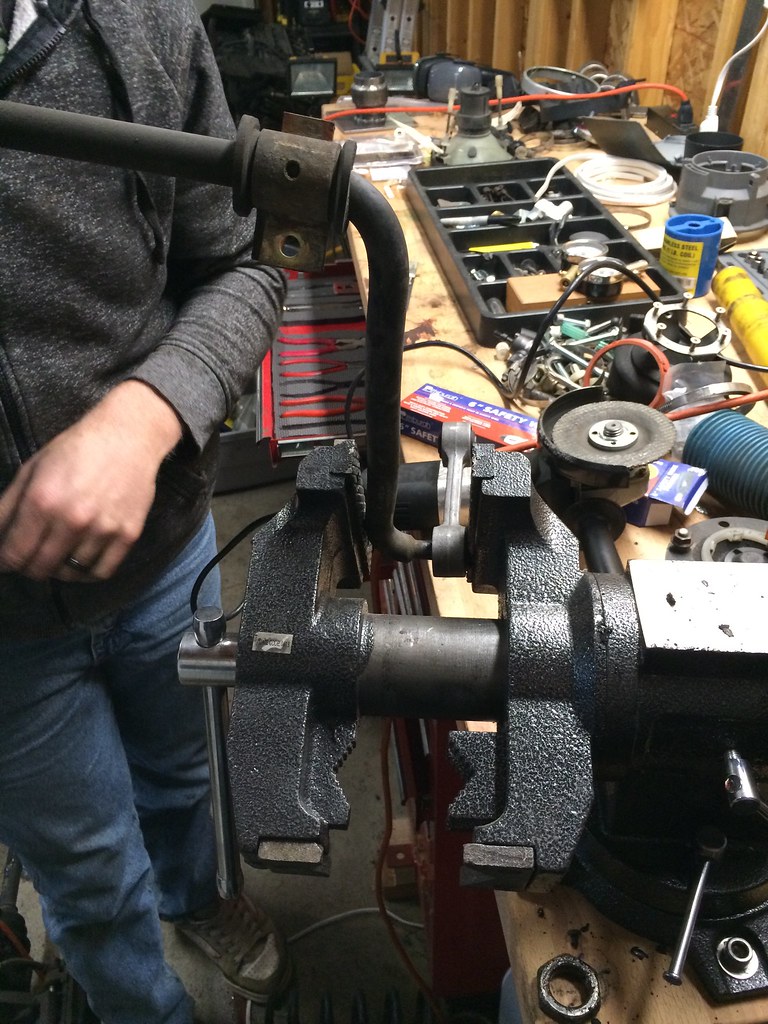

I also wanted to fix the front seat frame, and try to diagnose the clunk on the front end that I'd been hearing for a while.

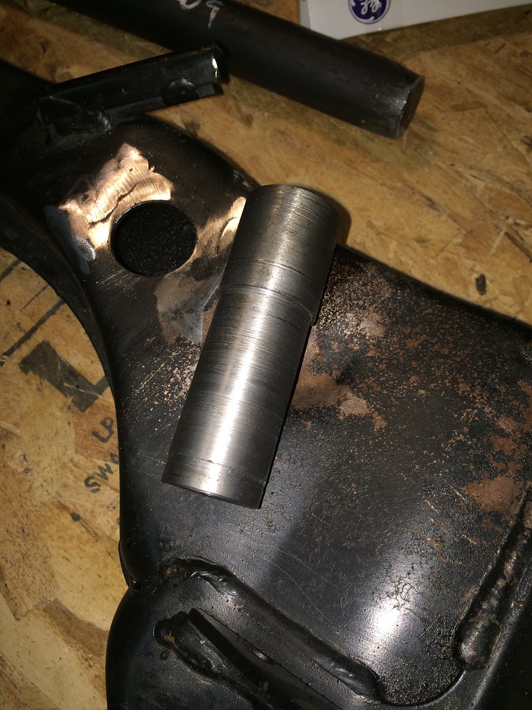

The subframe itself was separated and taken to the auto hobby shop on Ft. Carson to press out the old bushings and press in the new rubber. Being in the military definitely have a few perks!
IMG_7642 by ericandshovin, on Flickr

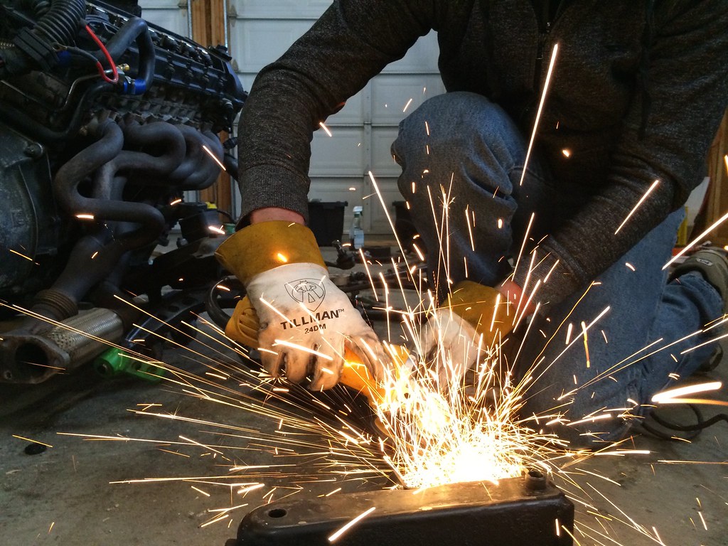

While at the hobby shop, I also welded the seat frame. I d0n't think E30 sport seats have the same problem as the E28 seats, I hadn't heard about it until doing a bit of interneting one day. The rod that provides support for the side bolster is welded from the factory to the base frame. This is great in theory, but the base metal is too thin, and the rod eventually tears the base metal apart from the weight of the driver pressing against the bolster over and over again. for the MIG would probably have been a better choice over TIG as the torch heat started burning the foam, but I wanted the practice on the more difficult discipline.
Broken:
IMG_7706 by ericandshovin, on Flickr
fixing:
DSC_3779 by ericandshovin, on Flickr
DSC_3839 by ericandshovin, on Flickr
Fixed!
IMG_7707 by ericandshovin, on Flickr

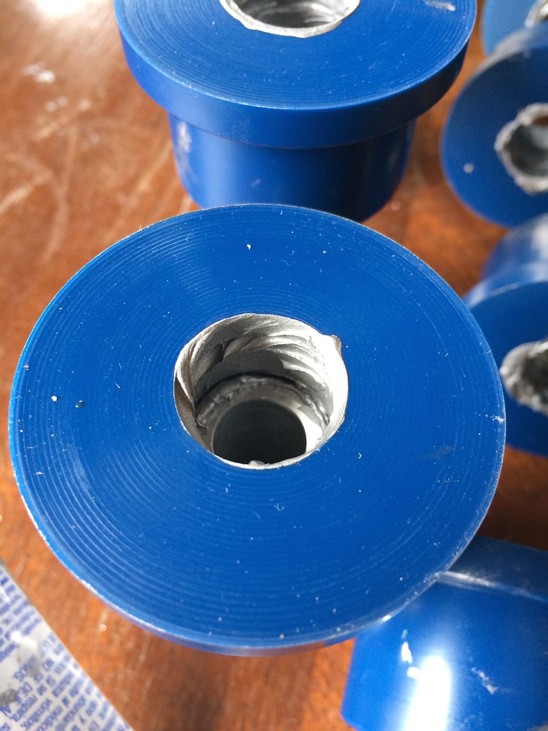

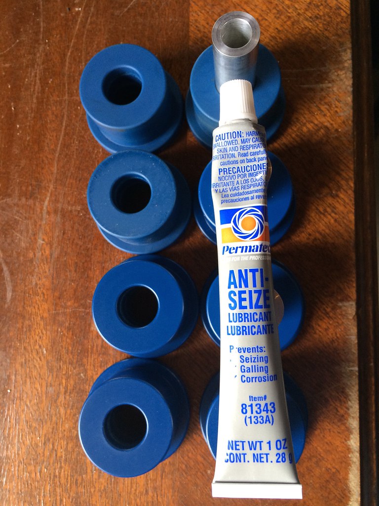

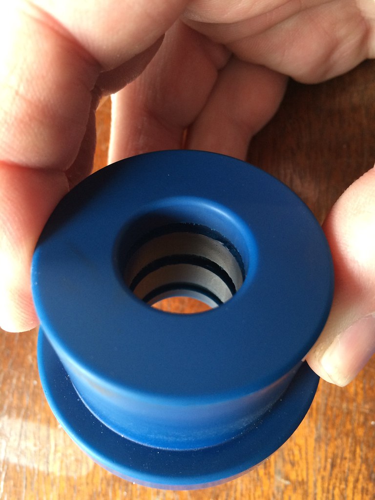

On to the RTAB's by AKG. A common complaint about poly bushings is the squeeking after a bit of use. AKG uses internal "grease grooves" to keep the bushings lubed and quiet. A phone call to AKG revealed that normal old grease is all that's needed, or anti-seize if you want to go a bit better.
Anti-seize it is!
IMG_8040 by ericandshovin, on Flickr
Grease grooves:
IMG_8041 by ericandshovin, on Flickr
Grease grooves greased:
IMG_8042 by ericandshovin, on Flickr

Rear diff bushing replaced. The old one's rubber was quite cracked and rotted.

So now it's time to crack into the rear...
- Dogbones with new

A bit more interneting revealed this to be a common failure on the E28/E24 chassis. Many times the weld just cracks on one side, but mine was completely cracked through on both sides.
BMW usually does an excellent job playing into the German over-engineered stereotype, but this mount is just dumb. On the left of the steering box is a horizontal through bolt that runs front to back. on the right of the steering box is this mount that bolts vertically to the frame. Any time a load is placed on the steering box (any time your not parked) the steering box is rotating on the horizontal bolt, and pulling or pushing on the vertical bolt. Make sense?
What to do, what to do...
Luckily BMW provided nice access holes in the subframe to get to the nut on the bottom of my broken steering box mount. I decided to use my newly acquired welding skills to make something better utilizing those access holes. So I bought a rod.
Ground off the old, failed welds
Cut the rod to size.
Had the help of a co-worker who turned the rod.
And here is the finished product. Another trip to Ft. Carson is in order to weld these guys together.
Test fit.
