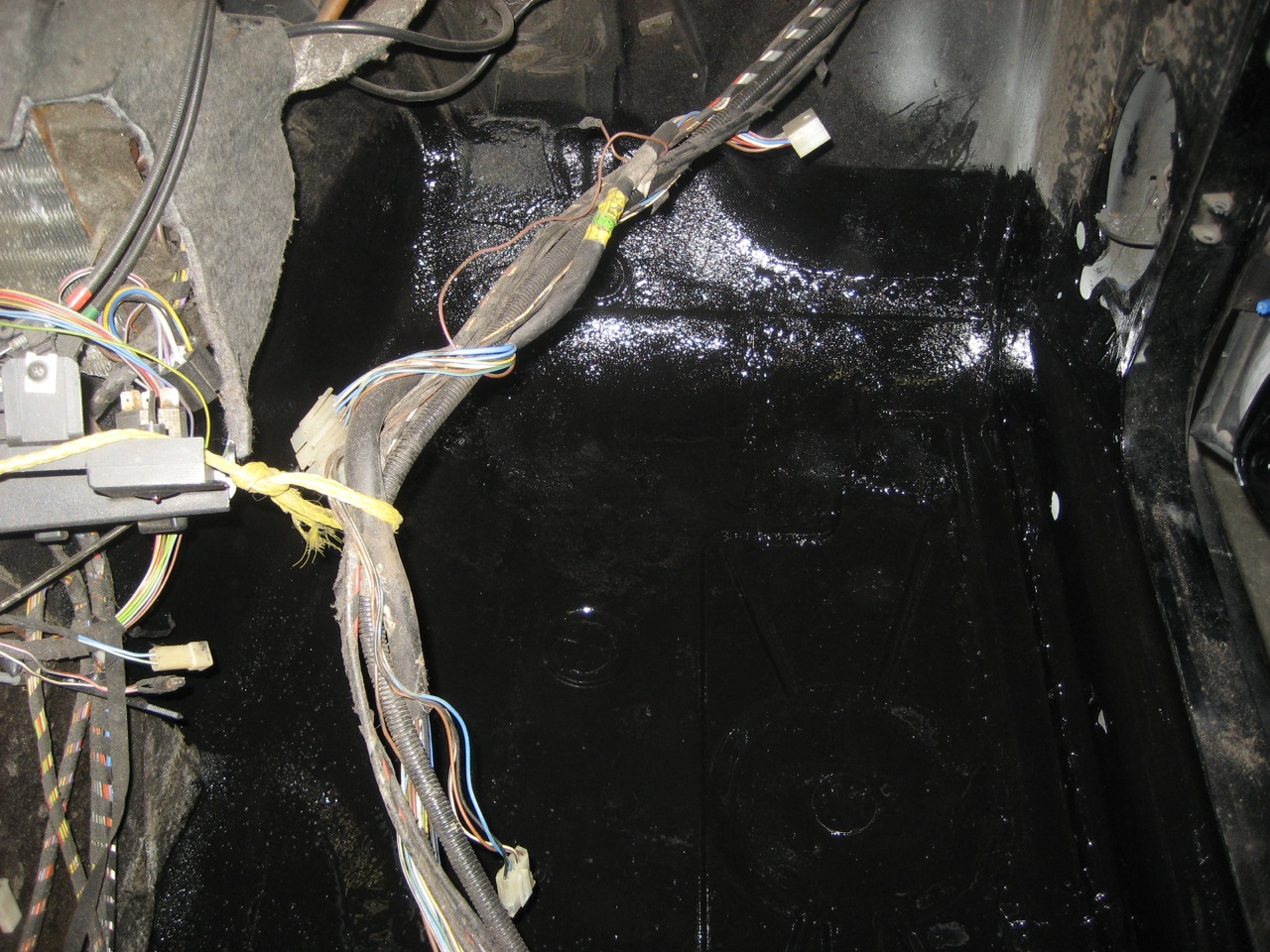

The floor boards cleaned up very nicely after removing all the tar, shit and surface rust. The drivers side repair is done. I burned thru in a few spots and ended up filling the holes making a few ugly welds....but I'm welding upside down...very awkward.....wine/cheese///wine... :rofl:
Applied POR15 on the pass side. Seam sealer will go over all the weld joints and seams and then I'll apply the truck bed liner paint. I'll put some kind of sound deadener in also.

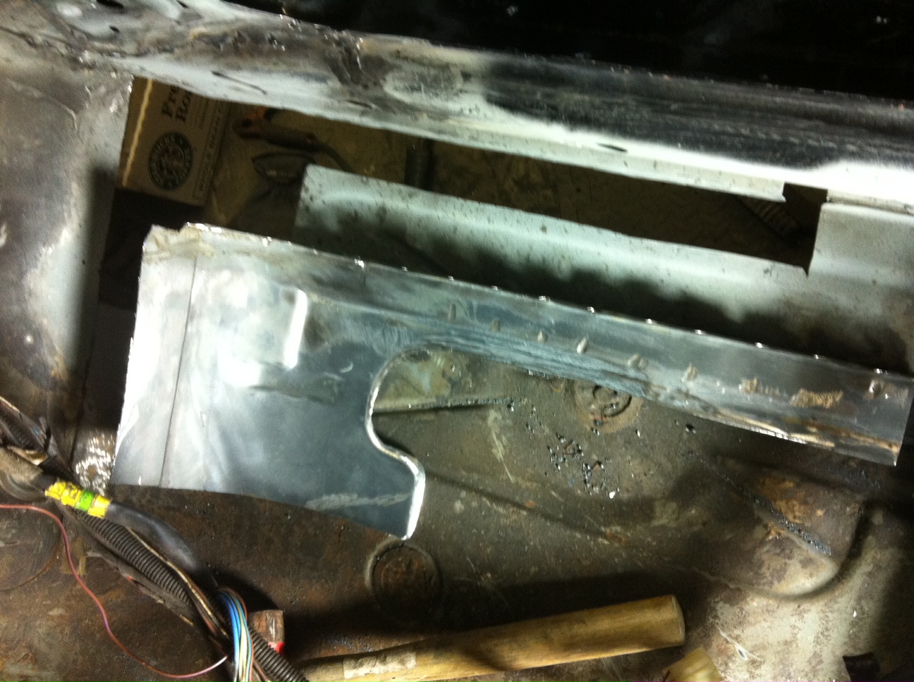

I cut my last bit of rust out of my car. There was a rusty area on the side of the jack points. From here I will take a piece of cardboard, press it against the hole and the jack support to get a indention of the hole. Then I will cut the cardboard for a template and transfer it to fresh sheet metal, it will show the jack support so I can drill holes for spot welds too.
I've been using weld thru primer on the back sides of the metal and joints. Don't apply more than one coat as its a bitch to weld thru if applied too heavy.
I'm actually surprised in how clean and rust free the inside of the rockers are.

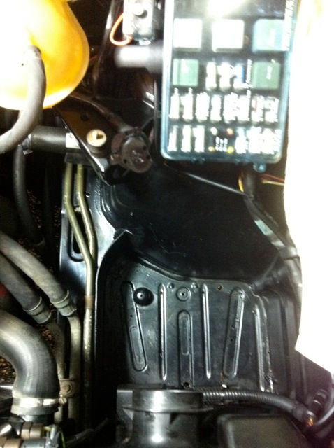

If you ever have your front fenders off....take the time to drill a small water relief hole in your top door hinges....this is a flaw in BMW design as water accumulates in the area. I have seen many hinges nearly rusted thru. The lower hinge is not affected as there is a hole located near the bottom that lets the water pass.
Here I have drilled a hole and applied POR15 for protection.

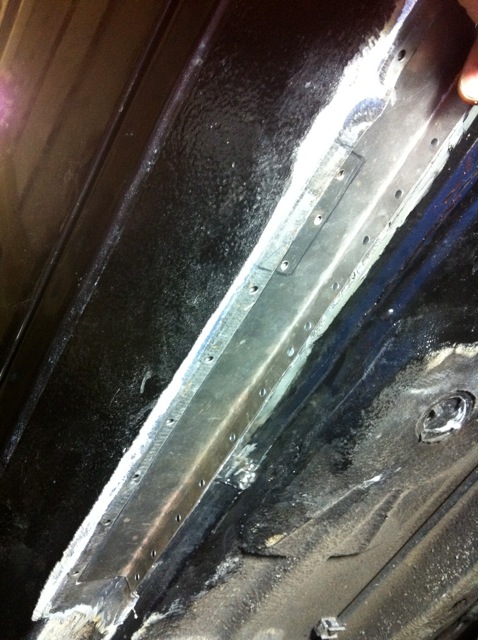

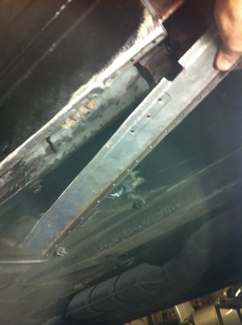

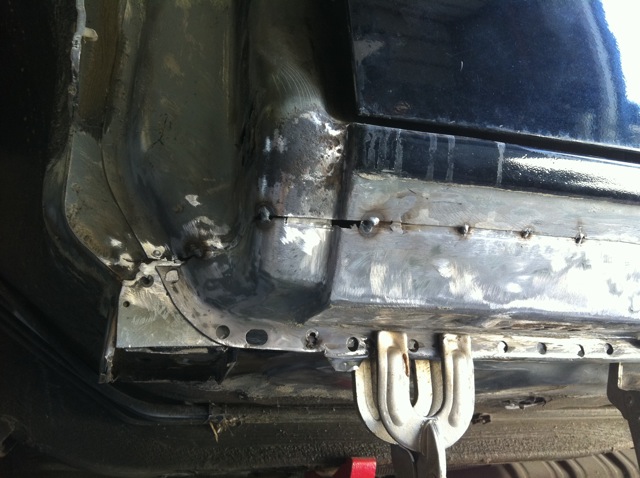

What I did today, left rocker done, right one to go! I should mention I have some finishing work, grinding and then applying a coat of metal 2 metal filler to cover the rocker weld...then rock guard...almost done with this job...onto paint!
I'm not that great of a welder...especially on my back...but it will look good dressed up with filler and rock guard..

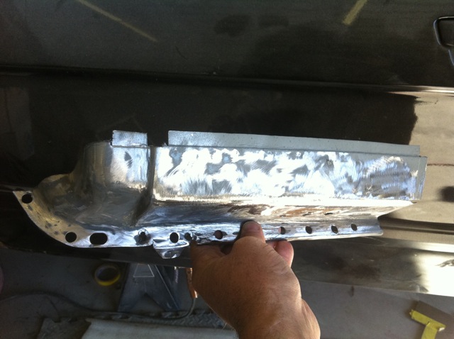

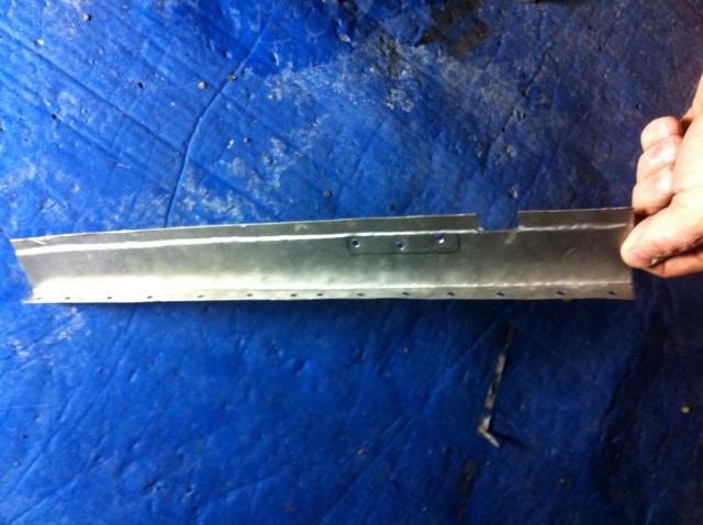

I'm getting better making my replacement pieces and faster. This piece I made for the R front rocker. It fit very well. I just have a small piece to welding ahead of this piece and I'M DONE....! with the rust repair anyway...then a little paint and onto the interior. :-}

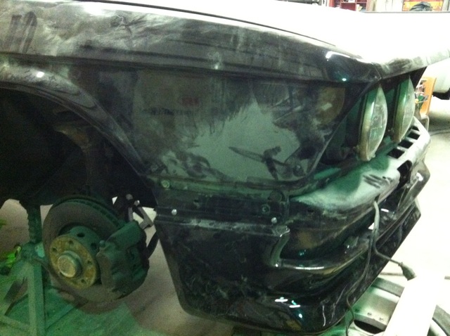

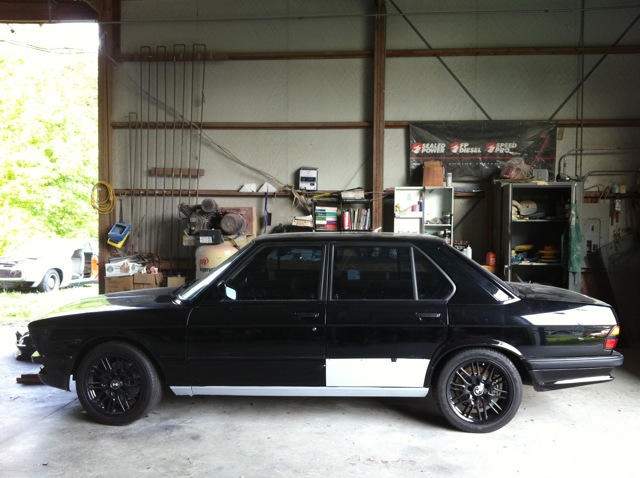

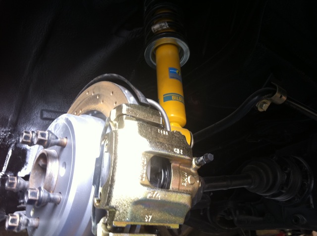

So its been a long time since I've updated this thread. The car is off the jacks and out of the body shop. I had it on the ground the day of the Vintage car meet and I had the balls to drive it without even a test drive...but hey...it was only a 30 min drive from my house to Winston Salem.

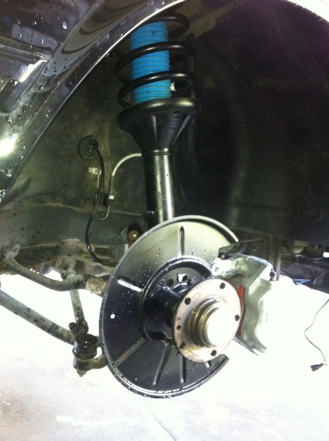

So the rust repair was a nasty, dirty, filthy job. It took me way longer to complete the job then what I had thought....mostly because I didn't take any short cuts. If something needed replaced or repaired.....I just did it. I ended up replacing pretty much the whole suspension/brakes/rotors front and rear along with many new bushing parts.
Once the metal work was all repaired I POR15 where I could use it and seam sealed everything else....probably went a little over board on the seam sealer....but that wont hurt anything.
The car was in good condition besides the areas I repaired. Thats one of the main reasons I bought this car because I knew if I fixed the rust it had good bones....most people were very afraid of this car....its gonna be a very cool euro m5 "non badge" no spoiler daily drive....baaaaaa-baaaaa! I decided the front spoiler was bit much, I'm probably going with a M5 chin spoiler . The front battery box tray was like new which is surprising as this catches a lot of road crap and rust badly [east coast that is]. Frame rails are in great shape...as you can see by several of the picks after I washed and cleaned the car its in nice shape....a little elbow grease and cleaner....goes a long ways. I'm very excited where the car is now "put back together stage" Heres a few things I've done over the weekend since I've had the car back home:
