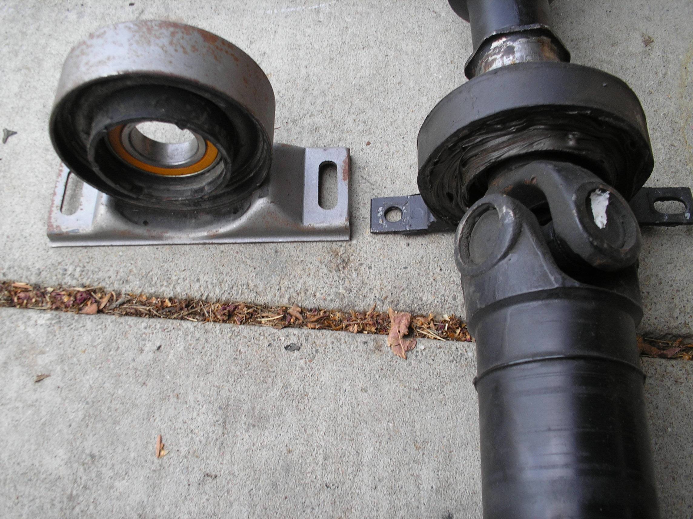

Check this photo of the e34 non-540 center bearing
It does fit, i have one on my car, shit is seriously tough as hell. If you destroy it, it deserves to be destroyed.

Looks like it fits to me.
For the non-540 e34 CSB it looks like the brand choices are (in price order from most to least) BMW, Lemförder, Ina, Febi & MTC
I would imagine that spending the $50+ dollars on the top three brands would be recommended?

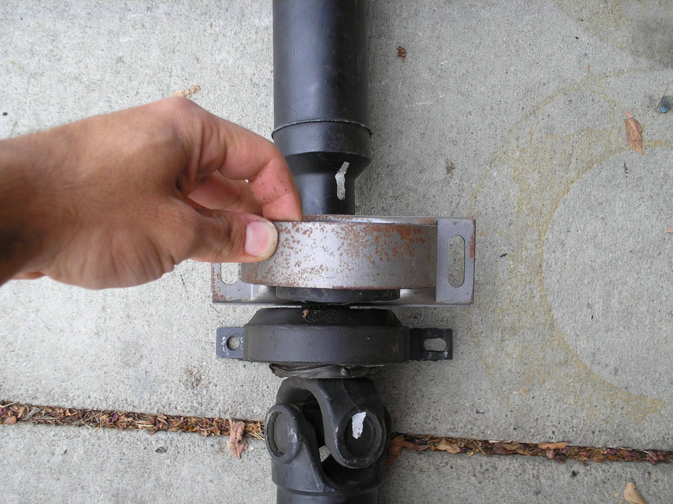

Brad D. wrote:The open side goes towards the front of the car and you preload it towards the front as well.
Is this definitely correct?
Odd. Everyone I've ever had has been like the pic with the closed side pointed forward.
Mike, the splines are on the rear of the front half, so the photo is still correct with "open side pointed forward."
Put one together today, I stand corrected, the pic is perfect,
I mounted the bearing on that one, but it is correct!

I know this is super old, but I just went through replacing my CSB twice due to a crappy quality aftermarket part.
Like many others, my $30 center support bearing made by Rein Automotive failed within 30 miles. It was knocking and vibrating just as bad as the 36-year-old OEM one I removed ('79 E12). Upon visual inspection it looks fine, but the rubber is just so flimsy.
I replaced it with a Meyle E34 535i part for $27 and it is MUCH more sturdy. With the Rein part, I could push the driveshaft into the tunnel by hand, no wonder it was banging around while driving.
With the E34 part installed, I can barely move the driveshaft by hand at all, and it's completely smooth while driving.
