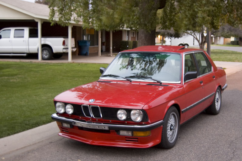

Here's the problem with the spoiler:
When using the BMW brackets for the Euro bumpers (which believe it or not are easily adaptable to the US frame rail extensions - cut a channel in the center of each large enough for the bolt - don't bother with that hole-drilling crap, since you really can't get the hole straight on in the right spot - even with the foot-long drill bit recommended in the write-up on M535i.org. Do it this way and your life becomes a whole-lot easier.), they don't clear the spoiler in two spots. The top, which crosses the opening in the valance. Also, the space between the opening for the fog lamps and the opening for the oil cooler is too wide, as it actually infringes upon the frame rail. Mark it and cut it. Unfortunately, I did a series of cuts since every time, the brackets would interfere in a different spot. No biggie, as they'll be covered with the plastic trim which sits between the fog lamp and the oil cooler opening.

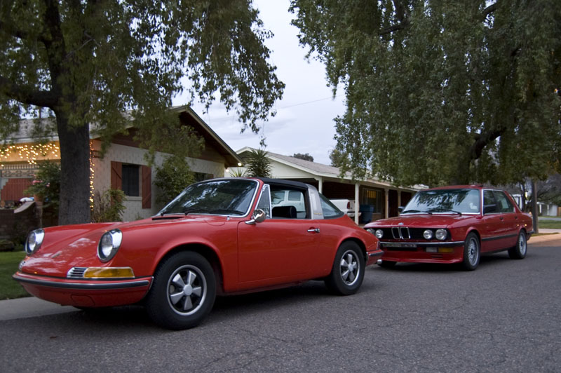

My uncle stopped by with his '71 911E just as I finished, so here's a shot of the two red cars:

The fitment issue with the Hartge spoiler was pretty much limited to the stock bumper brackets. I also haven't seen anyone else using the plain spoiler, so I don't know if it's just a factor with it. Some trimming needs to be done. Essentially cut out the very top where it crosses the opening in the valance and do some trimming next to where the foglamps sit.
The lamps fit in the spoiler fine, but a piece is added in where the mounting tabs for the turn signal should go. The center section of this must be cut out to allow for the ribbing on the backside of the turn signal to fit into the spoiler. Other than those issues, it's fine. It looks good and the fiberglass work is quite good. It is much thicker and has a better flex capability than the BMP kit, if that says anything.
I can't stress enough the importance of doing all of the fitment work before sending the spoiler in for paint, though. You can make some very expensive mistakes.

For the record, the directionals and fogs fit no problem. The only issue with fitment was trimming the lay-in piece by trimming out the center (not an easy task since it could break, crack and transmit vibration throughout the spoiler). Once that was cut out, there were no issues.
