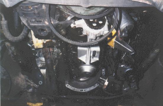

Am I prying on the right spot?ahab wrote:Your skirt is getting in the way.Get a flat blade screwdriver in there and gently pry around the outer edges. It'll come free, it's just stuck from 30 years of not moving.
Re: Crank Pulley Securing Tool?
Now if only I could get that stubborn oil level sender out! I'm prying around with my flat scrwdriver at the seam where the flange meets the pan. No loosening observed whatsoever. You'll see in the pic I posted above that I've sprayed the area liberally with penetrant. I'm afraid of prying too hard and pressing a hole into the pan with the shank of the screwdriver or damaging that seal area with the tip.Blue Shadow wrote:I'd rinse the pan with a some petroleum distillate of some flavor a few times. get it in there collect it as it comes out and go in again. Use a brush if you need to to dislodge and milk shake. Use the oil drain plug or the oil level sender hole as needed to get the bulk of the crud and old oil out with the first half gallon or so of cleaning fluid and then use a fresh batch of fluid for a final couple of rinses. That should get lots of milk shake and detritus out of the oil pan so you can get back to the next unforeseen issue you need to address.

Yes. Try a small hammer and tap around the edge. I don't remember them being super stuck but you have the correct nuts off and that whole triangle is the bottom of the sensor. It will come down.ncamie wrote:Am I prying on the right spot?

Okay, shortly I'll try prying and light hammering and let you all know how it goes. In the mean time, I've just realized that in order to remove the crank sprocket I'll have to slip off the oil pump chain as well. It is a very short length of chain by the looks of it and no obvious master link whatsoever. How can I manage that oil pump chain? Is it just a matter of loosening the spring tensioner and using the slack to slip it over the sprocket?
No, unfortunately you may be in a pickle there. You have to loosen the nut on the oil pump sprocket to remove the gear from the splined shaft. I'm not sure there's access for that in the opening of the pan.

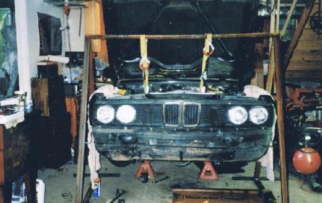

You may want to start looking for a contraption that spans the shock towers and allows you to hang the engine, thus allowing the subframe (and oil pan) to be lowered while the engine remains basically in place. About 20 years ago I built two A frames that stand next to the car with a piece of C channel across the top to hang the engine. Now I just pull the engine and do a complete reseal whenever major work is required. Since then I've seen something that does the same job of suspending the engine from in the engine bay.
That allowed me to do this with the engine in the car. You can see the oil pump nut in this photo. I doubt you'll be able to reach it with the pan in place. Why are you taking the crank sprocket off again?

Because I'm a nut case. Because I enjoy the punishment. To be honest I bought all the parts before I started the job, that way I'd be prepared for the eventuality that if I HAD TO then I was ready for it. The parts are here, that's the reason I am convincing myself of. Technically speaking I do want to change the timing chain and and so to that end I figure better replace sprockets too. The car probably has well over 300k on the clock and I could see that the ends of all the teeth on the camshaft timing sprocket were point, which compared the slightly flattened teeth on the replacement gives me a sort of impetus to change the bottom sprocket as well no matter what condition it may be in.
I have renounced myself the fact that I will have to get organized with an engine hoist and do the job right. There is a local tool rental place where I can source it (along with the heavy torque wrench for the crank nut tightening). Before I do I'll have to get an oil pan gasket and whatever else so I have that hoist for no more than 24 hours.
