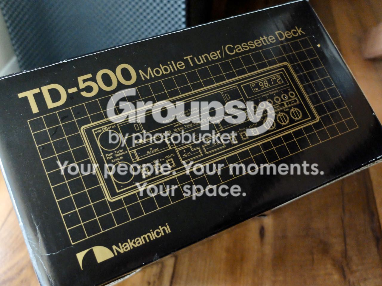

Getting ready to install this vintage Nakamichi:

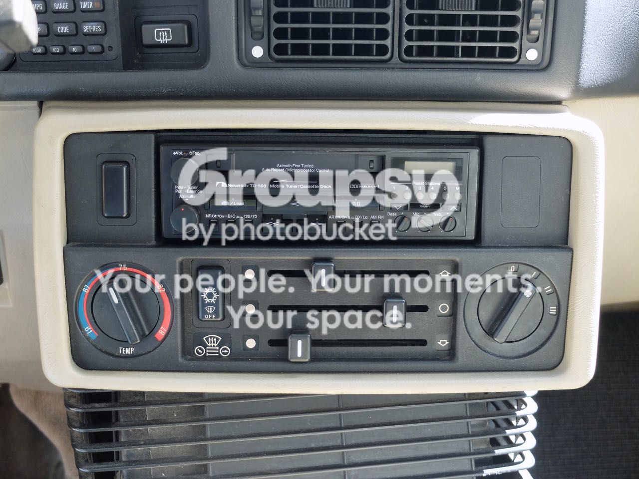

Got the Nakamichi TD-500 installed today.
Replaced the fader with a foglight switch to enable/disable the auto antenna.
I've done 8 or 10 stereo installs in various cars and I think this was the most difficult due to the cramped space in the dash. Pretty happy with the result though!
