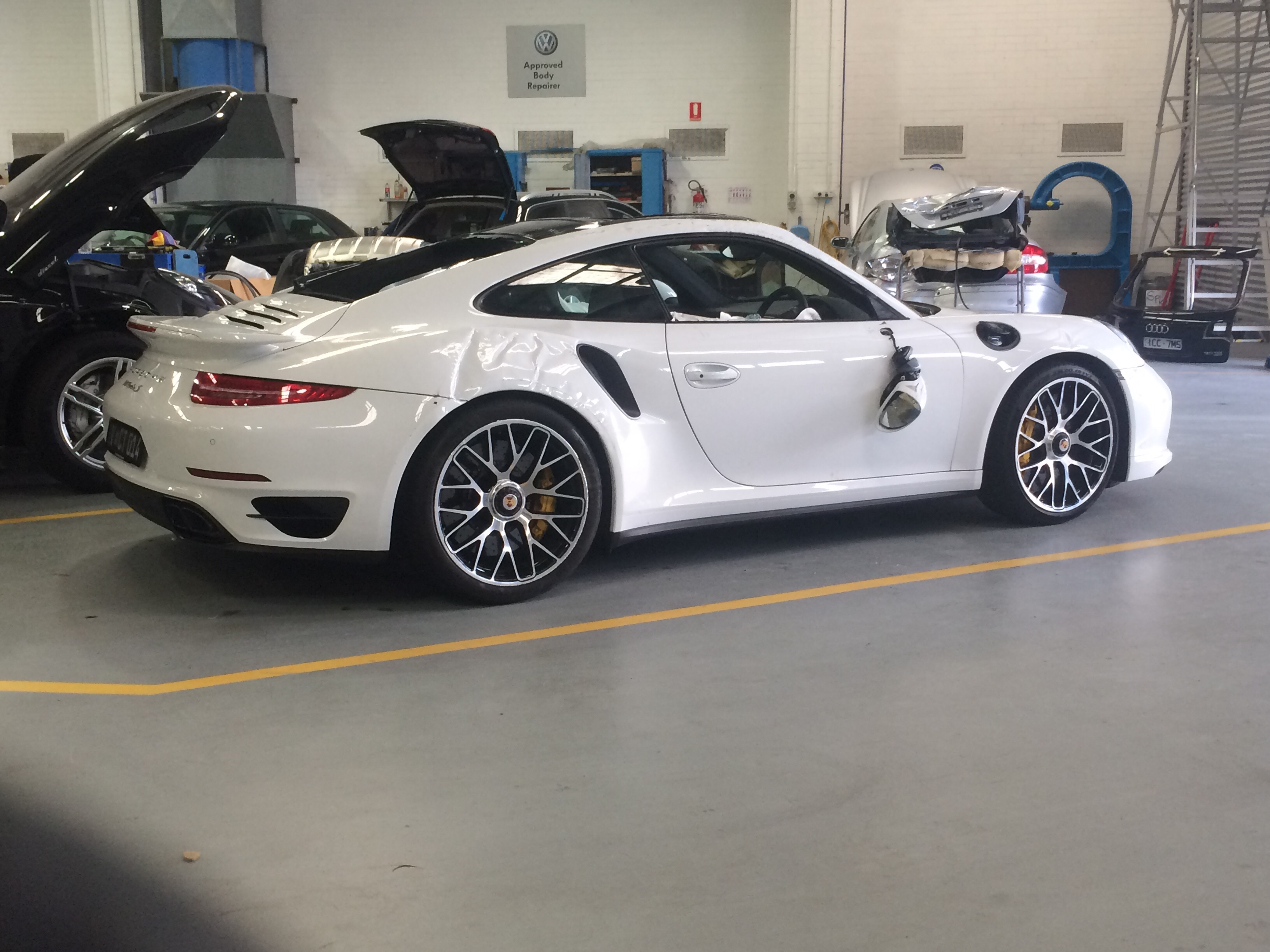

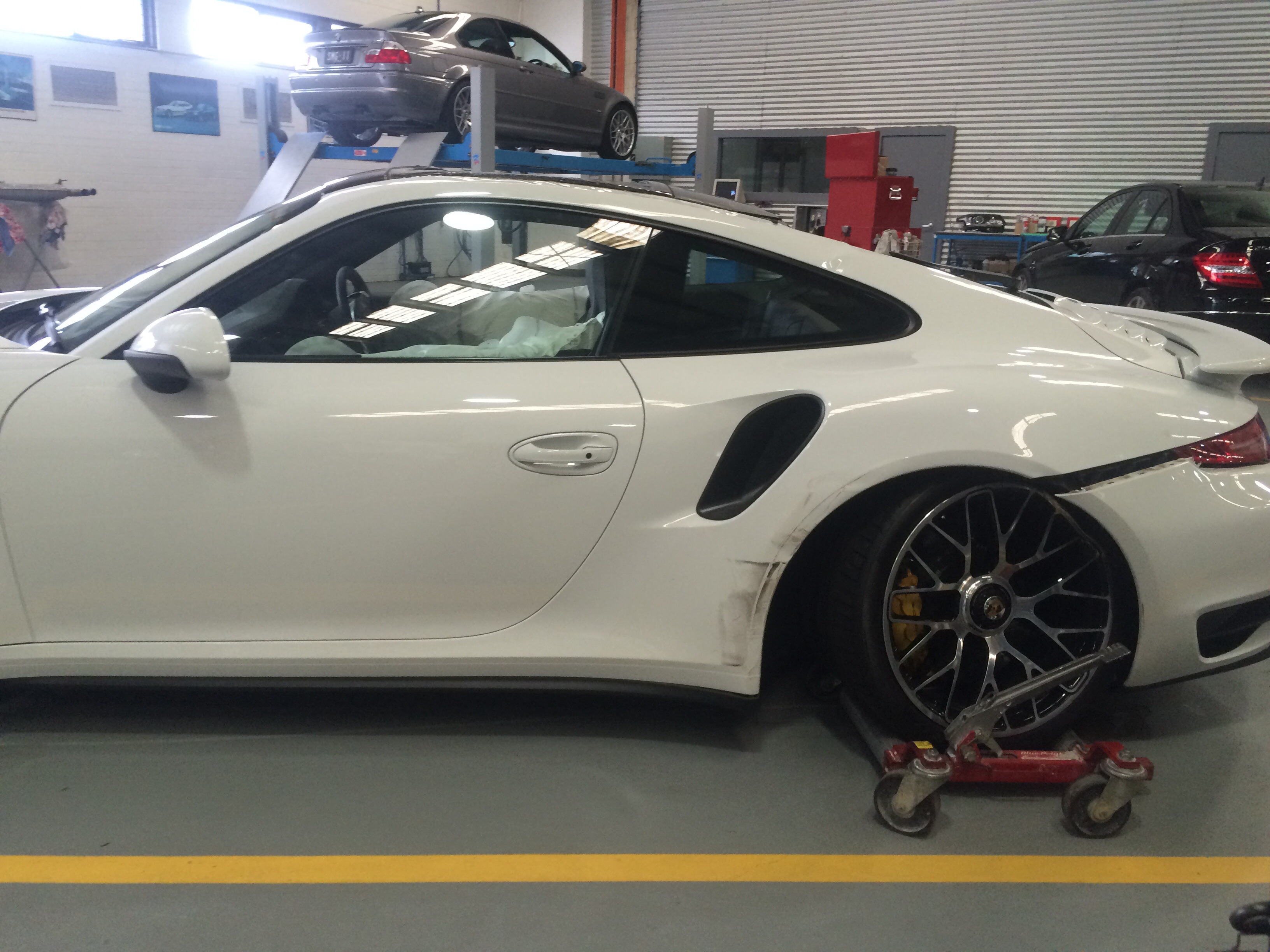

Funny thing is, the day that video made the rounds, we had a rolled 991 turbo S in White get picked up and sent to another shop. Long story, but at first glance we all thought the video was of that shop trying to start it. given the impact was so hard it tore the suspension mounts off the body and sent the LH rear wheel into the LH turbocharger and smashed it to pieces, the result would've been very similar.

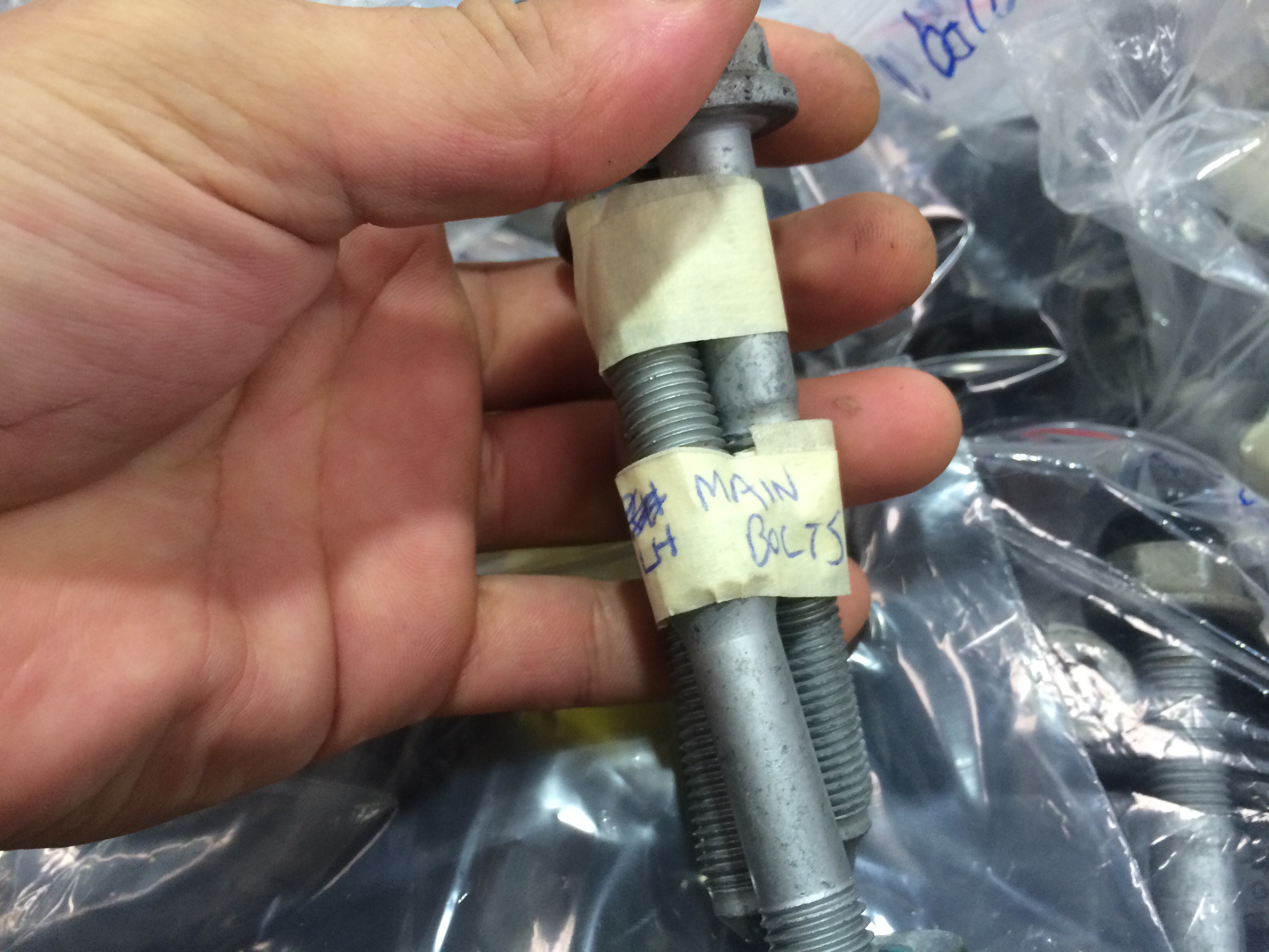

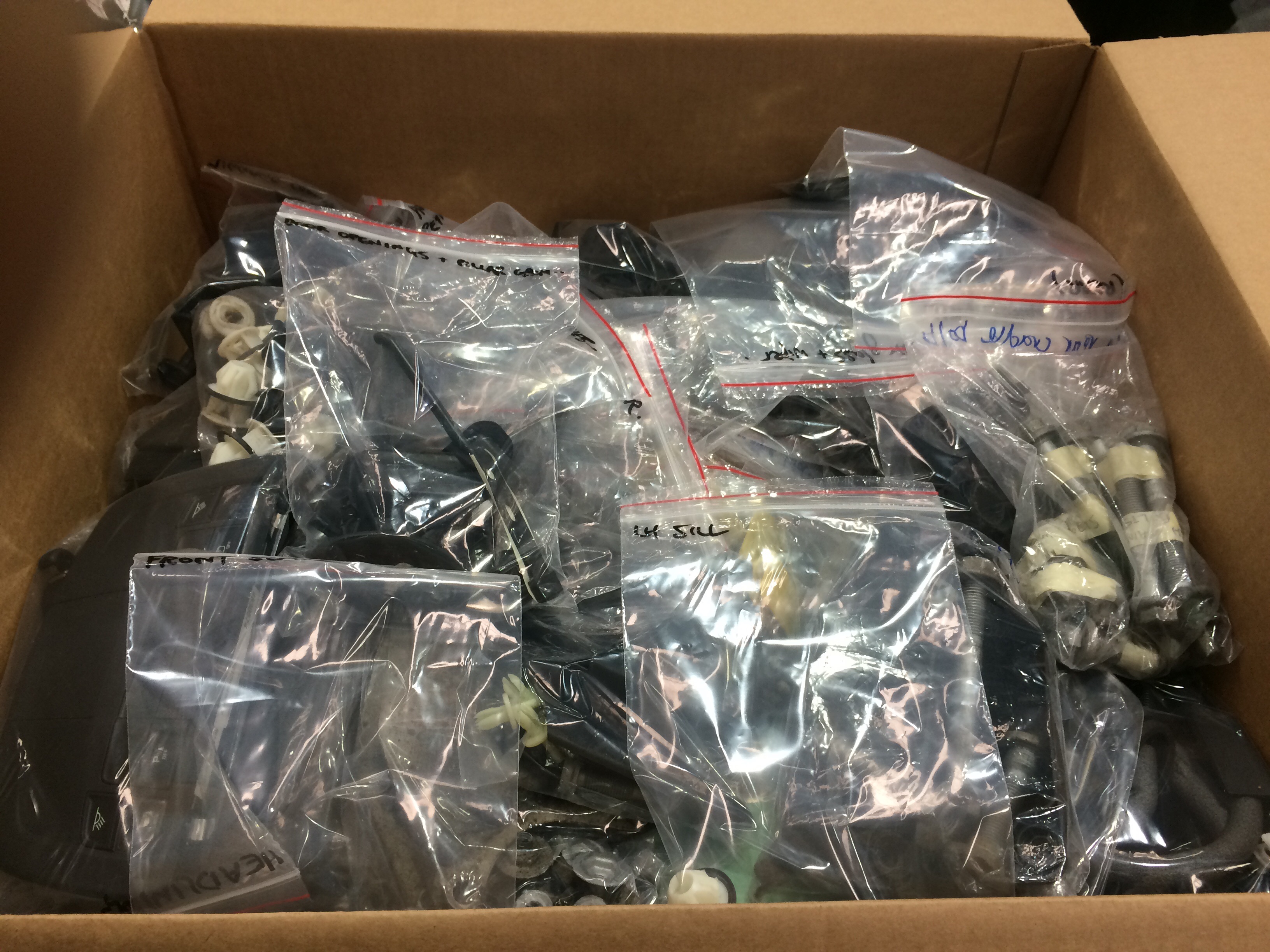

Dub-Nub wrote:Question: how are you keeping track of the bolts/nuts/etc?
A whole lotta ziplock bags. In some cases, such as with suspension studs that vary in length, I'll lable each individual bolt also. A good memory comes in very handy, although I cop it at home quite often from the wife to be.. "You'll forget what milk I asked you to buy 30 seconds ago, yet are able to differentiate between and recall perfectly where a screw goes on a job you stripped 6 moths ago"

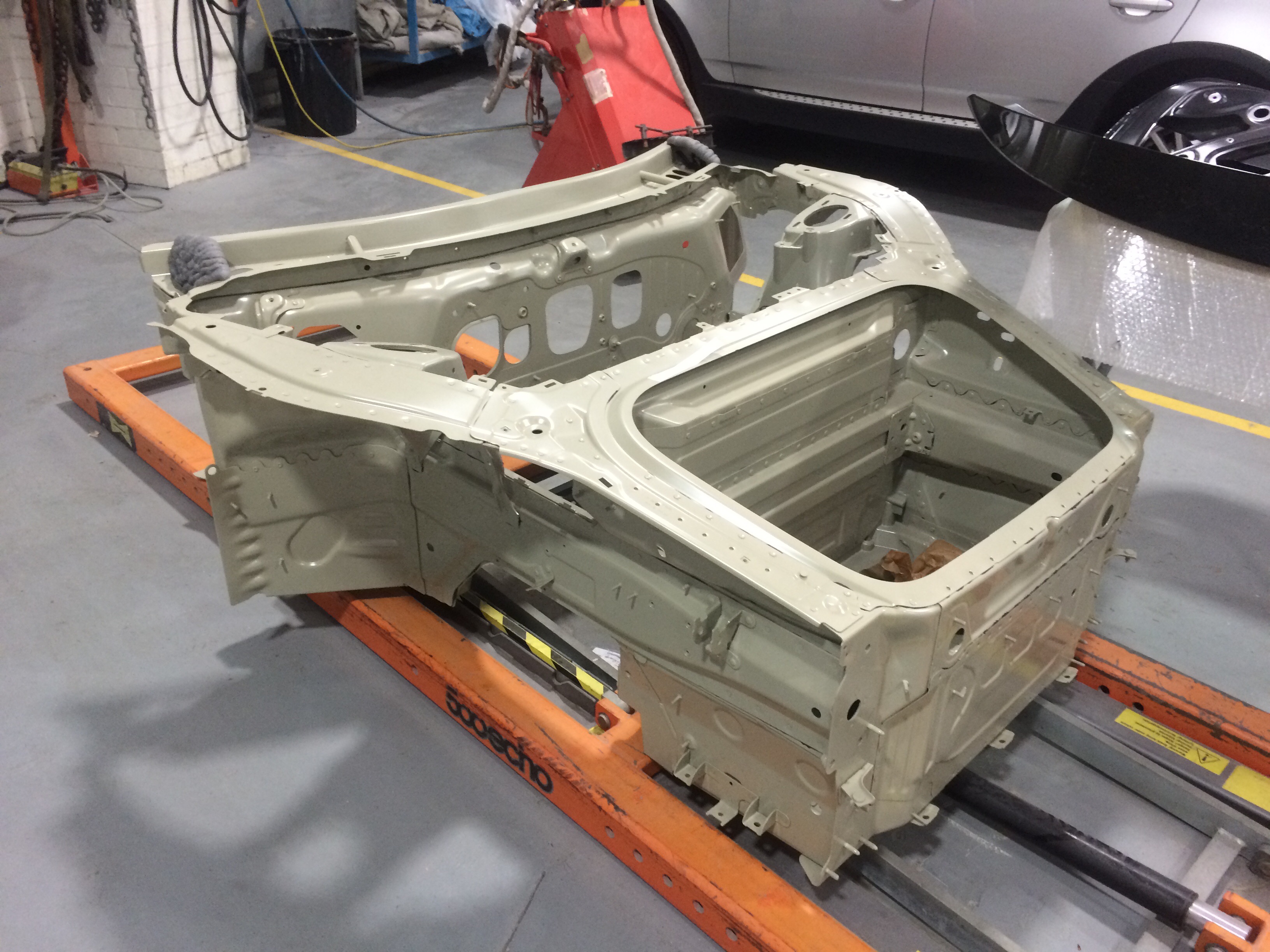

The 991 is coming along. The front clip has been removed, and the new clip fitted. Glue and rivets attach 90% of it to the rest of the body, with spot welds only where the rails meet the underbody.
This image shows how the rear rails have dropped by around 2mm. That eye in the alignment jig should be dead center with the reinforcement mount behind it. Impressive considering how minor the damage to the rear end appeared.
