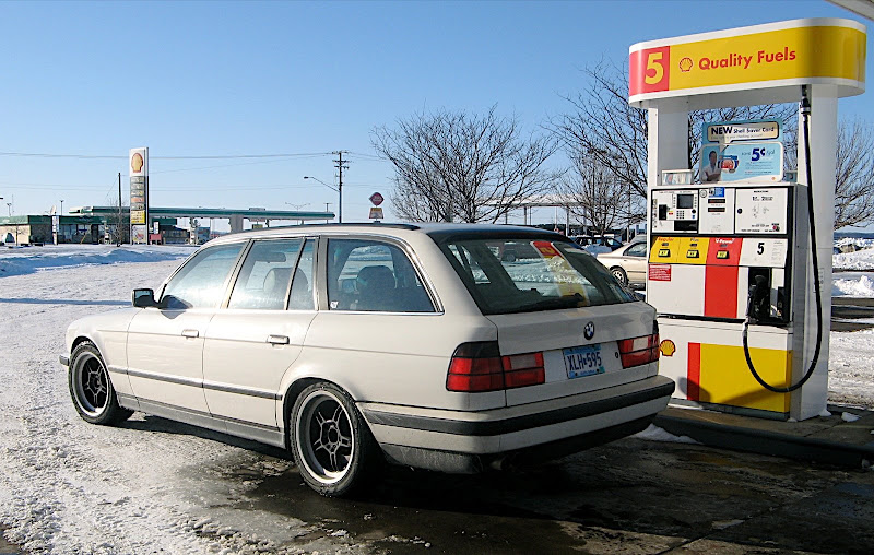

Tammer in Philly
Posts: 10719
Location: CHI, IL
Post by Tammer in Philly »
Adam W in MN wrote: Yep I had it built (check out my web site for info) and sold it to Tammer to get an E39 540i 6spd.
That was 5 years ago this past February or March, right?
Pic from my first fuel stop in WI after leaving your house:
And from fall 2012, last time I bothered to photograph it:
Still chugging along at 240k miles or so. Getting some love this summer: new brakes all around, probably shocks. Unfortunately the dual sunroof finally shit the bed for good, so that needs attention. Front end needed a respray before, and needs it worse now. But you can't kill this thing--it will always get you from A to B (which is more than I can say about my E53 ...).
-tammer
