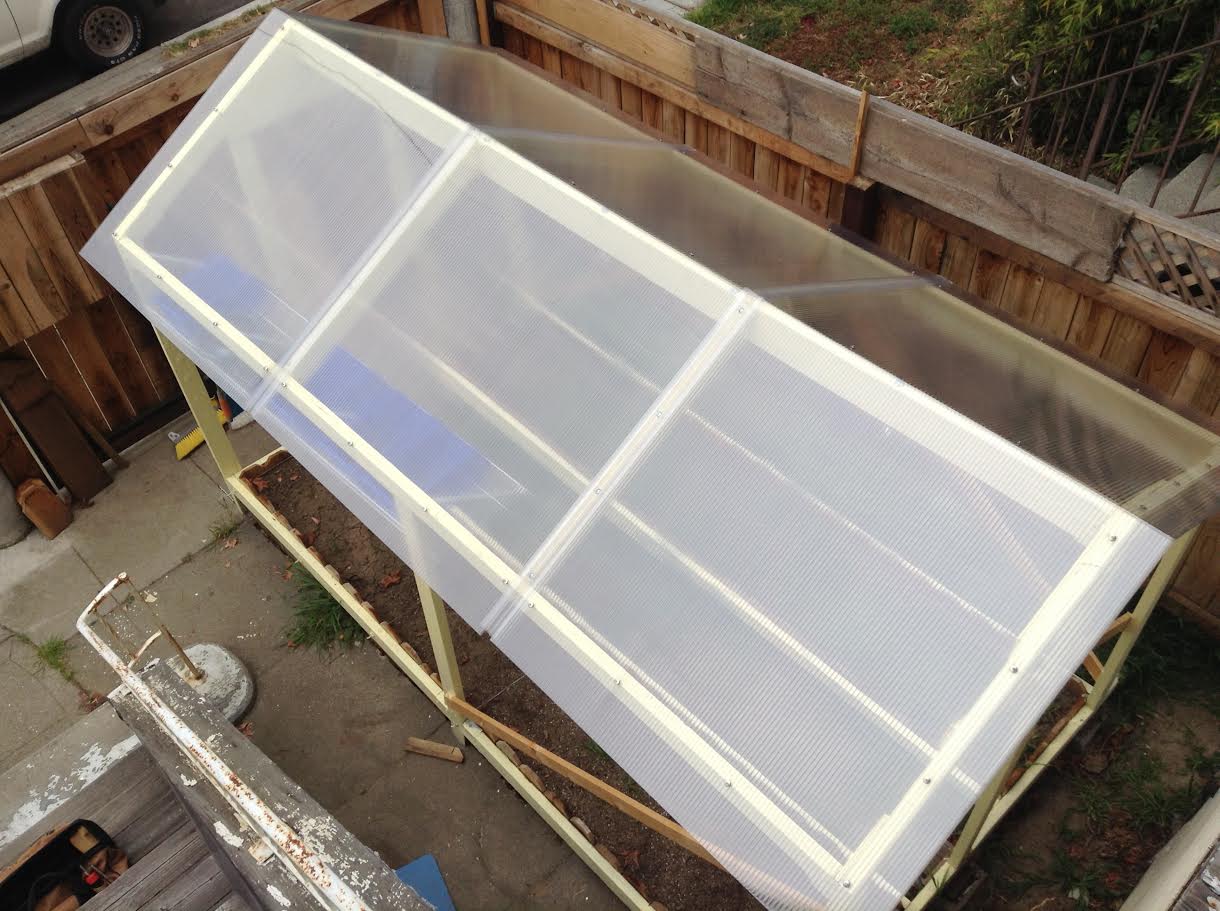

I recently used multi-cell polycarbonate panels on a project and I really like the way they work. They are very common outside the US but not easy to find here in larger sizes. I'm going to be at your house in two weeks so we can talk about it then.

Yes, that stuff. On the west coast it gets imported to the port of San Deigo so it's more readily available down there. The distributor here had a hard time getting a small number of 12' panel sent up here at a reasonable cost.
It is used in larger commercial projects in the US but not in residential construction. Outside the US it is used the same way we use corrugated metal and plastic panels. I saw it used for shanty towns in Turkey and the roof of Mario Bataly's new Eataly in NYC.
Having used it to make the roof of my greenhouse, I really like the stuff. It can be heat formed, it is stiff for it's weight, and offers good insulation. it is also much easier to work with than corrugated when it comes to making water-tight joints. For the greenhouse, I heat formed it into a v-shape so no extra water-tight joints needed at the top.
It comes in tints too for shade and heat control.

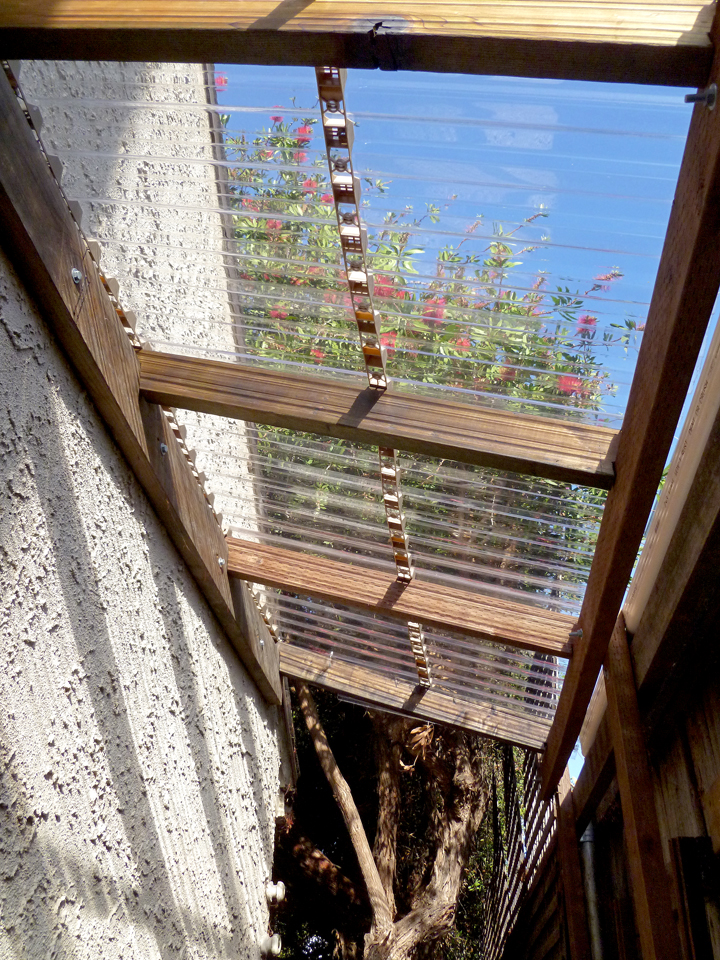

As for the corrugated FG panels (like the ones sold at most home improvement stores) they are even lighter yet. I just installed these over an outside storage area behind my garage and was very surprised on how weak they really are; their spanning capabilities are almost non-existent. The same rule would apply: have a strong framework for them.
This is what my roof/cover looks like:
The horizontal span is +/-36" (+/-39" on the slope) and the horizontal spacing of the rafters was +/-24" o.c. (the width of the panel). I wasn't going to have those bridging strips, but when I put the first panel up, it became apparent I needed something up there to lock the panels together and support the centers. (I could have used simple 1x's, but these strips are formed to accept the panels. This didn't matter much for the centers, but really makes a difference on the ends.)
