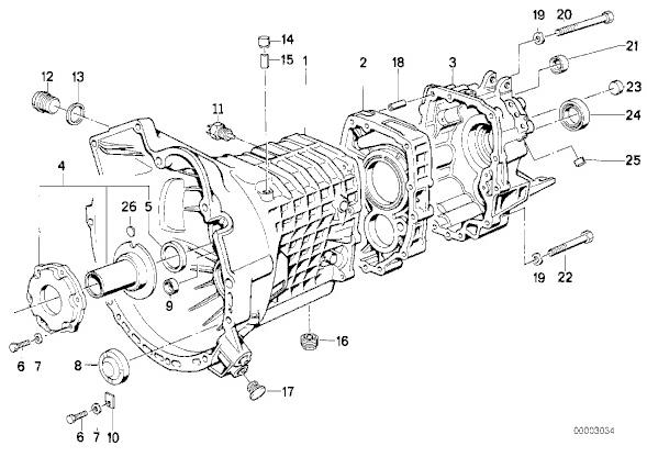

There are some mixed opinions in this thread but no definitive answers, and there is a reason for that (all of the above were right). I posted on the Facebook E28 group and got some clarification. Pictures are courtesy of 1st 5er.
G280 out of a 11/87 M5. 17mm female allen.
G280 out of a 91 M5. This is the one I have in my car, and hence why i was so confused.
Here is the TIS manual page regarding the late G280.
Quote on Rob_K's response on the fb group:
For E28, they were originally in the forward location by the green arrow, but at some point in production (i don't know the dates) it was shifted to the rearward location. The bottom line is - if there is a 17mm hex plug in the forward position use that. If there's a shear plug like the photo above, use the rearward 22mm plug.

This would have been nice to know before welding a wrench onto the shear plug to remove it!! I replaced it with a 17 mm allen like the early version. This was a PITA. I guess i have a E34 M5 trans in my car??

Interesting information contained in this thread. Can either plug be used if you have both? I assume my earlier 280 has the hex head plug (red circle) in the adapter but I have always used the Allen socket plug (green arrow) in the side to fill. My question is does one allow more or less fluid into the trans or are they at the same level. I have always filled mine with the car slightly elevated on the passenger side in order to put a little extra fluid in, about 1.75 quarts. I had read where that was recommended or maybe Jim Blanton told me to do that. I've been doing it that way on all our Getrags... unnecessary?
