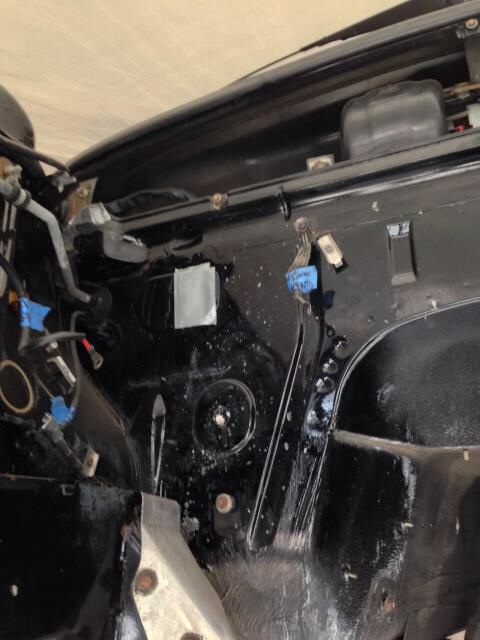

... And there is a 'popout' on the passenger side for the steering column/shaft to go through. Sweet. One less thing to guess about...
Thanks to rubix_cube for the naked engine bay pics!
