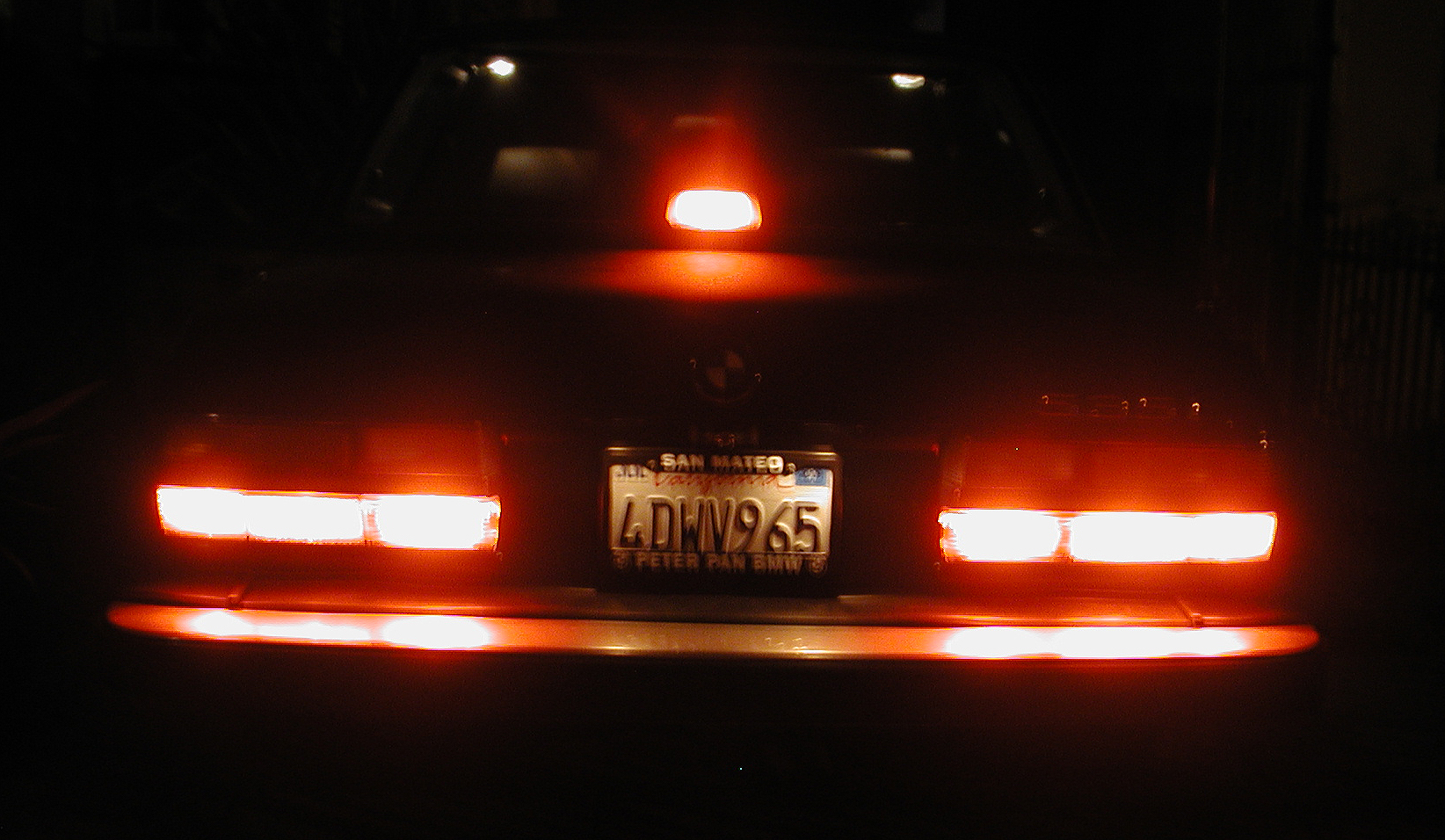

1. Brake & Tail Light Upgrade:
I consider this probably the most important and simplest improvement you can make to your car. The E28 suffers from a deficiency of rear light power; both in night running lights and especially in rear brakes. While your '87 carries the high center brake light ("Cyclops" lamp), the lower tail lights need help. All E28's are designed with a bulb slot for the Euro Rear Fog lamps; BMW blanked out this slot on all US models. This upgrade utilizes this slot for an additional brake light each side and changes the types of bulbs (brighter) in the entire assembly. This vastly improves your odds of being seen from the folks behind you. Your car should look like this when you hit the brakes:
Search for MisterFixit's thread on his upgrade package; worth every penny and insanely easy to execute.(http://www.mye28.com/viewtopic.php?t=109181).
Please don't consider smoked tail light lenses unless you're begging to be rear-ended and want your car totaled.

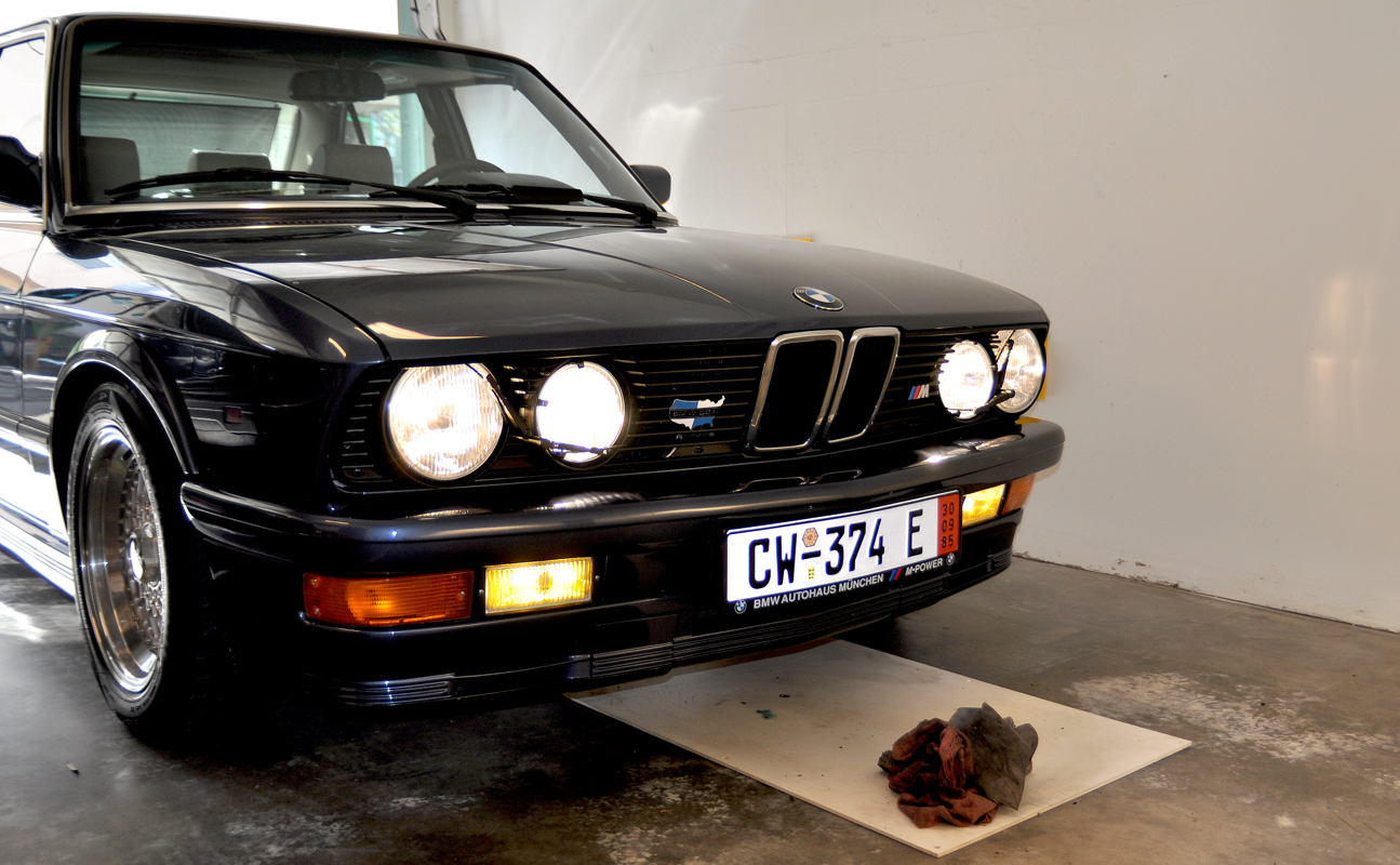

2. Headlight Upgrade:
In keeping with #1 above, another weak spot on the E28 are the front headlights. You can improve them however; review Daniel Stern's incredibly informative website on all things lighting related. Also, Rod Paine's site is equally informative. There are several options to accomplish better and more light output from the front:
A. 5.25" H4 Low Beams: Let's face it, US sealed beams suck. Hella makes an excellent 5.25" H4 drop-in unit for the US headlight buckets. Daniel Stern would argue that the Cibie unit is far superior and he may be right. Drop in 100/90 watt bulbs and you make a great upgrade better (note: do not attempt these higher bulbs until you upgrade the wiring).
B. 7" H4 Lows & 5.25" H1 Highs: This is known as the Euro Headlight system. Standard on all Euro versions, far better than even option A above. Do this along with some 100 watt H3 driving lights and you're all set for those Morris County backroads at night. Yours could like this (well, maybe not quite):
C. Wiring Upgrade: Daniel Stern and Rod do extensive write-ups on this upgrade. Consists of installing relays in between the fuse box and headlights then running 12ga. wire from the relays up to the headlights. I did this to my M535 and it made a considerable difference in the light output. Relatively simple to do and Stern's kit is pretty complete.

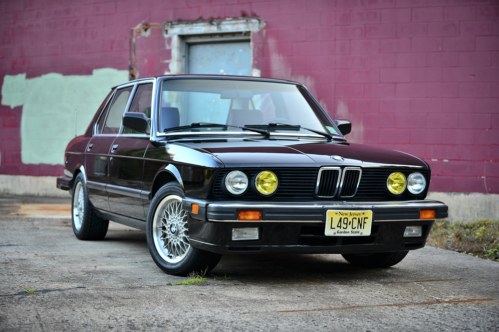

Great list up there. I live in New Jersey, it's crowded, and anything I can do to prevent getting hit is something I will put on my to-do list. The headlight thing is relevant because right now I'm basically rocking one headlight and one fog without a lens ):
So, if I were to get those Hella H4's, that is just a drop in replacement for the current lights I have? Are they just like mine (with the high beams included) or do I have to do something special?
Correct, they work in conjunction with the US headlight rings and buckets. You can either just keep the sealed beam highs or go with the same Hella 5.25" lamps with H1 bulbs. Classic Garage sells the set here: http://classicgarage.com/002850871.html.jkarr wrote:^ I think I have a standing offer on the bracket, but I'll keep you in mind!

The only trick to installing new headlights is that the plastic screws that hold the grilles on strip out about as easily as if they were made of playdoh. I've never gotten the grilles off without drilling at least one screw a side. Luckily they're cheap from a dealer or your choice of oe parts supplier. I like Blunttech.vinceg101 wrote:Correct, they work in conjunction with the US headlight rings and buckets. You can either just keep the sealed beam highs or go with the same Hella 5.25" lamps with H1 bulbs. Classic Garage sells the set here: http://classicgarage.com/002850871.html.jkarr wrote:^ I think I have a standing offer on the bracket, but I'll keep you in mind!

I've got H1's and H4's on my 528e, and they make a WORLD of difference.
