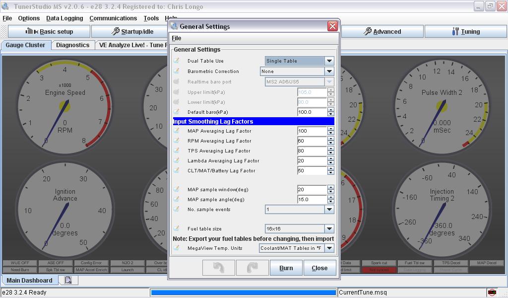

What are the lag factors set to?

I tried the firmware reflash this morning and loaded a different msq that i built last night through a different laptop. I also calibrated the TPS and set the map, rpm, and tps lag factor's to 50. Still no luck. :cry:

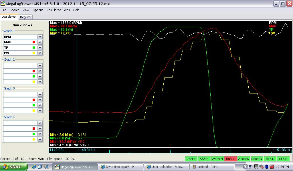

I would go through and check every little thing you've never had to mess with. If you reflashed to a new firmware version there may be a new feature on the default setting. My firmware is different, but if I were you I'd check to see if its still set to speed density only or if secondary alpha-N is turned on. Check to see if its on single or dual tables. If EAE is enabled, disable it and run standard AE. If lag compensation is enabled, disable it.
The settings on the bottom of your lag factor screenshot are new to me, so I don't know where those should be at. Might be worth screwing around with those to see what happens. Looking at the screenshot of your datalog, MAP does not rise as quickly as it should. It shouldn't take so long for MAP to peak after reaching WOT. The rise should be simultaneous. MAP definitely should not peak after the throttle has begun to close. If MS isn't sampling MAP quickly enough, that could do it.
