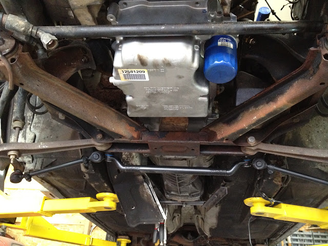

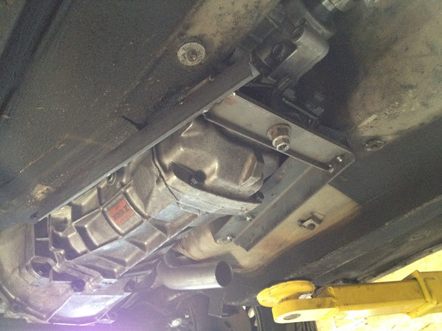

Started to make the trans mount and at least the engine is supported on it's own now.
Starting to make lists of parts. Driveshaft is measured and can be ordered now.
Also able to lift it up and check under it a lot easier. One more spot in the tunnel that I need to pound out and then there will be around 1/2" all the way around the trans.

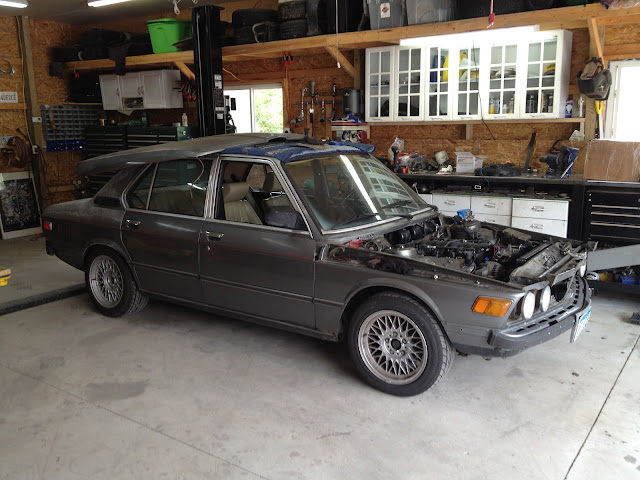

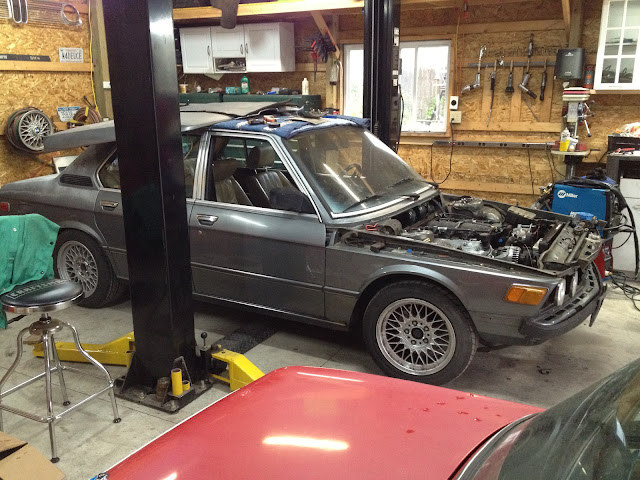

I had to roll it off the lift yesterday and thought it was a good time to see how it sits. Mind you the hood isn't on it and it is missing a fair amount of things from the engine but it actually sits higher in the front then it did with the m30.

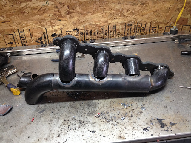

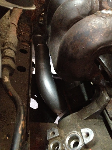

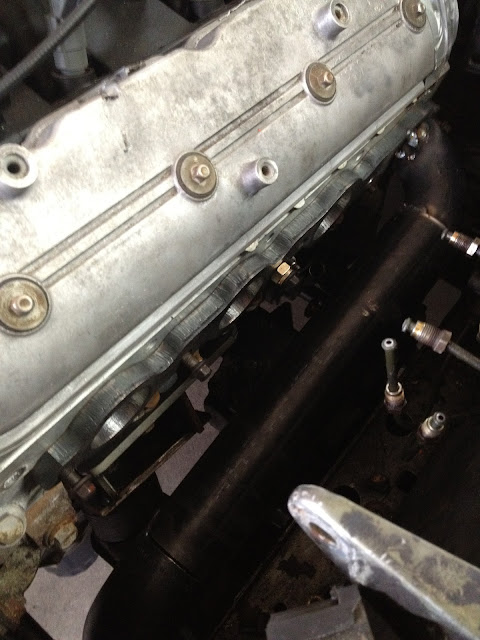

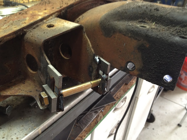

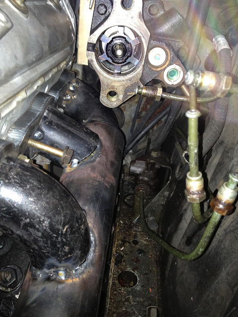

Spent some time today working on the drivers side exhaust manifold today.
Joined: Apr 08, 2009 10:30 PM
Not bad. Do you think it would be beneficial to have them merge with the main pipe using bends instead of straight dumps?
jakeb
Posts: 552
Joined: May 07, 2011 11:30 PM
Location: Bay City, MI
Post by jakeb »
There is a bend coming off the port and I would have liked to have them directed toward the output but I had to have room for the plug wire too. The one that is just straight pipe is about 1" off the main runner. I would have liked for it to be smoother but only so much space to work with.

I would say I have gained at least 2" of clearance. Maybe a little bit more. Everything lines up as it did with the e12 stuff. I might have to end up using 2002 tie rods because the e28 ones are a little long. Hard to tell forsure without having it aligned but it looks like it is still toed in with them wound all the way in. The 2002 tie tod center threaded part is about 3/4" shorter. I have a set in route to try to also see if the ball joints are the same.

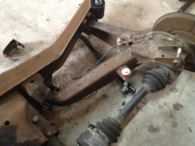

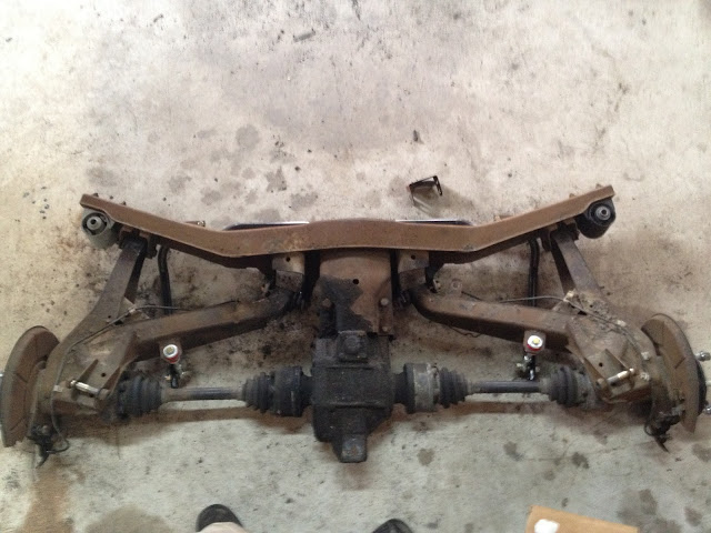

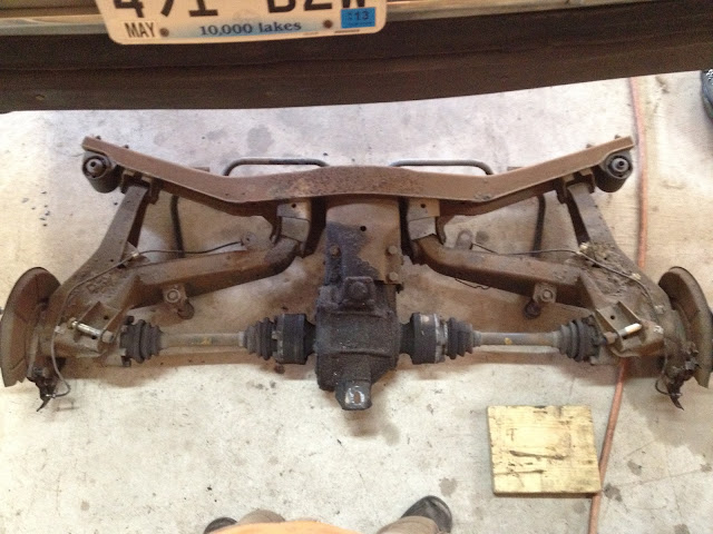

Dropped the rear subframe....a lift really makes it a quick and easy job.
Camber adjusters installed
Subframe ready to go back in...new trailing arm bushings, subframe bushings, ST sway bar, diff mount, and the adjustable camber.

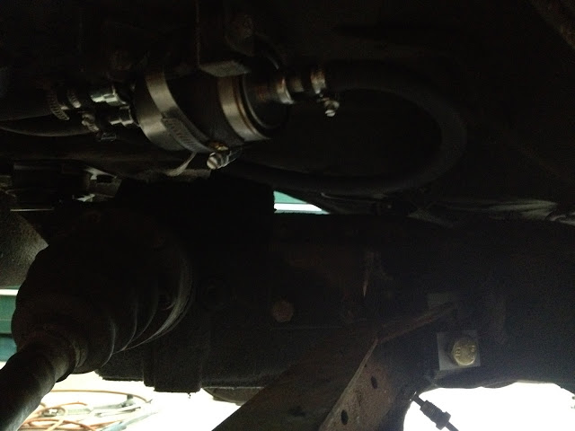

Also got the filter/regulator in place. Will swap out the intank pump tomorrow more than likely.

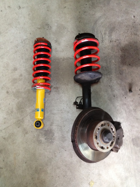

Suspension is just about done. Car is sitting down on all 4 again.
Billy sports and Spax springs
Back on the ground. The old suspension was a combo of blown shocks, cut springs, and __________.
Just to compare a little bit....
with m30
old suspension and LSx
New suspension and LSx
It should drop a bit more once everything is put together and it moves around to settle a bit.

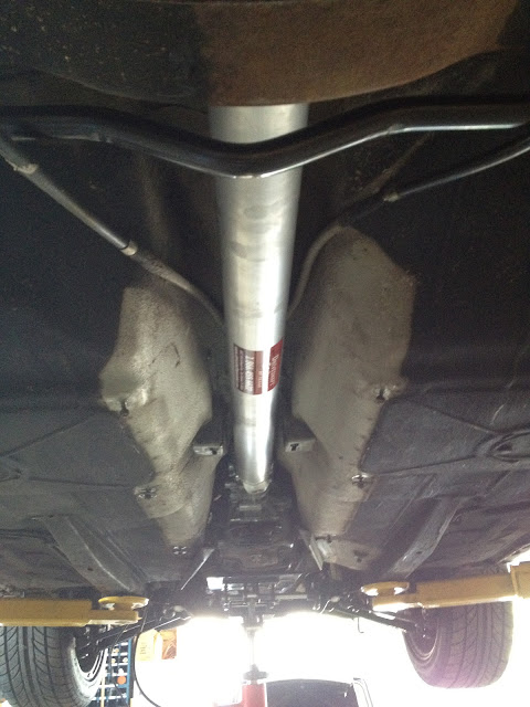

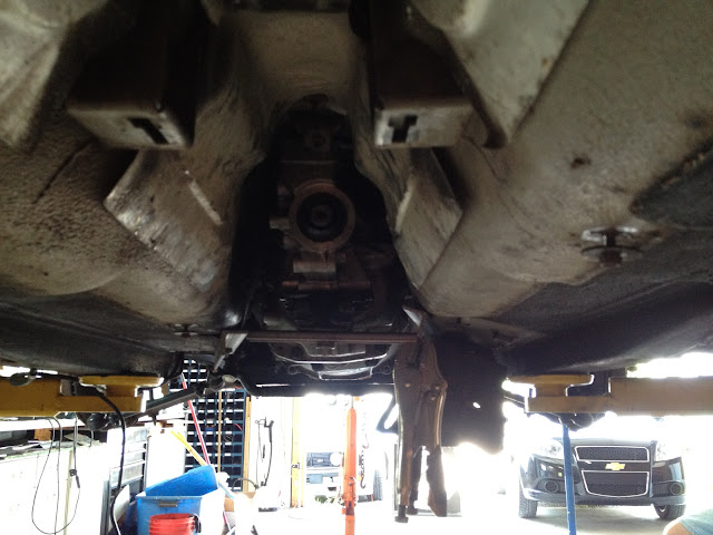

I was waiting on the driveshaft and then was out of town for a long weekend. Got back at the car today...

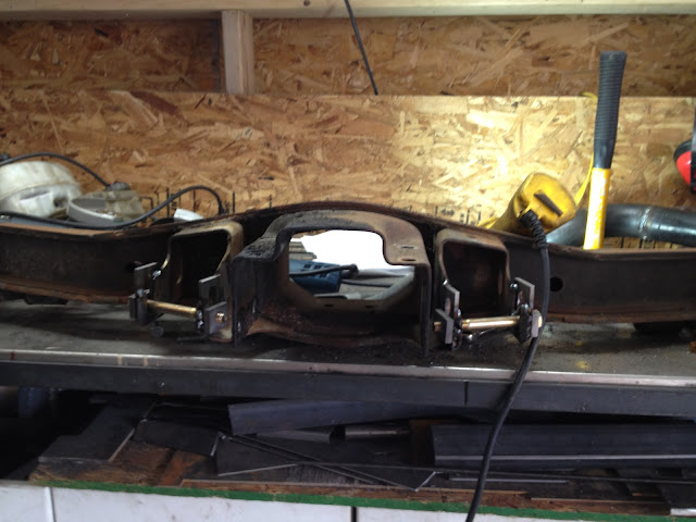

Driveshaft in, clears everywhere except at one spot on the subframe. Broke out the plasma and was able to open it up just enough.
You can sorta see where I had to clearance the subframe.

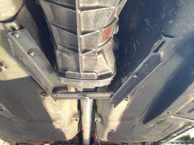

Transmission mount is made..well tacked up and holding at least. Still have to add a little gusset on the passenger side and clean it all up.

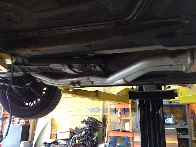

Started on the exhaust...it is a tricky task getting around everything from the drivers side back to the passenger side. I had to order one more bend and a few band clamps...nothing else will really fit.
From the top
It's coming along....the exhaust is more than likely one of the more time consuming things. Just because there are so many things to get around. Hoping to have the bend and clamps tomorrow and then thursday I can finish the exhaust.

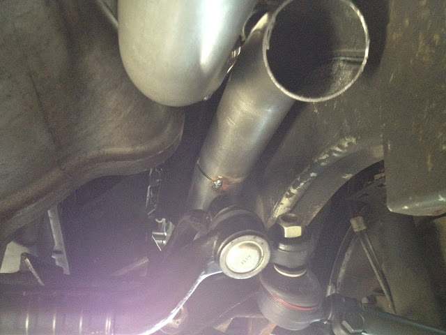

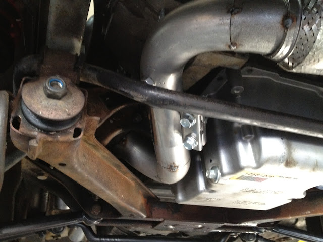

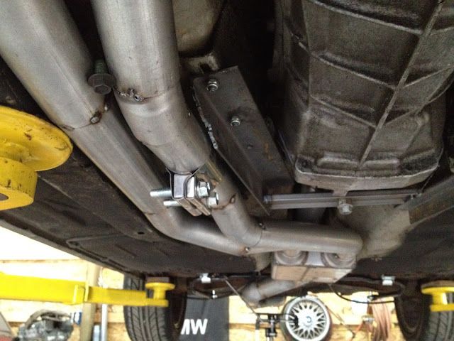

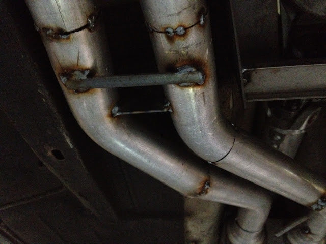

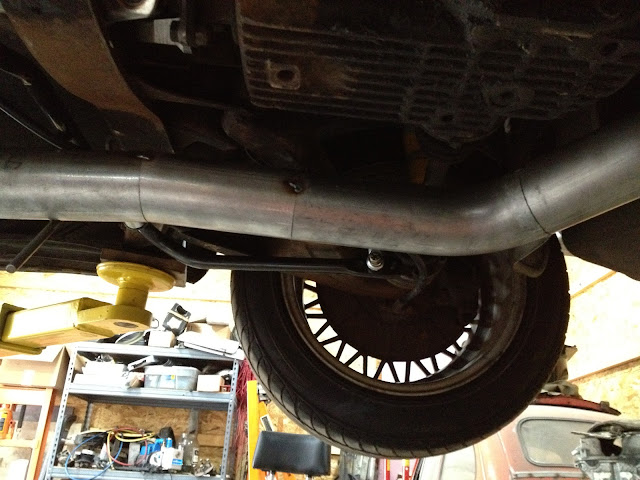

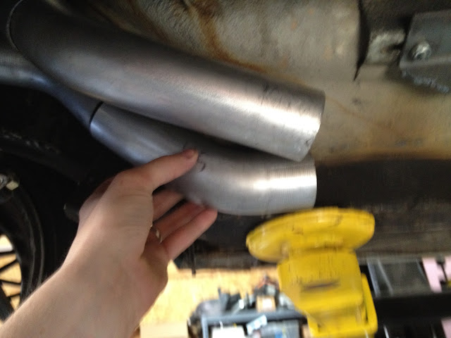

More progress on the exhaust... Two 2.25" pipes coming from the passenger side is way way tight. But there is 1/4" or so clearance at any given point.
Passenger side how they snake around...

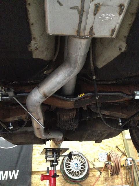

I really liked this joint so I had to take a picture. I make all my cuts with a sawzall. Now this was an angle cut on one side and straight on the other. It was the first cut and I normally just mark one side and go for it.
Same pipe..
There will be another hanger up in the front...but it is all tacked together

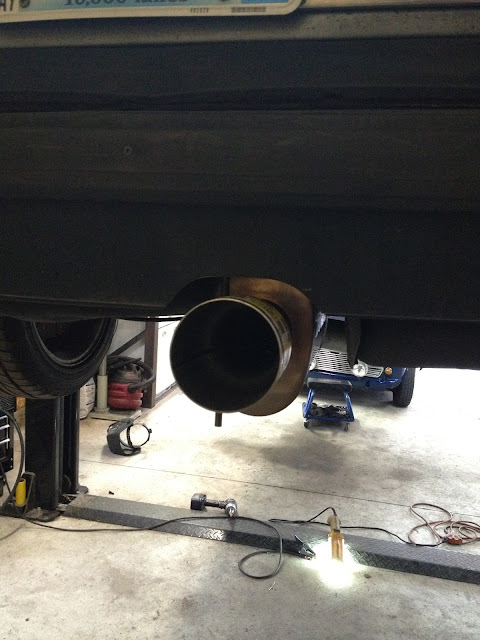

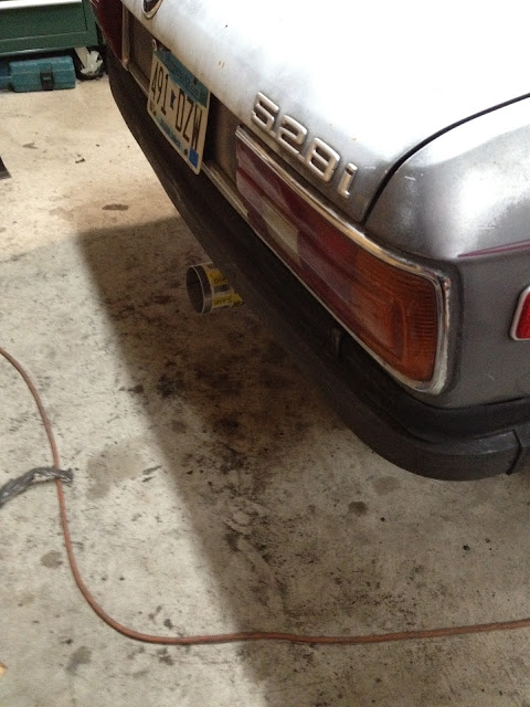

Still need to extend the tail pipe out. It's going to be a straight 4" exit.

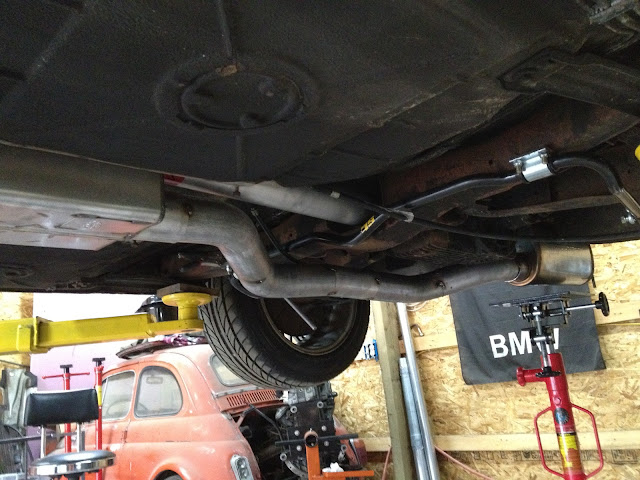

Added another mount up front and a couple braces between the pipes to keep things where they need to be.
Found a 3" to 4" adapter (had to go to the diesel place)

This pic is awesome; do you charge extra for the leaves & debris? ;)
(actually, my cars look like that sometimes. :roll: )

Most of the leaves and such were hiding behind the old firewall insulation. It will get vacuumed up. Remember this build is about function more than looks.
