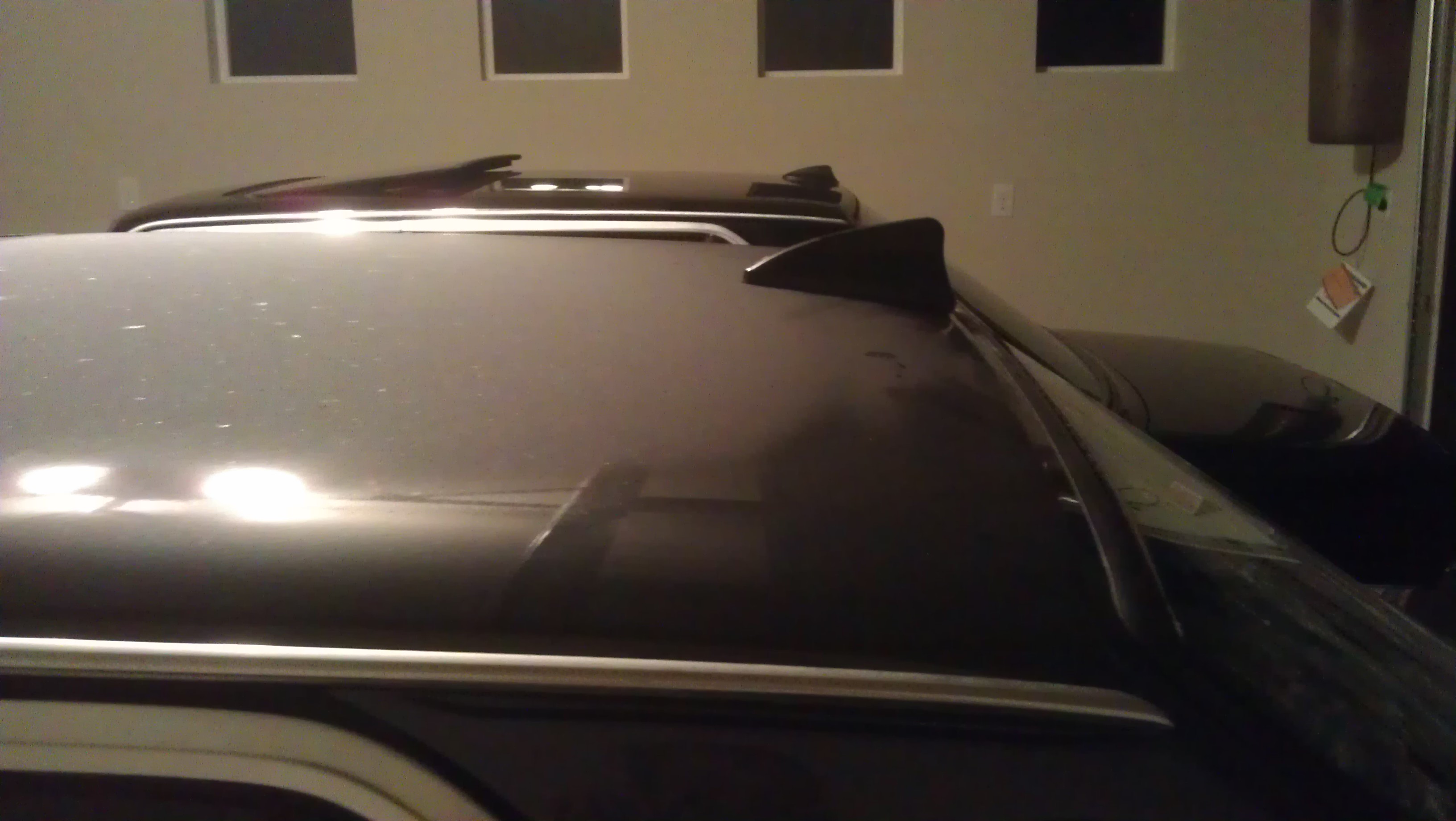

Shark fin antenna installed.

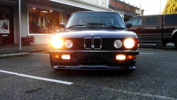

Also sealed a deal for some Euro lights finally. Thanks sskoda!

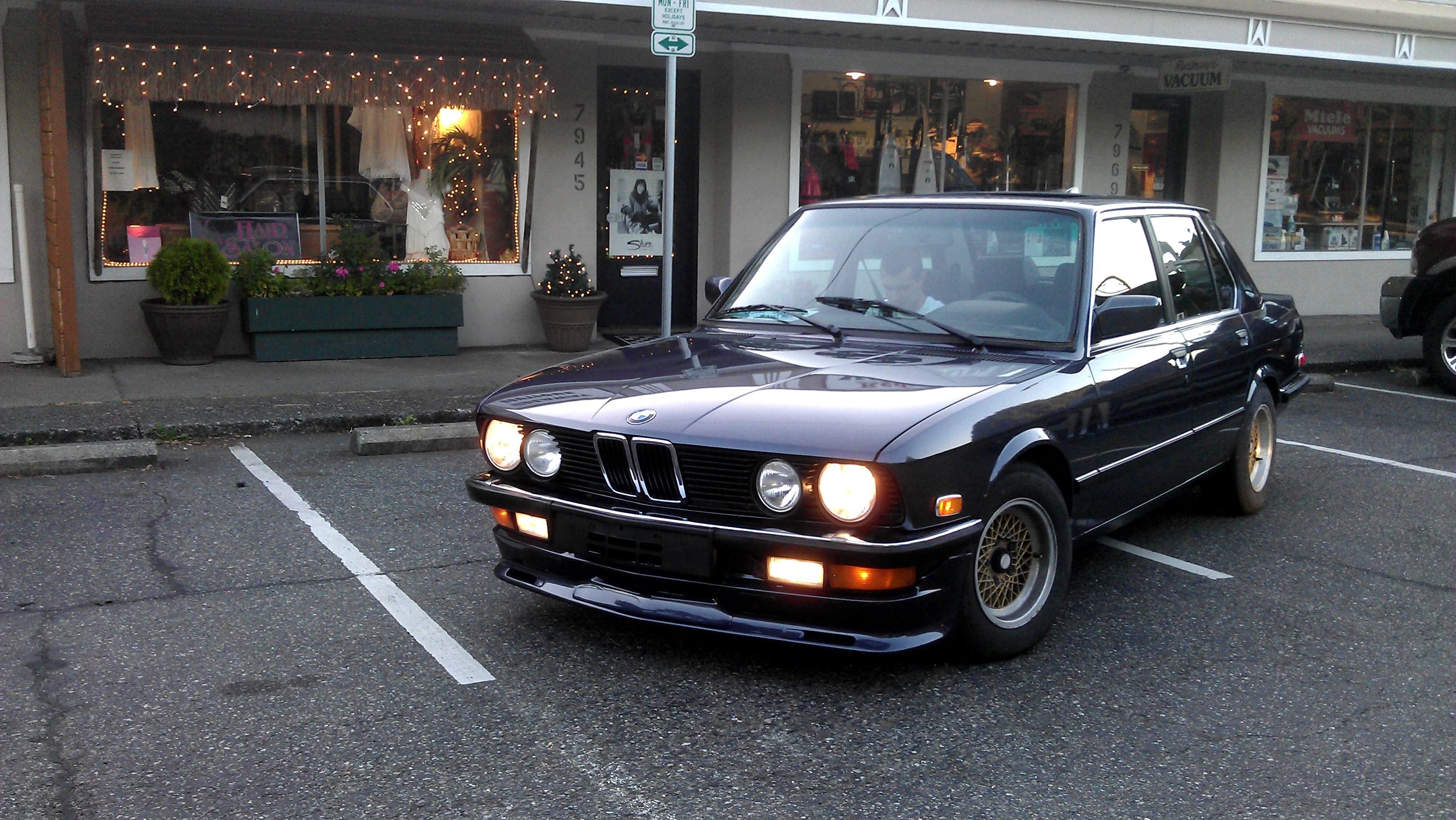

Euro lights are in but not finished yet. The car was in a slight front end collision and the front fascia needs to be lined up. right now the lights sit about a half inch in the grills but also need to be adjusted. At the same time I'm aligning everything I am going to swap in some clear hid's on the lights and fogs. The car also spent the day yesterday getting a full tune up. Had the hartge rear spoiler installed also. Monday I will look into new brakes all around the car and getting the ac recharged. After this it's just small stuff.

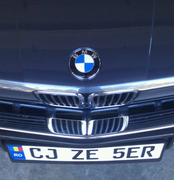

Since I will be selling the 533i I decided on swapping over the rz's to my euro last friday.
And I custom ordered euro plates..

Ya I should've removed the side markers. Not till after I painted the car did I find out they were added on when imported. In the future I'll see about removing them.
Jesus Christ, put some fucking tires on those wheels!! Looks like shit like you're driving around with 4 flat tires and on those horrid roads!
Looks nice other than that. Wish you had asked about the sidemarkers before painting the car.

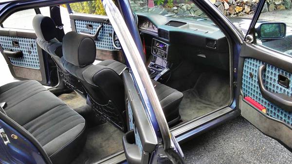

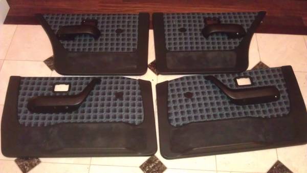

Did some work to my euro this week. Had to fish out this build thread to do an update, it's been that long. Not much has changed on the 5 up until this week I finally tackled my ripped door cards and had creative intentions in mind.
So I visited Joanne fabrics..
I had zebra print in mind but I didn't really want to copy shagrath's (I believe it was) car. So I chose a blue plaid design.

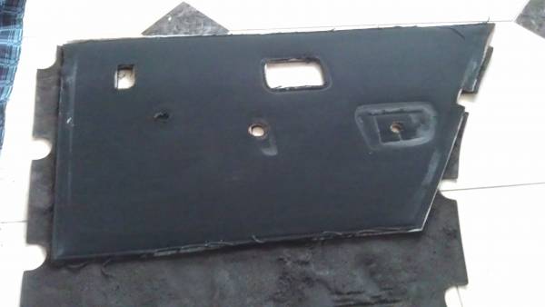

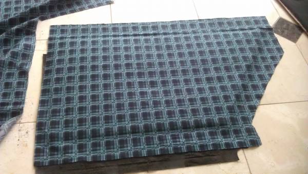

Here is a step by step process of how I wrapped my door cards. All I used as far as tools is a simple office stapler (my stapler did not go all the way through the cardboard and the cloth), scissors, razor blade, and a screw driver
disassembled removing the door card panel from the surrounding trim. I left the insulation layer on because I found I could work around it.

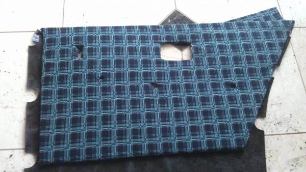

I then put the fabric over and cut off the excess material leaving 2-3 inch of extra material to fold over the edges. Pull the fabric tight staple it on each side so when everything is put back on the fabric won't sag or move to much out of place.

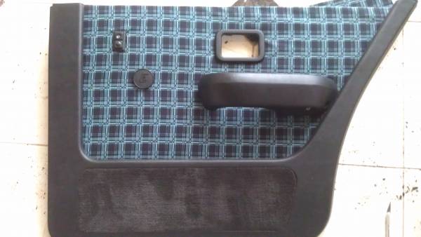

Cut out holes with a razor blade for the window switch, cap that would be for the manual windows, all the holes for the screws on the arm rest and for the door handle and make sure to mock up the door after this step to make sure everything fits before installation. Staple all the fabric down from cutting all the holes tight so it doesn't allow slack in the material.
Then you can put it all back together

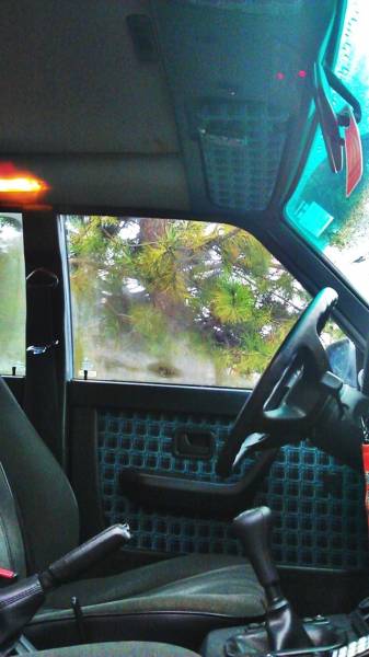

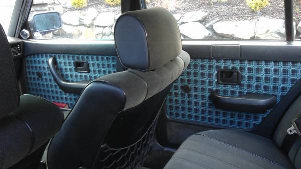

Installed..

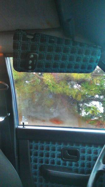

Wrapped my visors in the same material.

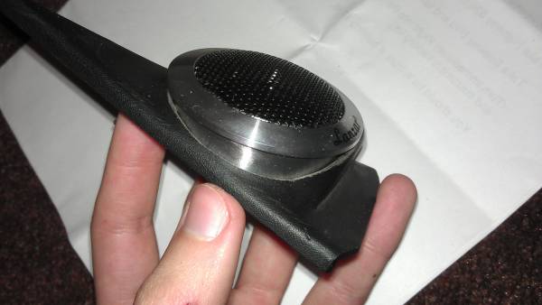

Also added new tweeters to my sound set up. Had to cut down the pod, almost didn't even fit. May end up redoing it, not too happy about how it sticks out.
..and that brings us up to date on my 528i!
