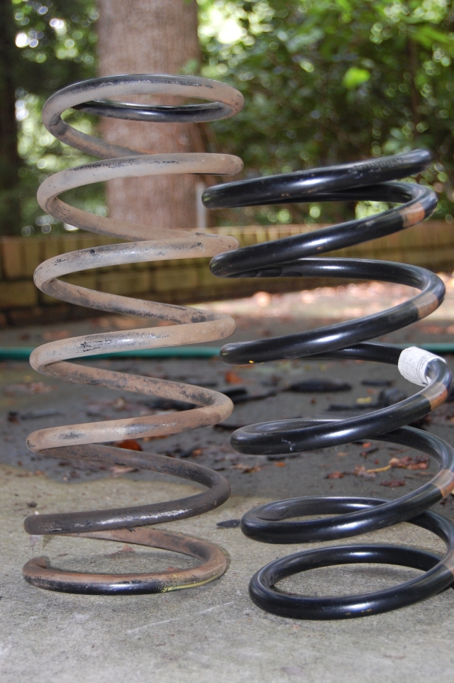

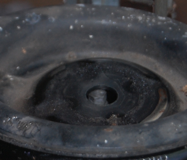

Im still in process of installation of these shocks and springs. Right now my most major question is which strut bearing to use. In this picture, the one on the left is the original bearing and the one on the right I got from bavauto, it is part number 31331139452. Does anyone know what part number my original bearing is? The original bearing uses the 28.5 mm cover (31331124335) if that helps identify the original part. RealOEM also lists a part number 31331139484, which is a camber correction bearing. You can see from the picture that the 452 strut bearing is quite a bit taller than the original bearing. So I wonder why that is? Would the original bearing even work with the new bilsteins?
Also, here is a comparison of the original springs to the mtechs.
m535is
Posts: 1319
Location: Greenville SC
Post by m535is »
The new upper bearings look correct (452). The rubber sags over time and so they get shorter. I would use the 452s as that is what was originally installed unless you have a set of camber corrections sitting around. If you have a set of the camber corrections sitting around then I would put them in at negative camber. .5 a degree is not much but it is better than nothing.

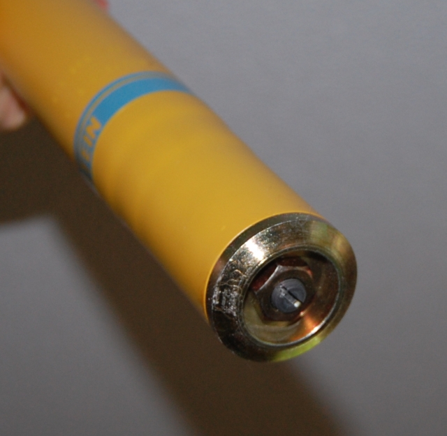

New question: do I remove the lower nut on the bilstein unit? Does this allow the piston to go to full extension?
m535is
Posts: 1319
Post by m535is »
Picture please

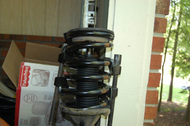

Post by Retro Rust »
So I feel like i am having to compress the ever-living crap out of these springs and Im actually not even close to being there yet. So I am wondering if the shock piston is not at full extension?
So Im wondering if this nut at the bottom of the bilstein shock is holding the piston closed or something.
m535is
Posts: 1319
Post by m535is »
DO NOT LOOSEN THAT NUT!!! You purchased sport shocks. That means the piston is shorter because you have fewer spring coils than stock. The way this works is the following. It is really bad internally for a shock to bottom out, aka compress all the way. So you design the suspension so that the spring reaches what is called coil bind, aka when all the coils of the spring are touching making the top and bottom of the spring solid, the shock will still have some travel before it bottoms. In a stock setup you will find that there the coil bind length is more than that of a lowered setup. So if you were to use stock shocks you run the risk of bottoming them out when the shorter springs compress. This is why you should always use sport shocks with lowering springs. So the sport shocks have a shorter piston. This means 2 things, 1 is that you will prevent them from bottoming with the lowering springs and the second is that you will reduce the amount of overall travel of the suspension. This is why you are having to compress the springs more than you thought you would need to.
What is happening is you are having to compress the lowering springs about as much as you had to compress the stock springs, which is just fine. Keep compressing!
Hope this helps,
