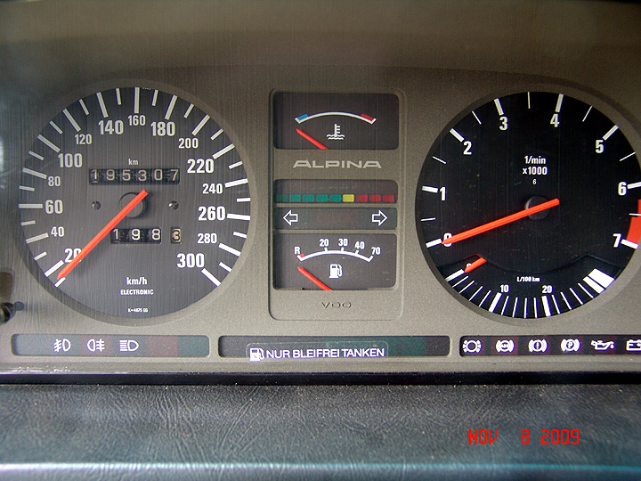

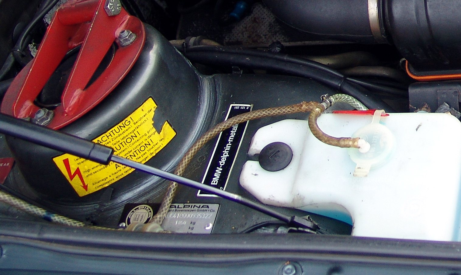

B7Turbo
Posts: 1260
Post by B7Turbo »
It looks fishy to me, unless you can verify the head and the block serial # as stated bellow.
http://alpina.ca/showthread.php?t=114
B7Turbo
Posts: 1260
Post by B7Turbo »
Euro-M5 wrote:This car had some front end damage which was also repaired (core support and perhaps the frame as well) and subsequently re-painted, I inspected the car thoroughly few months ago...it appears to me las it was an original Euro 528i that got almost all the Alpina B9 bits transferred from Alpina #505 B9.
Here are some photos of Alpina B9 # 575 ( i presume the last car built) I almost bought while I was in Germany in 2009 from my German Partner..BTW, it has the Alpina Vin plaque..
and Here's the correct Original Alpina Gauge Cluster
few more original cluster photos of cars I have seen
more photos of car number 575 I took at below link,
http://euromcars.com/cars/alpb9575/
All other clusters you see with Alpina stamped on the dials are fake, they are stickers affixed to the Dials, Original Alpina cluster has the Alpina stamp on the frame and in order to stencil that the clear plastic cover has to be unglued, I go to Germany frequently and look at many real and fake Alpina cars...hence quite familiar with finding fakes...If I am not sure I simply email my contact at Alpina in Buchloe and he confirms the VIN...
Regards,
Saliya
Saliya,
The speedometer is belonging to a B7, that is given, because the B9s didn’t come with 300K speedometer.
Also the others are from an e30 and 34s and the one with stamp Alpina logo is the additional display that comes on BiTurbo for further info that you would need such as diff Tem, air and fuel ratio, etc…. which is an add on and has a separate part #.
Also the VIN should read the Alpina VIN as well both on top of the shock tower mount (stamped) and the body plaque.
But at the same time, you mentioned that the owner changed the original B9’s body with another e28 in which take this thing to a different category, but certainly not an Alpina if that is true. Another word, do you think if I buy all the parts and install them on an e28 would that conceder as an Alpina car?
Sia
