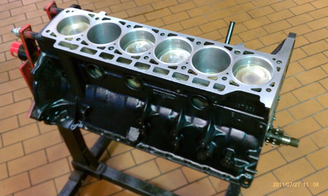

So we started working on it today at around 8am. Here is a shot of the engine bay.
Pulled the transmission out in about a hour. Had the motor out about a hour after that.
I was going to use our old school BMW engine stand here at the shop. However, we didn't have the right mounts for a M30 so I had to run over to harbor freight and pick up a cheap engine stand. Luckily it was one sale. :banana:
Got the motor stripped down shortly after. I don't think the chain guides are supposed to look like this!
I can still see crosshatching in the cylinder walls! :banana:
Here is a shot of the head.
Cleaned up the block really well and hit it with some gloss black spray paint. It's still drying in this pic.
And thats all for now. Started cleaning around 3:30 because i made a huge mess, lol. I'm gonna send the head out Monday and install some new valve guide seals. MLS and ARP's should be here by the end of next week (Thanks Todd!). In the mean time ill be cleaning and painting everything before it gets reinstalled.

Post by L_N_Love »
Are you doing this at Leith BMW? Thanks for taking the time to post the photos. Keep them coming.

Post by clongo »
Yes I am. I'm a tech there.
