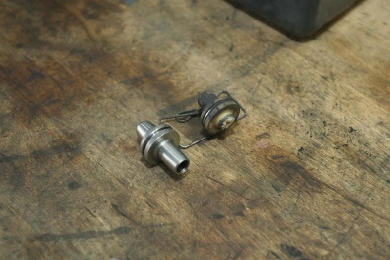

The metal pivot pins seem to all be silicon bronze. If my memory serves me, this material's surface is naturally low friction. I haven't seen anyone use steel for this part, and I assume it's because it would increase wear on the clutch fork. Clutch forks are cheap. The plus about having a threaded pivot is it would be adjustable. I don't know. I'm still on the fence.

The 850i pivot is stainless steel.

Quick question, what's the function of the spring? Just to keep it in place?
Joined: Apr 08, 2009 10:30 PM
Keeps the clutch fork in contact with the pivot to keep it from rattling.

That's pretty much what I'm imagining. I have both a 1/4x20 tpi and a 3/8x16 tpi tap. If either will match the hole I'm going to use a hex head stainless bolt with a locknut.

Hole is 0.305" in diameter.
3/8" x 16 tpi tap was $8 and takes a 0.313" (5/16") hole.
I am confident this fastener size is more than enough for this job.

Just did a test run with a 0.297" hole in a junk cast aluminum water pump. Tapped just fine. I'm going to run the 3/8" x 16 tpi tap without any extra drilling.

Got the hole tapped and got an allen head bolt in there. Clutch disengages beautifully now and the action is silky smooth.

The point is that if anyone else decides to do this, the hole is perfect for a 3/8" x 16 tpi tap. Figure out how to hook the tap up to a stubby ratchet though. Otherwise it's impossible. I did this by holding the tap in a backwards 3/8 drive (male) 1/4 drive (female) adapter and an 11 mm 12 point socket.
Also, the locknut interferes with the bellhousing, so if you can source a smaller nut for the 3/8" fastener, it will probably work best. And finally, if you get the 'set screw' style fastener from McMaster in a good length, this will be the ultimate best.
