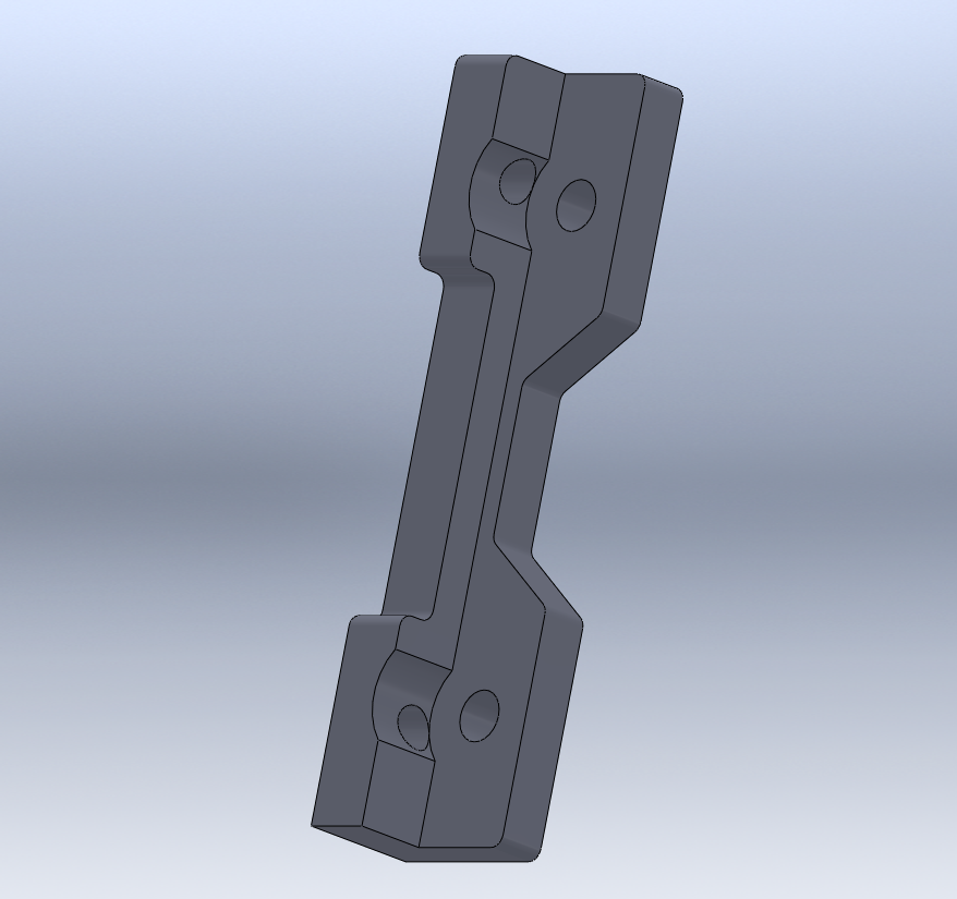

Finally was able to upgrade SW at work and get my old drawings back.
I have someone that wants me to make front and rear brackets for Stop-tech/Brembo calipers, so now that I have my sample and my drawings back, and some parts to do the testing on, these will be available at as low of a cost as I can make them. I found someone that can anodize them as well.

mooseheadm5 wrote:Finally was able to upgrade SW at work and get my old drawings back.
Great stuff, I'll buy front and rear when they're available.
