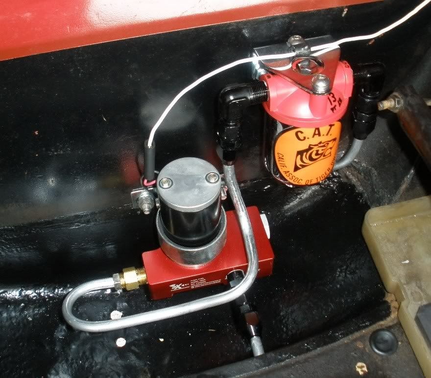

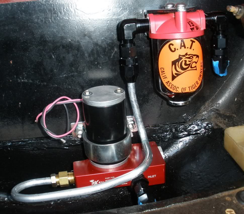

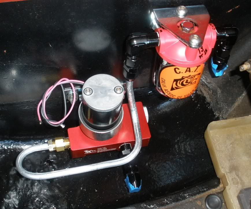

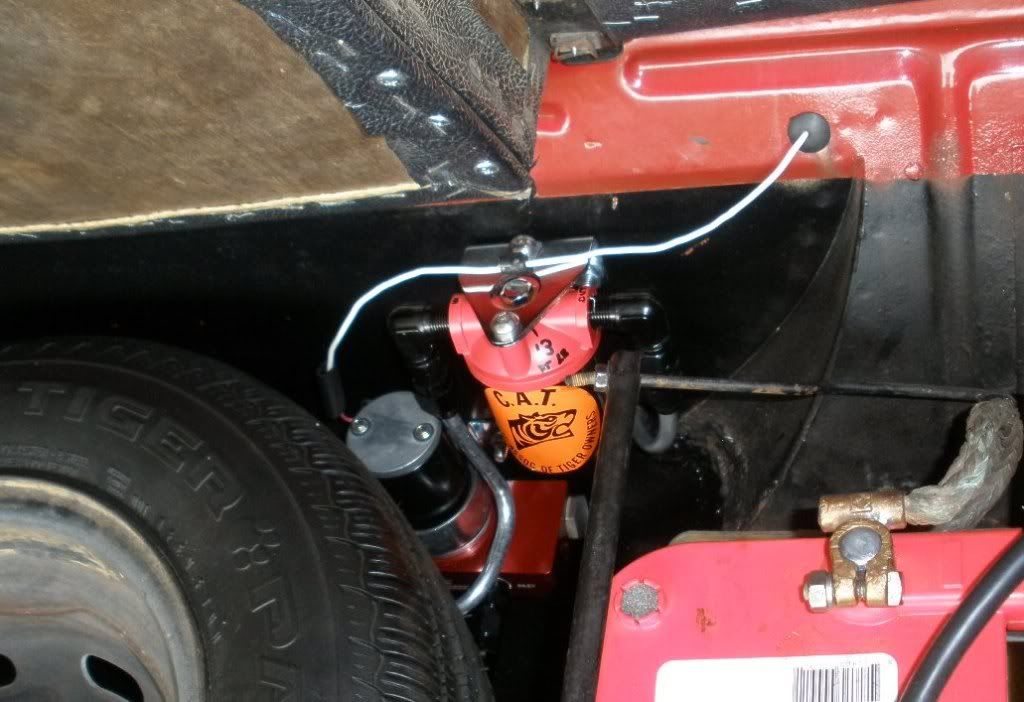

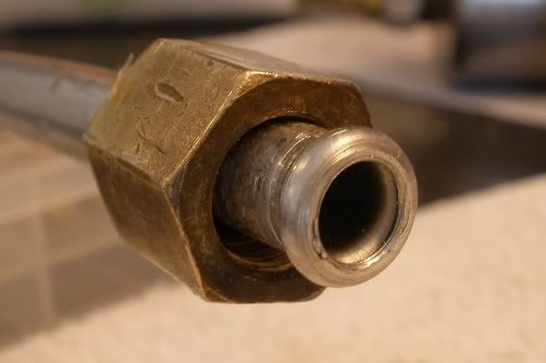

Getting the fuel flow to spec.
120 GPH fuel pump with a high capacity fuel filer installed. Using 3/8 line from the tanks to the carb with only ~4" of rubber line in the complete system.
Still have to connect to the 3/8 line from the tanks to the pump and then from filter to to the 3/8 line to the carb.

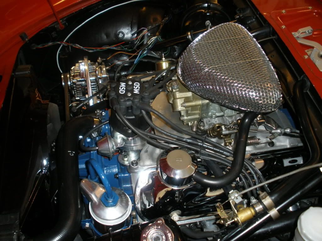

The new air filter. The stock filter can not flow what is needed for over 400 HP. I will use the stock filter for car shows. After all.....they sell for $600 - $1K to replace.
Got the 3/8 line to the crossover. Was not as hard as I thought it would be.
I cut the 5/16 line to get the compression fitting off. Drilled the opening to 3/8. Here was the tricky part.....getting a proper flare on the 3/8 without the compression collar (would not fit). I went down to AutoZone and used their brake line double flare kit. The trick is to stop at step one and not push the flare down in the second step. So far so good, no leaks.
Here is the pump install finished
Spare tire still fits great. With the trunk panel down....you see nothing.
The fuel system can now support engine tuning and my goal of 480-500 HP. :banana:

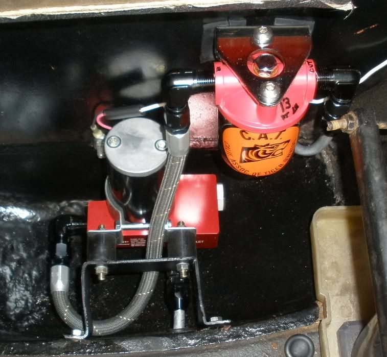

Some changes to the fuel pump install due to it being VERY loud.
The hard line from the pump to the filter transferred a lot of nose to the trunk wall. So, I ordered 1 foot of Pegasus 910 6AN Kevlar Braided PTFE Racing Hose and two 6AN strait hose fittings. I also flipped the pump bracket around, used some rubber mounts and made another bracket.
It is much quieter now.
