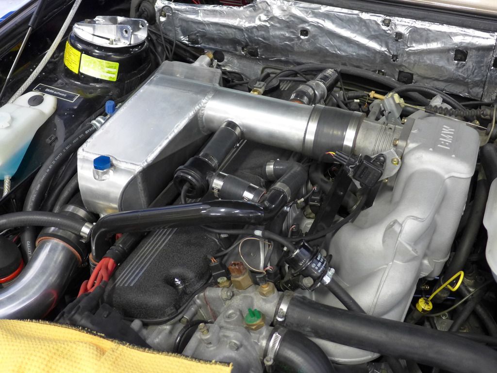

Awesome car/build but what the heck is going on with the air filter?
Re: 535i "Project Sepang" - 06/01/15 re-build update
Just turned the K&N filter/tube up (from it cozy little corner) in order to do the A/C system serviceT_C_D wrote:Awesome car/build but what the heck is going on with the air filter?

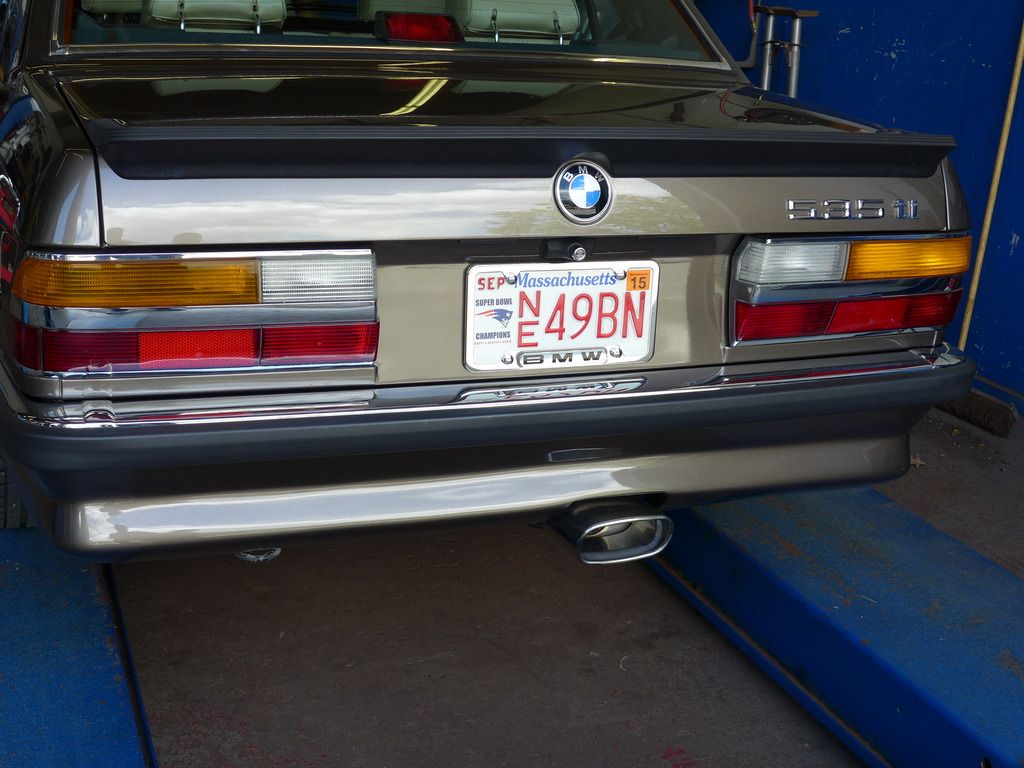

What, no comments on the oval exhaust tip?
I was hoping for a couple ideas or thumbs up if OK, or thumbs down if "not-so-much". I think its a little to big (tall), but width-wise it fills the cut-out in the rear valance nicely. Unfortunately the dual tips I've look at either don't fit or look crappy... so I went with oval like I had in the B7. I also don't like the edge of the inside 3" pipe showing, should be smooth, and not visible transitions, I think? So, for now, it stays.

I'm not a fan of that exhaust tip. I think a Hartge one would suit it better if you wanted that ovalish shape.
Fine, if you don't mind me saying...RoyW wrote:What, no comments on the oval exhaust tip?I was hoping for a couple ideas or thumbs up if OK, or thumbs down if "not-so-much". I think its a little to big (tall), but width-wise it fills the cut-out in the rear valance nicely. Unfortunately the dual tips I've look at either don't fit or look crappy... so I went with oval like I had in the B7. I also don't like the edge of the inside 3" pipe showing, should be smooth, and not visible transitions, I think? So, for now, it stays.
I think you should bring back the dual tips, providing you find some that fit the 'groove' of the build. I quite like the Borla "intercooled" tips that are on my car. Very period-chic.

I actually think the tip looks ok. At first glance my thought was ugh, oval; should have just gone with a single round tip perhaps. Upon reflection and seeing how well it fits the opening, I came around to like it.RoyW wrote:What, no comments on the oval exhaust tip?I was hoping for a couple ideas or thumbs up if OK, or thumbs down if "not-so-much". I think its a little to big (tall), but width-wise it fills the cut-out in the rear valance nicely. Unfortunately the dual tips I've look at either don't fit or look crappy... so I went with oval like I had in the B7. I also don't like the edge of the inside 3" pipe showing, should be smooth, and not visible transitions, I think? So, for now, it stays.
Nice job on the rest of the exhaust also. My old engineer part (fluid dynamics) had issues when it saw that original 1-into-2 transition. It would be a lengthy thought process and text to describe, so suffice it to say my gut did not like the design of that transition -- too much pressure drop likely required in that transition design, but of course you are limited in length to get into that stock 2-pipe (or Supersprint, whatever it was) setup too. The new setup would appear to be a much more beneficial design.

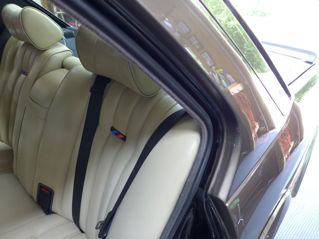

- gave up on getting new edge protection door frame gaskets, which I had had on order from BMW for the past 15 months, and pick up a very good set of used ones from Todd, thanks TCD
, and installed them.

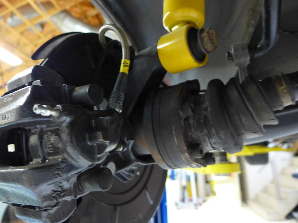

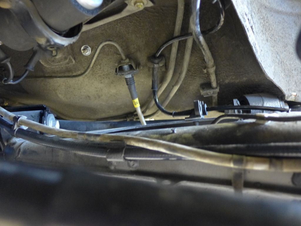

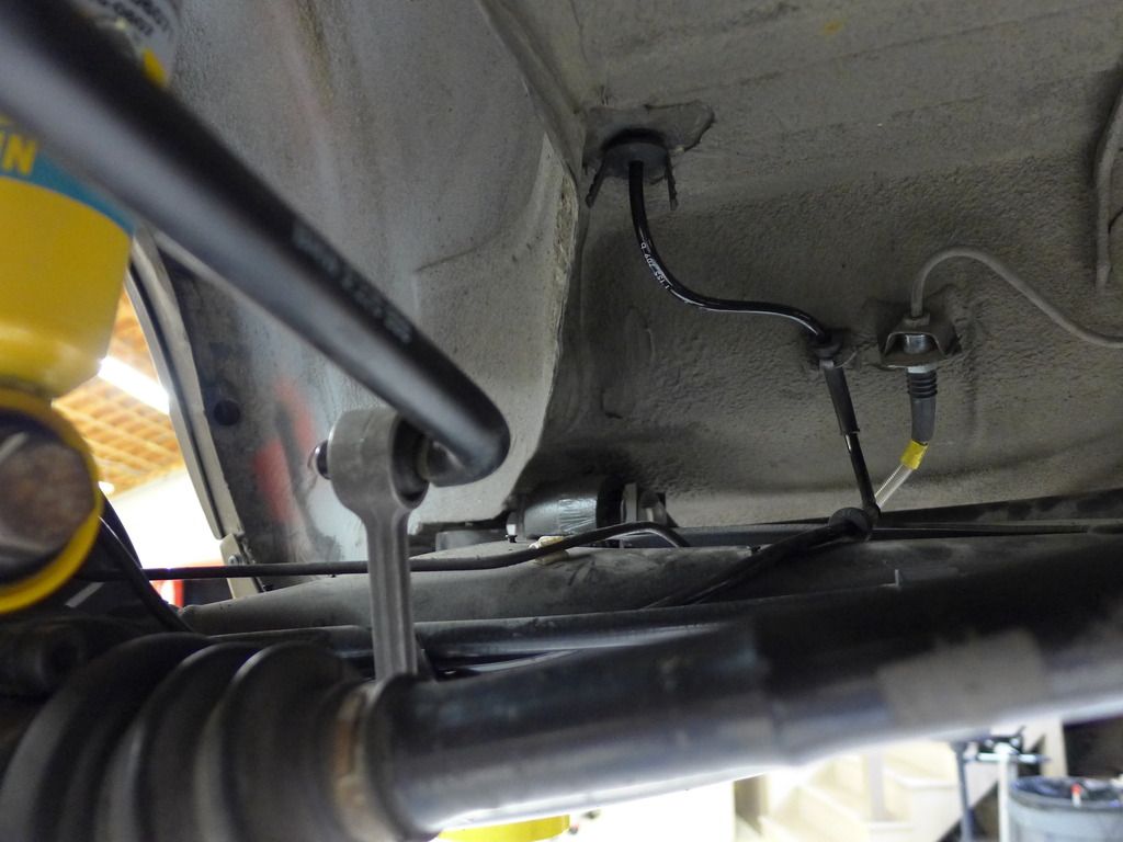

- installed the rear speed sensor which were missing on this car (didn't notice that until the ABS light wouldn't go off). First set I ordered were the wrong ones, i.e., didn't fit... second time was a charm

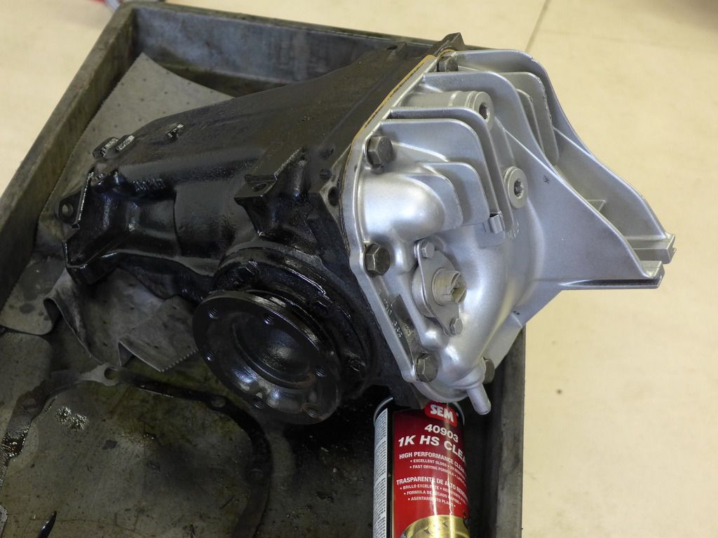

- swapped differentials from the 2.93 LS I had gotten from TCD Todd when the original locked up a month or so ago, and swapped in a 3.25 LS that I got from a member in Canada ... thanks to Squirrely for bringing it down from TedFest

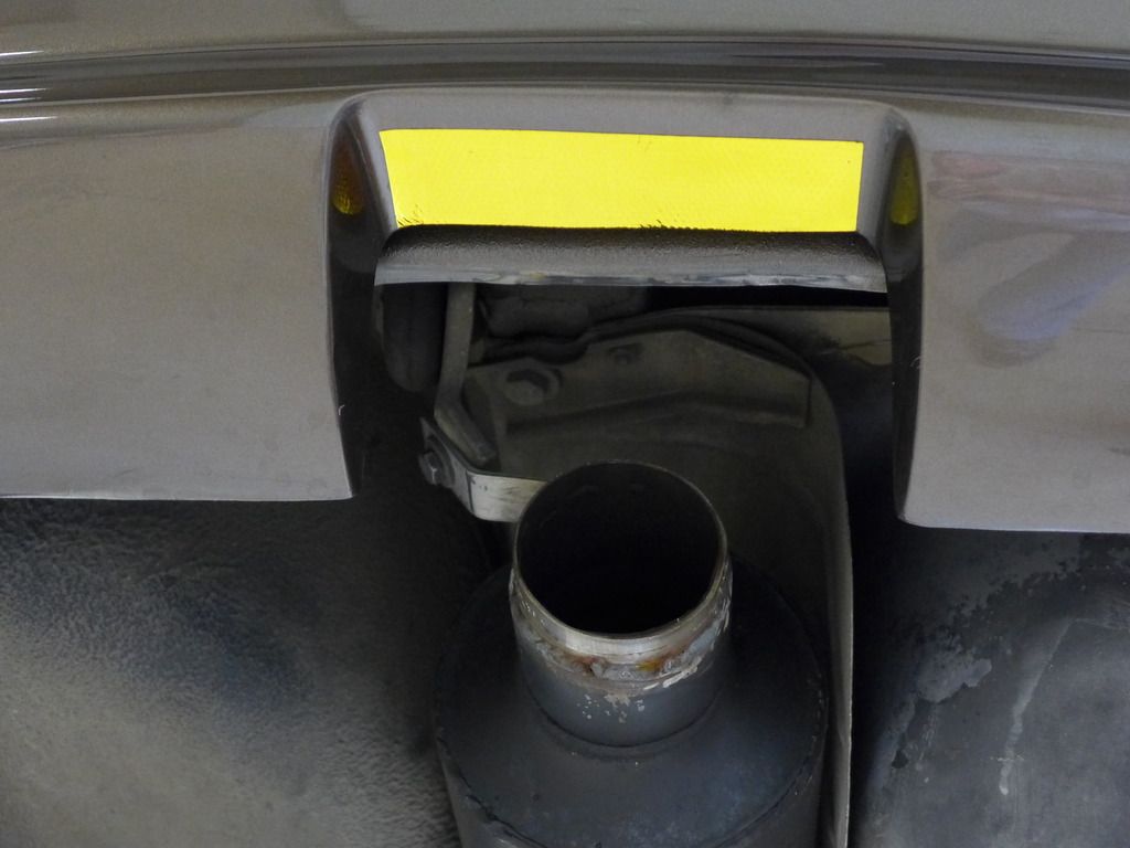

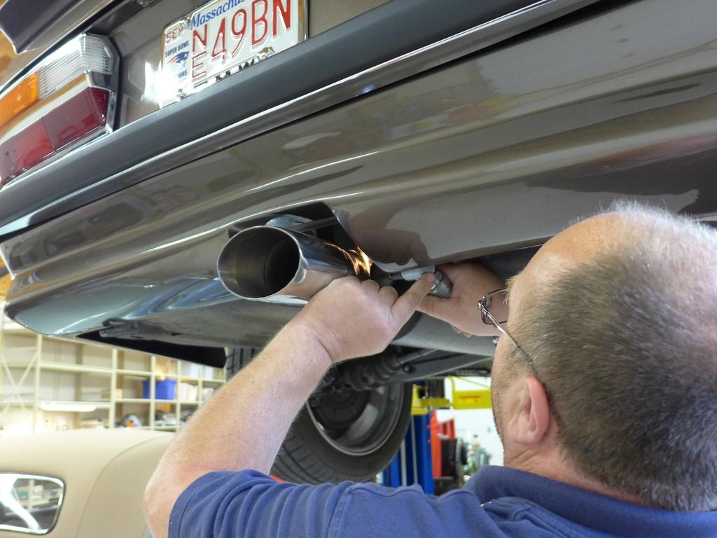

- removed exhaust tip and replaced it with another who's shape I preferred (still not perfect)

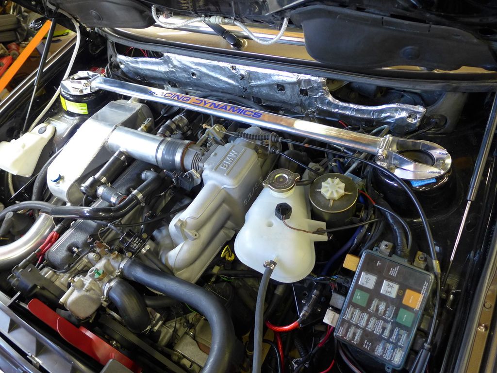

- installed Racing Dynamics front shock tower brace

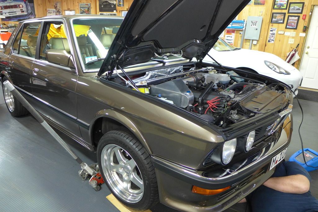

- had Peter Florance fly on up to again dyno-tune the MagaSquirt system/engine, because the exhaust had been changed from a blended 3" and 2 1/2" to a full 3" system, and the valves had been adjusted since the initial tune he did in May 2014
- Tune is right-on, idles beautifully and runs terrific. Dyno results were a little lower than expected, as it was 93 degrees with 85% humidity the day we did it, but still had 268 bhp at the wheels and torque was a little under 300 lbs/ft. Cooler weather and an e-brake that now isn't dragging due to issue with handle and release button (was when we dyno'ed but didn't notice until after

Great set of edge protection door frame gaskets
New rear speed sensors

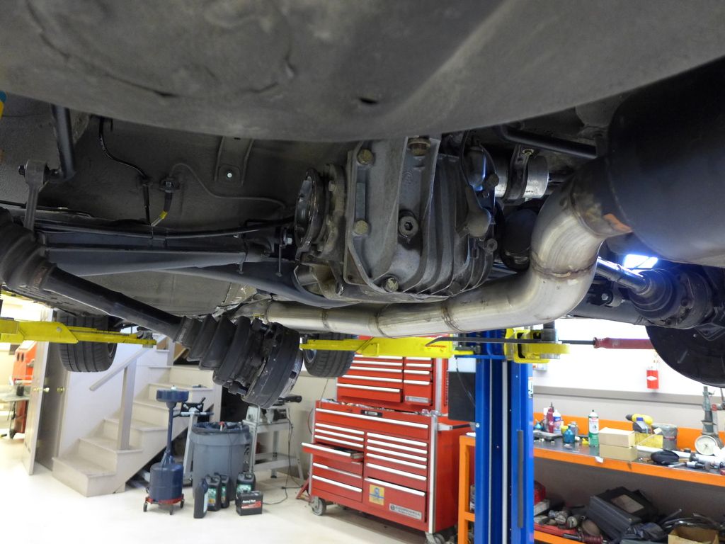

removing 2.93 diff

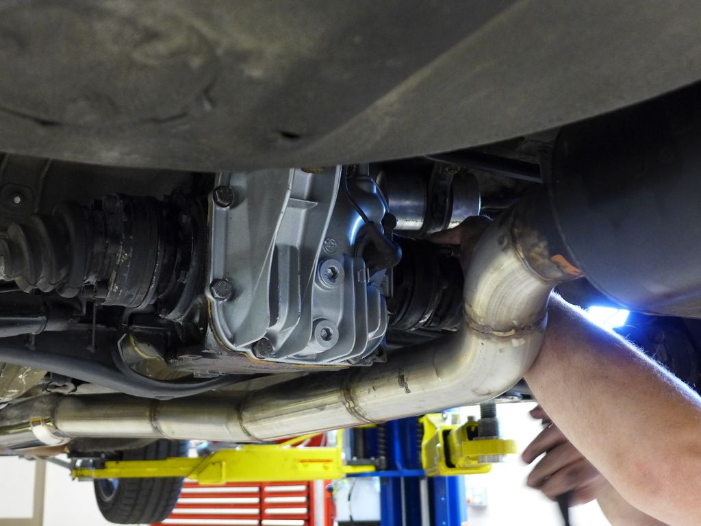

Cleaned-up, painted, & installed 3.25 diff
removing oval exhaust tip
new rectangular exhaust tip installed
strut bar installed
removing 2.93 diff

strut bar installed

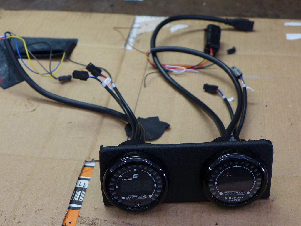

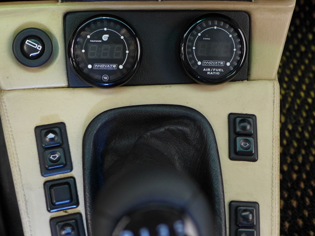

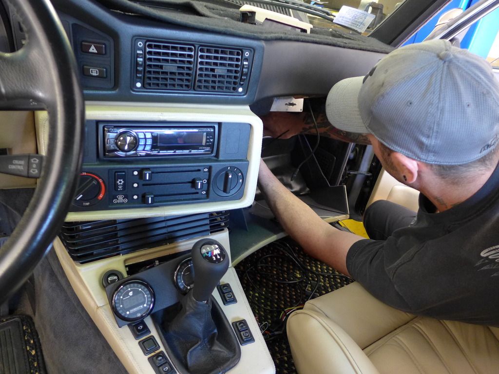

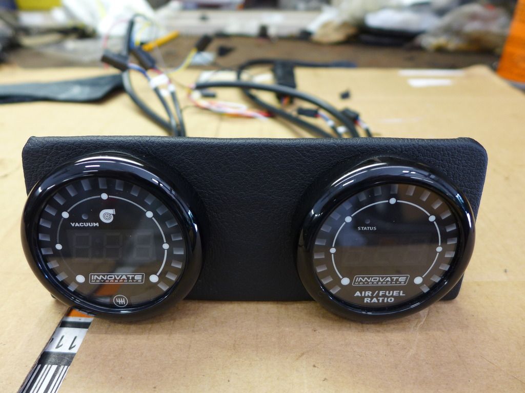

- My friend, Ian, fabricated and installed the boost and air/fuel mix gauges into the ashtray area of the center console

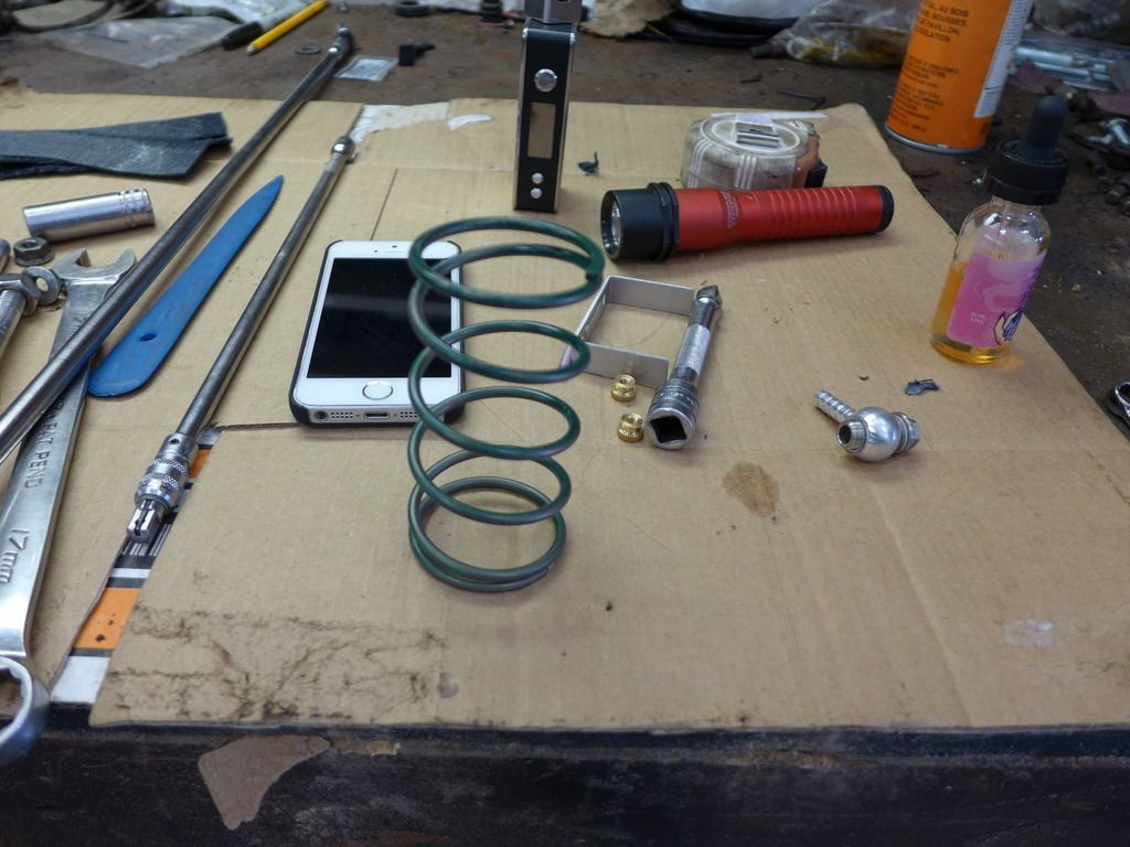

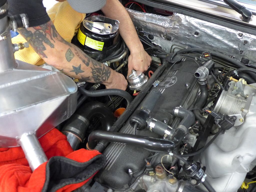

- As the performance with the turbo system was at pretty low boost level, e.g., 5.9 lbs, yielding 260+ wheel hp... with Ian's help, we swapped in a 10 lbs. spring, provided by TCD (in place of the 6 lbs. one) . Holy crap what a difference... much faster and pulls like a train!!
Todd says we should now be north of 325 wheel hp and 340 torque. I will get her back on the dyno to get the actual performance numbers later this month and see what the data log says
- Also, a few other minor tweaks to the sound system, cleaned up some wiring, adjusted the exhaust tip, etc., etc.

Gauge pod fab'ed
Gauge pod installed
6 lbs waste gate spring removed after inter-cooler and a few hoses dis-connected and moved aside
Unfortunately my picture of the 10 lbs spring didn't come out, but it was much bigger in diameter and thicker (and red)... it was a bitch to push the cap down and align the holes so the bolts could be started and tighten.. couldn't take a picture of that procedure, as while Ian was doing the muscle work of compressing the spring and holding/aligning the cap down, I was turning in the bolts... not a lot of room for 3 hands in there!

Gauge pod fab'ed
Gauge pod installed

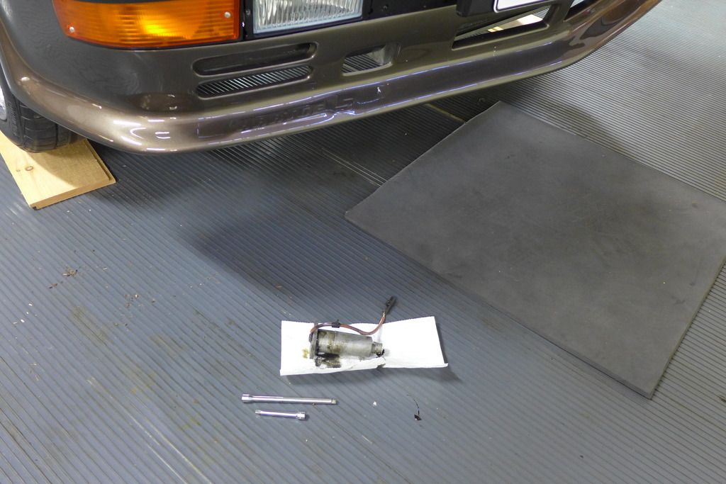

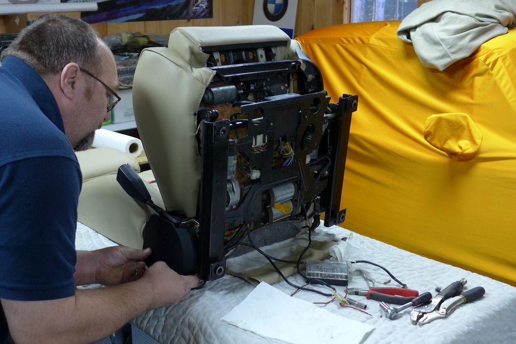

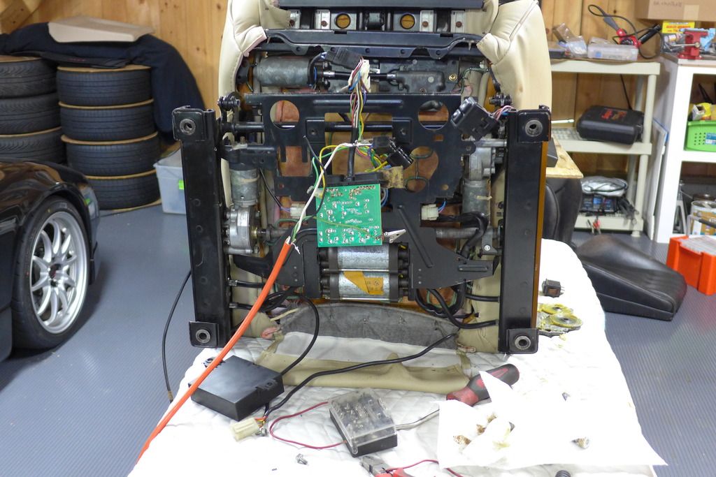

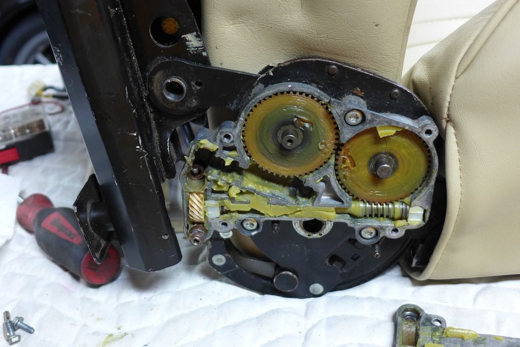

- driver's seat wasn't working at one of the 4 adjusting function switches, e.g., rear of seat wouldn't go up/down to adjust that height. Took the seat out of the car and apart to test where the problem was... turned out to be one of the gear thingies was jammed up... got it turning freely and put that marvel of engineering back together (see picture below). Glad Steve knew what he was doing, because I would have been clueless

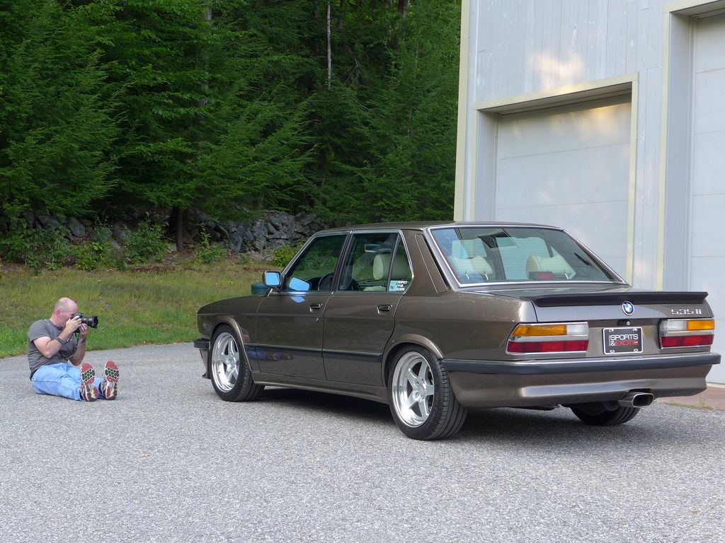

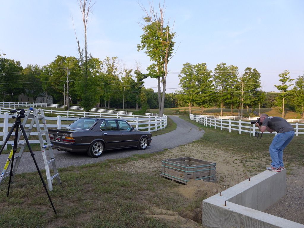

Here's a few pics from today
-RoyW
- sunroof wasn't working at all (had before)... took that trim piece off at front of headliner by the switch and found the wire/connector had mysteriously come apart. Put it all back to together and now the sunroof works perfectly

- a had a low oil check light on the panel all the time (oil level was good)... so, replaced the oil level sending unit. No more light
