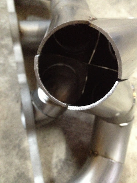

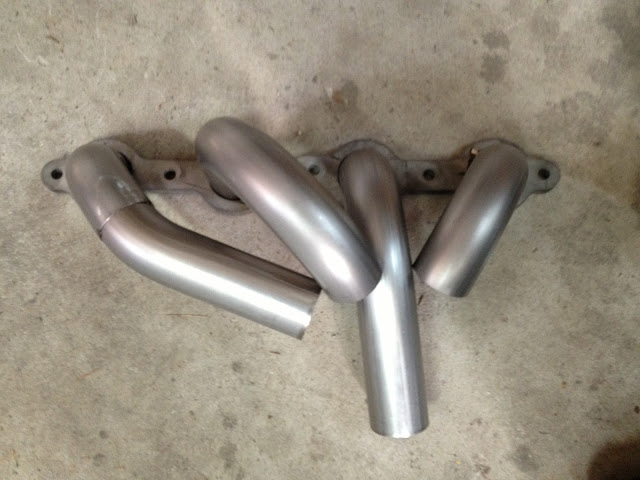

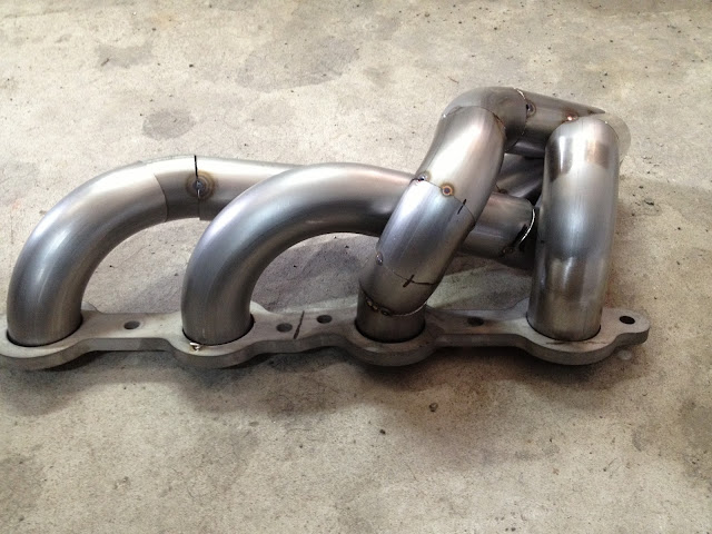

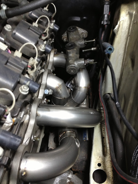

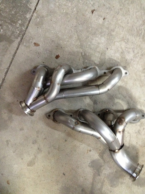

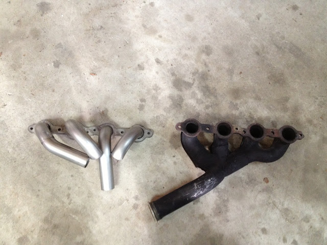

Making some new stainless headers...
The drivers side is really tight so starting with the harder one.
New compared to old.
The third runner from the left is just a test right now and will change...

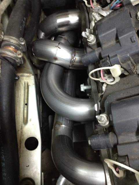

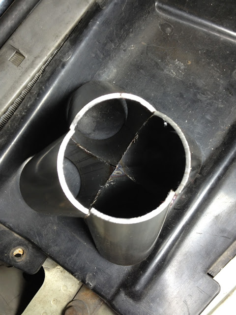

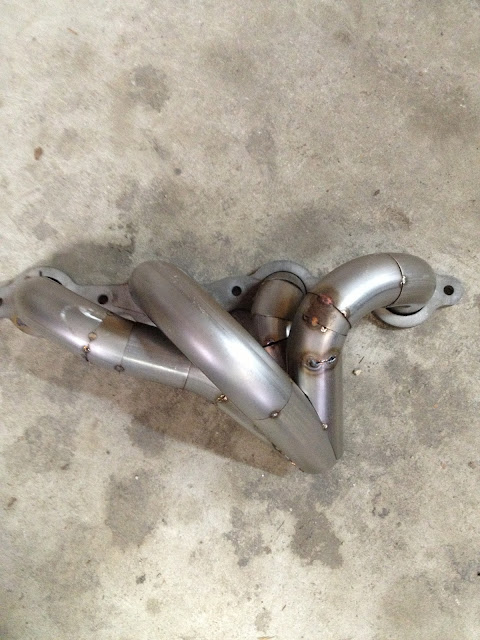

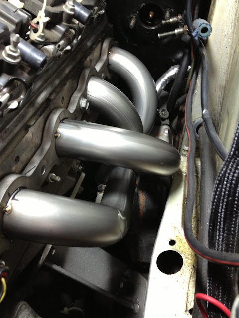

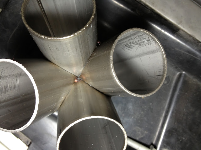

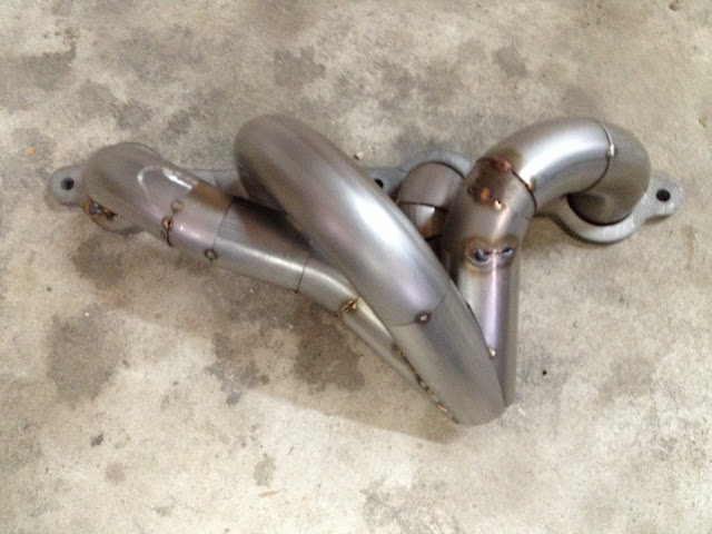

I wasn't happy with how the header was going to merge together so I started over.... MUCH happier with how it is working now.
4 into 1 collector
New version...
On the car...

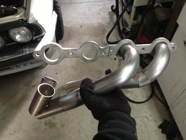

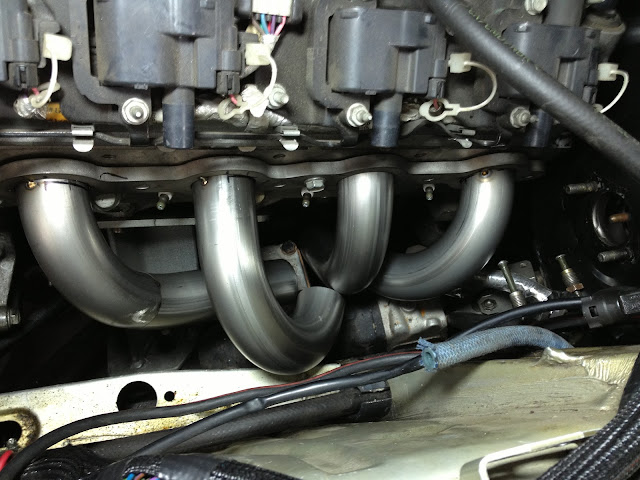

more work on the headers...
passenger side
On the car
Both together....vbands on. Still need to be test fit one more time...fully welded, jigged
