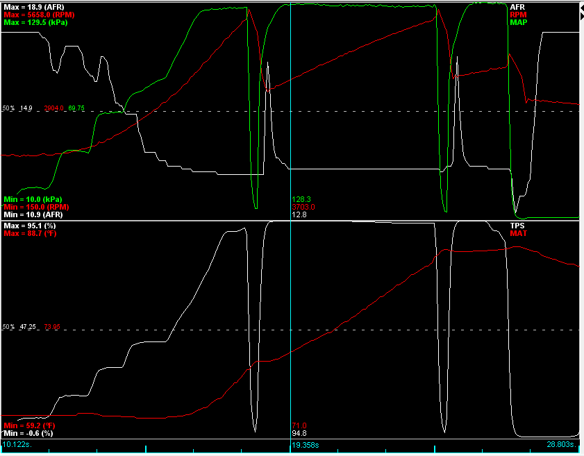

Thanks Marc, that's helpful. I decided to change the lag factors in the megasquirt to try to isolate which signal is the culprit. Upon closer inspection I think my AFR could have the most noise. So I will be messing around with it in the next week.
One of the biggest differences with this engine is that the oil pressure is higher than before. Where as the old engine(s) had hot idle of about 7-10psi, this engine sits closer to 15 and that makes me feel a bit better. I don't know if this oil pressure could have caused a piston ring issues but I'm sure that was the problem with the other engine that I pulled.
I decided after talking to my brother that it may be worth it to buy the full version of TunerStudio. It was $10 off and I decided to go for it. I had a fair base tune on the old engine and it drove ok but right away I started with the Tune Analyze auto tuning. It is interesting to see the suggestions of the new fuel values.
I went for a short drive and immediately saw the difference in optimized AFR's. After a short 30 minute drive up and down the highway, I slowly opened up the car as I saw the target
AFR's were more in reach. I have to say, I am very impressed with the program and would recommend it to anybody who has Megasquirt. The performance is night and day compared to just a day earlier. I don't say this kind of thing very often. Boost comes on smooth and I am running about 6.5-7psi.
This morning I did a cold start and ran the analyzer to find that at cold start, idle, and then through the revs after the engine warmed up that the whole tune was too rich. It wants to take out fuel everywhere. Does anybody else have this problem? Here's the adjusted map after what I thought was a close base tune yesterday:
Here's a short data log pull from the same drive this morning.
I am going to try it again in the warm afternoon temps and see if there is a difference.
With additional smoothing on AFR signal, here's another one:

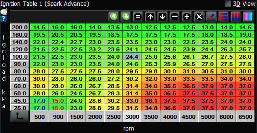

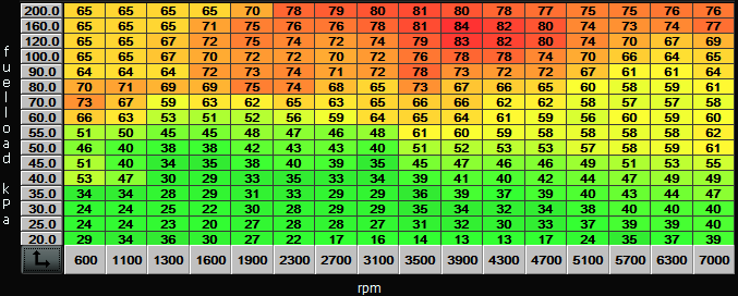

Here's my current tables which are slightly different from before. Useful for later reference:
VE:
IGN:
Target AFR:

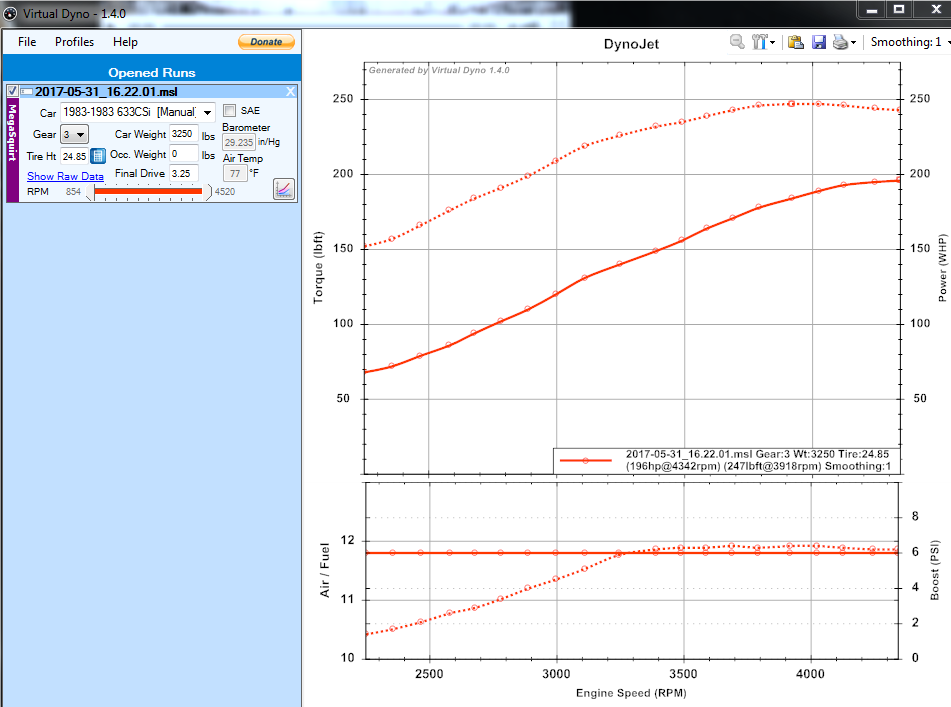

I have spent some time tuning the car, but my tuning laptop hard drive failed and my driver's door hinge pin broke (literally sheared) so I didn't get as far as expected. I got the laptop hard drive replaced and spent a little time tuning again this afternoon. Hope to replace the door hinge tomorrow or so-- it totally failed and can't really be opened.
I downloaded a program which has positive reviews called Virtual Dyno which supposedly lets you get an idea how close you to the real thing after defining specs on your car. So I entered in what I found to be my gear ratios, cD, estimated weight and others and plotted a quick graph just to see what it might show.
MLV:
Virtual Dyno:
I will continue experimenting with this program just for fun, but a lot people say it is quite accurate. It would be actual power after drivetrain and losses. I assume it uses sea level for the calculations and my inhg barometric pressure would really be ~24.5.

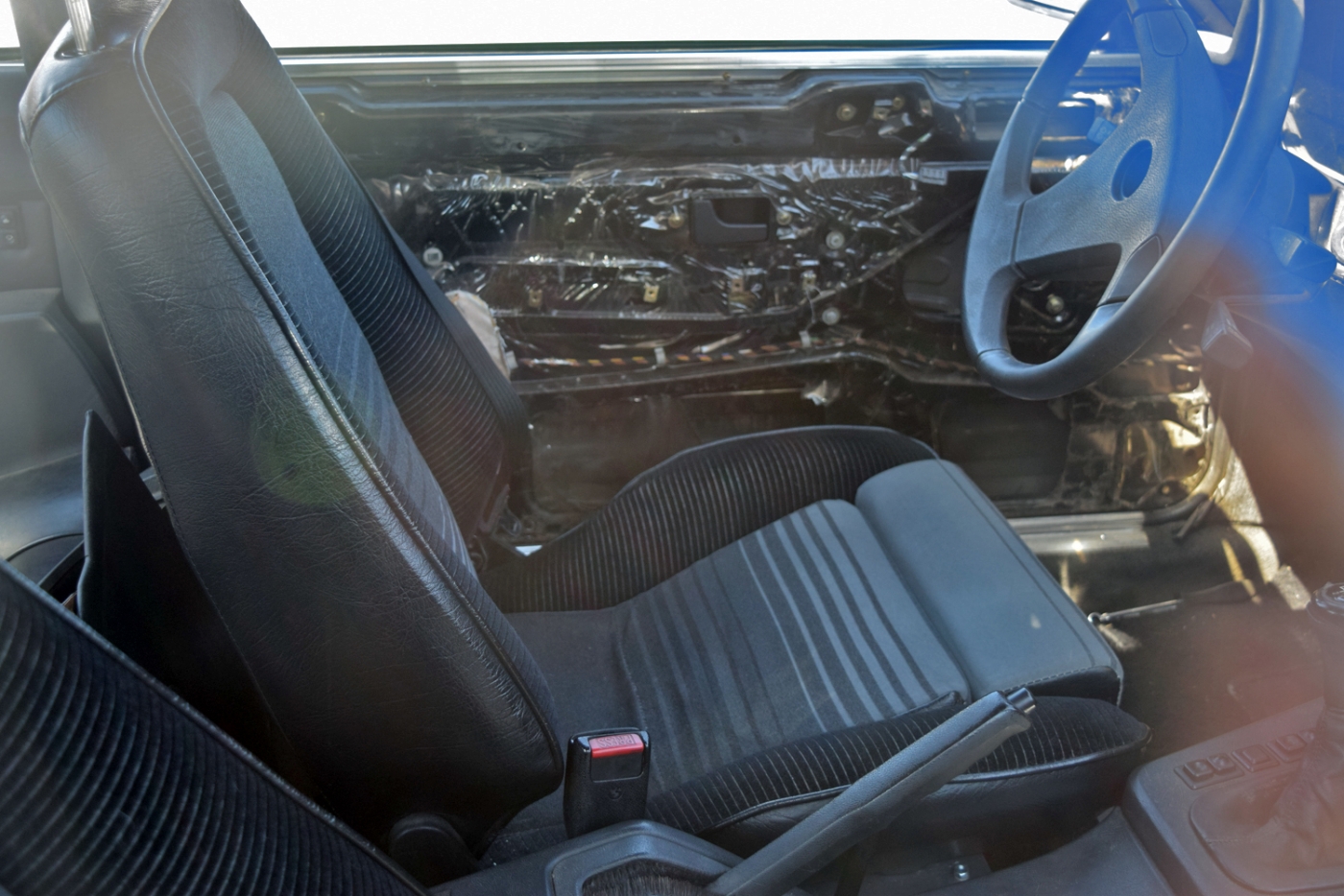

I got a door hinge last weekend and attempted to replace it yesterday. First tried an electric drill, but the three phillips head screws didn't budge. So i purchased a manual impact driver. Unfortunately that didn't work either. I tried air tools on as low of a setting as possible and the screws still weren't budging. As I slowly cranked up the air pressure, nothing happened until sunddenly the screw stripped. I tried all three and the same happened.
So yesterday I spent the evening drilling out the three.
To get the door hinge off, I had to almost pull the door off the lower hinge to be able to slide out the upper.
The offending hinge/pin.
And finally got it reassembled with new screws. Here's a pretty good photo of the Recaro seats

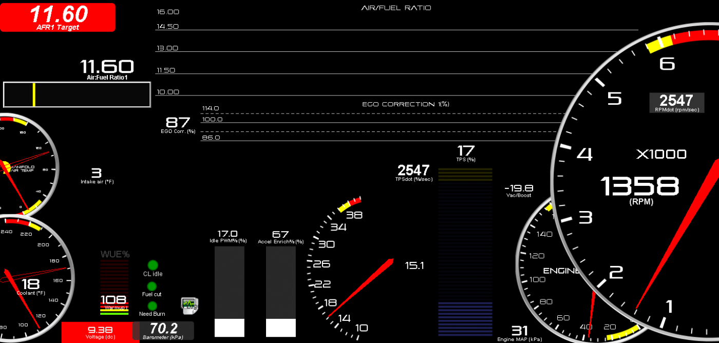

I created a custom dashboard based on one I found online. It's based on the TunerStudio dash shown on the load/open screen. Still trying to decide what is important but this was a good start for me to work on idling and to prevent stalling (Idle PWM%).
I also like comparing target AFR to actual measured. I am still getting noise in my harness, but I am not sure where to really start to try to iron out the issue. I think it is due to previous splicing into the harness before I bought the engine.
Also I took two different virtual dyno runs in different temperatures, humidity on different days. I thought the result was interesting. I really need to try one of these on the flat part of an empty highway to see if it changes at all in 4th gear. Next step when I am fairly happy with the tune will be to try these tests with my manual boost controller and see if there is a difference of how boost builds. Then I will turn boost up close to ~10psi/150kPa when I plan to leave it for continued track use.

Your dashboard is looking good. I made mine black so it would be easier to see and tune at night. I like to see what you've got there, IAT, CLT, Ignition Advance, engine map, baro, voltage, and now ego correction/ afr target. I also like to see what pwm my icv is at. I turned on my on/off display for fuel cut, need burn, WUE, ASE, and when accel enrichment is on. That is handy to know. I like the font on your as well as a couple of the gauges. Here is a view of mine. I was adjusting it so it doesnt look super finished. I like the afr log map so you can see what your afr was after a boost session.
I may take some elements from yours and make my own. But after riding in it last weekend, it seems much smoother. The last time I rode in it was either at the track or at D4C so take it with a grain of salt, but the new engine runs good and aside from a little boost lag, it seems to be really good. Hopefully the adjustment to the autotune makes cells change less readily and the smoother fuel map makes it run better. Once you get the noise reduced from the afr gauge it should be close to dialed in. I'll have to try a log of vitual dyno. I was going to do it the other night on the way home but couldn't get the dang driver to work. But 250/300 is pretty good, is that at the wheel or at the crank?

That's allot of shit to be looking at. :shock:

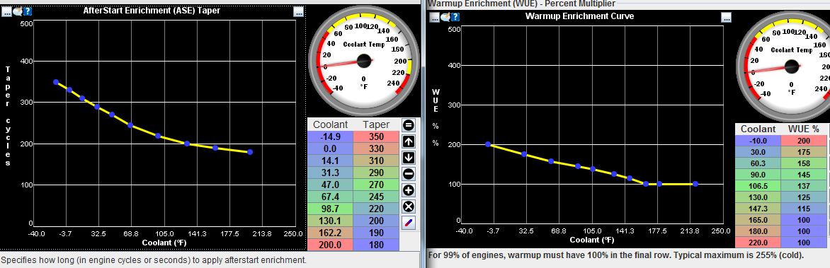

I have continued with tuning and have still had issues with the fuel map leaning out in hot weather like today. In 60F morning temps, everything was rich. In the afternoon at 90F ambient, the map was lean. I do think it is related to MAT correction and the map trying to run based on ~85% fuel or so. Will continue messing with it and report back.
Also, I visually updated my dashboard and I am pretty happy with it. Like I said, it is sort of like the TunerStudio entry screen

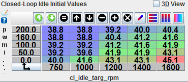

For tuning return to idle-- my closed loop idle settings still occasionally cause a stall and I think it is due to my initial value map. So I am tuning that map. Here is where I am currently at. Full closed is about 32-34%.
I used some of George's settings for enrichment and that was an improvement from what I had. Here's where I am currently at (which has helped with throttle blips and eliminating the lean spike in throttle tip-in).
Adjusting my warmup enrichment has also helped the cold start tendancy of the car to want to stall.
Lastly I did some reading about ideal fuel mixtures under boost. I thought this was interesting in relation to AFR under boost.
Jeff Hartman's book http://www.amazon.com/Modify-Management ... 538&sr=1-2. He's a chapter on Air to Fuel Ratio (AFR) theory that speaks directly to boosted engine that are knock-limited.
Lets have a discussion as to what is the best AFR for our engines when we want to make the most power without blowing up. Lets limit ourselves to one fuel: gasoline. 91/93 octane. Since that's what the vast majority of us use.
First some Ratio's:
14.68:1 (~14.7:1) Stoichiometric mix
12.8:1 - Lean best torque
12.2:1 - Mean best torque
11.76:1 - Rich best torque
11.01:1 - Fastest flame speed in cylinder
All five ratios are directly from Hartman's book.
He argues that for boosted engine that are knock-limited, "at a very minimum you are aiming for mean best torque" or 12.2 AFR, "if not rich best torque" at 11.76 AFR. 11.76 AFR has a side benefit of higher cylinder flame speed.
Torque starts dropping off the moment you start to go richer than Mean Best Torque and begins to drop off dramatically after Rich Best Torque. Counter-intuitively the Fastest Flame Speed at 11.01:1 AFR does not produce the most torque, but there is a cliff-like drop off in torque when you start to go richer than that point.
To sum up, Hartman states that 11.76 AFR is the richest one should shoot for. You may have to tune back the boost to get there but you'll get the same torque with better fuel usage than if you turned the boost up and went crazy rich (e.g. 10.8:1).
Going richer than target may depend on boost level, fuel quality/octane, static compression ratio, air temperature fluctuations and things like the condition of the fuel pump. With that said I aim for 12.2 and slightly lower as boost level increases.
marc79euro645
Posts: 513
Joined: Dec 08, 2008 11:33 PM
Re: 633CSi Callaway Turbo - 6/5/2017 - More Megasquirt Tunin
Post by marc79euro645 »
Good info. I see mega log viewer use 12.5 for it's ve analyzer at boost. I am still whittling down my ve from an earlier rich map, after my latest hg job. The rich(like 10:1) just blubbers, but I get zero knock from my knocksense light, so I'm going slow.

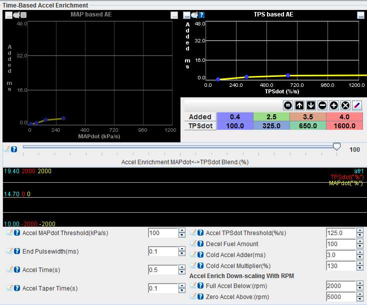

The EAE in the old tune in sent you was pretty rough. I've since dialed it back a little bit. Im still a little too rich on a big throttle spike. More tuning required on my end. Are you running 3.4.2?
Also, are you running fuel cut on decel? For me the transition back to fuel can cause a hiccup if the RPM reduce down to the transition point for idle. Still a work in progress.
Yeah, 3.4.2
I need to continue to revise the accel enrichments, but increasing values closer to yours seemed to help. If you do have settings you are more happy with, I'd certainly like to see them. I still get a lean spike when hitting the gas. Not as bad as before, but I think slightly rich is better than lean!
I have 100% decel fuel, so no cut at the moment. I'm not sure quite sure what I should set this to either. With the Motronic setup I had noticed rich surges during shifts and such. I just looked at a datalog and see the same thing happening. To a point this can be good when you are in boost, but in general I think you want to make sure the AFR stays close to the prior value (before lifting the throttle at all). I am going to try 90% and see how that works out.
Hoping to report some more MAT info later this week. I have started watching Fuel correction% and overall correction in my TS dashboard. In the morning it would be at 110% and 94% in heat of the day, causing my map to be either too rich or too lean in the temperature variations.
M. Holtmeier
Posts: 3036
Post by M. Holtmeier »
A nice long drive on an empty freeway can do wonders for accel enrichments.
Have you tried 0.2ms for accel time and 0 for end pw and taper? Mine seems to respond the best with a momentary rich dip then right back to stoich. I tuned for no change in the target afr and still fought an intermittent stumble.
Interesting take on the mat correction. I read the algorithm isn't as effective at higher rpm and/or engine loads. I haven't seen the issue like you describe with boost regions running richer. I still have hot restart lean conditions, but it's not severe like it used to be. I have found that as my fuel temperature creeps up, the afr starts to lean out. I'm thinking all the e85 has done some damage somewhere or one of my pumps is dying. Either way, I'm completely revamping my fuel system.

I am wondering about the corrections-- maybe they are more inaccurate due to my altitude. Like possibly that air density due to ambient temp doesn't fluctuate quite as much at 5000ft as at seal level, so the default MS2 ends up being too aggressive for me.
Mike, I'll have to try your accel enrich suggestions. After seeing a datalog I can already see my TPSdot values should be set closer to 50-60mS for a pulse of fuel with smaller throttle adjustments.
Regarding your lean hot restarts, why not simply add more fuel to the Warm up enrichment table at that spot? So if coolant is 175F, it adds more fuel to the taper process... It could also be failing hardware too like you mention.
M. Holtmeier
Posts: 3036
Joined: Mar 11, 2007 3:06 AM
Location: Josephine, Texas
What I did was add more temperature than needed to my tables for ase and idle DC. (I'm back to open loop iac) So now instead of continuing to add on to the "at operating" temp range, I have a new point thats 30 degrees higher for hot restarts. I haven't turned ego on, but I'm pretty sure when I do, it's going to handle any temp swings thrown at it.

In driving around a fair amount lately, I seem to be getting a very noisy signal into my unit. With the engine off, all sensors report very smooth signals. However, once I start the car, the CLT, TPS and AFR signals all become very noisy. I was hoping to try to reolve this today but have gotten nowhere yet...
The wideband is grounded through the MS2 adapter wiring. I have tried powering and grounding the AFR signal directly to the battery for no change in behavior. Idle AFR's jump from target idle of 13 up to 15 and down to 12. Ignition advance and Ve table values are constant in this closed loop idle situation.
Regarding variable TPS wiring,I do not have a way to shield these wires in the stock wiring harness. Is this something I need to do? Connecting the ground reference wire directly to the battery made no difference in the noise I am seeing.
Do you have any ideas for me to troubleshoot? I don't know if my VR adapter cable is shielded or not, all I know is it connects up properly to the stock harness through the reference sensor.
I have checked engine ground and all seem to be working well...

Can you post a log?
It sounds like a bad or intermittent ground, possibly fretting buts its difficult to diagnose without seeing a log file.

These files are good for 30 days:
https://uploadfiles.io/68zpa
https://uploadfiles.io/5veh4
I believe these settings show the inputs after lag factors (Which right now are set at 15-20)

What are the lag settings on your wideband? Can you slow it down to get a better average reading?
Most of the noise I've seen/read about with MS is engine harnesses routed to closely to secondary ign wires. Do you have the coil wire or plug wires running near any other wires?
