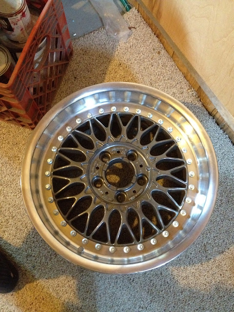

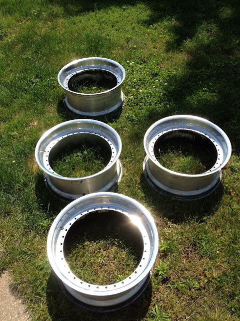

It was around 90 degrees here this weekend so I spent a lot of time inside. Worked on refinishing the wheels today. Right now the lips are just bare aluminum...with two coats of wax on them. I don't have them put together yet and I am at the point of should I powder coat the lips clear or leave them bare..... What do you all think?

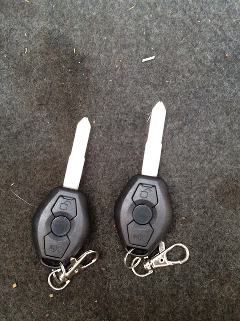

I bought a keyless entry/alarm off ebay with the remote in the key. I didn't hook up the alarm part. Just the keyless. It is all hooked up. I just need to get the keys cut.

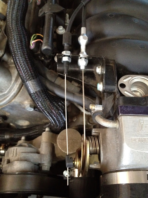

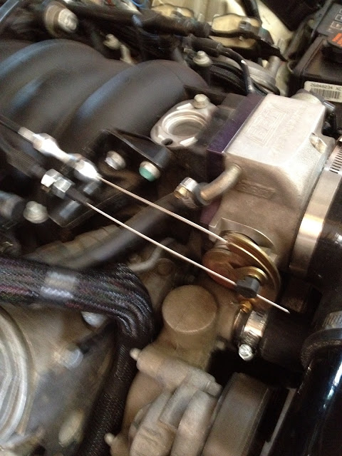

Worked on adapting the BMW cruise cable to work with the LS1 TB. Just need to add a crimp after the little snap thingy.

How is the cruise going to function with the LS1? Probably just not thinking it out all the way but the cruise in the e28 was a seperate control, right? So its just as easy as adapting the wire and leaving the original system in place?
jakeb
Posts: 552
Joined: May 07, 2011 11:30 PM
Location: Bay City, MI
Post by jakeb »
yup...the BMW cruise is it's own system and not really connected electronically to the engine.
Posts: 15844
jakeb wrote:yup...the BMW cruise is it's own system and not really connected electronically to the engine.
Correct. AFAIK, the e28 cruise has no connection to the ECU at all. Brake and clutch pedal cutoffs, speed signal, throttle control, and control stalk leads only.

I recommend clear coating the lips. I've heard people complaining about the maintenance (mainly a lot of elbow grease) of bare aluminum and having to polish it frequently.

I ended up clearing the lips....I don't want to have to deal with cleaning them.
Got the wheels all together, tires mounted, and on the car...I need to get some paint mixed up to match the centers so I can paint the center caps. LOVE them!
