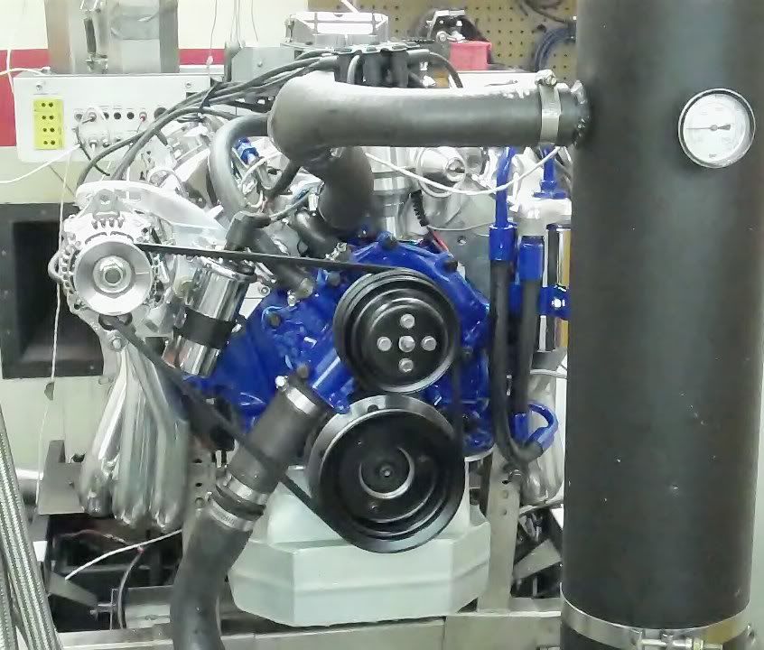

Monday morning at 0800, engine will be on the dyno.

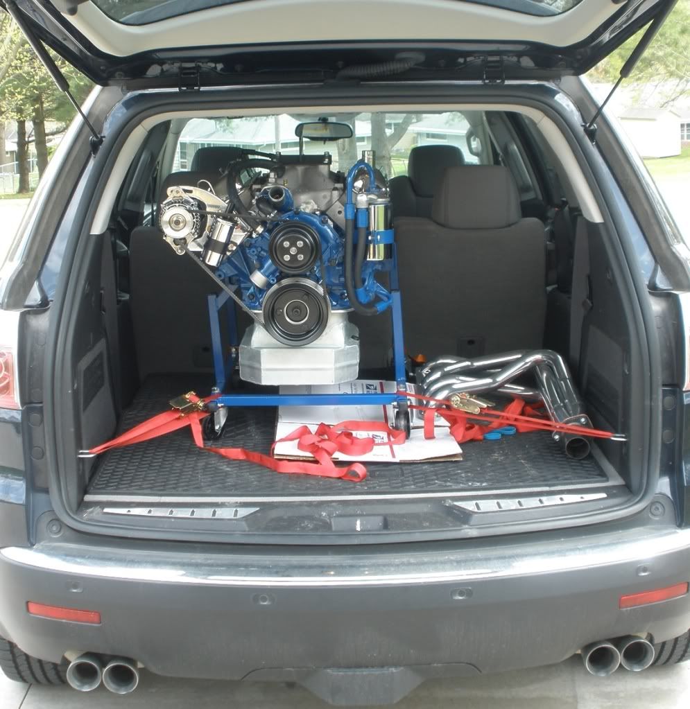

I just over doubled the HP in the Acadia.
Now the challenge to not forget anything I need so I don't have to return from the dyno on Monday.
After ~5 hours of work, engine was finally on the dyno ready to be started for the first time. As seen and heard (back fire through he exhaust) timing is way off. I had also just gotten a call from work and my brief to a GO was moved up....I had to go. Will pull the valve cover off in the morning to check that #1 is TDC on the compression stroke and then re stab the distributer. Tomorrow should be a day of many power runs.
See video here - http://www.youtube.com/watch?v=ffNCJ_4hGzg
DIS-MISSED!!

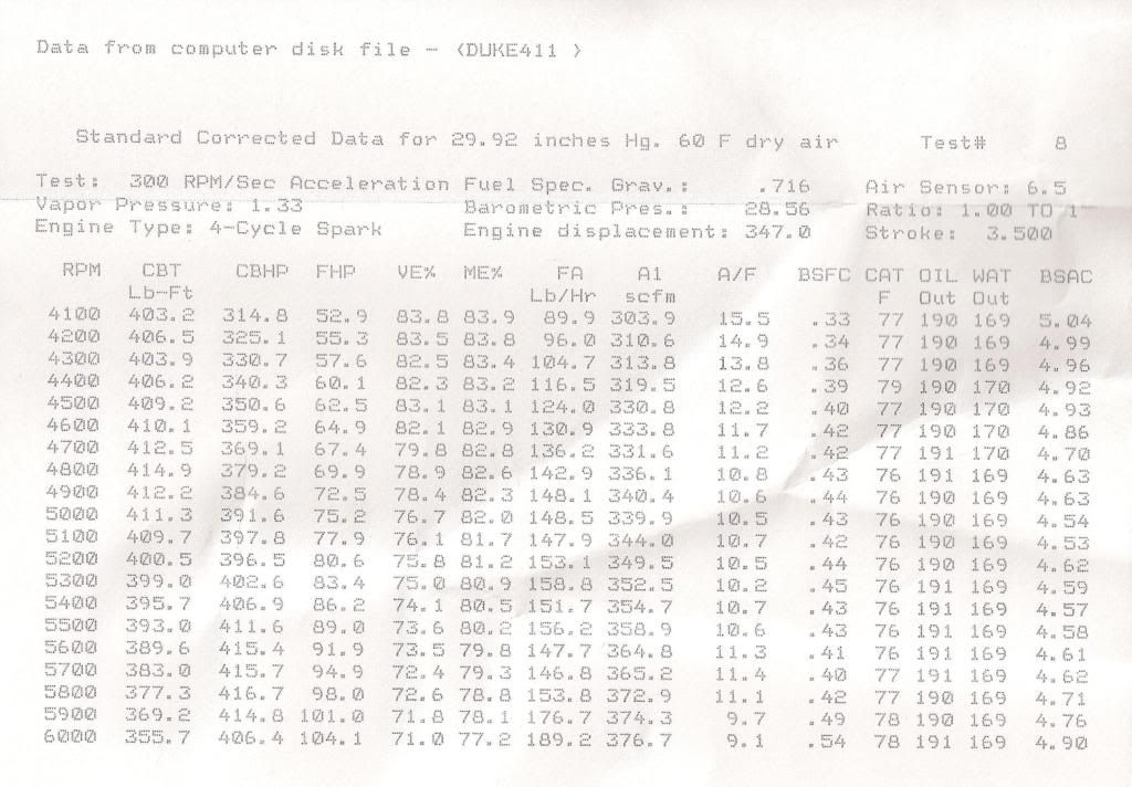

Numbers:
415 lb-ft torque @ 4800
416 HP @ 5800.
On the Holley 600 DP. Ran out of time. I bet there is at least another 70 HP to be squeezed out of it.

So here are the numbers -
No fancy graph, just a dot matrix print out. I was disappointed he did not do from 1500 rpm on up. He claimed he was not able to do it. No matter, will get all of that info on a chassis dyno.

Timing....what a PITA. Lets talk about what hell I went through with timing today.
1. Pulled the valve cover over #1 to determine TDC for the compression stroke. Discovered there were two identical sets of 0-40 degree timing marks oriented the same way ~45 degrees apart (there are others that face the other direction for a pointer on the other side) on the balancer. I had obviously referenced the wrong one. So I marked the correct with white paint.
2. Got it running and discovered that if the distributer was not really tightened down, it would turn and retard the timing. This would happen over 3000 rpm. That screwed up some runs.
3. The mechanical advance weights in the BRAND STINKING NEW BIG $$$$ MSD distributer kept get stuck in the rotor cap. I had to remove the cap and do surgery with a dremel to correct the problem (calling MSD tomorrow). This also screwed up runs when I discovered the advance would not go past 20 degrees and was stuck partially advanced.
So, you can see why I was happy with the 416 HP and got the hell out of there. Will do the rest of the tuning with it in the car and/or a chassis dyno.
Almost makes my EFI days seem easier...............almost. ;)

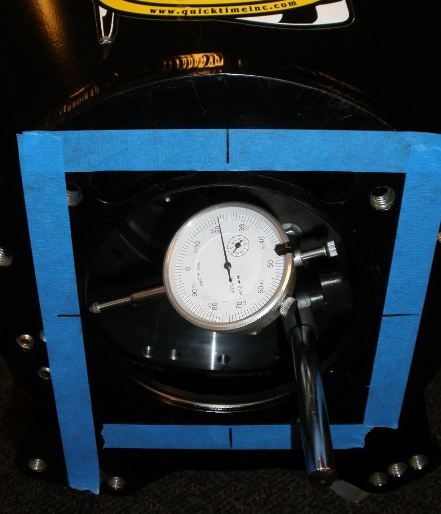

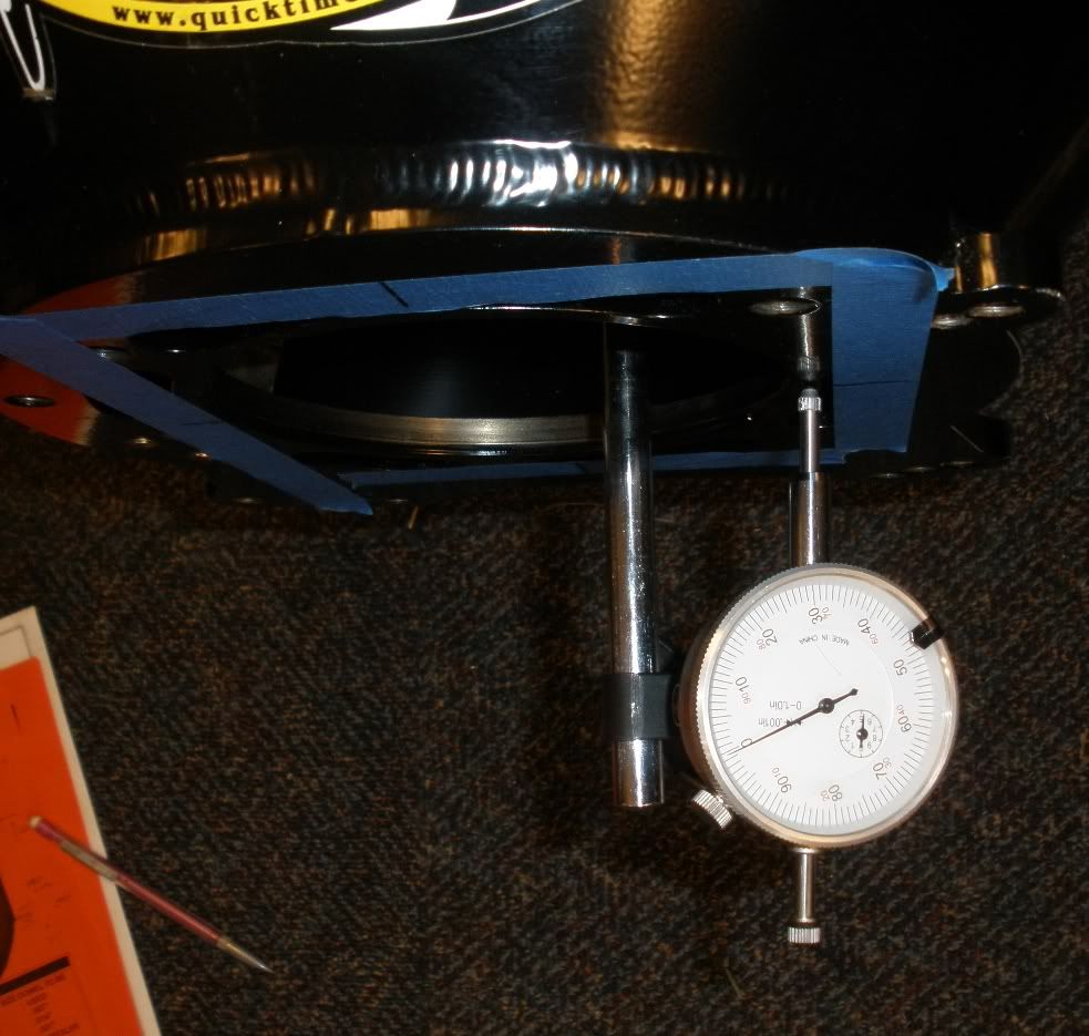

Bellhousing Alignment.
Checked bore concentricity and parallelism.
The bore alignment was off .020 at the 12 O'clock and .015 at 9 O'clock. Will correct it with a set of .014 offset dowels. Trans mounting surface was withing specs for being parallel.

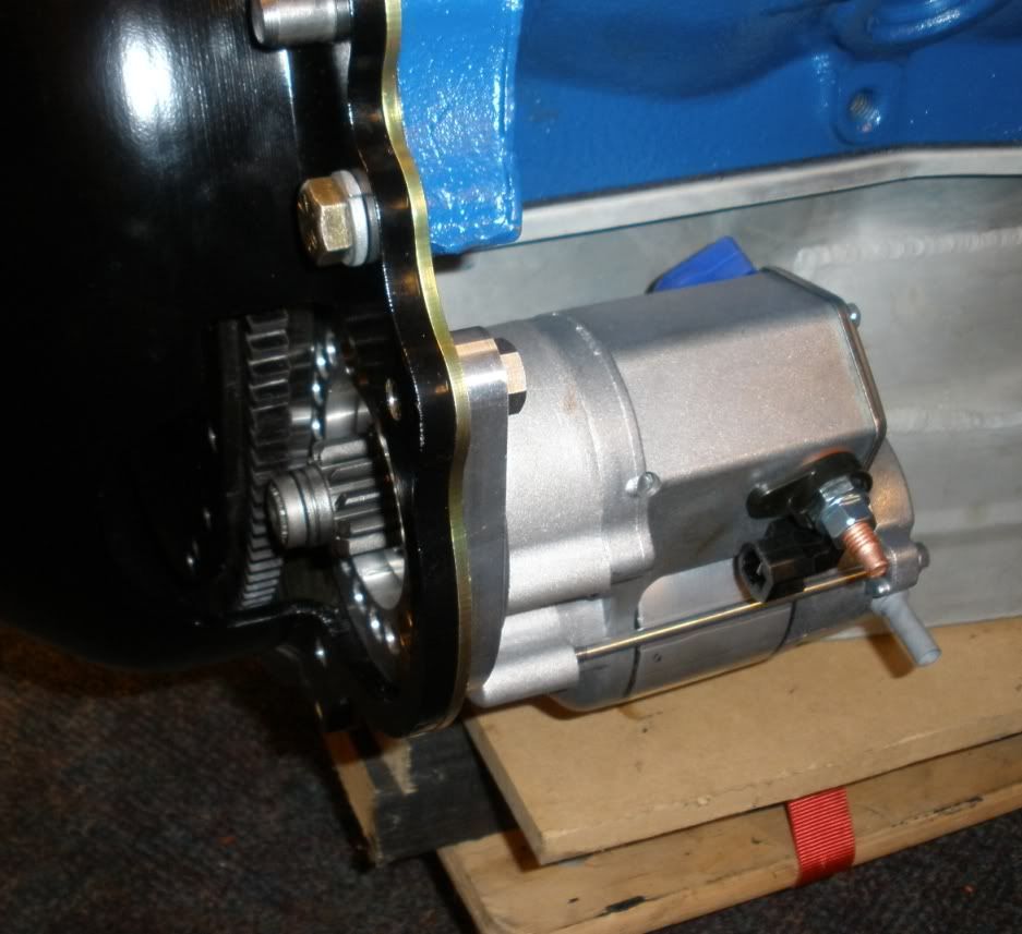

Starter test fit, looks really good and will easily clear the headers.
