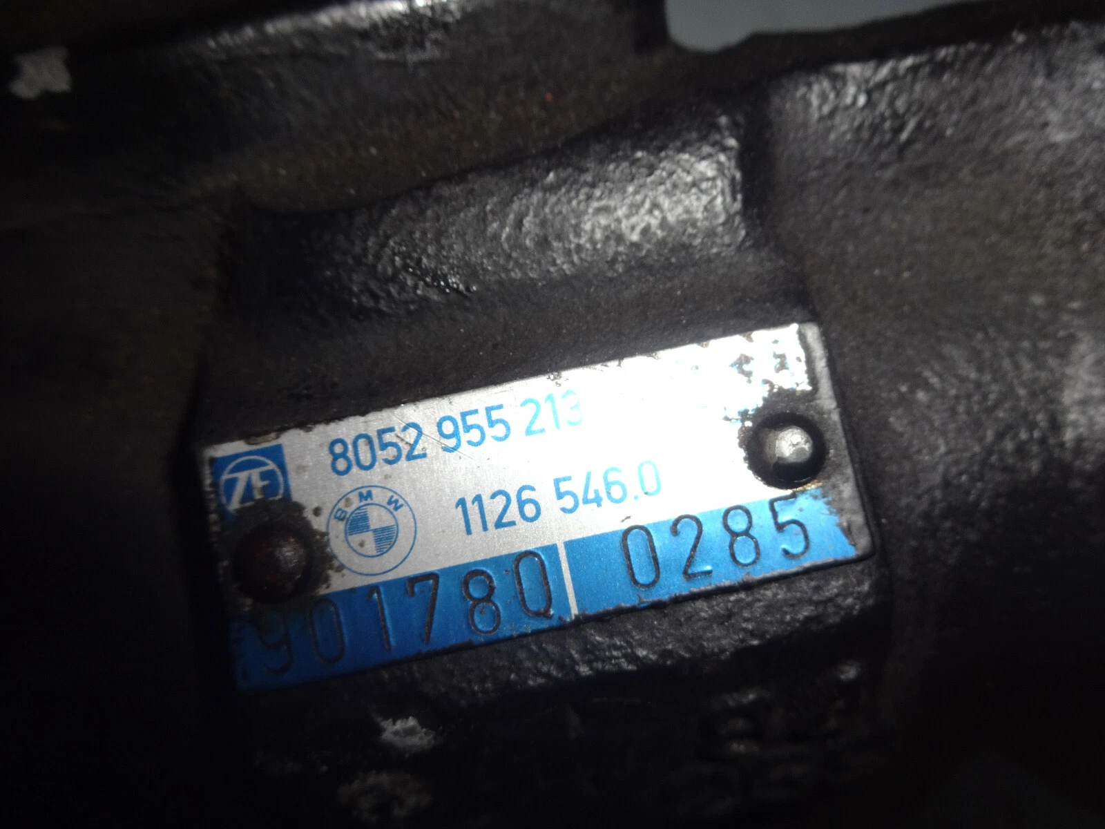

Does anyone know the numbers on the plaque for the E28 M5/635csi steering box? I have found a low milage box that the owner states is from a 6-er, but I would like to double-check if it's truly a quick box vs a normal E28 one. Thanks.

szacsi72 wrote: Jan 27, 2026 8:06 AM
Off:
Some details on them here:
viewtopic.php?t=50059
szacsi72
Posts: 523
Joined: Nov 13, 2022
Location: Hungary
Re: szacsi72's 1984 Zinnoberrot 535i Build
Post by szacsi72 »
Chimi-Changa wrote: Jan 27, 2026 10:19 AM
Off:
Thanks. I've read the post, but it's not super detailed on exactly which boxes are and arent quick ratio.
The box I found has a silver plaque, says ZF - Schw. Gmünd - Made in W. Germany + 8052 955 213 + 8716 0582.
I could not verify the box from this number only.
However, I did find an ebay ad that has the same code on it, it's a blue tag, and also says 1126 546.0:
No luck again, all I got back was:Hydro steering box 112654632 13 1 126 546
Delivery discontinued by the factory
ProductionMar '82 - Mar '90
Any ideas? Thanks
Any ideas? Thanks
Let me check that number in my 84' 635csi next friday...
Do you personally feel the difference in the slow vs fast box? Is it worth the upgrade?

szacsi72 wrote: Jan 29, 2026 3:28 AM
They feel different; the E28 is "lighter and requires more turns to corner"...the E24 is "heavier in the steering but requires fewer turns"...in both, all the steering arms, etc., are new, so I imagine that's how they felt when they were new cars. But I don't use either for racing or track days, so the most noticeable difference is the heaviness or stiffness of the E24.....if that's what you're looking for, the change is worthwhile, but for casual driving, it doesn't make sense (for me at least)
Aldo525 wrote: Jan 28, 2026 9:44 AM
This is the tag in the euro 08/84 e24 635csi....it is the same as you found.
