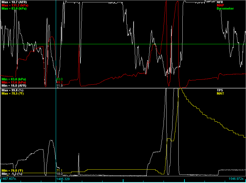

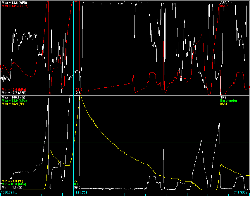

Can you post your AFR table? My approach has been to tune the VE map for 14.7 across the board and then let the O2 sensor make adjustments as necessary based on my AFR target. Though, I'm not running boost yet and I think the boosted area of the VE table should be hard coded to whatever AFR you want to make there as the O2 sensor is pretty useless there. Are you using Multiply Map? I have 42lb injectors with a similar ReqFuel and have to have much higher VE in the idle region to get a decent idle AFR.
I think you're going to need a lot of retard in there boosted region if you're trying to run on anything less than 91 octane. When I talked to Todd about my setup he didn't recommend anything less than 91, though our gas here in Cali isn't very good to begin with.
As for your MAT correction, I was under the impression that since it modeled the ideal gas law it shouldn't be changed much unless you're really sure that's the issue. Maybe you're just having issues with your temp sensor placement as previously mentioned in the thread.
Re: Callaway 633CSi - 9/24/2016 - Up and Running MS2!
Sure. I am set to multiply also:
Recall I am at higher elevation than you, so my 80kPa is close to atmospheric. I specifically wanted this region to be about 13:1. I also have lower grades of fuel available. 91 is the highest you can find in most gas stations around here, but it sounds like I may just have to always use premium.
My understanding is the MS controller references the VE map as the base fuel value (along with req_fuel). Then EGO control is allowed depending on the circumstance and preset settings in case of fluctuations between ve map and the target AFR. For example, my ego control isn't allowed over 80kpa so once I get in that zone, I am relying on the ve map. The idea is to get the base map target zones close before any corrections.
For the AFR Map, you want to tune the different zones for the application. Notice my 15.5 zones are cruise in low load, so lean is acceptable to save fuel. Approaching positive pressure I target 13:1 and above I aim for 12:1. But I have my ego control disable above atmospheric. I'm not sure what other users do.
I'll keep investigating mat corrections. The iat sensor placement seems to be related mostly to hot restarts. I have found it to run a bit lean in these conditions until closed loop idle is able to interfere and bring everything near the target. Temperatures are cooling down and I haven't had hot restart issues, but it is still on my mind.

Another update although way past due.
Back in Oct I realized that I have some sort of issue with my engine and had parked the car since. I actually started it up today and pulled it out. I didn't even have to charge the battery!
It started right up and I decided to take it around the block and try a datalog. I hadn't done this before because I thought it was in the premium version only. I took off my ball/spring mbc since I wasn't sure what was going on with my engine, but at 6psi with MS2 it feels as fast as the Motronic setup@11psi. Mostly it just has better response.
You can see my immediate need to reduce noise in the signals. These are CLT, RPM, TPS, and AFR. Also I don't think my AFR calibration is 100% accurate. It is reading slightly leaner than actual. Just a 2nd/3rd gear pull to try out the datalogging.
Still planning to swap out my spare engine in May at the latest.
