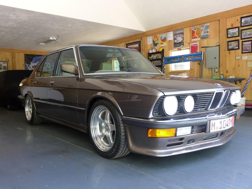

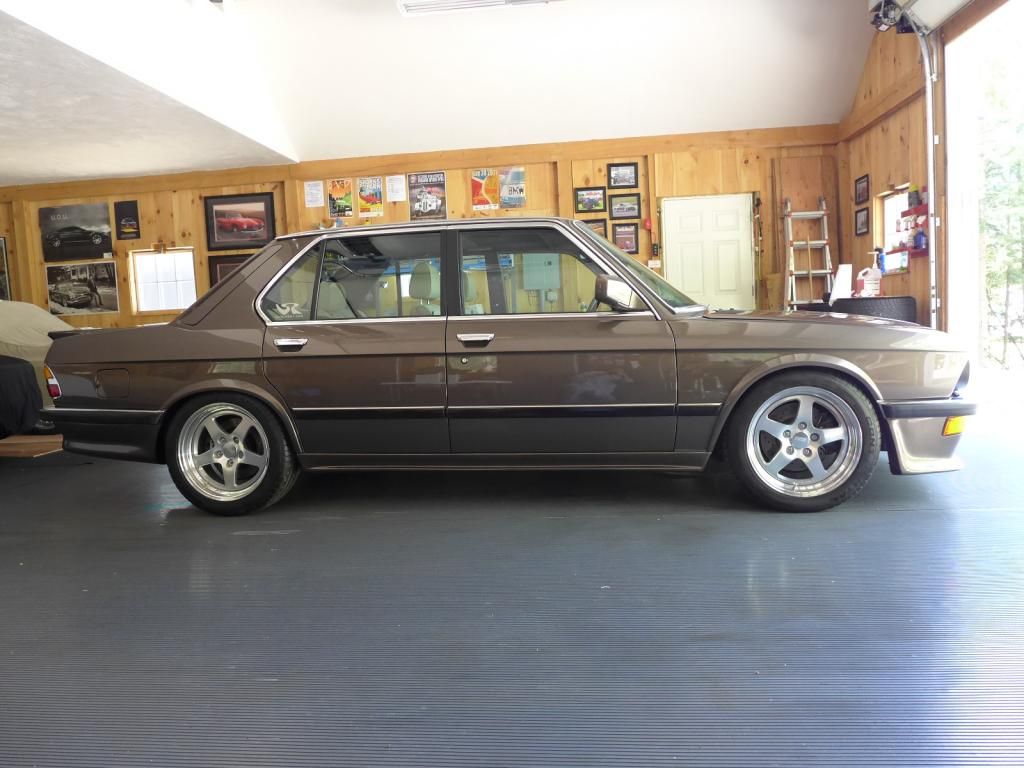

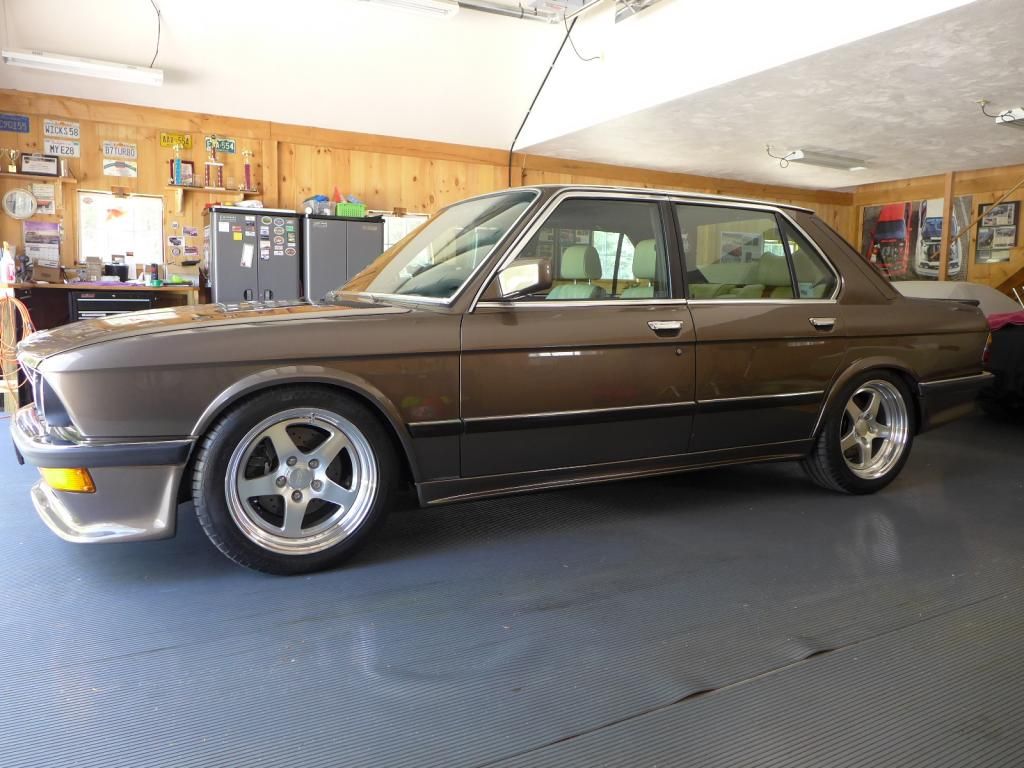

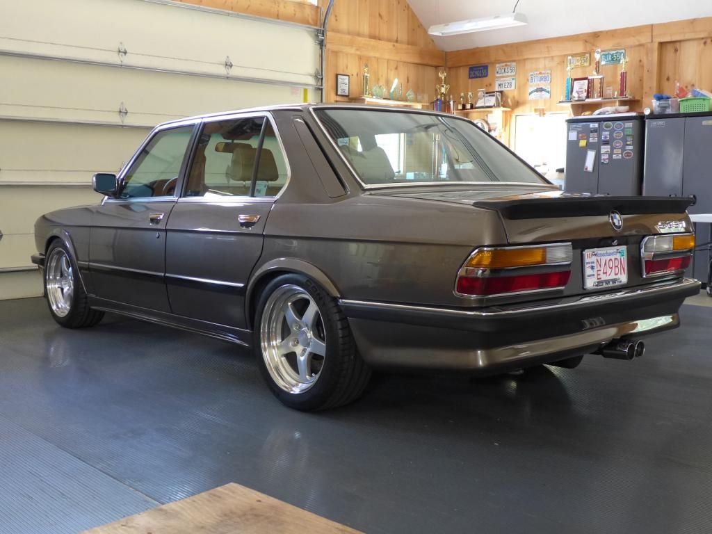

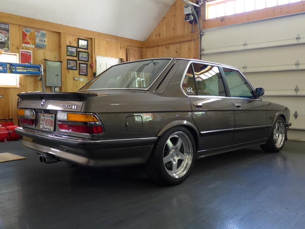

I took some more pics today after the detailing, figuring this is the best its ever going to look... and yes, I plan to drive this one :D
-RoyW
That may be the most perfect ride height I've seen on an E28. The wheels weren't my thing at first, but they're growing on me.
Will be very interested to hear about the power and driving experience once it's 99.9% tuned!

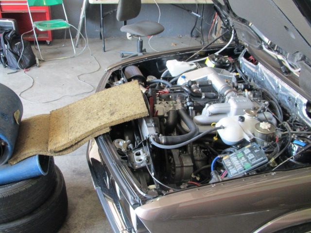

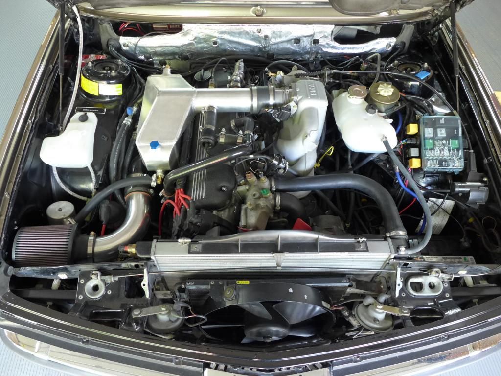

RoyW wrote: Image
Roy, can you please espouse on what you used for the firewall insulation seen in this pic? Happy with the results?
Thanks.

cek wrote:
RoyW wrote: Image
Thanks.
The material I used on the firewall cover is simply sound and vibration deadening stuff like that which I used on the inside of the cabin... it's like Dynamat. That original covering was in bad shape, all cracked and nasty looking and it is an NLA part... so, I just decided to cover it over. Its not ideal, but it looks a lot better than before :)
-RoyW

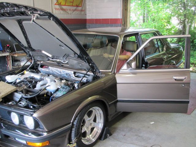

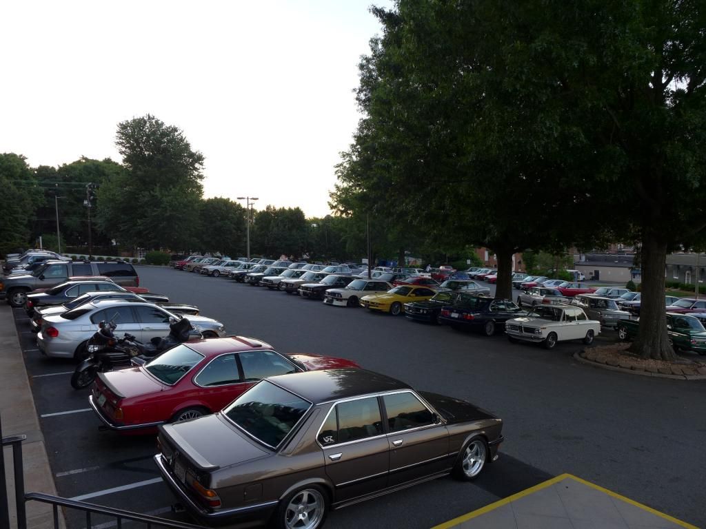

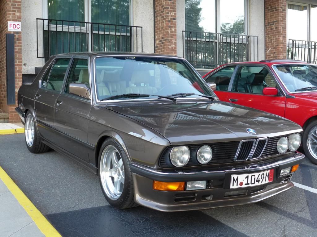

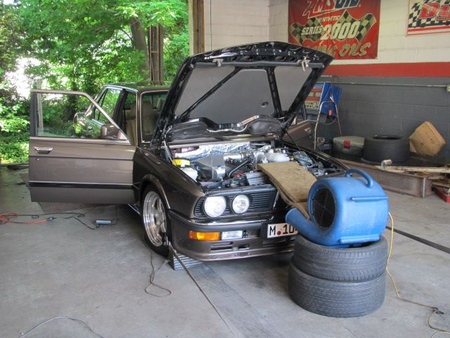

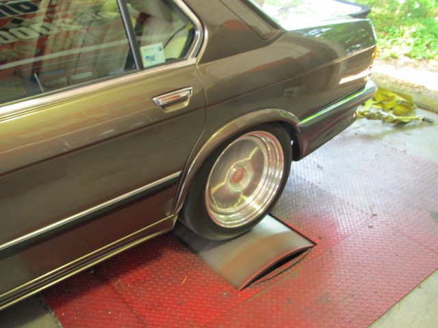

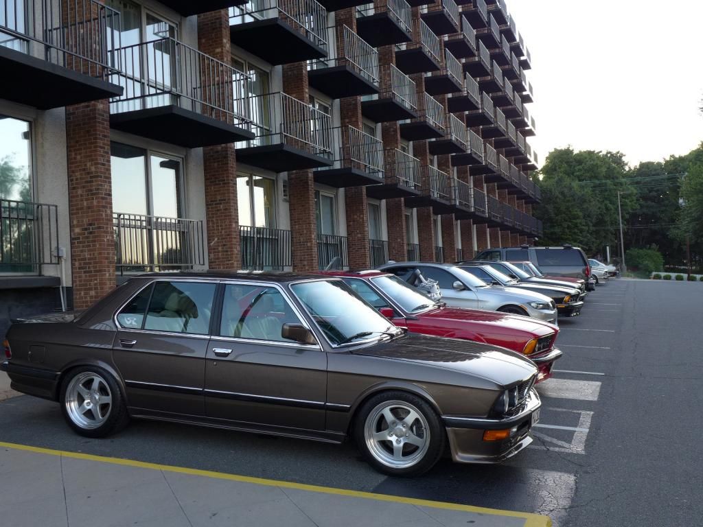

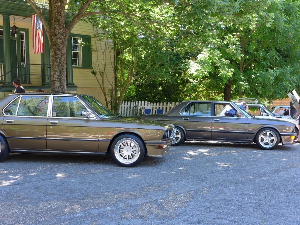

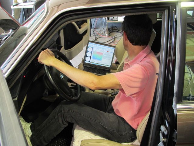

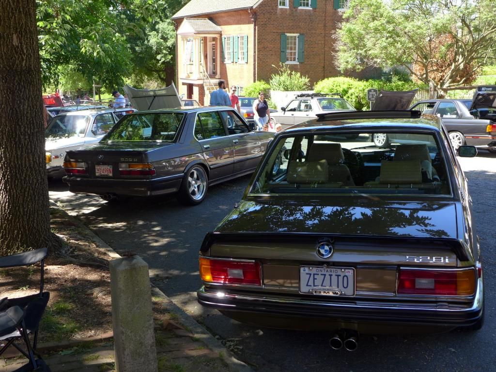

Well, the 535 project car made it to The Vintage this past weekend despite not be fully completed or registered (had a plate on it, but out-dated sticker). It was close enough from a mechanical & cosmetic perspective to make that previously set goal to bring it to this event... and, since I needed to have the MegaSquirt system tuned by Peter Florance in VA, I combined the two events, which were only 5 hours apart, into one trip. :)
The week prior to Vintage, I completed a bunch of small stuff, e.g., antenna delete, trunk trim, wipers, etc. and loaded her into the trailer for the trip South. Had a couple problems on Wednesday on the way to VA, e.g., blow-out on a trailer tire on I-95 (YIKES!) and big traffic delays around NYC, but made it safe and sound to Virginia Beach, after a 13 hour drive, about 3+ hours later than expected.
Met Peter at Abacus Racing for the dyno runs and MS tuning on Thursday morning. All went reasonable well, but we had a low vacuum reading at idle, which after confirming no leaks, was attributed to valve adjustment. Not wanting to burn any valves, we decided to not do any hard runs until the valve clearances could be checked... we'll re-do the dyno hopefully in June. But, Peter was able to get a nice smooth idle and the engine running very nicely with some moderate runs on the dyno and MS tuning work from his laptop... a 100% improvement from its running condition before his work! She sure pulled pretty well around the parking lot :D He anticipates about 340 lb/ft of torque and 320 bhp, maybe more?
Anyway, had a great time at The Vintage and the car was well received. Later in June, we're hoping to button everything up and get the few remaining tasks completed; get the car registered; and out on the road fro a good shake-down. :D :alright:
Here are few pictures from this past week at the dyno with Peter and at The Vintage.
-RoyW
At Abacus Racing's dyno with Peter F.
At The Hawthorn parking lot, full of vintage BMWs :D
At Olde Salem Village next to Eddie's brilliant e12 (the 1st Place People's Choice Winner)

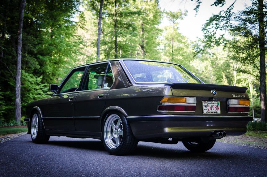

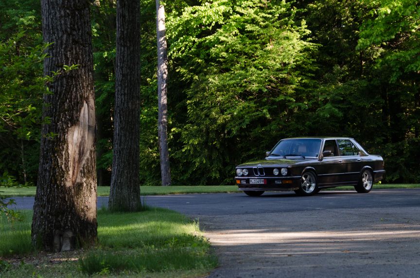

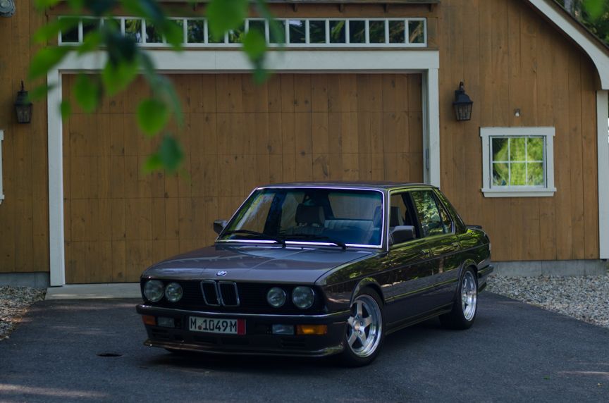

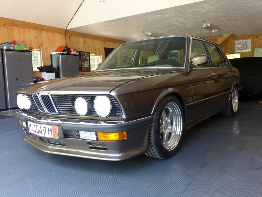

Since returning from The Vintage the 535 has seen no real progress on the long list of small items that need to be done to completely finish her up. I did get a few things accomplished, i.e., resolve the rear right headrest issue (it wouldn't go all the way down); put in the trim panel over the radiator; more progress on the stereo system, but, we discovered one of the Soundstream amps was intermittent, so took it to a shop for repair). Oh, and I did get the car plated and registered, and have driven it a little locally! :) Still another couple sessions worth of work to do... hope to get some of the items done before heading to TedFest, the rest will have to wait until after and my expert help, Steve, is available.
Meanwhile, the Sunday before last a professional photographer friend came over and took some pictures of the car. They came out far better than those I attempt :lol: and he promised to come back and take some of the other cars...cool :cool: Here's a few of those he sent me.
-RoyW

Those German engineers back in 1988 could only dream of making something so stunningly gorgeous.
Re: 535i "Project Sepang" - 6/15/14 re-build update
This picture is really nice!
