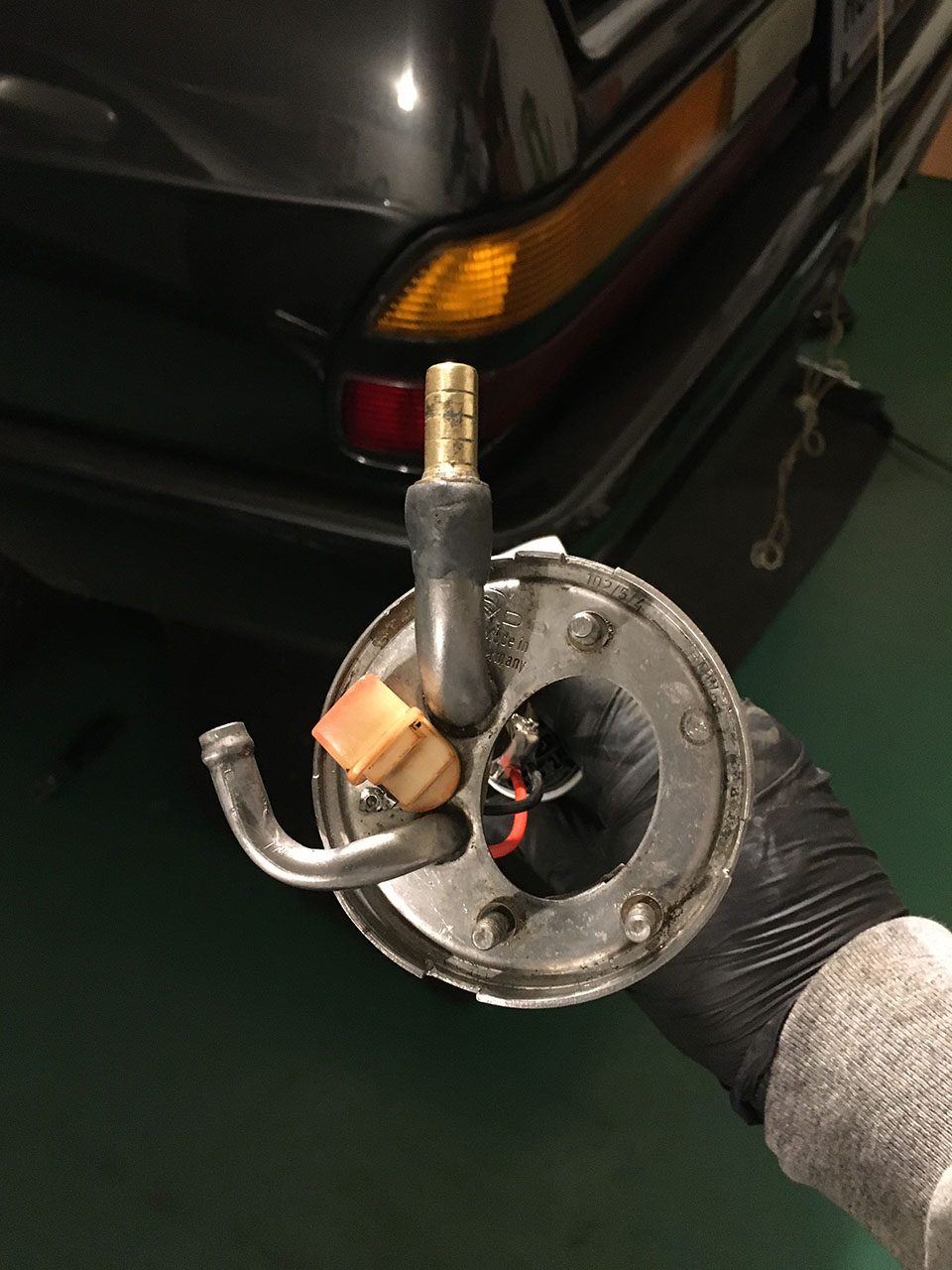

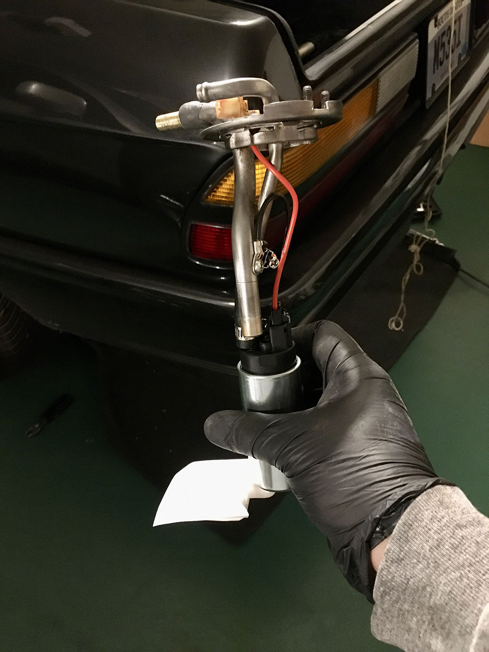

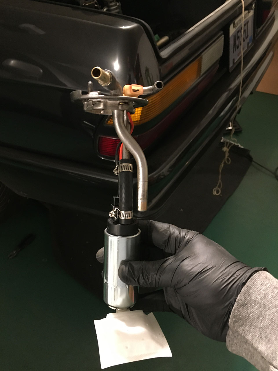

Just eliminate the need for it by using the small pipe on the tank assembly for the pump output. I've done that on two cars now, and it works fine. Very easy modification, and allows you to use the connector hose that comes with the pump.EE TWO EIGHT wrote: Oct 17, 2022 12:36 PM Is the stepped hose that goes between the pump and in tank assembly still available new? Part number if available or a link to where I can order one?
This is the one I did several years ago for my 528e:
And this is the one I did last year for my M535i:
