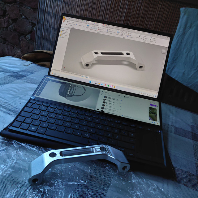

Oi Zman,
Thanks. I can whip-up these anytime actually..
But since this is a hobby and im not planning to sell these actively, it would be maybe reasonable to group up so i could get a group discount from my machininst.
Lets bundle up?
Only thing missing from this bracket is ruthless road testing. I am honestly quite many years away from finishing my build. This would need couple/few brave ones to do the field test for me. (if waiting is not an option)

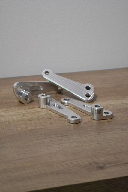

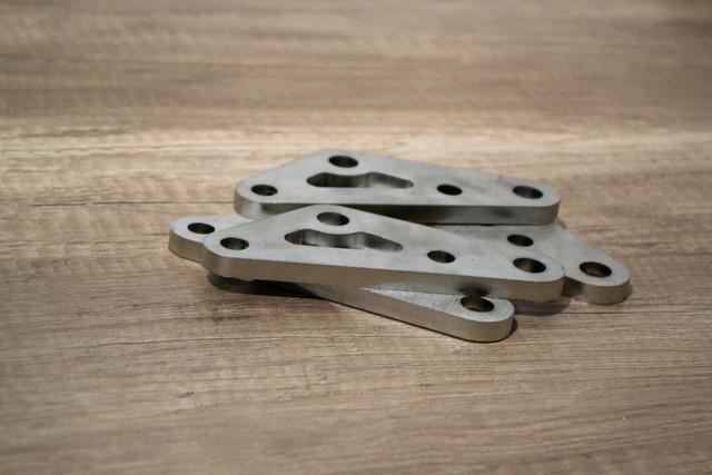

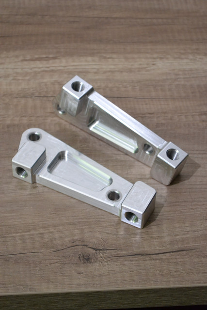

Good work. I just wanted to let you know that - if you need it - I can help you make brake adapters.
Here are some that I've made before:
